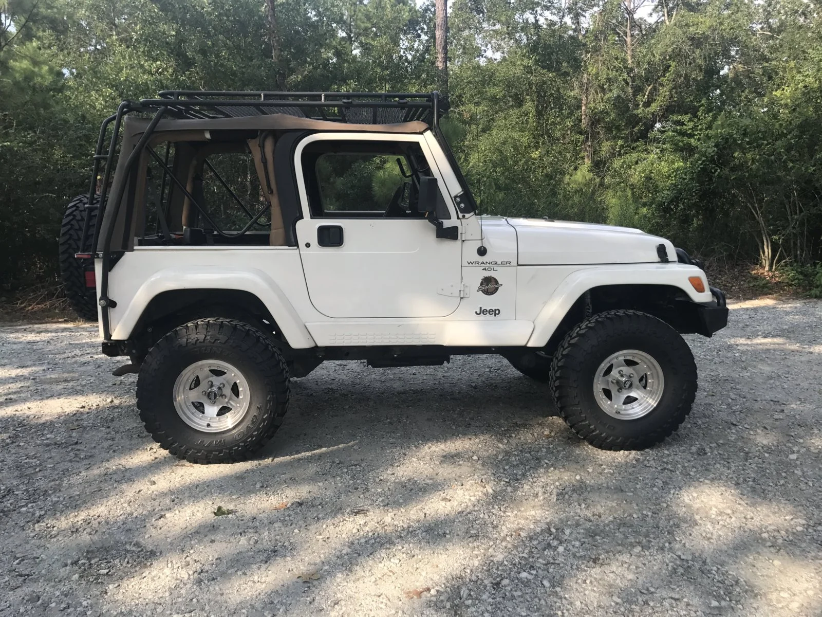

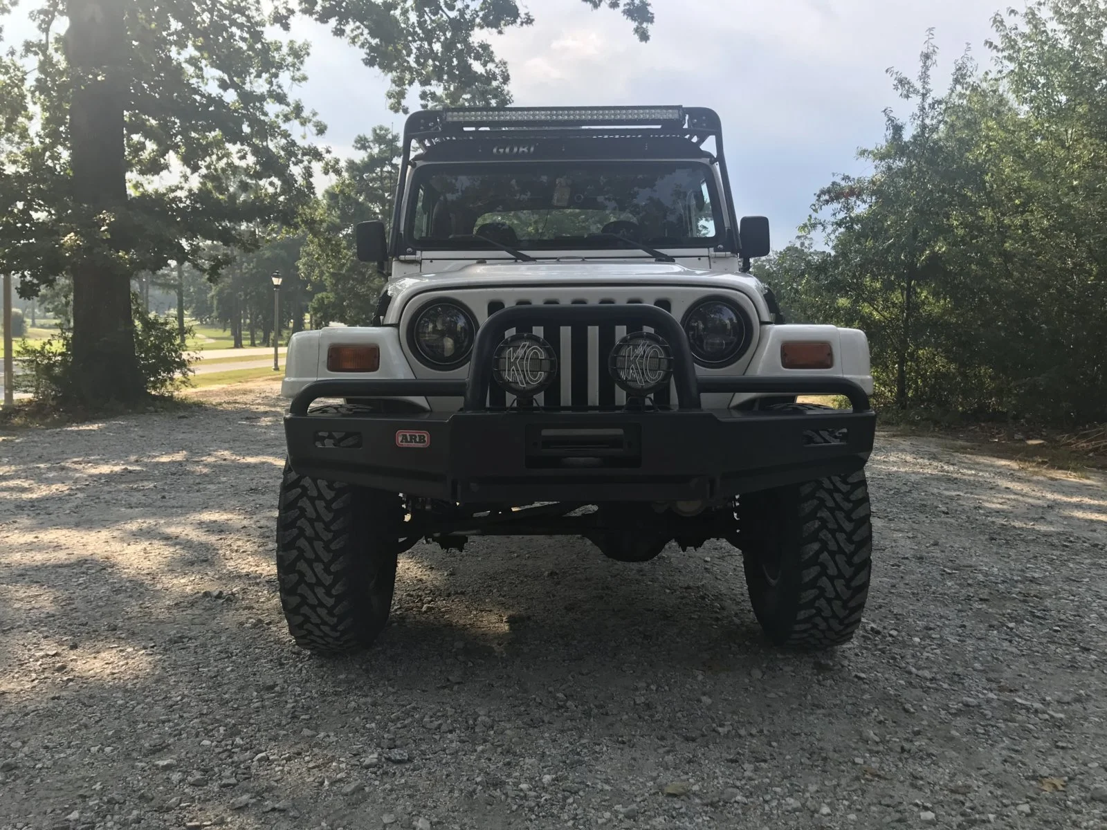

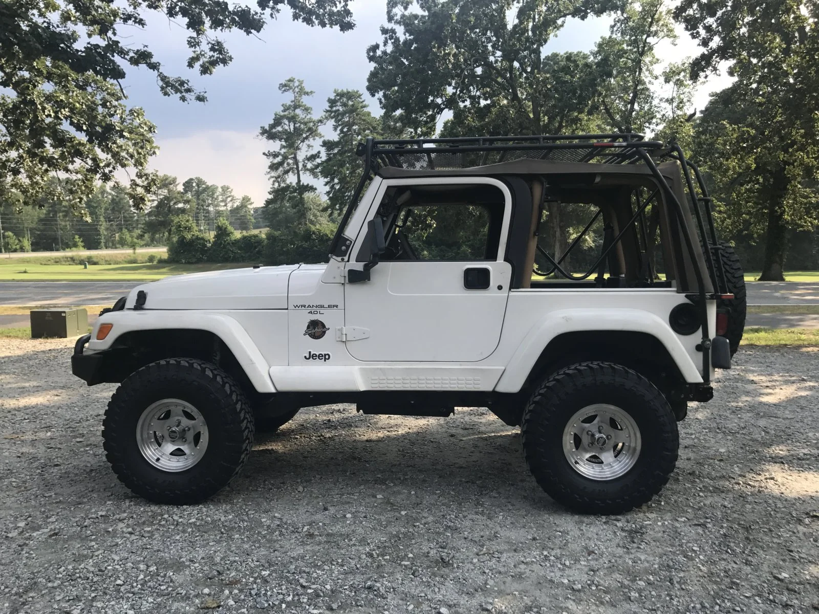

Another update: Ordered the MC rear track bar & picked up the TJ. The clutch is significantly lighter so its going to take a bit to get used to eliminate all jerkyness. The Jeep rides like a dream though getting her home. Glad to have her back and hoping to hit some light trails to get used to her pretty soon (Some heavier trails when I actually get some recovery points & take a journey with the mates). I took a couple more photos on the way home:
View attachment 19215 View attachment 19216 View attachment 19217

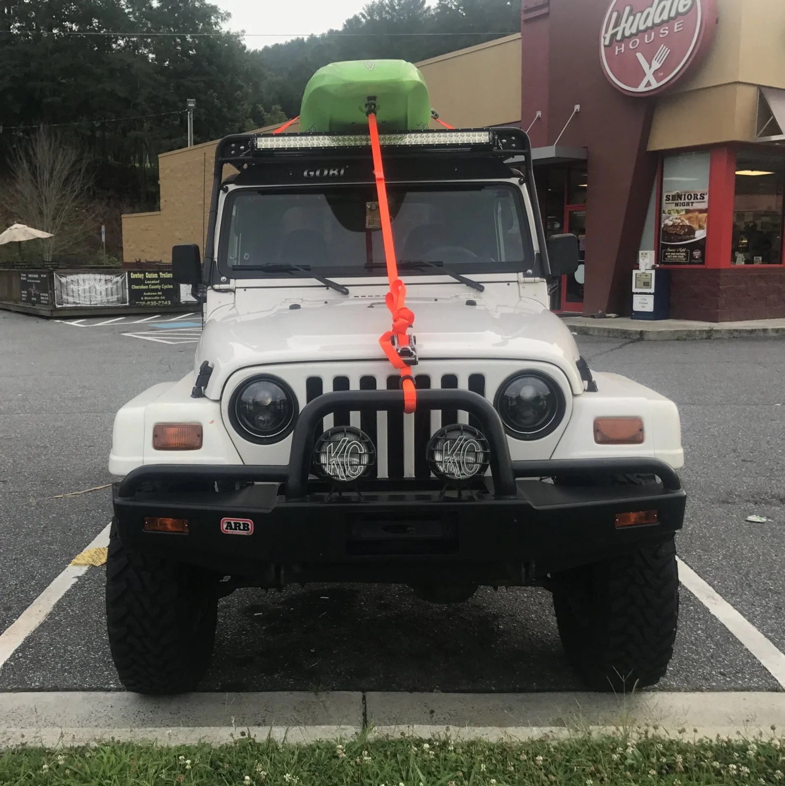

Well just drove up from Florida to Tennessee/North Carolina border for a white water competition and wow. 3.07's on the interstate are much worse than I initially thought for very long trips. Also, I always try taking out the carpet to see if I can live with it in the front seats and Its always a wash, man these things heat up after 8 hours of driving. The tires at full tread really don't make that much noise with the soft top/hard top on, however I am sure as soon as they start wearing they will whine & drone. After math I averaged about 10MPG traveling 60-65 mph in 4 gear nearly lugging the engine. Let me just say after I buy this rear bumper & a winch for the ARB bumper, I am solely dedicating my time finding a proper 8.8 & hp30. Going to try to find both of them at 4.10 gears for the 8.8 and 4.11 gears for the HP30 so I can immediately get the brackets welded on and installed. The HP30 is a fairly straight forward with the 8.8 requiring more fabrication. Will probably run both stock driveshafts with an adapter until I can properly do my SYE/CV. I am anticipating needing to buy the control arms the before I swap the axles so my measurements are correct and its easier to line up. Soooooooo going to need a job when I get back to the university to finance these. Once the axles have been installed I will work on regearing 4.10-4.88/lockers/driveshafts/tt/brakes/steering upgrades. In the mean time I will do some group rides on some local trails once I have proper rear recovery points & some solo trips once I have the winch installed (You know some photos of a jeep doing jeep things not just driving around ;) ). More to come, but heres a photo from todays haul:
Nantahala here we come!
