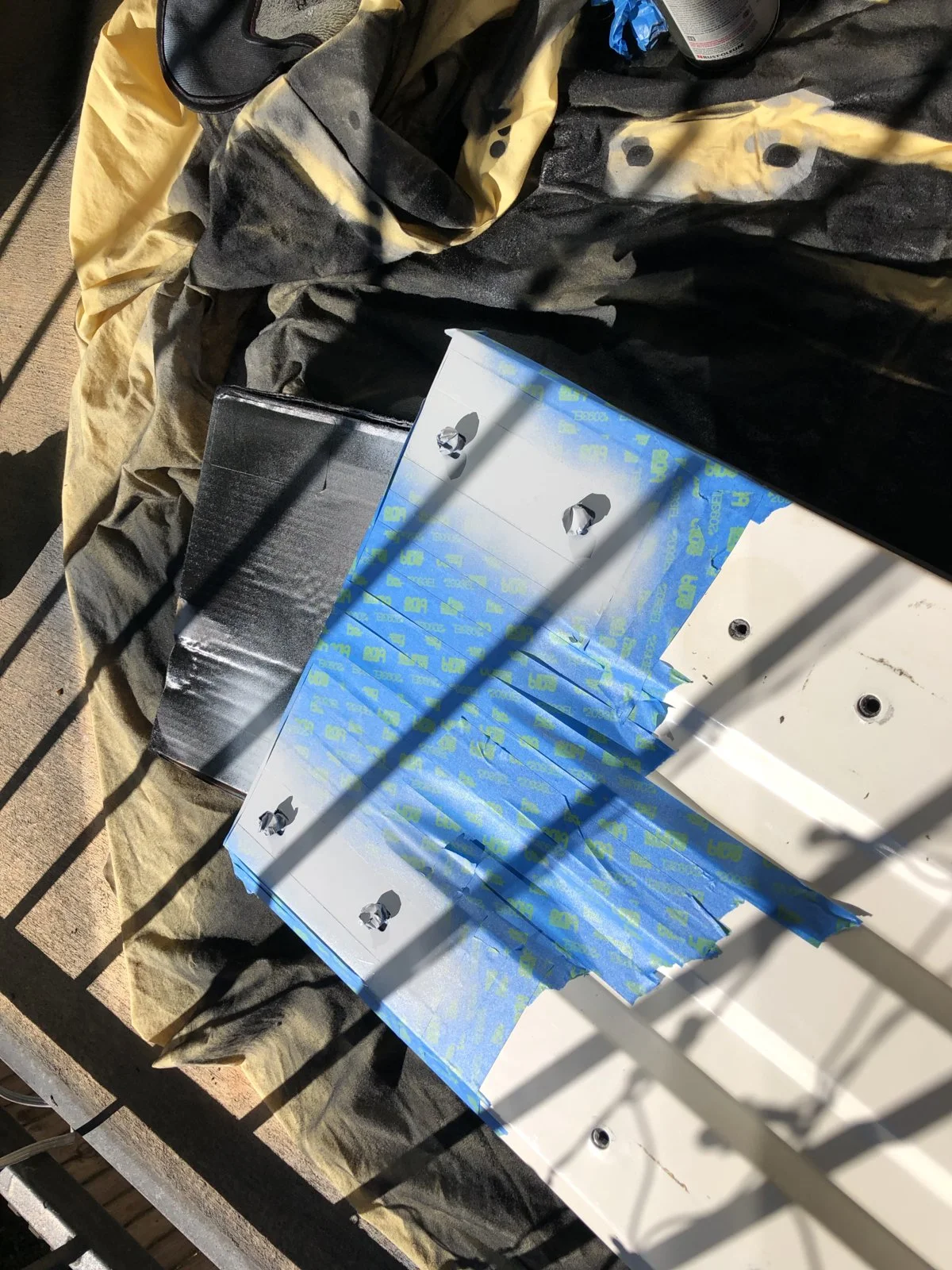

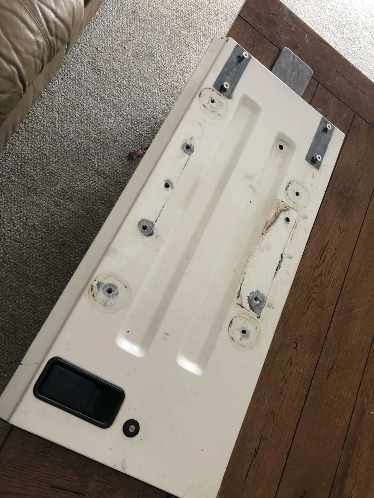

Prepped tailgate for paint over bare metal:
Prepped hinges as well:

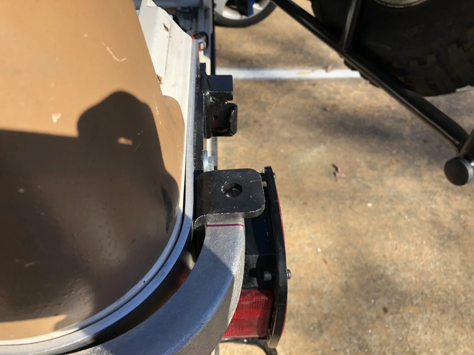

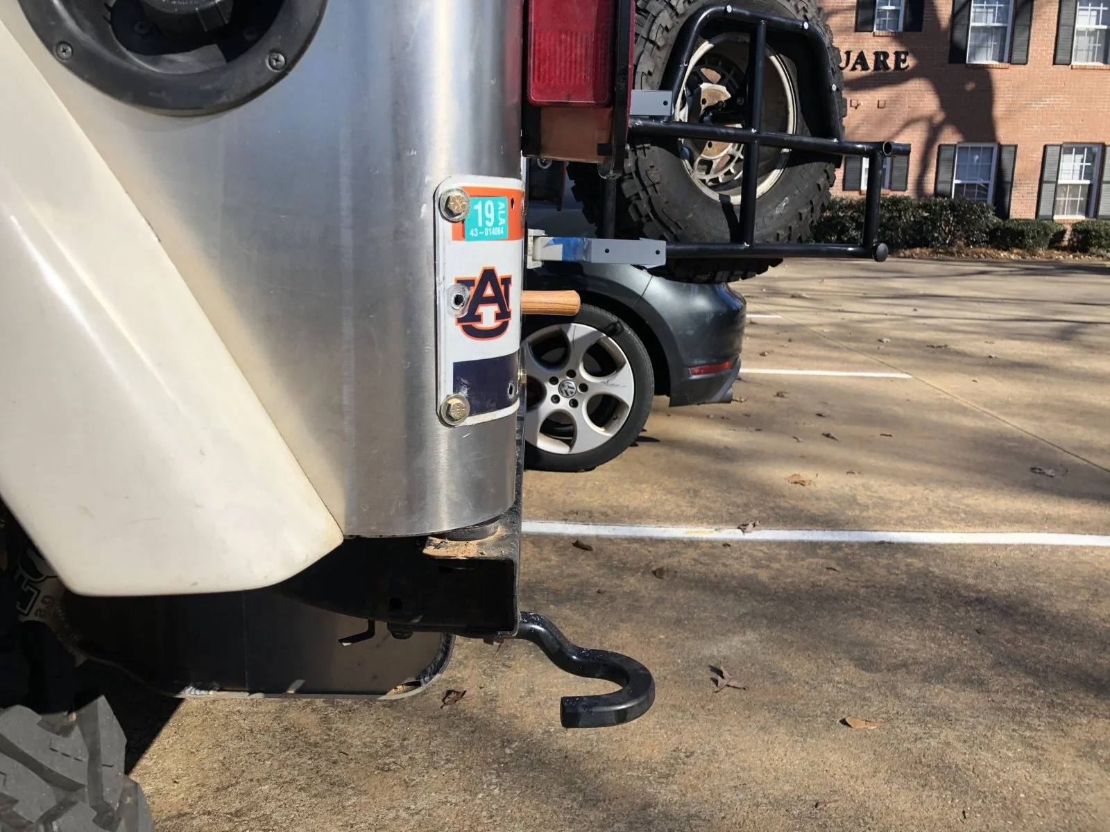

Marked the trim line driver side:
Marked trim line passenger side:

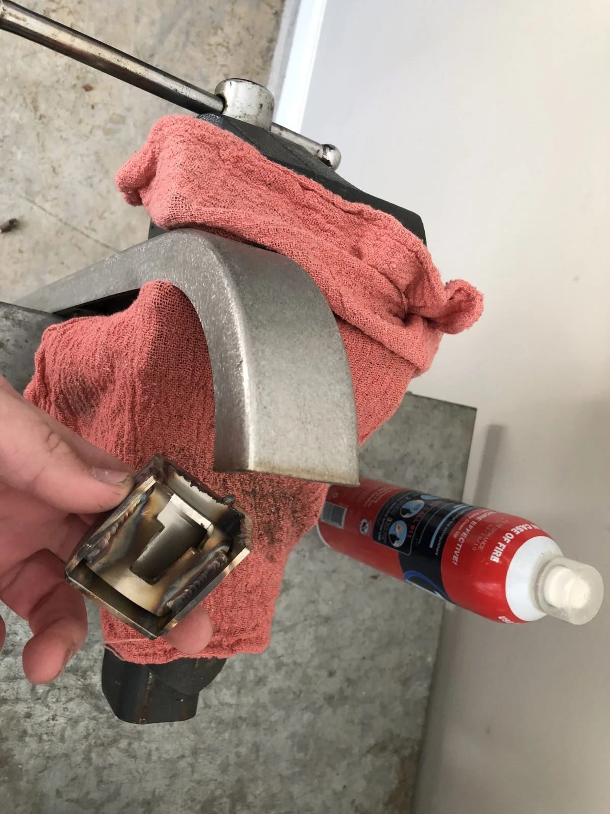

As you can see I will lose both mounts sadly:

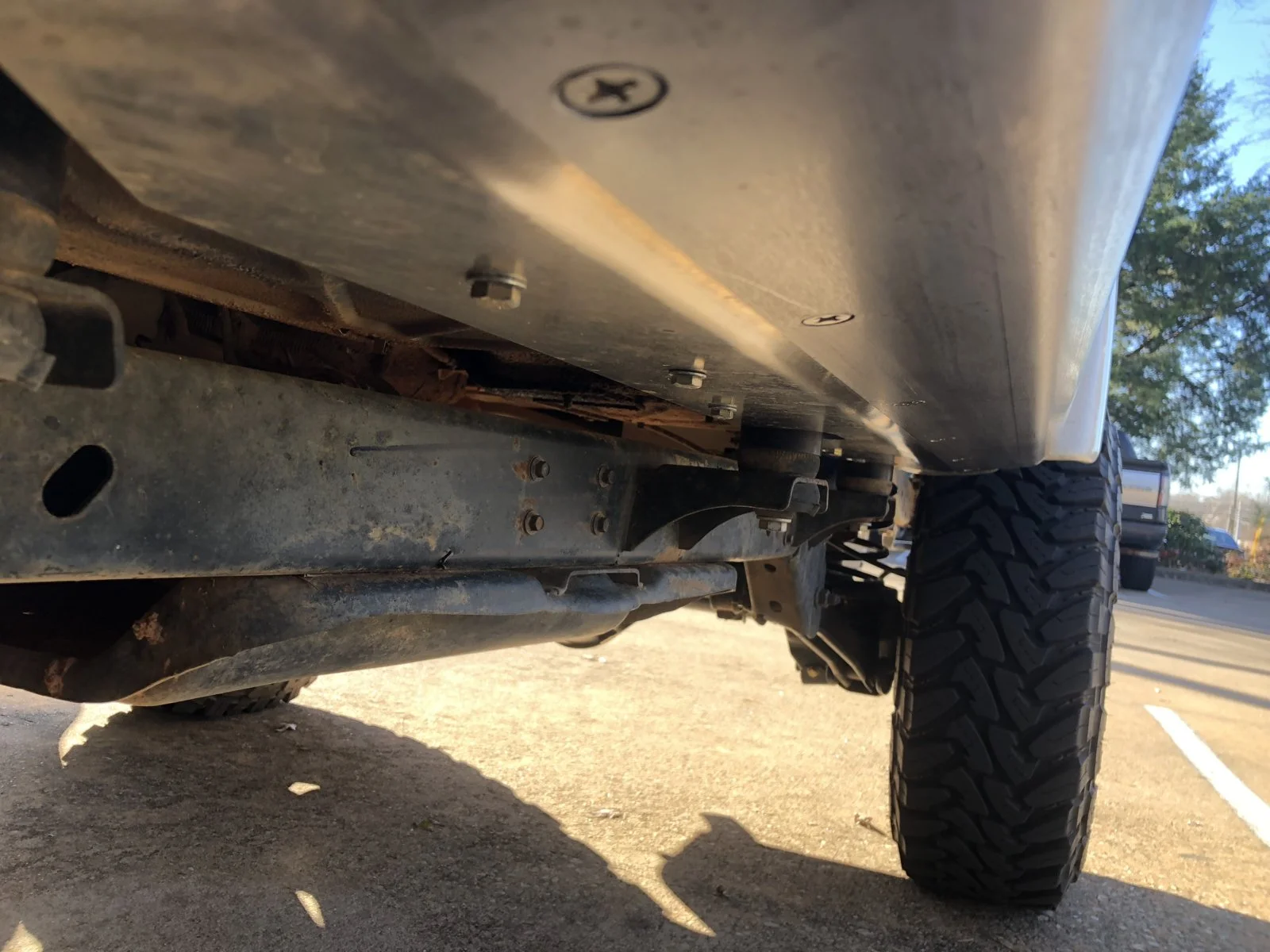

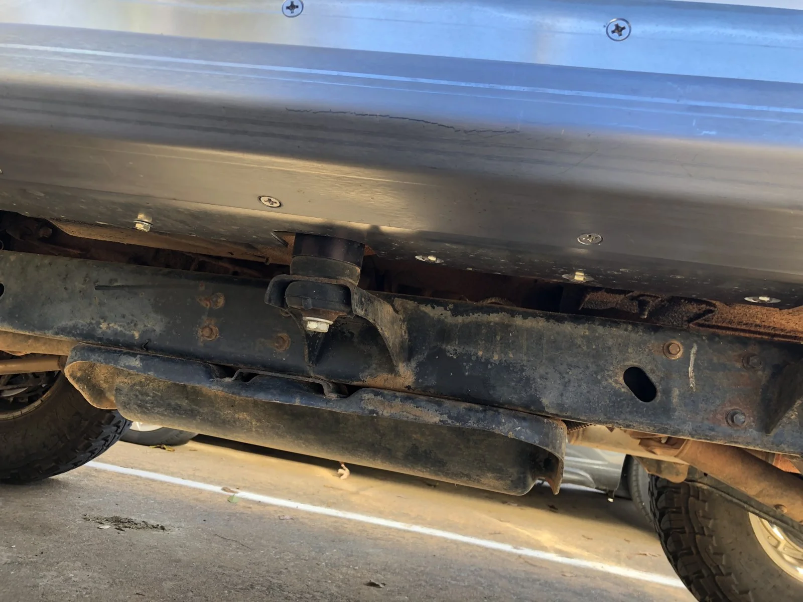

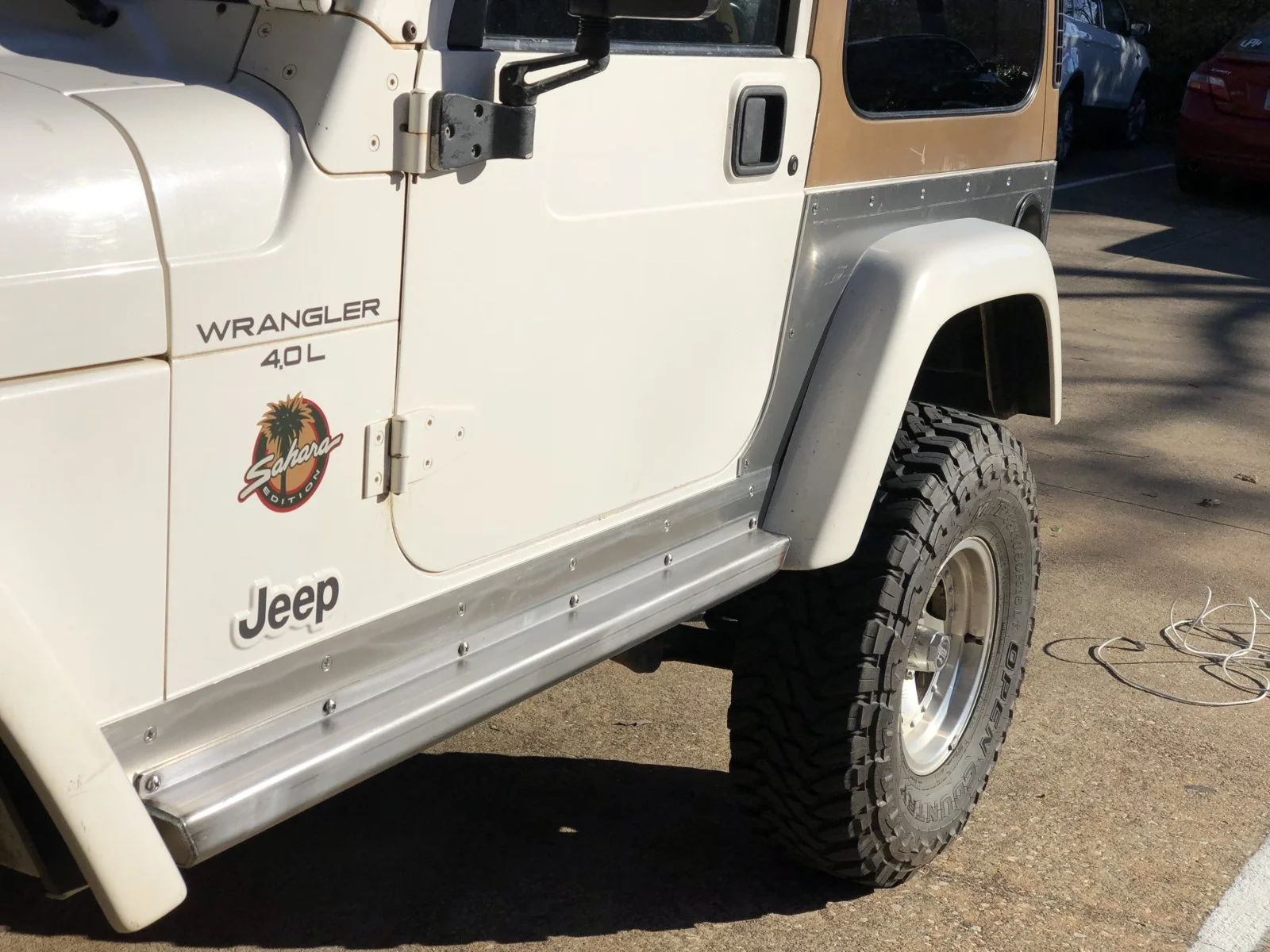

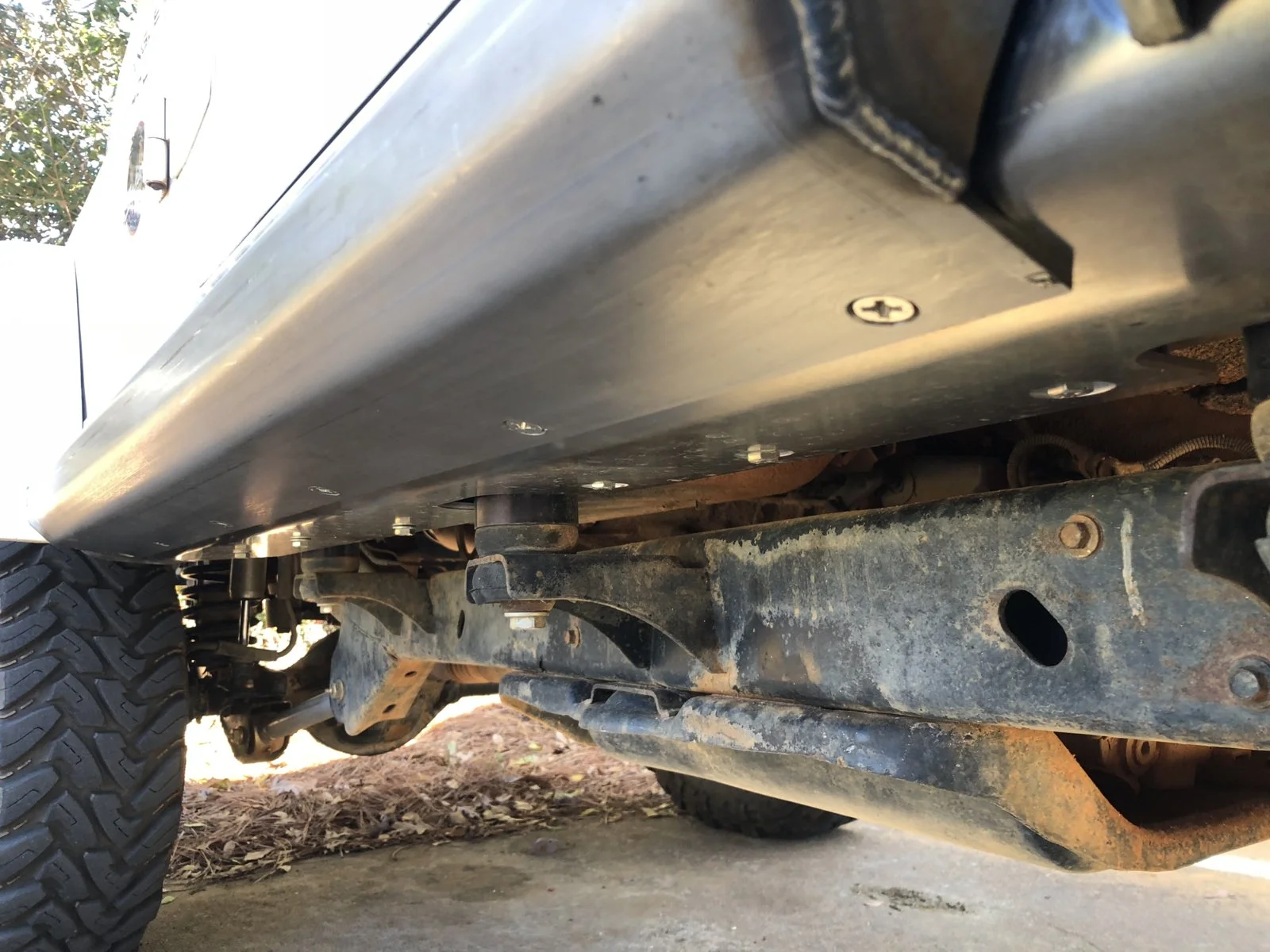

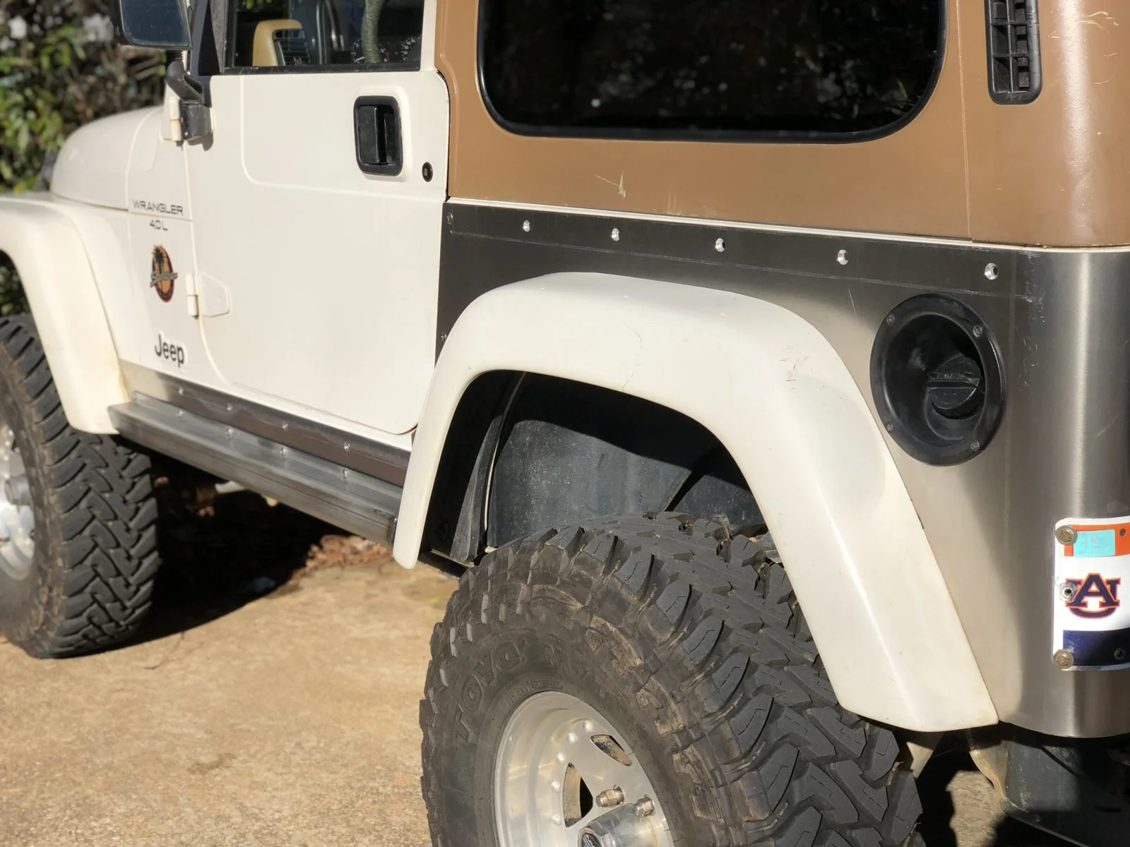

I put these in the slider post but these products are well deserving of more photos in the build thread, god knows I haven’t seen too many. Here are some photos of the slider side you don’t usually see:
I will let you guys know I am slightly nervous to see how the step and rub rails hold up being stainless steel. I had to clean them up with a sanding block and then apply sharkhide after install day. We’ll find out the next rain or so. I will let you guys know the longevity of the metal protectant for sure.
Sure does look good though :D.
They use that sharkhide stuff on Pontoon tubes, right? That is a much more harsh environment that you step sliders. Moisture is a killer...
For sure. I’m more than confident of its ability on protecting the aluminum. Its more the stainless steel than anything, salt and rain broke the Cr layer fairly early. Hopefully the sharkhide keeps it safe.
Easy day today!

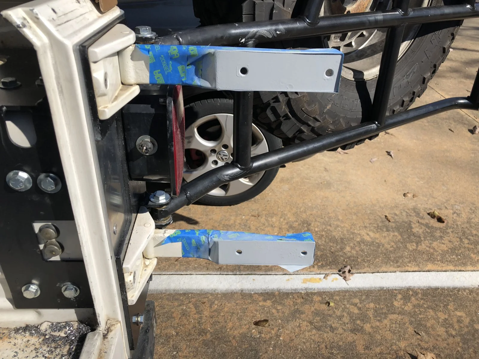

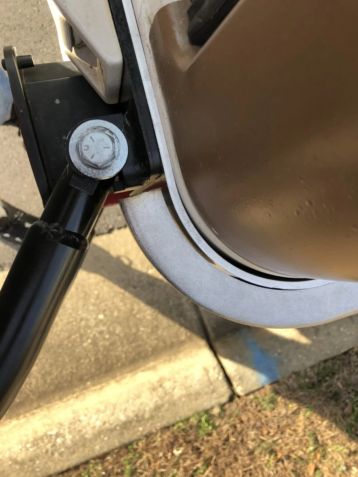

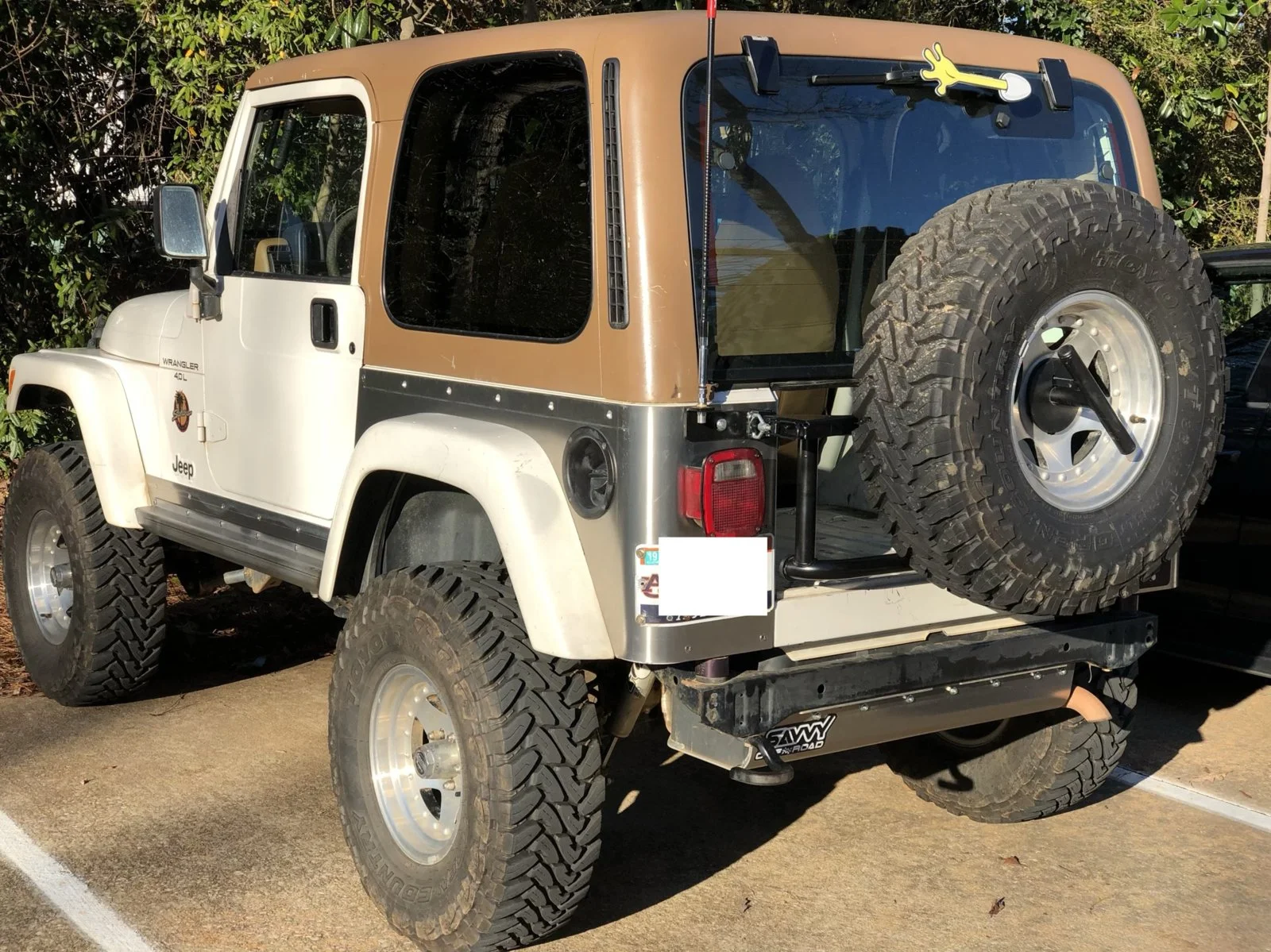

A little on the GTS too ;)
Not 100% finished but dang she is looking good!

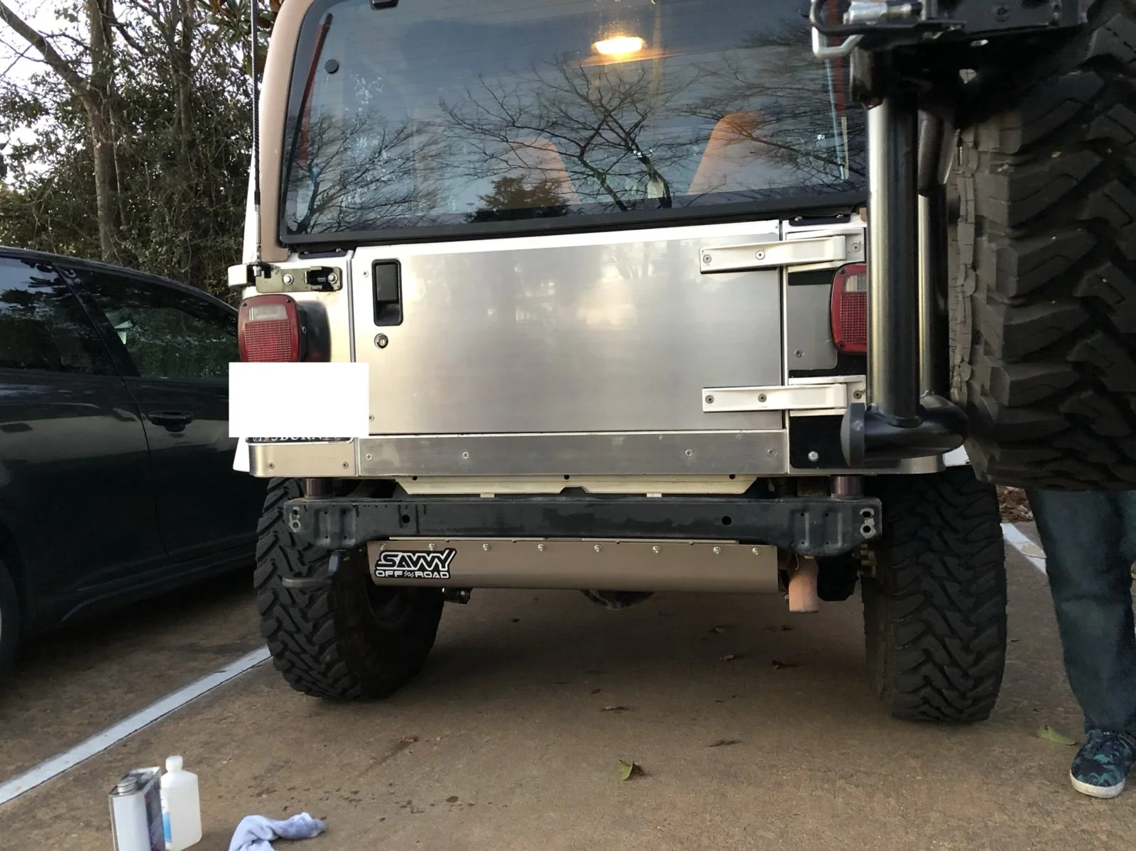

Lots done today!

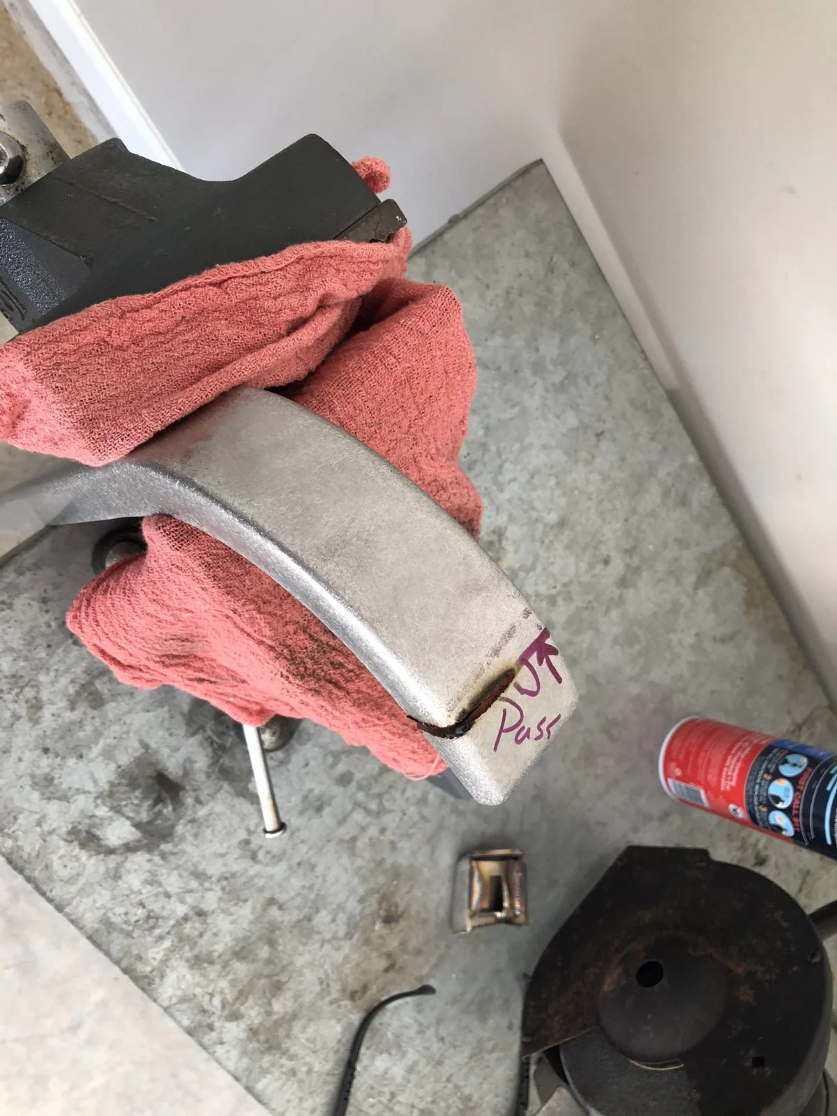

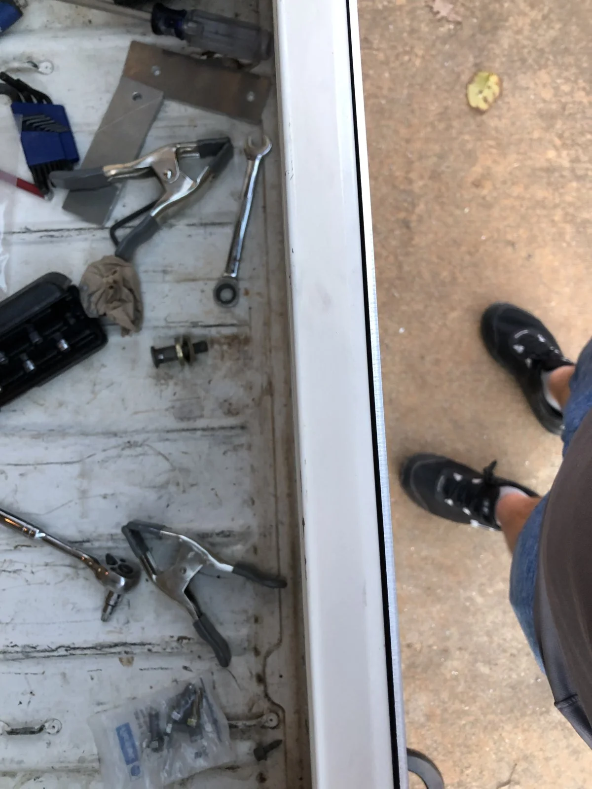

Barrowed my friends shop to make some cuts:

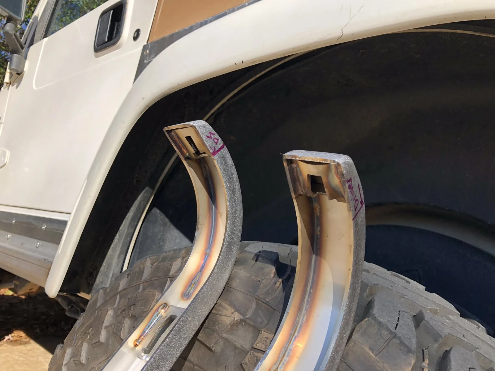

Mounted rub rails (I will need to use some heat and coerce them in the future to get them to sit flush):

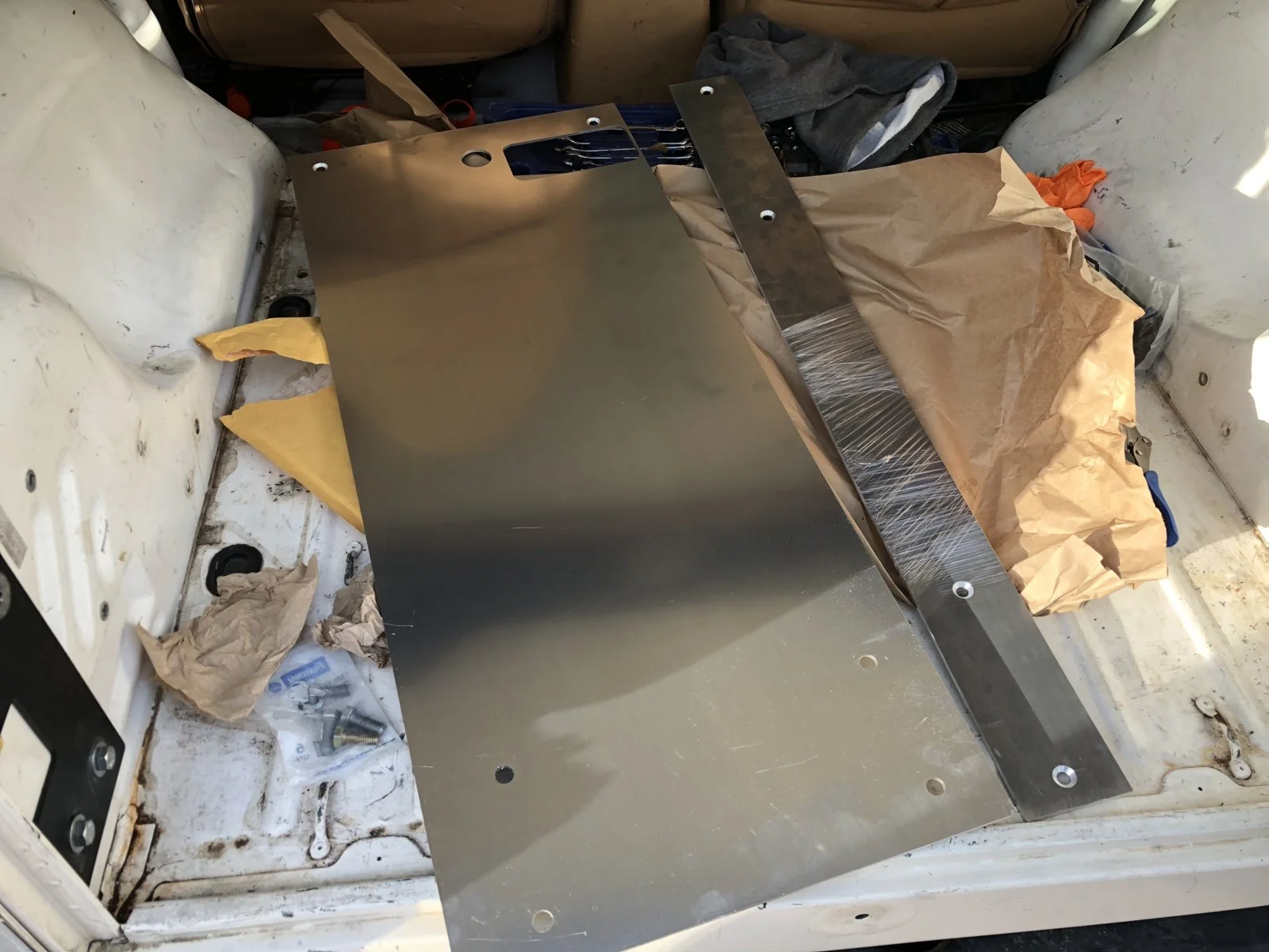

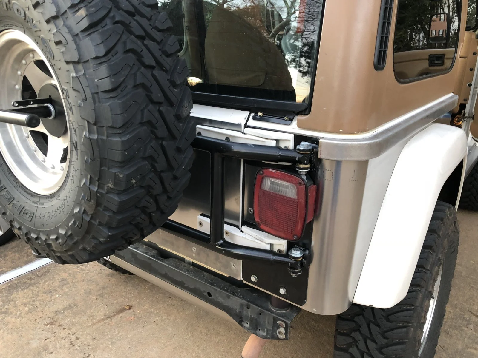

Got a nice box today:
Both materials received:
Mocking up mount:
Holes aren’t even close to being correct with hinges mounted:
Nutserts installed, I’ve gotten really good at them:
Pre-installation mock-up:
Hinges and bolts installed:

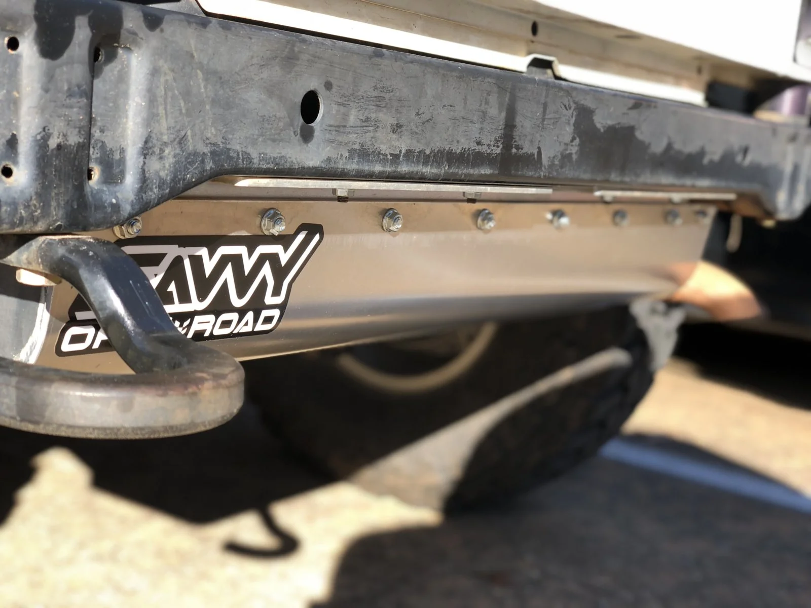

Valance holes drilled and nutserts installed:
Valance installed:

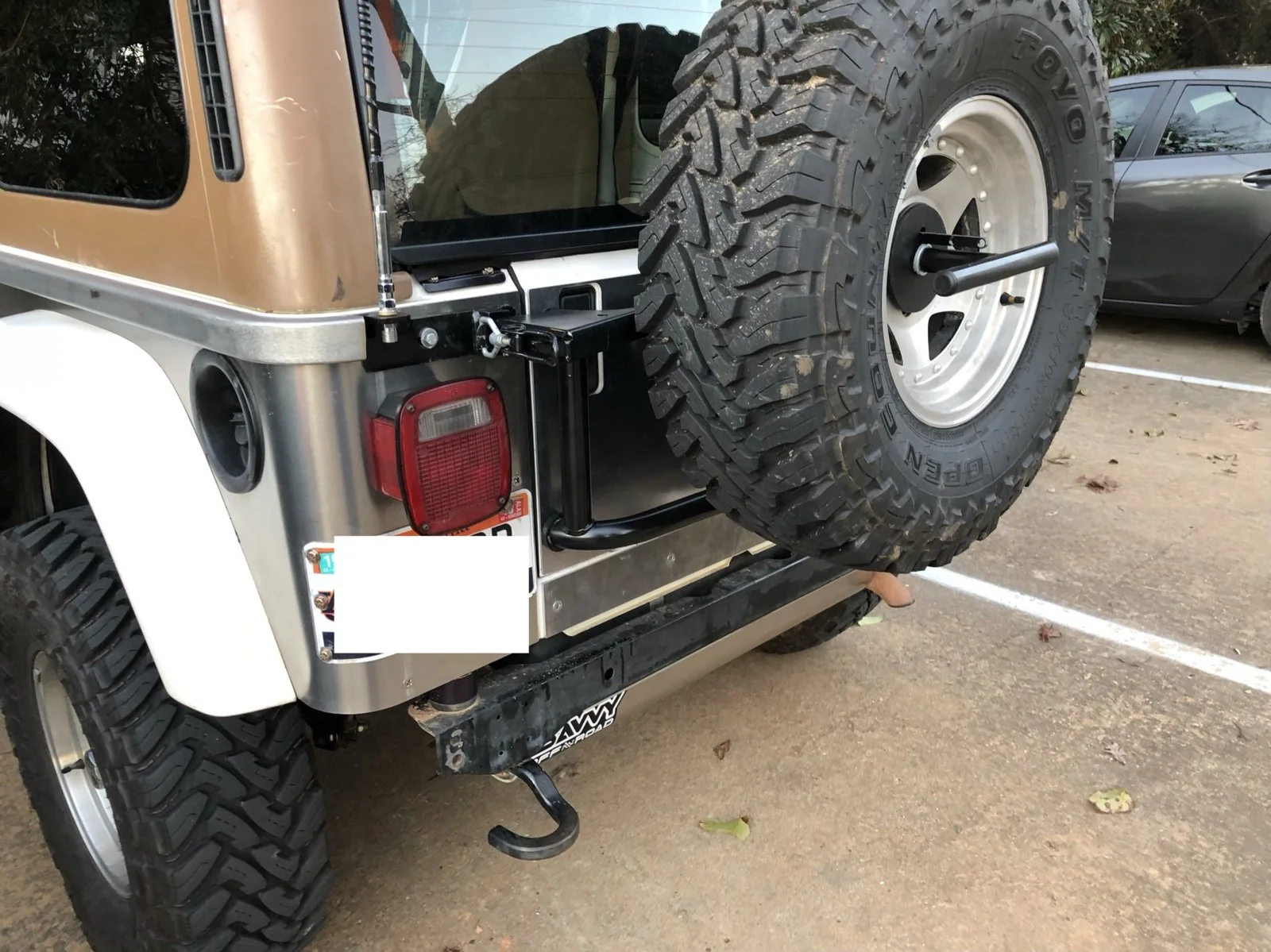

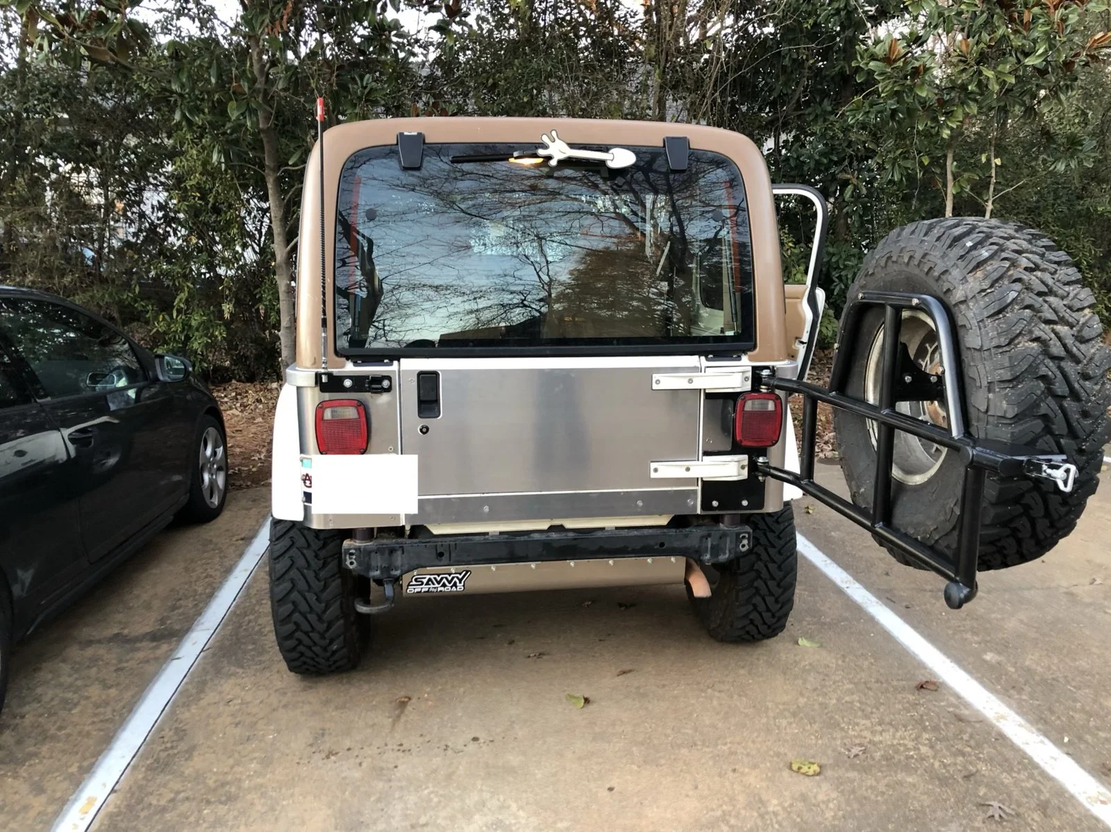

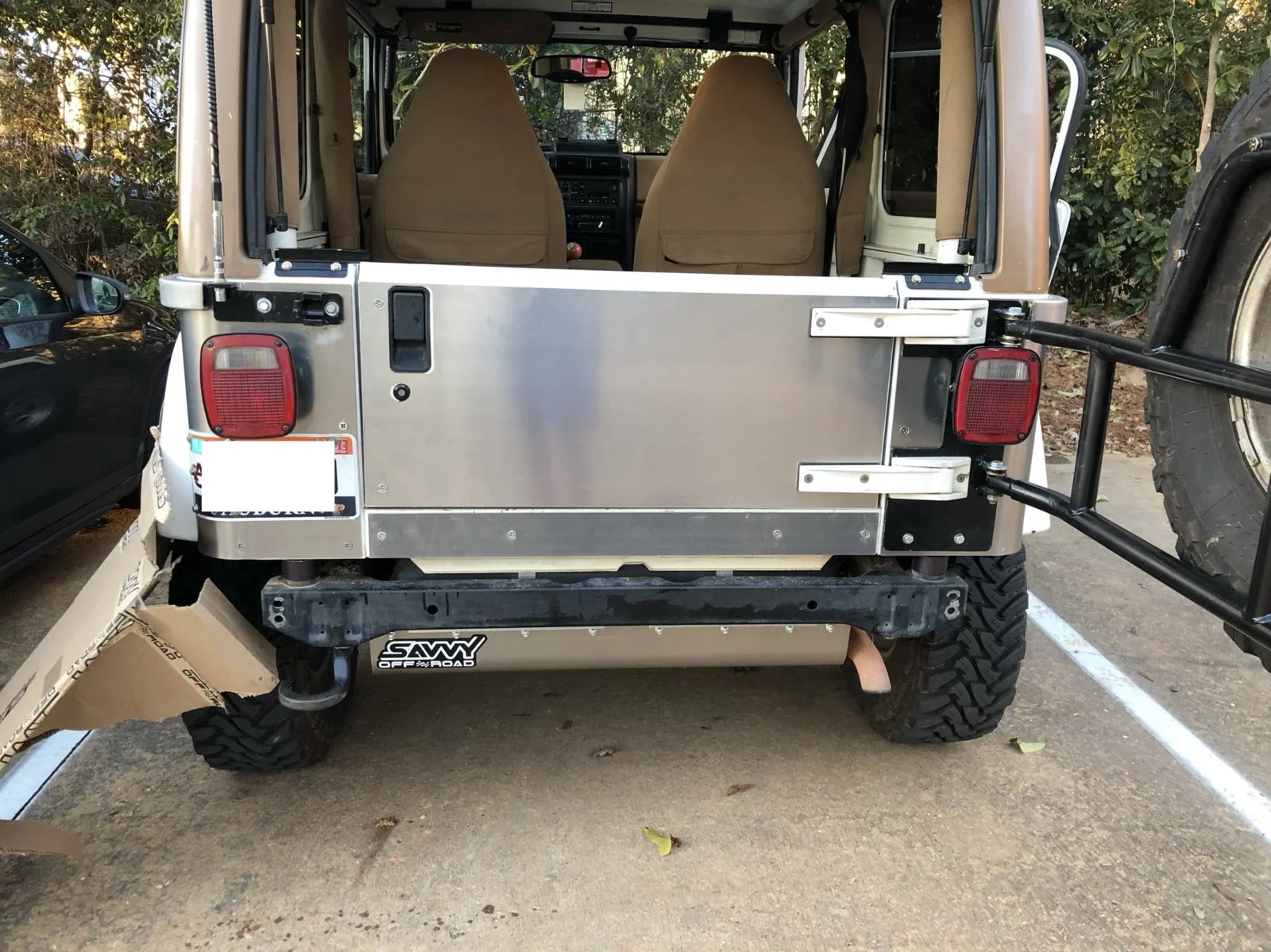

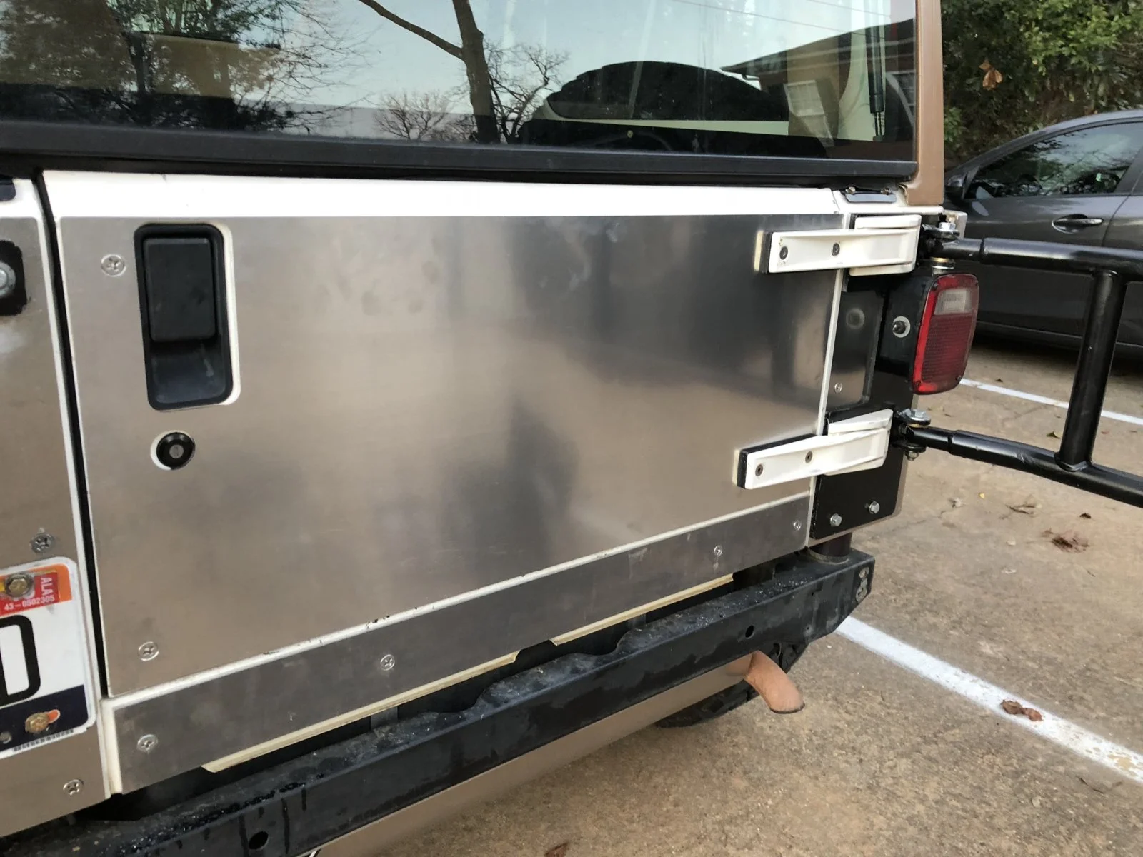

There really should be some center mounted holes to hold the tailgate piece on, it bows and needs the support:
Another view:

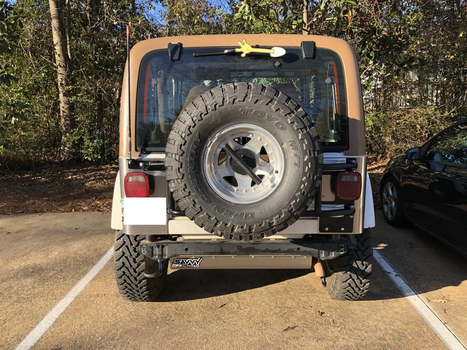

The aluminum used on the bottom piece is noticable different, I called Katie at Savvy Offroad, she said it could just be corroded, sigh:

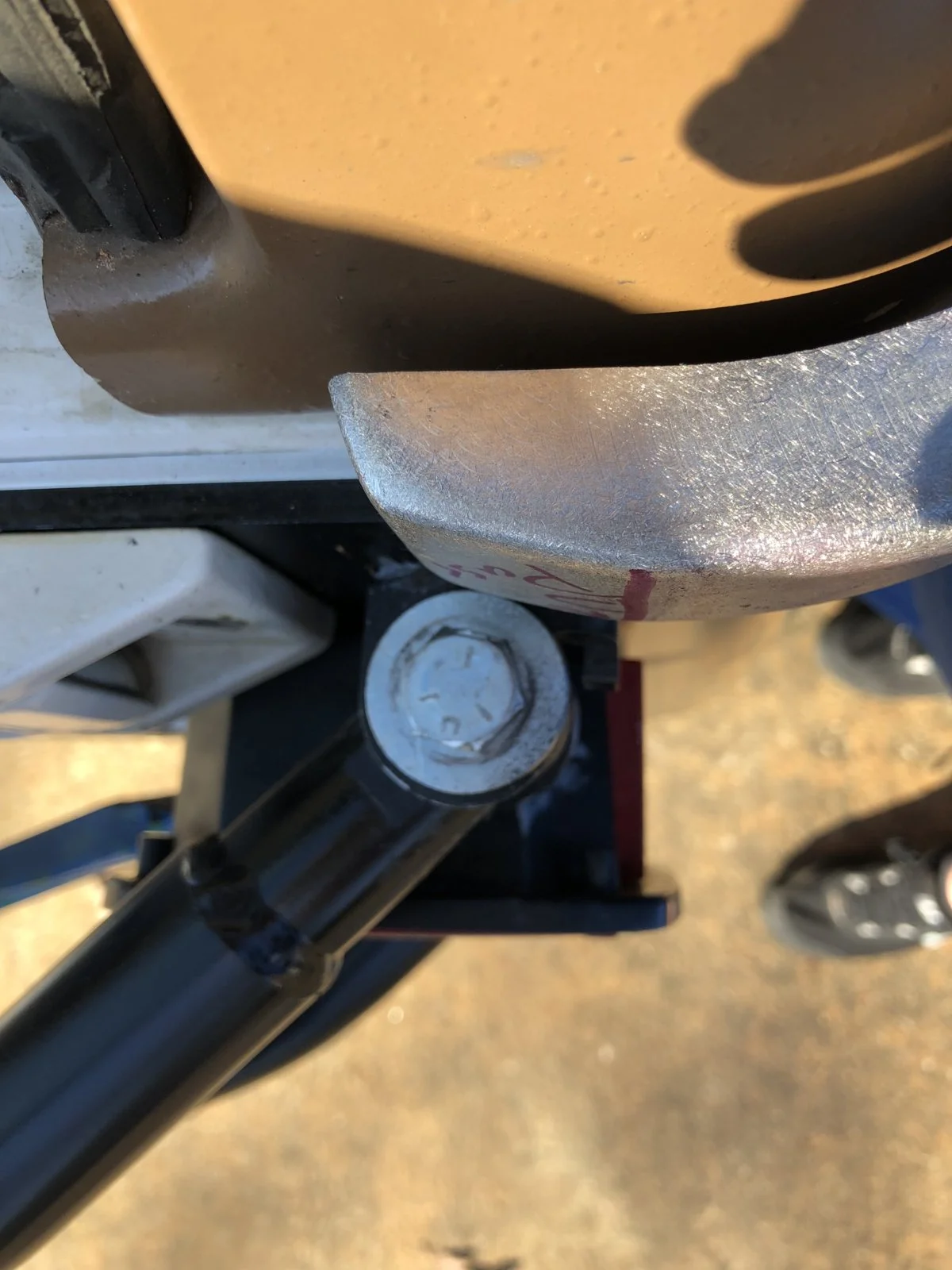

Sharkhide installed:

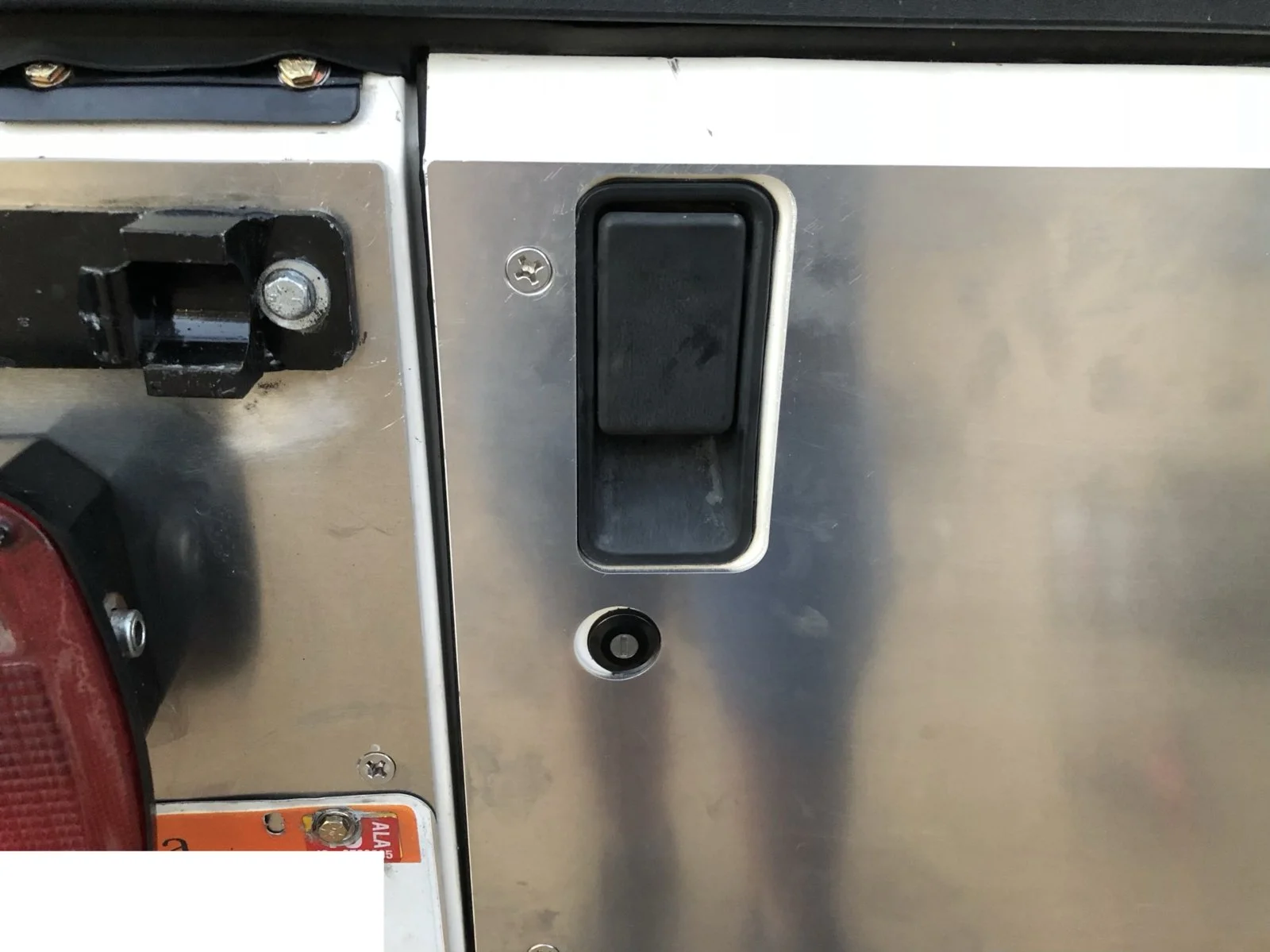

Holes aren’t even close to lining up, same as the corner guards:

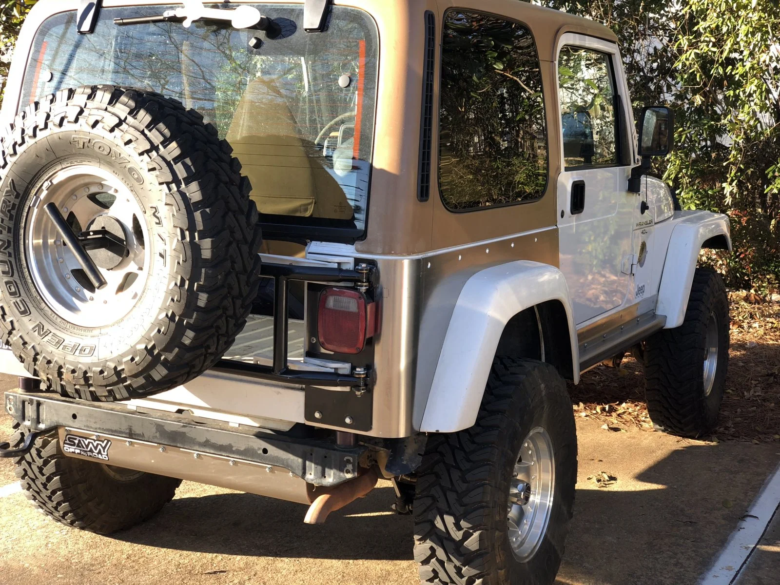

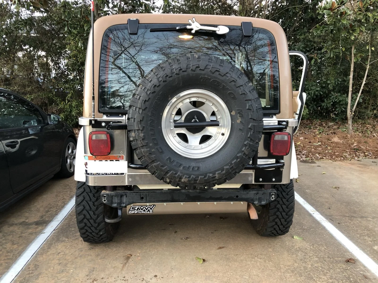

It looks dang good:

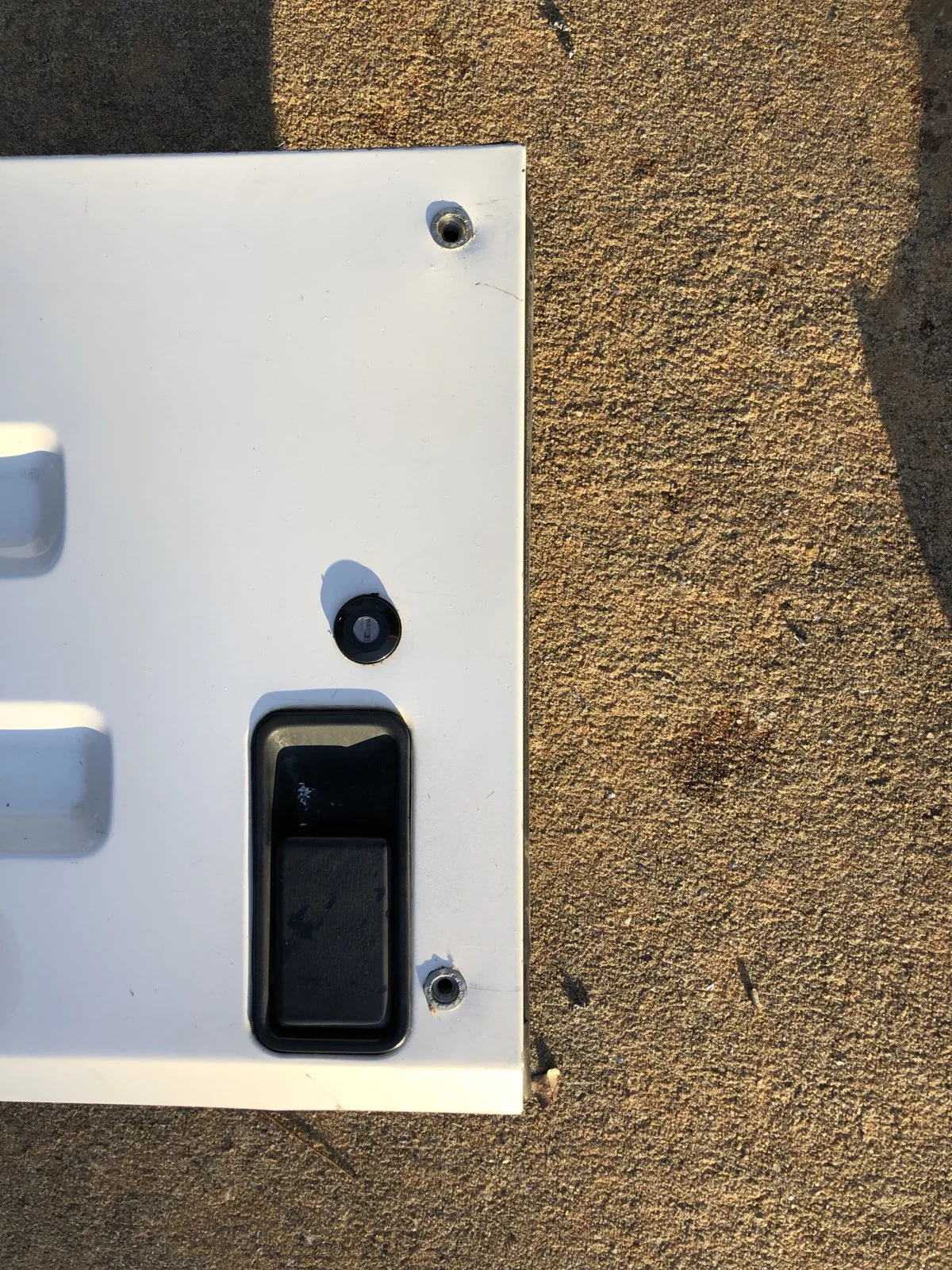

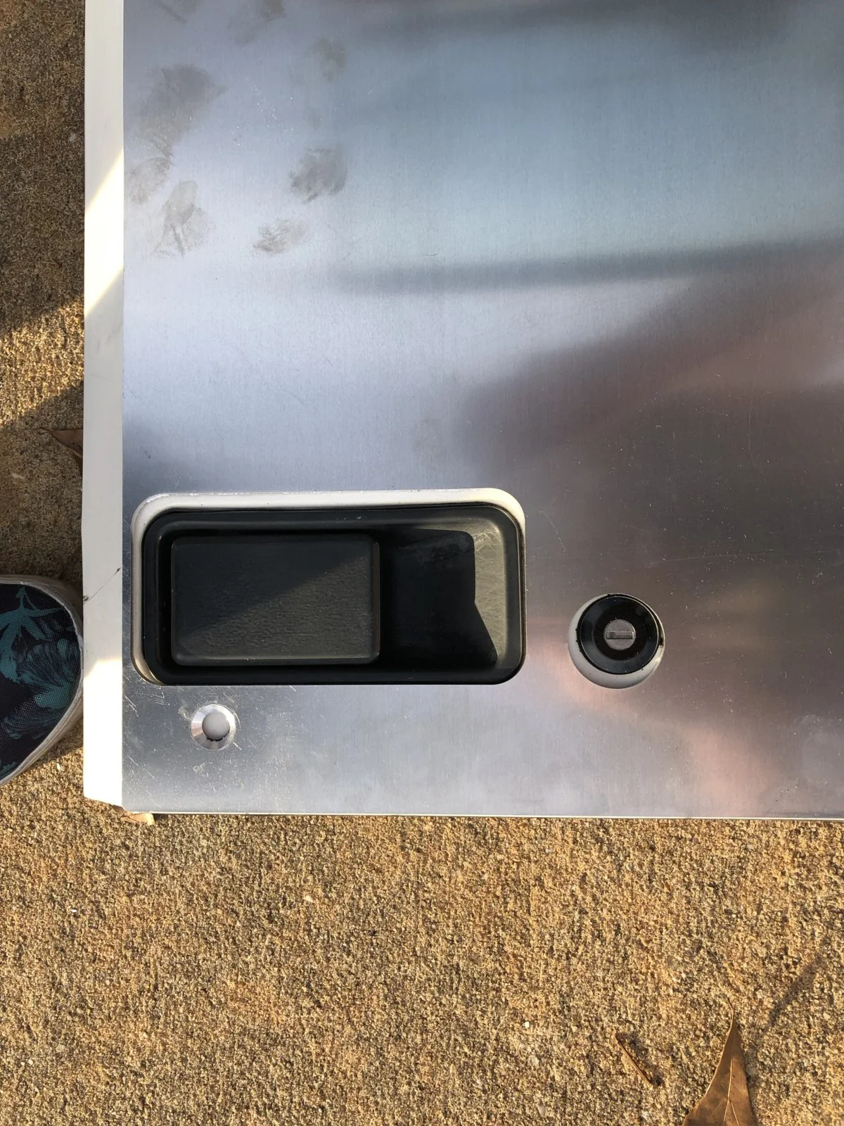

Some final notes: The holes for the tail lights, tailgate hinges, key slot, rear tailgate handle, and license plate were not even close to lining up. All of the holes either had to be wallowed out, re-drilled, or presented to the public post installation.
All of the corners were pretty badly bent. Its ok because post installation the body reshapes it to follow the corners.
The current tailgate valance appears to be a subpar quality. Katie says its the same material as the others, but you can clearly see it vastly different in texture, quality, and ability to be cleaned up. Every other component looks fantastic minus the valance.
The tailgate valance is advertised to say savvy offroad engraved on it. Being quite honest I only purchase it for that reason. Katie at Savvy says they recently switched manufactures of the pieces so that is why my valance piece didn’t have Savvy engraved on it. I sent her a request to exchange it for one that did have the engraving and awaiting results.
I’m not trying to complain about these things, really happy with how it turned out. I just want the product to be perfect and thought the things wrong with it with easily avoidable. Hopefully I can get that valance exchanged.

Wow...I'd be really ticked about the misalignment in the clearance holes. You dropped some serious coin there...I get that each tub is going to be different, but that is where you design a relief all the way around, so that it doesn't detract from the whole install. They've still got some things to learn over there at Savvy about finishing...Good design can be ruined by execution so easily.

Over the past couple weeks I haven't exactly what I would call the best experience with Savvy. From the lift kit shocks being poorly thought out, to the misaligned holes/missing tailgate spacers I really hope they swing this ship around. I buy quite a bit of their things because I can see the passion Blaine put into the products. He identifies problems & creates elegant solutions. The same reason I like supporting local companies who put their sweat and effort into things. I'm a reasonable guy and can deal with mistakes, across both corners/tub rails/tailgate armor the holes were misaligned. I can deal with that, fingers crossed the valance works out.
Really surprised to say the least. I read great reviews from veteran members like @Jerry Bransford and @Chris on this forum when it comes to Savvy’s product line. Ive read plenty of post about their superior build quality and attention to detail but no real hires shots like I am seeing here where I can see actual product in detail. Any idea what is going on at Savvy? Seems like the latest photo evidence doesnt match up to the verbal praises I have seen here on this forum in the past. Rub rails not being straight or following the natural rear body curve, a majority of the holes not lining up, missing hardware, missing parts, missing mounting brackets, and so fourth. Seems very odd. Maybe its just a few bad batches that snuck through that @JamesAndTheSahara has recieved thus far.
I can't discredit the rub rails because the bend is taken care of by the bolts being snug, with the corner mount removed its up to me to make that one work. I'm happy with the end products, just concerned why certain mistakes were made. Again, hoping I can at least get the valance taken care of.
Reactions: ac_ and Fouledplugs
Agreed on the rub rails, that's on you. the hole misalignment would bother me, but not a deal breaker for the amount of variance a TJ has. not making excuses for Savvy. We need comparative evidence.
