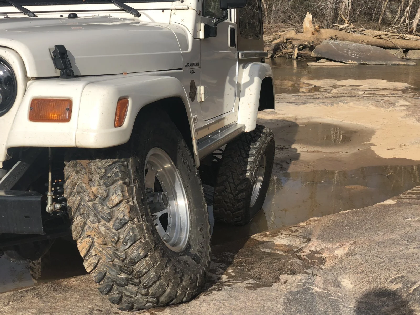

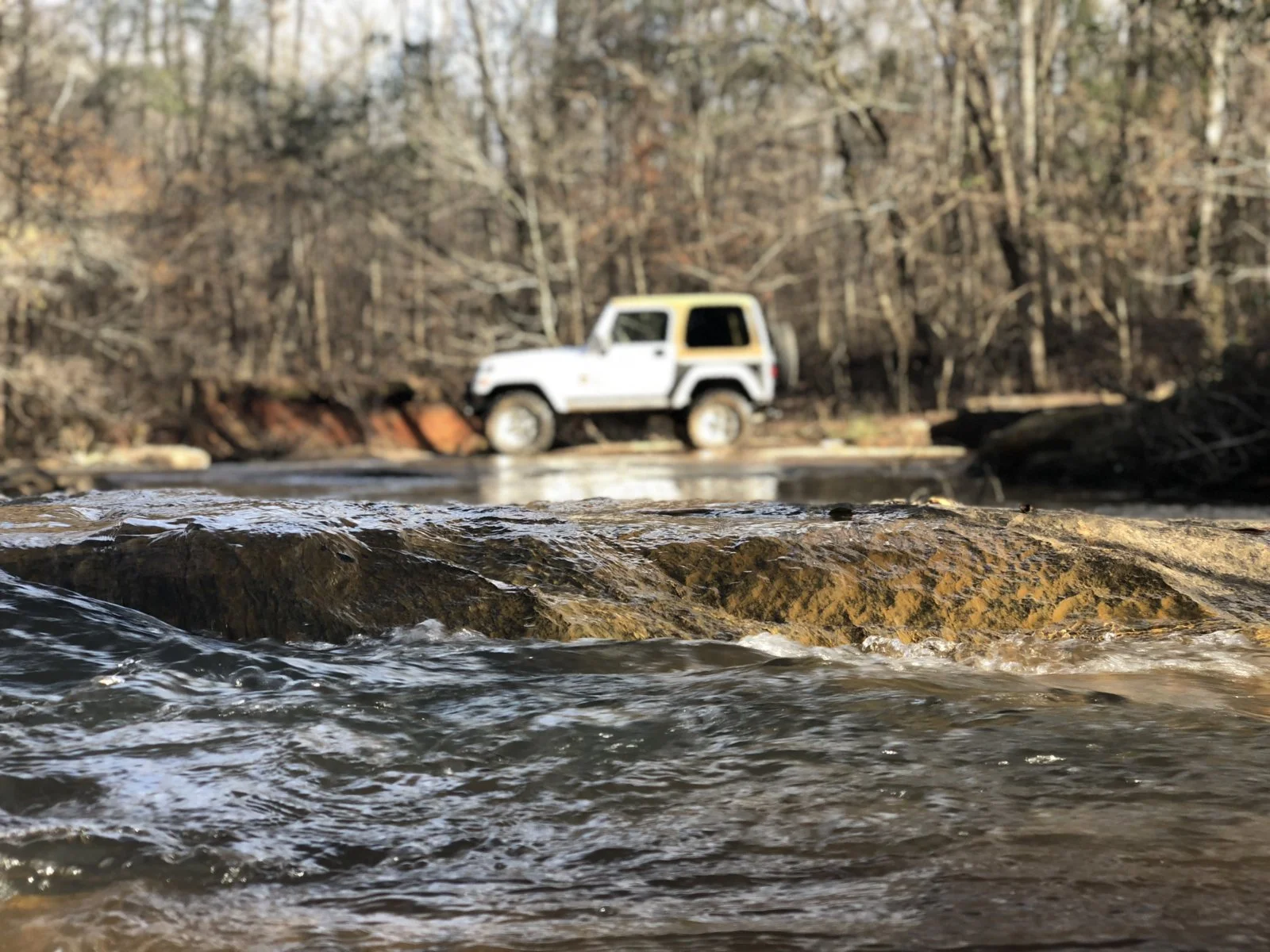

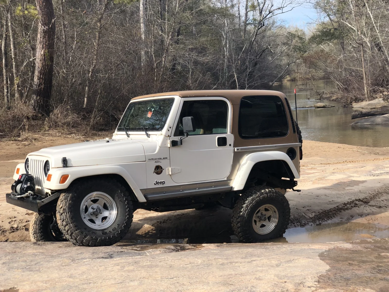

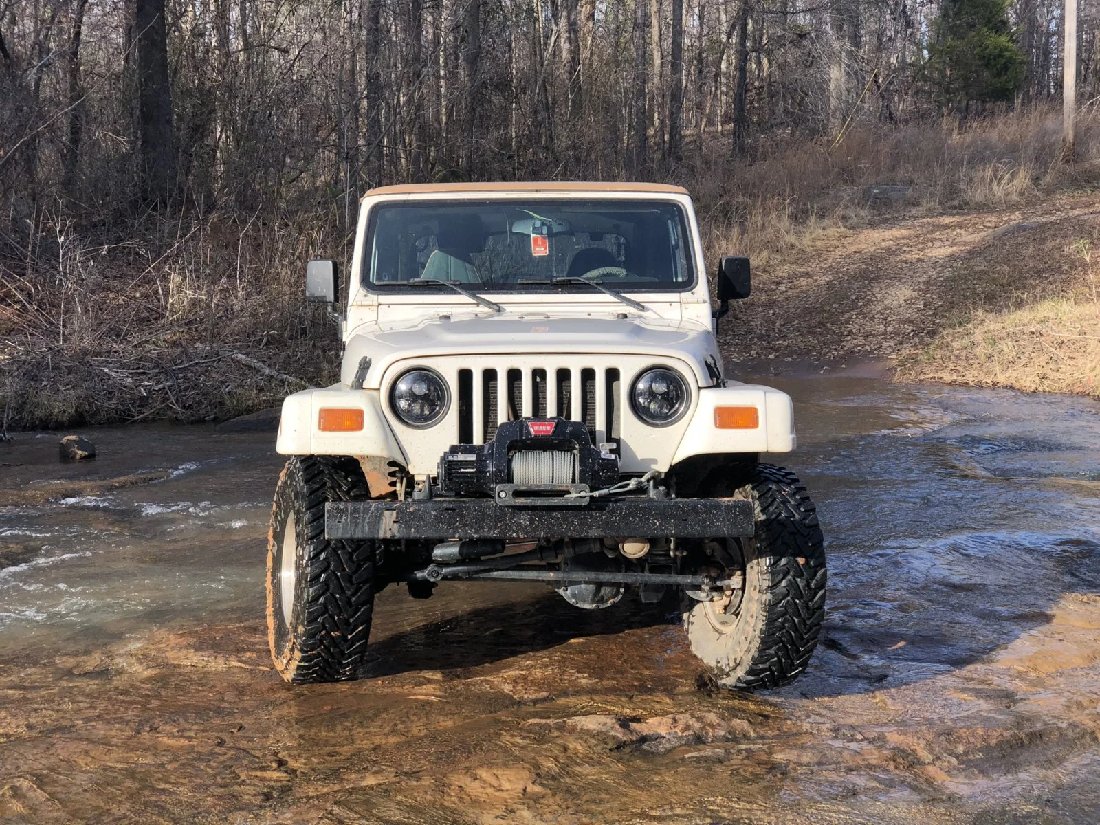

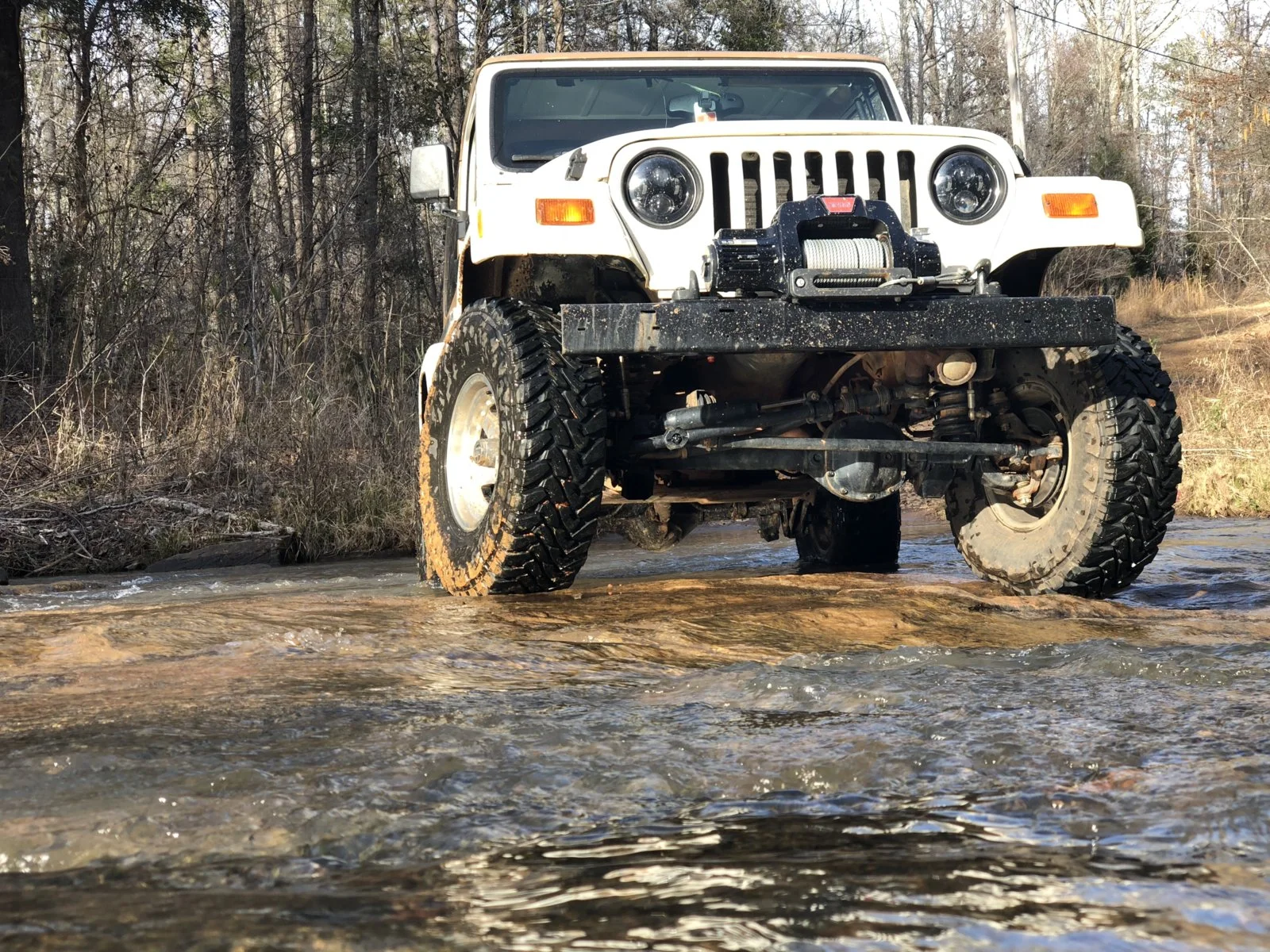

Well it was a solo wheeling day, so didn’t get too crazy out there. Hoping I can do some serious wheeling soon:

My stainless steel step seems to not like the elements very much. It continues to form surface rust spots even after cleaning and coating it. I may be pulling it off to paint it. Very tempting at this point to also pull off the rub rails and paint them black (As a safeguard in the event it starts to go too). I’m not worried about the aluminum... the stainless steel I don’t exactly want to be fighting forever.

Have them cleared.
Nice poser shots brah! rattle can clear would work just fine and make touch ups easier. Just scuff with a grey Scotchbrite pad, clean, and throw a few coats of clear on.

Well I called up the local PC shop an hour away, quoted $250.00 to get them powdercoated in clear. He strongly reccomended I powdercoated it in silver because after blasting the stainless steel (required for them to powdercoat, even ar bare metal) it would not look the same. Leaning more towards pulling them & painting them in rustoleum clear or black.
I appreciate the comment JB ;), sadly weather won’t permit a trip to a location like morris mountain this weekend :(. Would it be better to just clear coat the stainless or prime-paint it black? I’ve never had any great luck with just using clear coat, but willing to give it a shot.

The sheen of the stainless might look a little different than it does now as a result of scuffing it to create some bite for the clear to stick to it, so maybe black would be a better choice. Black accents on a white jeep just plain work IMO.
It's you like it stainless color, give clear a shot. If it turns out you don't like it, or it doesn't last, it's easy to paint black at that point.
Not so easy to go from black to clear
If you you guys think it will hold up I’ll give it a shot. I bought some extra nutserts as blaine shared a fantastic idea to make it easier to pull the steps on and off.
I’d paint them silver and then clear or black. Your wheels are silver, your tires are black. It’s a tough call. Actually been thinking about what I would do if your Jeep were mine since you put them on
Well my ideal rims will be a dark grey. I don’t like silver or black rims on my rig. Its between clear and black on them. Going to give clear a shot and see how it holds up. Scotchbright and quality clear coat sounds easy enough.
