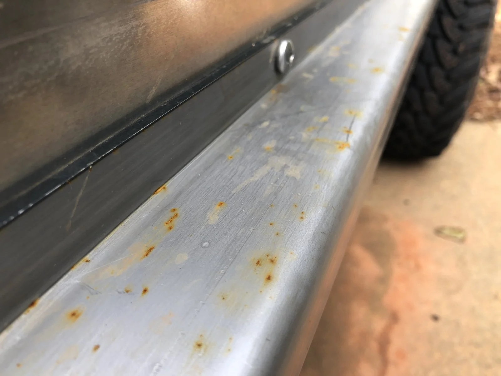

Yeah after yesterdays storm the steps protected surface has completely broken through. Rust is starting to get an upper hand so going to remove ‘em and CC them today. It it doesn’t hold up to my standard I’ll just prime/paint then black. With nutserts in place, its not that much of a PITA.

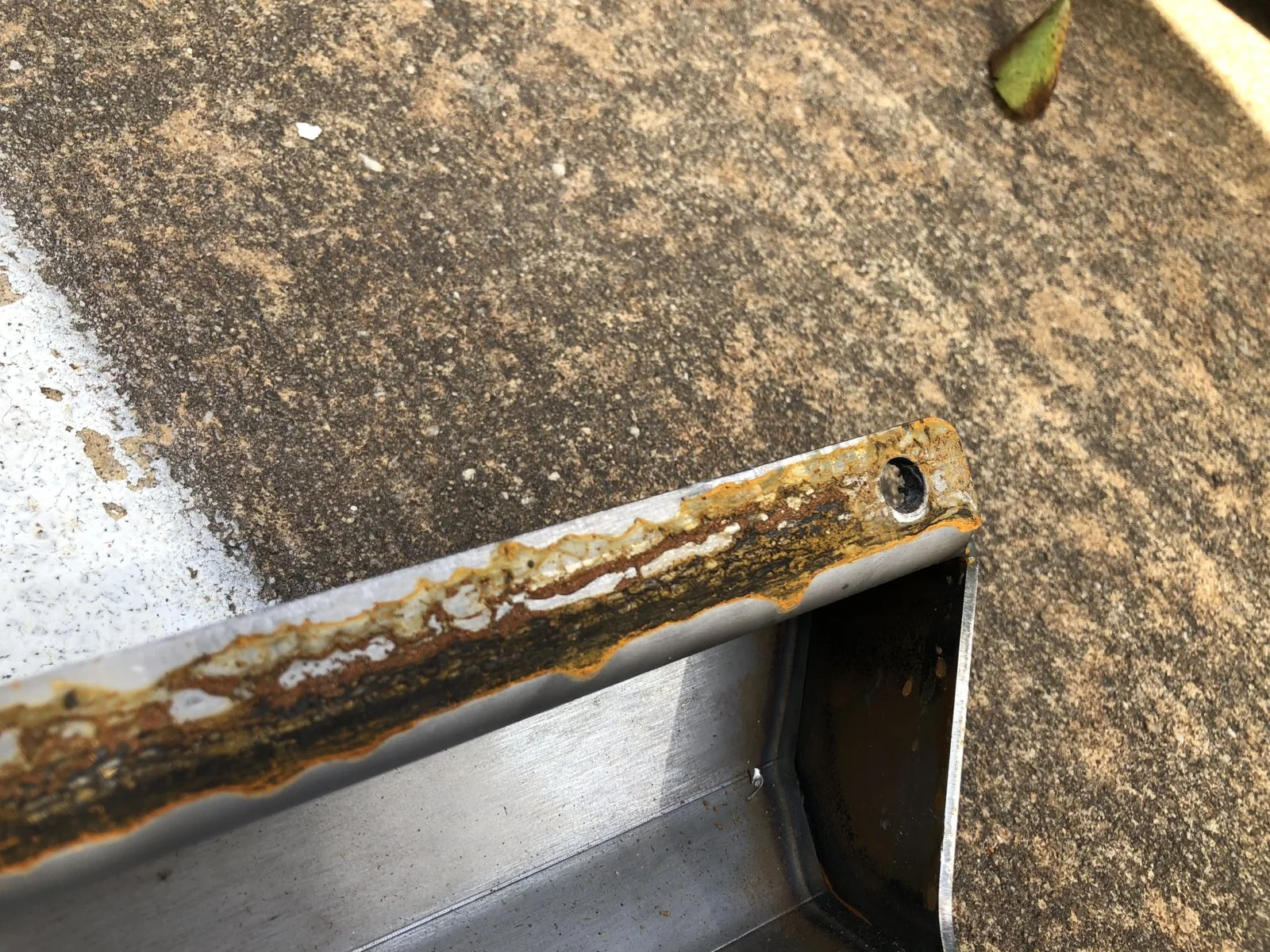

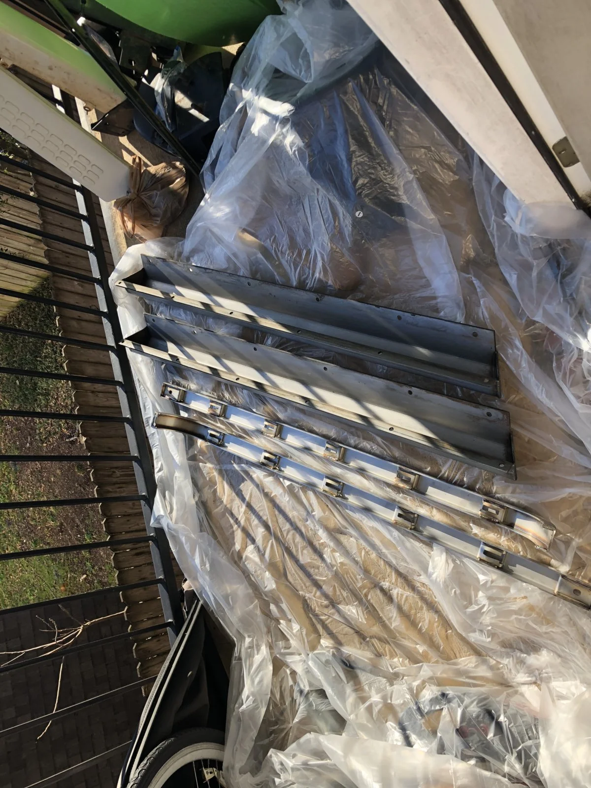

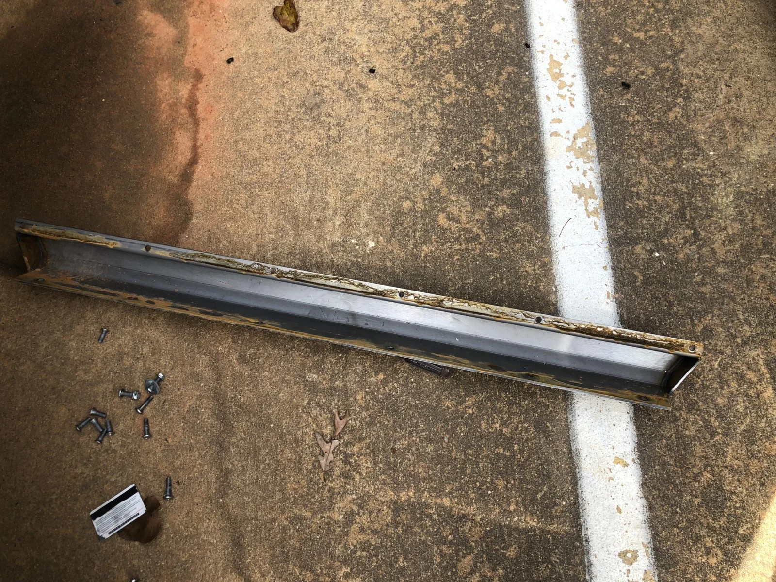

Today was the 4th time I’ve hand sanded down the sliders and rub rails. I removed them to do so. Something I did not think of was the water sitting against the aluminum and the SS. I really thought about putting just a clear coat on, but after pulling this crap off again I really don’t want to remove it again. I talked to Blaine about it a day or two ago and he stated explained the properties of stainless steel to me. Looking at the original post on JF about rub rails ect, they are 100% not intended to be kept raw. Painting them or polishing them is required. Not a show Jeep so had to make a choice..
Was that a lesser grade of stainless than 316? 304 maybe? - 304 will do that around salts and I would expect this.
I use 316 when making water hookups for mild saline waste waster applications and it does not do that even after several years --you say it was against aluminum?
The staining on the backside from mild steel or was it actually pitted like the top side of the rails?
Reactions: JamesAndTheSahara
Wow...that must be a 400 series stainless...300 series shouldn't rust like that.
Unknown grade of stainless. No salt on the road currently, just one rain storm. It was pitted really badly. It took quite a while to clean them up. The rub rails were holding up better but I figured I’d just get them both done. I can’t imagine what they would do with salt on them.
Swiss cheese

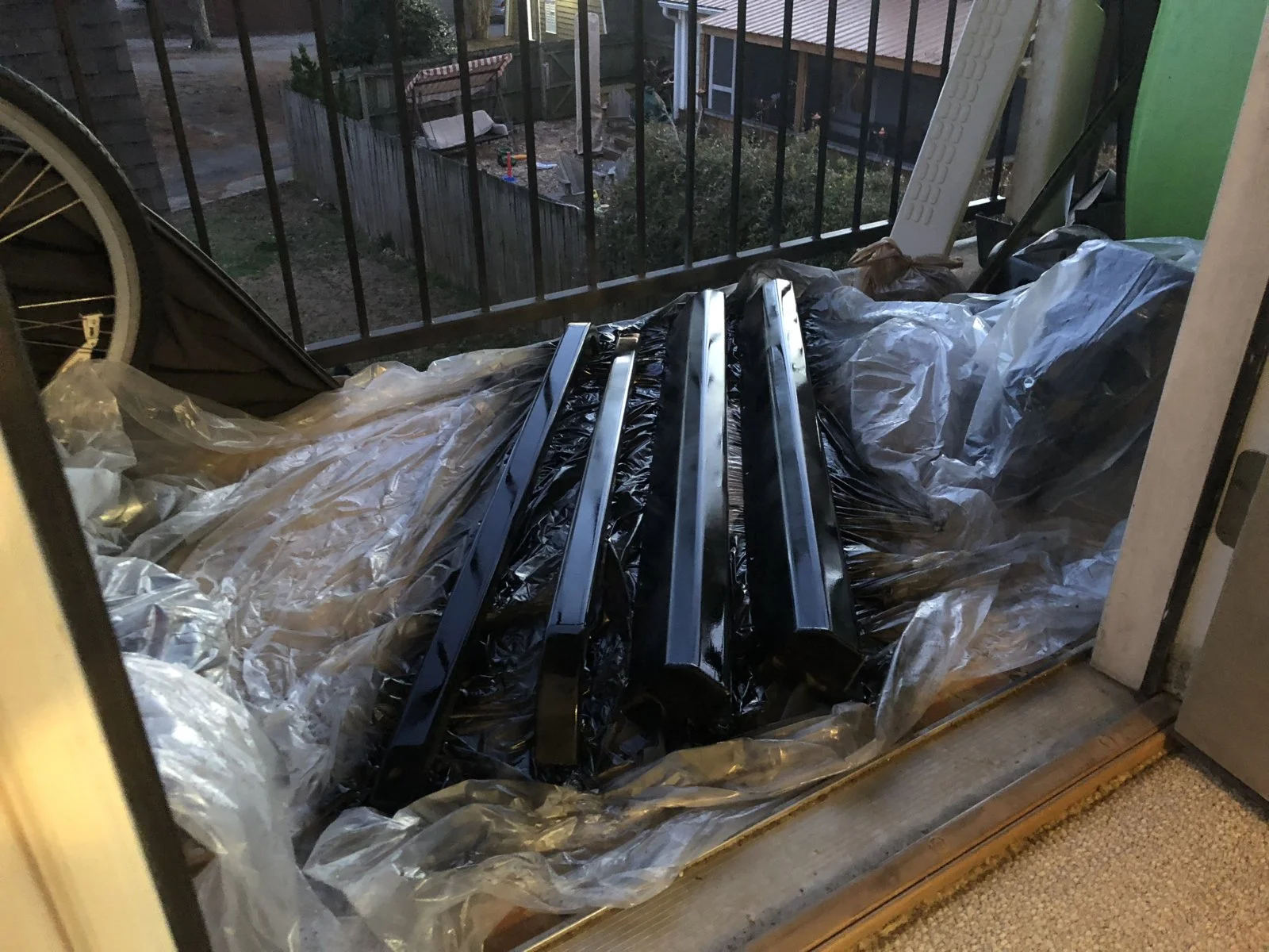

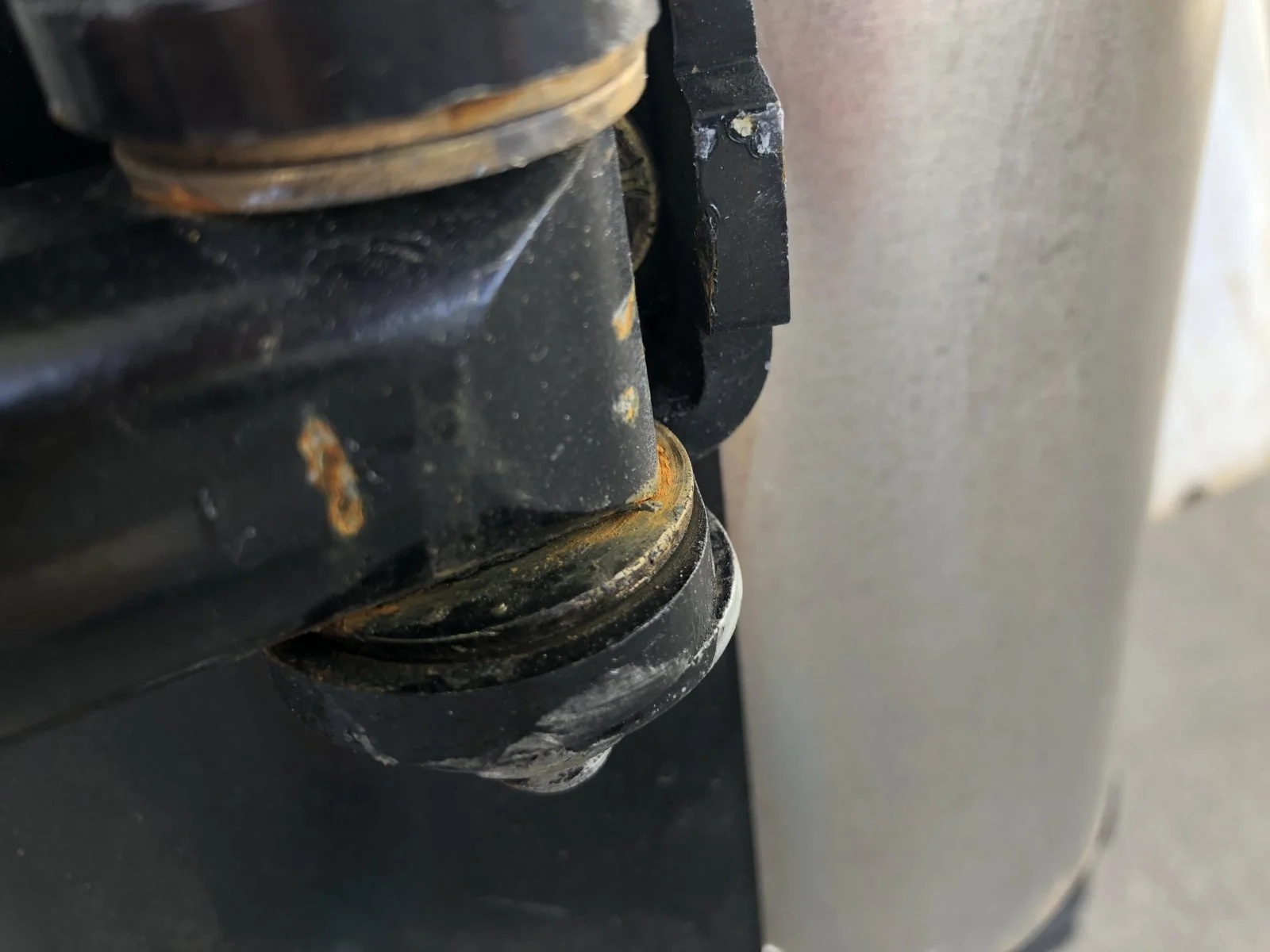

Painted the other side today, so letting it dry. Supposed to rain this whole weekend so hopefully will get it on tomorrow. Like many other members I also purchased the Cobra75 cb. One popped up for $70 on amazon so snatched it up. Finally going to get the CB setup later this week. My tire carrier hinges still work perfectly but they appear to be stripping the paint and rusting. Do I need to PC the tire carrier and the hinges to keep this protected and not rusting? (Its not the brass washers rusting, its the steel pivot point on the hinge).
