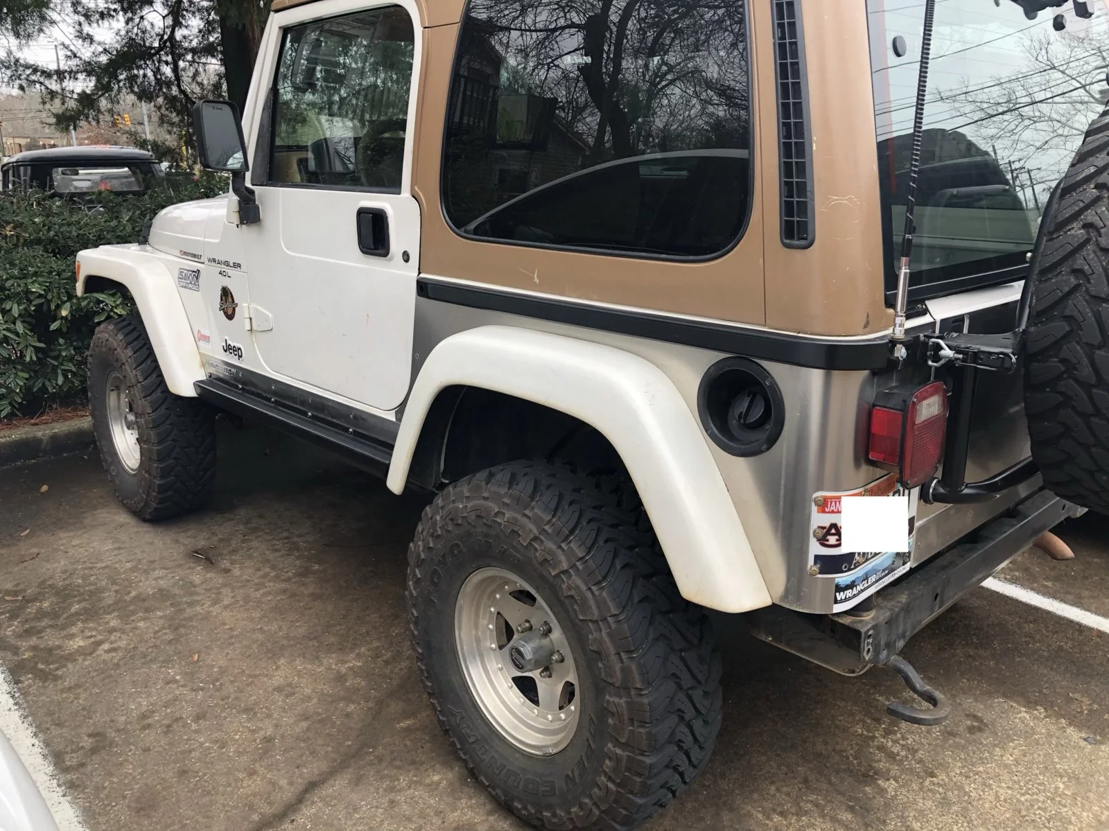

Installed the armor today but it was raining hard and dark.. so no pictures till tomorrow I guess. I’ve removed the armor so many times the whole thing is now a huge pita to go on and off. I will not be removing these again anytime soon.

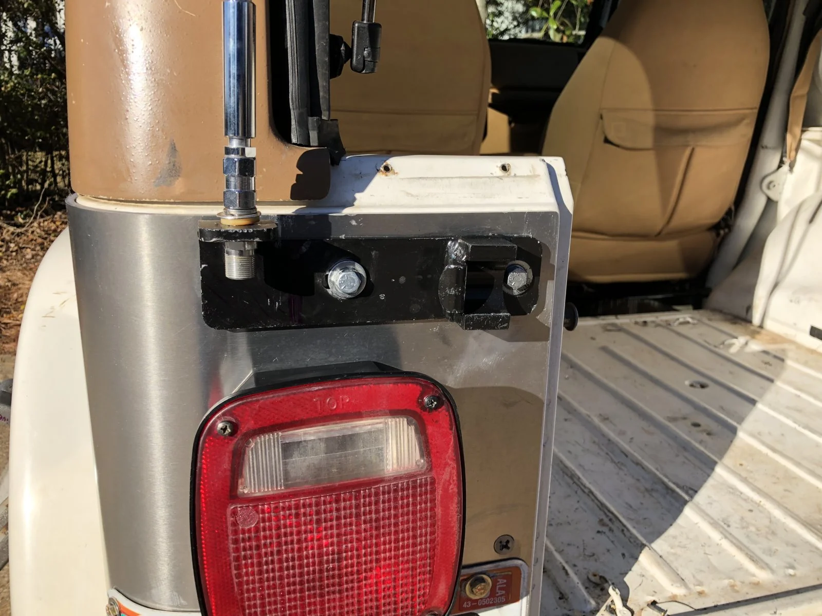

Are you mounting the CB antenna on the driver side or passenger?
Driver side, against the body:
It clear the hardtop liftgate glass perfectly. Never intended on using this kind of mount but the ORFAB tire carrier came with the striker mount having provisions for a CB. Since it ties into the rollcage the ground is VERY impressive :).
You can run the coax thru the tail light and up thru the factory wiring harness that goes thru the tub. Just cut a small slit in the rubber boot for the wiring harness and feed it thru. You may need to dremel a groove in the tail light housing so the coax fits flush.

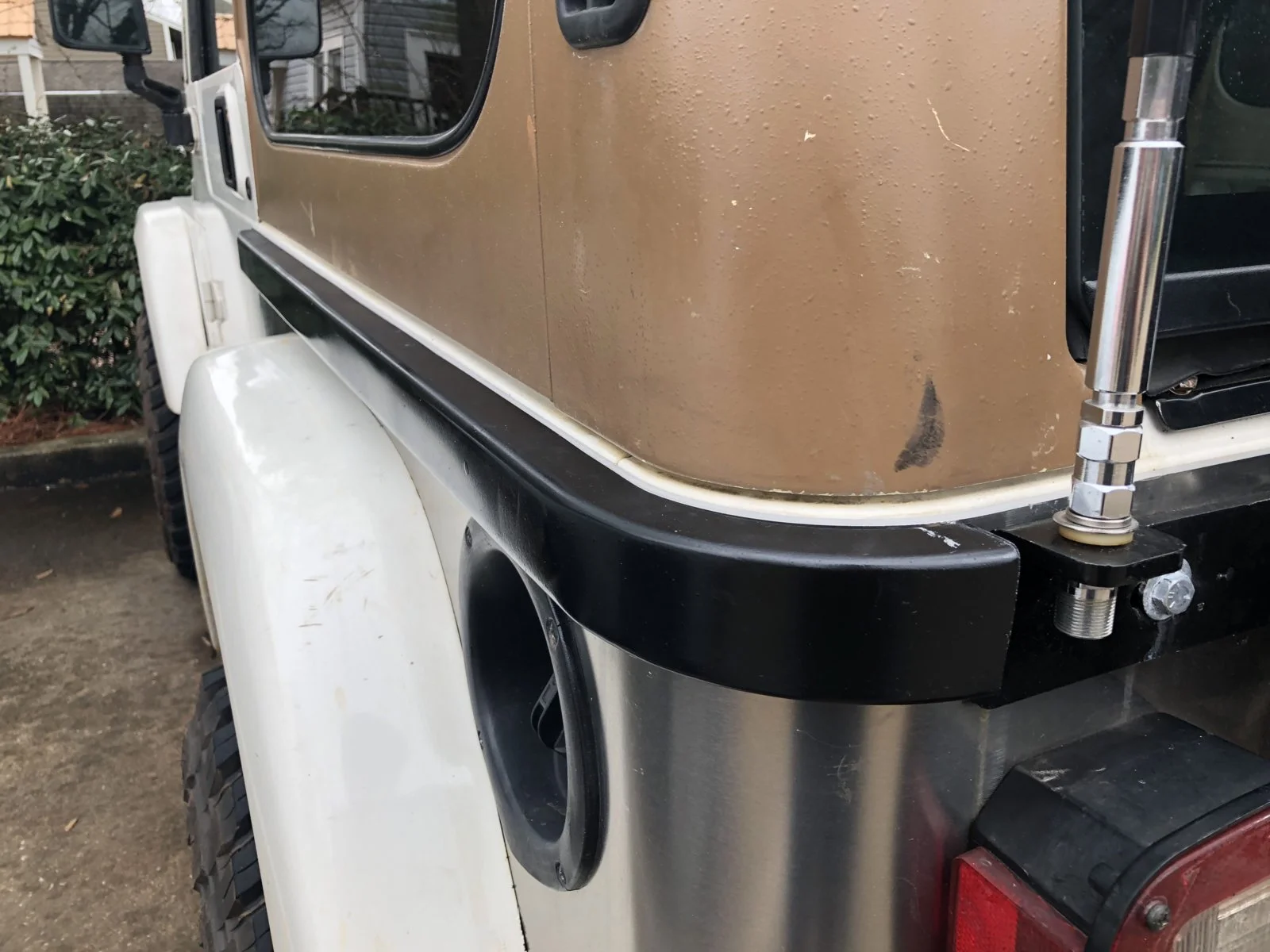

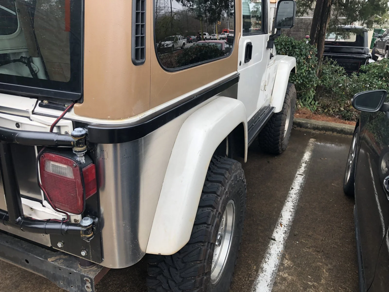

Gave in with 100 stickers laid around and placed a couple of them where I saw fit. May keep them there, may remove ‘em in the future. Here’s some photos of the newly
Installed black armor:
