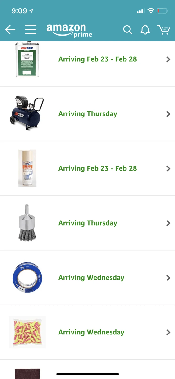

You guys can spot a hidden purchase here... ;)
Can’t believe its only $220 for a quality name brand 20 gallon 4 cfm compressor.
