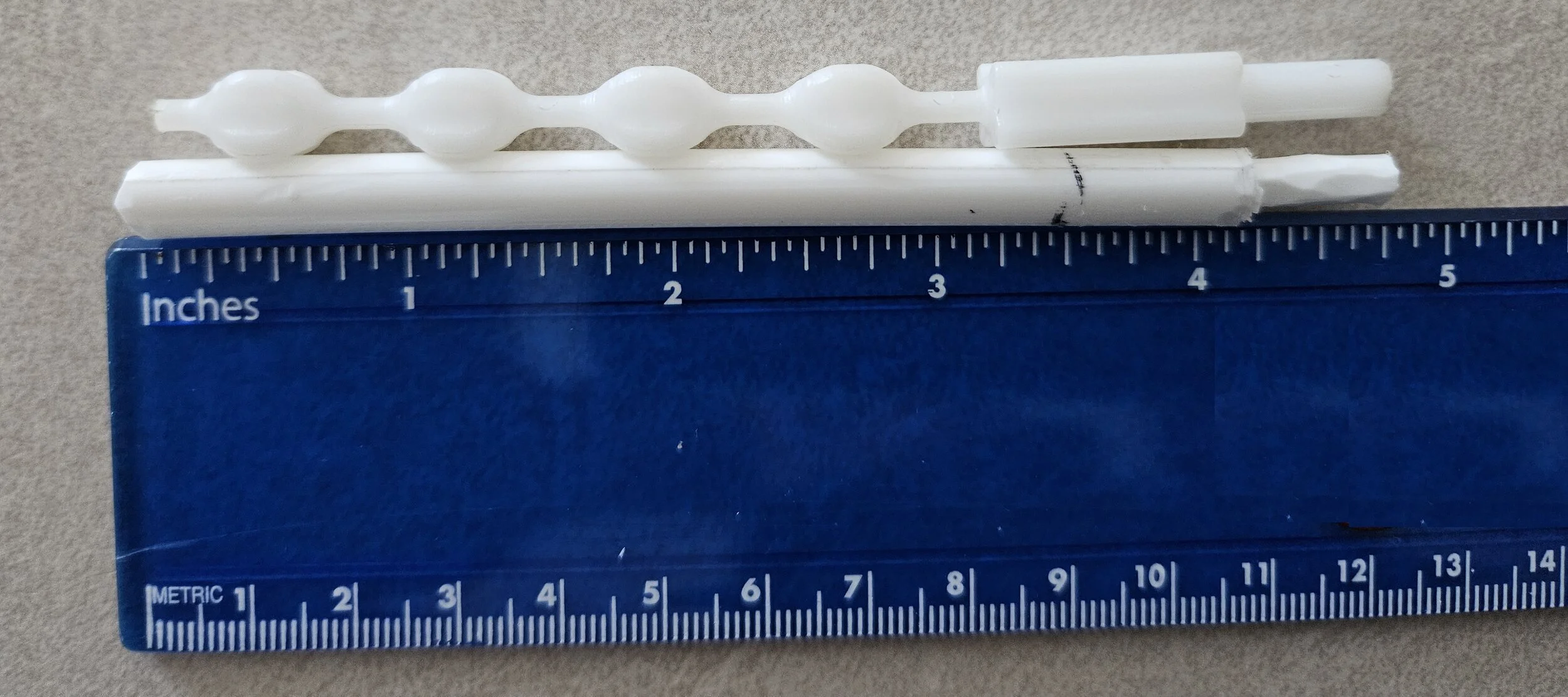

My 2005 Wrangler decided that enough was enough, and the inadequately designed plastic part inside the gear shift finally broke. So my interweb search started; down one rabbit hole and up another. Pulling the T-Handle off the gear shift shows me the top of the plastic part, and was removed easy enough. There are plenty of videos out there showing this easy part of the problem. Most of the interweb shows info on the 1997-2002 Wranglers, but I own a 2005. There are plastic parts available from every corner of the interwebs, but they all say up to 2002. I take my part and Jeep info to the local dealer and they tell me that I have to purchase the entire shift assembly from the base plate to the t-handle, and the plastic part isn't available separately. OK, how much is the entire assembly? Sorry it's discontinued and not available!
Automotive designers should be dragged though thorn bushes, twice!
Yes, I saw the many posts about using a chop stick. However, this didn't seem to work for me. Yes, I measured the chop stick accurately and cut it to the proper length. Wait, what about a plastic coat hanger! Sure, I could sacrifice a plastic coat hanger to the best Jeep Wrangler ever. I made some cuts and trimmed some more. After too many trial and error attempts to get the correct length, I finally settled on 4.5 inches in length. It seems the plastic piece for the earlier years is longer.

Here's the original part minus the broken, missing end, and my modified coat hanger part. I've been using the modified coat hanger for a few days now and no problems yet. I live in Florida and I'm wondering if the plastic used for the coat hanger will stand up to the hot temps. Time will tell.
Does anyone have the original plastic part in good condition? If someone has one from a 2005 year, I would appreciate a photo or accurate measurement of the part.

A metal rod would work as well. Just find a piece of similarly sized metal rod at Home Depot and cut it to length. That's what I'd do.
