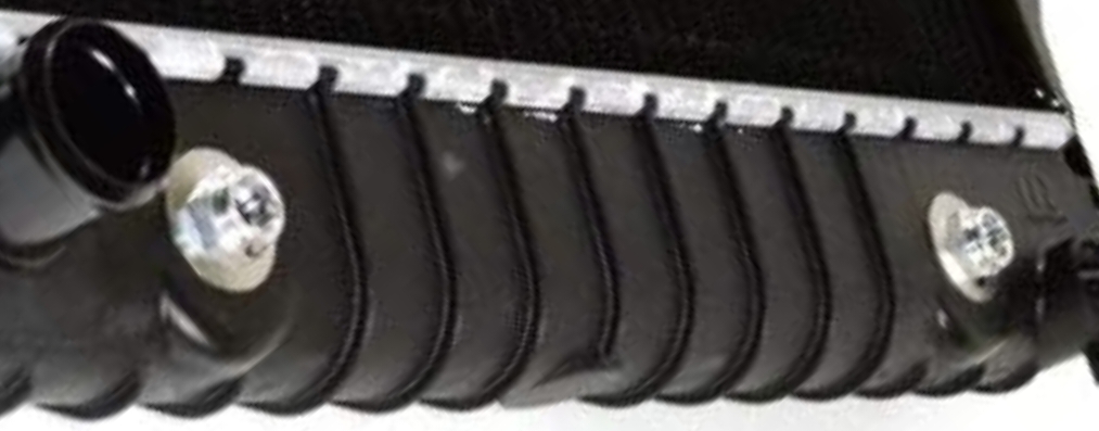

It will fit. The only difference with the radiators over the years that I know of is that the automatics have the cooler at the bottom for the transmission lines. Other than that though you can fit an automatic radiator in a manual, but you can't put a manual radiator in an automatic unless you were to mount an external cooler.
Will PN# 55037653AB fit a 2006 4.0 w/ Manual or do I need #55037653AC? Sounds like you're saying it doesn't matter, the outlet for the auto trans cooler will just be on the top vs the bottom.
My what appears to be original radiator cracked last night only a few weeks into ownership. 17 years, just shy of 100K miles.
the difference is the type of connectors for the auto trans cooler lines which doesn't matter to you if you have a manual transmission
55037653AB for '01-'04
55037653AC for '05-'06
Reactions: Dmn0805 and Chris
Awesome, thank y'all. I am going to go ahead and order the 55037653AB since it appears to be significantly cheaper. I might even grab two of them, since the part appears to have been discontinued...
