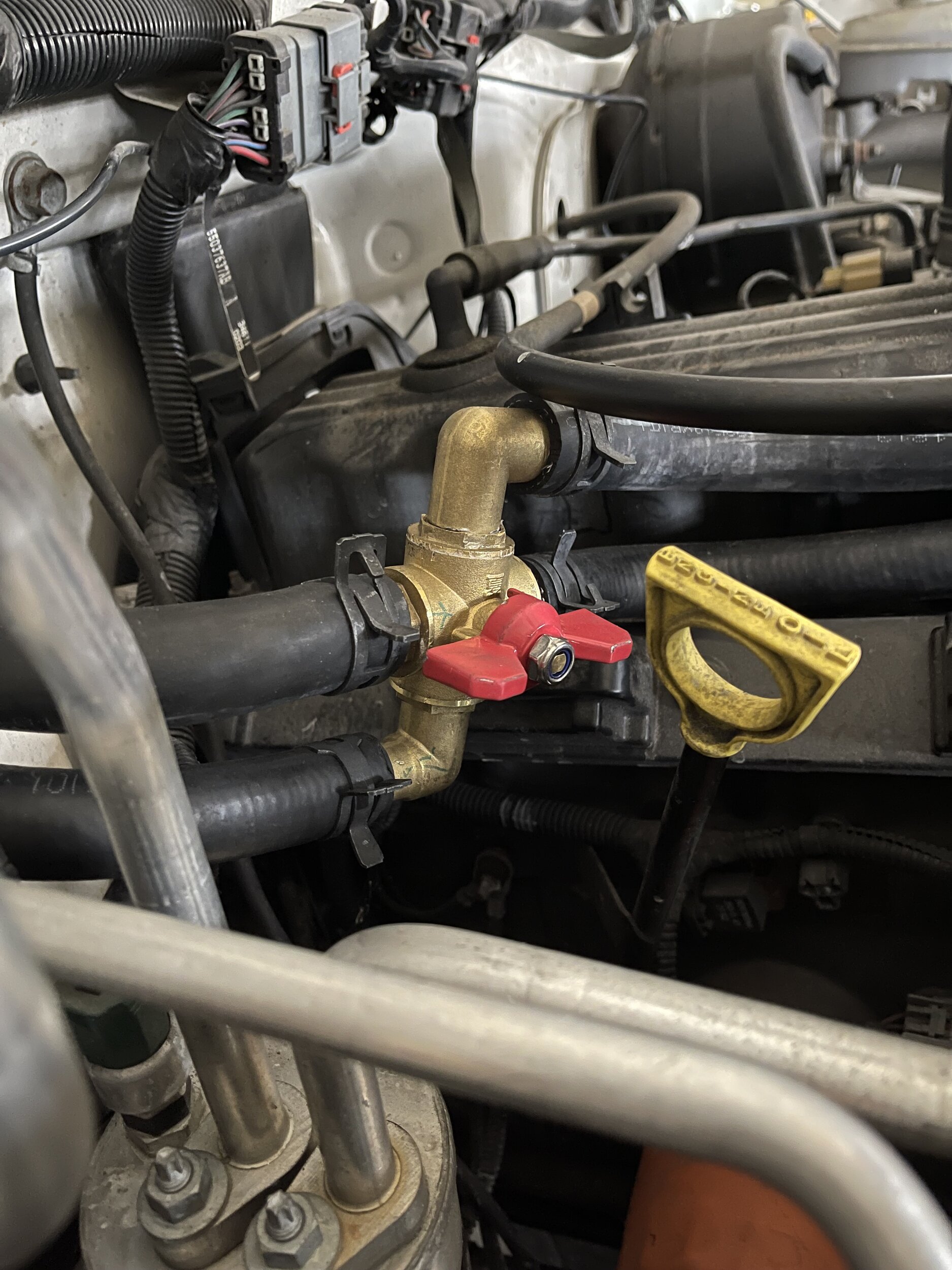

BRASS Bypass Valve:
1) Here's the baseline product: https://www.amazon.com/dp/B0989GCHX6?tag=wranglerorg-20
2) You'll need to purchase the 3/4" and 5/8" sizes. In the end, you'll have two bypass valves. I have a second, DM me if interested.
3) You'll need to partially disassemble/reassemble units to create the correct hose port sizes. This is very easy, and be sure to use sealant.
4) When complete, you'll have a manual bypass valve that will prevent unwanted heat in the cabin.

That’s a pretty cool bypass valve. I’d not seen that before. Thanks for posting.

That's really nice!! Looks good! I might consider doing something like that in the future! Nice job!

So my question is: what is the downside in placing just a ball valve cutoff in the heater line, ie stopping flow thru the heater loop?
Good question, and would appreciate the forum's input. I'll post here if any concerns arise. In the research process, it seemed (generally) that most concerns could be addressed by periodic operation of the system in a non-bypass, normal circulation path.
FWIW, a local rad shop was very helpful in understanding load transfer to radiator when bypassing the heater loop. An incremental load is transferred to the rad during bypass. In my scenario, the after-market Dorman radiator is designed for cooling capacity with standard or automatic transmission use. Since I have a standard transmission, the incremental additional load was inconsequential. Interestingly, the rad shop was also unconcerned about load transfer to rad with an automatic transmission in normal operating conditions.
We discussed this on another forum for Ford trucks and the general consensus was it's OK to do that as long as you periodically open it and let the coolant circulate. Apparently (some, most or all?) factory systems allow some coolant to flow thru the heater core all the time to keep it from getting stagnant, or from causing clogging issues. Some coolants become acidic after a time and that can be detrimental as well. there are after market heater control valves that you can buy that will stop the flow completely while the AC is running, and there is a Ford Ranger valve from certain years that is popular to retrofit into the bigger trucks.
Also some trucks came with a valve that closes off the flow when on Max AC.
Interesting! I’ve been running the ball valve on both my TJ 4.0 & my 74 CJ5 304V8 for a while. Thought I’d throw it out for discussion .
