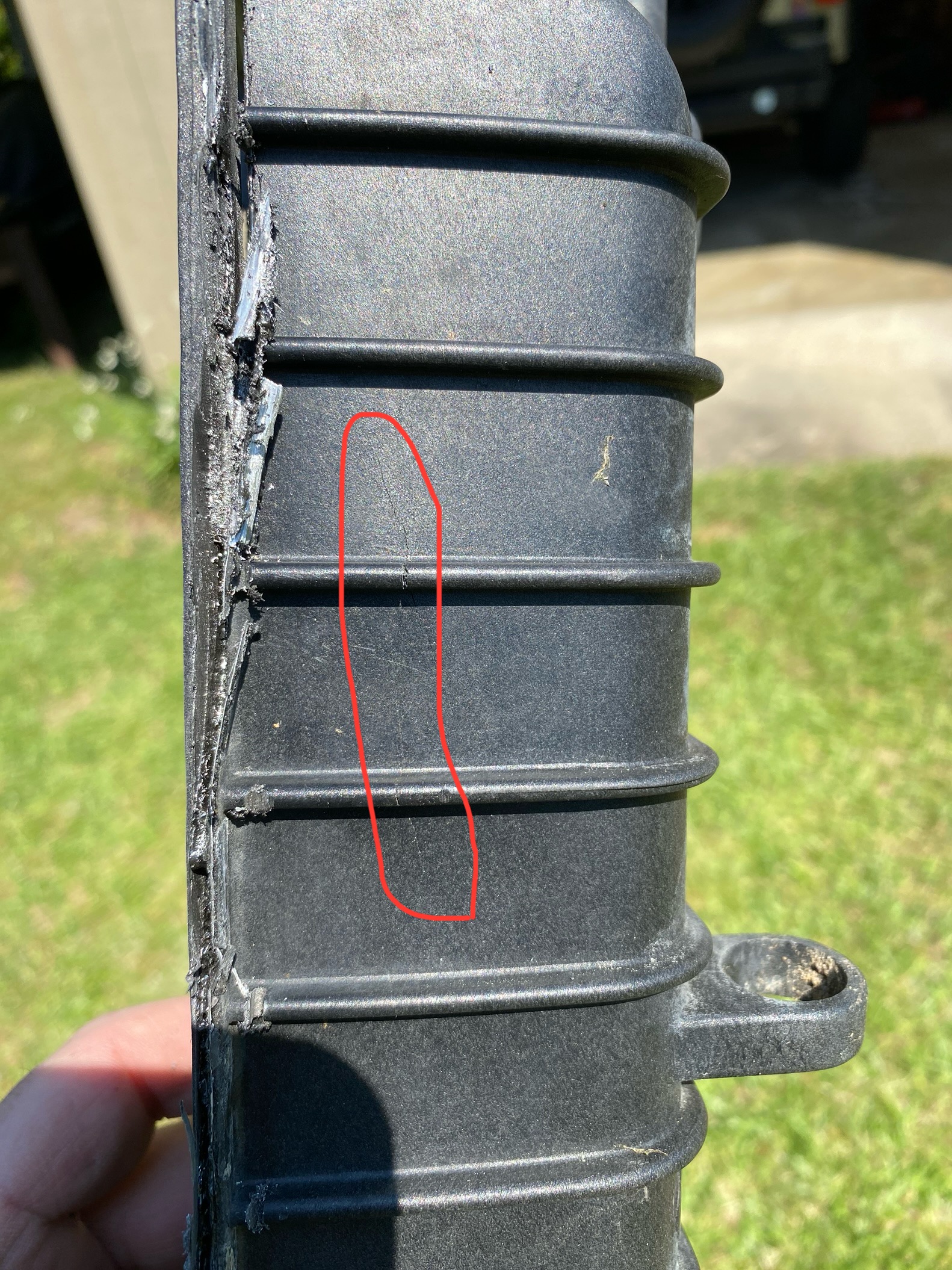

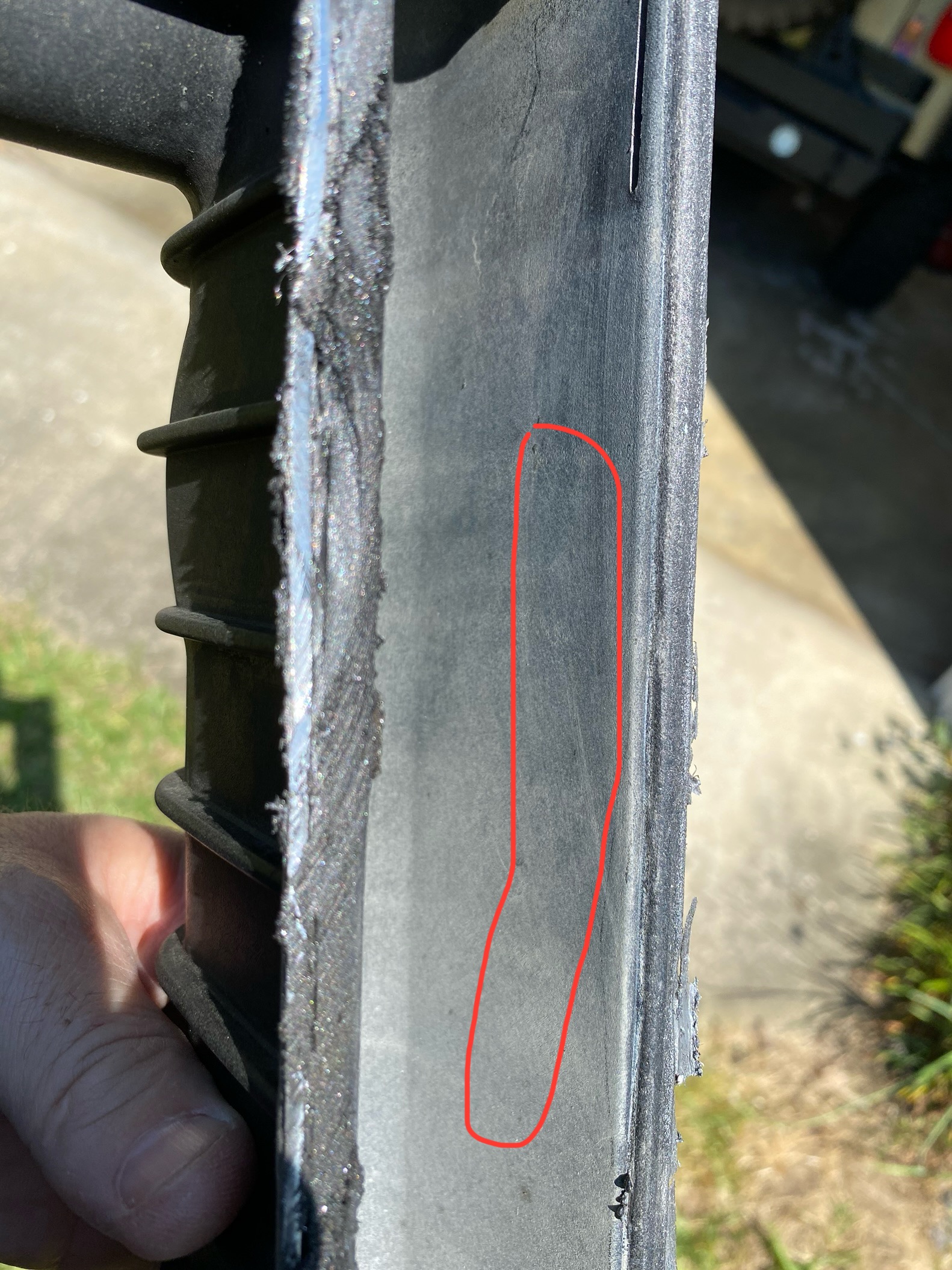

The original radiator in my ‘06 TJ and my ‘99 Silverado both cracked one of the plastic tanks within the last handful of years. Other than being dusty/dirty, neither had any visible signs of being bad or leaking until they cracked. I put a MOPAR back in the Jeep, but I put a Denso in my truck about a year ago. The quality seemed good to me and it has being working as it should.
I was curious what the inside of the tank looked like when they crack, so I cut the end of the tank off of the one that came off my truck. I think I was expecting to see some erosion or degradation of the plastic but it looked no different than the outside of the tank.

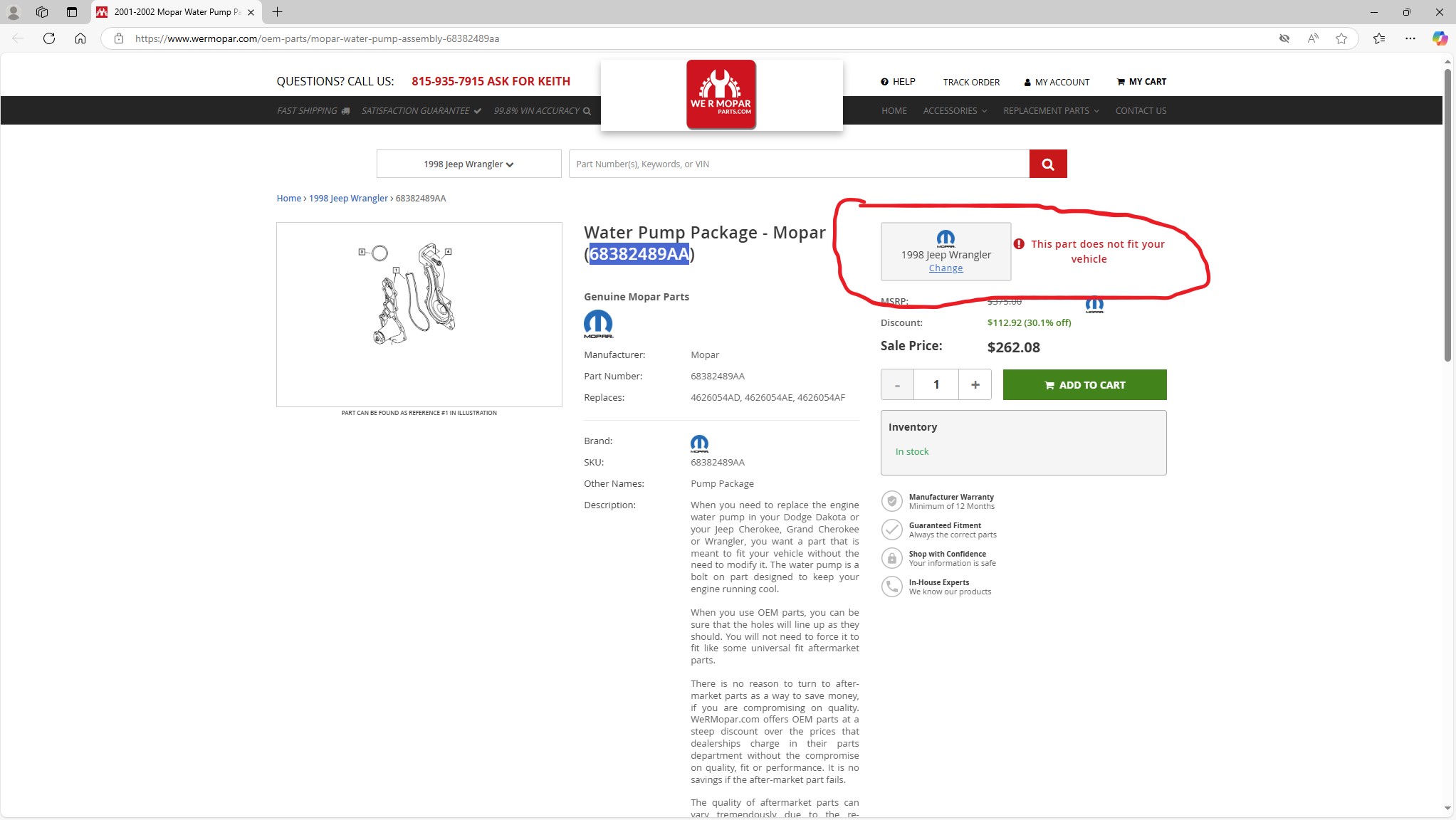

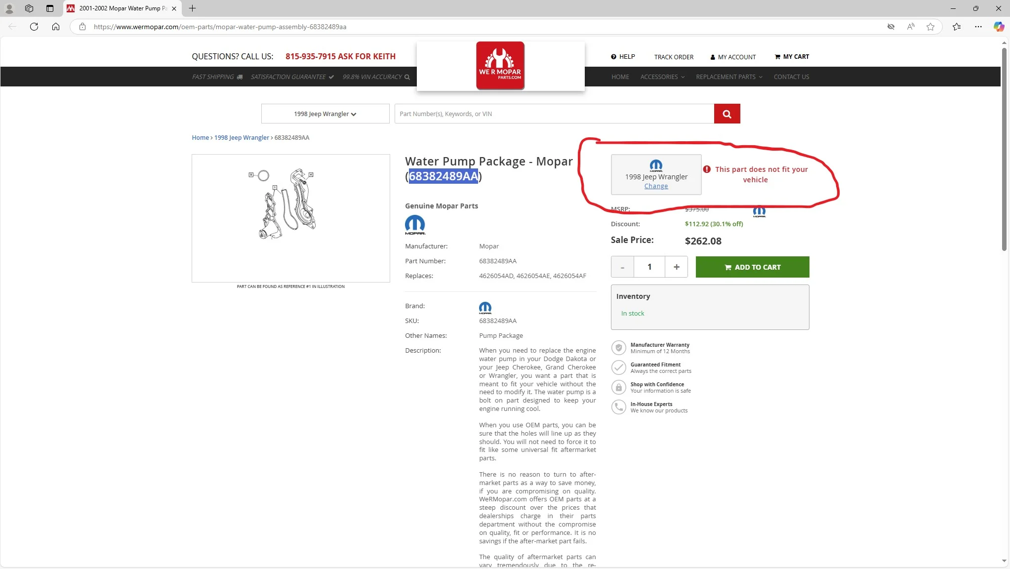

Just a heads up, the indicated part number IS the correct part number even though the website currently says the part does not fit. I called to verify.

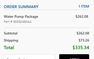

Holy Smokes on the shipping!! That shipping is from the link listed in the original post. I found the same part on several Mopar sites for around $250-260 with about $10-$15 for shipping. I ultimately bought from RockAuto for $253.94 all in.
