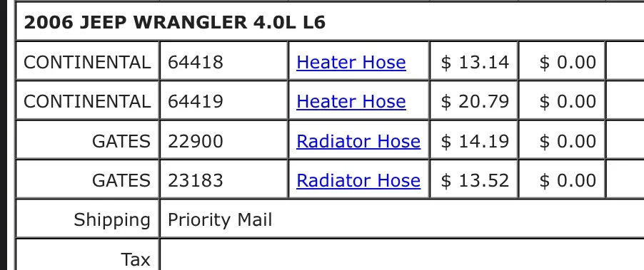

Here are the hoses I ordered and they worked fine. It’s for a 2006 4.0.
