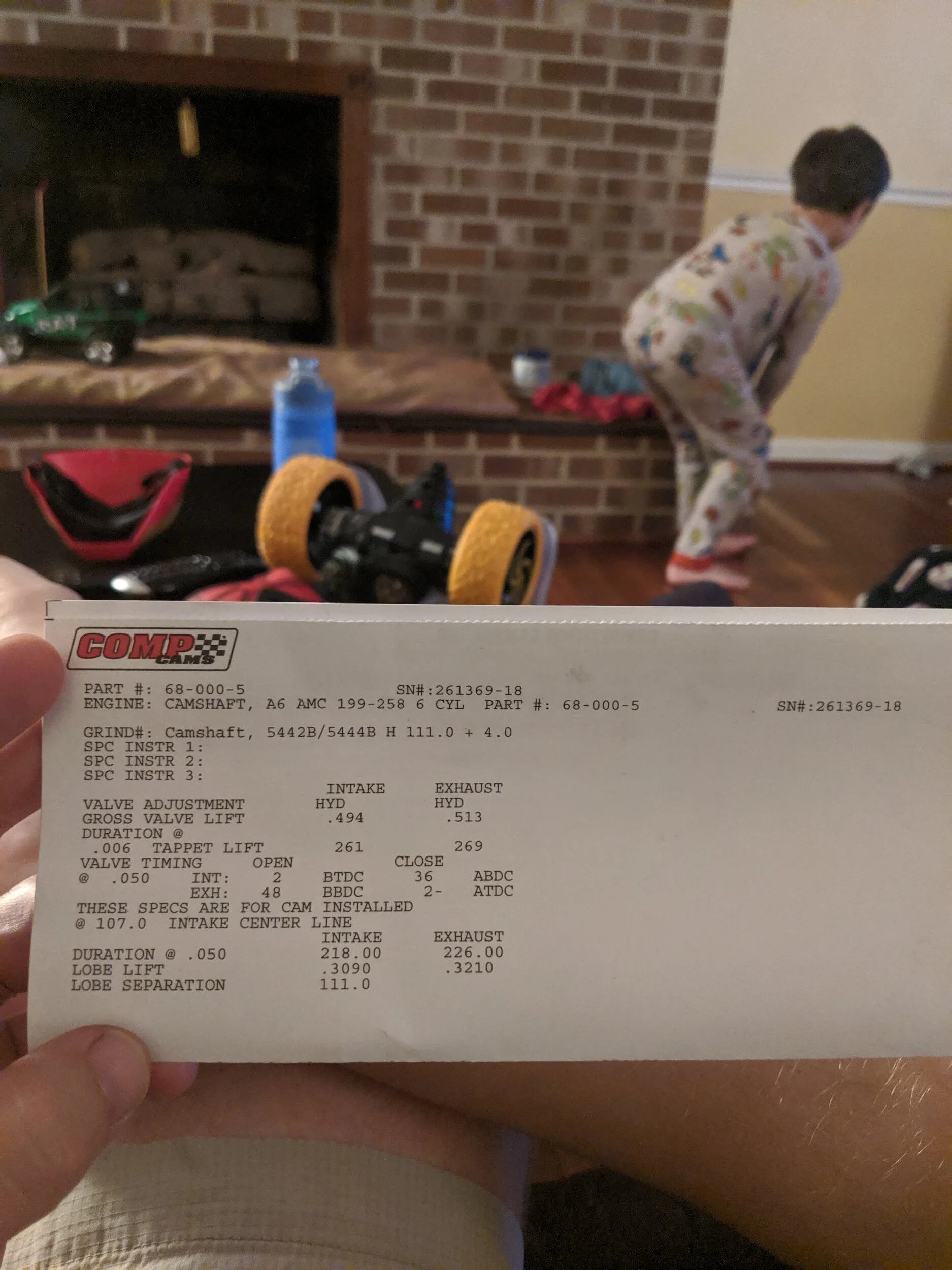

And please excuse my ignorance, but the lift listed on a cam card is seen at the valve with stock ratio rockers, right? Or is it at the cam lobe and math is required? Your springs are listed at 550 max lift IIRC. Also I have 1.65 ratio rockers.
