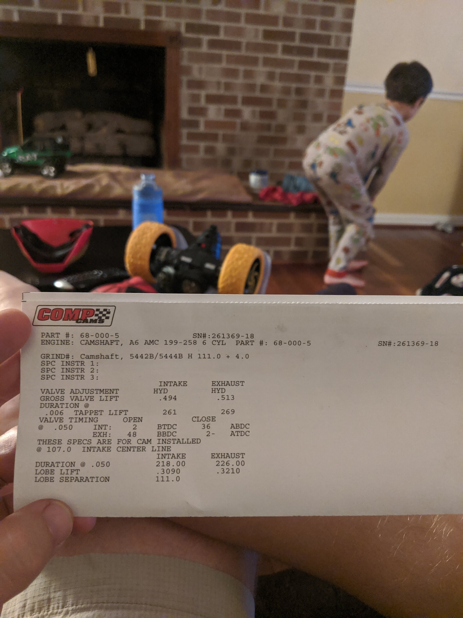

Thanks. And those were drop in, right? I remember you said it quieted down the valve train some, right? Did you ever see any valve float? I shift around 5.5k rpm so that's a bit of a concern for me.
And please excuse my ignorance, but the lift listed on a cam card is seen at the valve with stock ratio rockers, right? Or is it at the cam lobe and math is required? Your springs are listed at 550 max lift IIRC. Also I have 1.65 ratio rockers.

They were drop in on my Russ ported Edelbrock with the LS valves. Not sure exactly what you were running. I rev to 5k and there is no indication of float there. I can't imagine 500 RPM more would result in float, but there are quite a few factors at play. I would think even 1k more RPM would probably only be equal to the boost pressure that attempts to hold my intake valves open. The cam card is specd for the stock 1.6:1. You can tell pretty easily by multiplying the lobe lift by 1.6 you get the gross valve lift. So in your case exhaust at 0.321x1.65=0.530 gross lift.

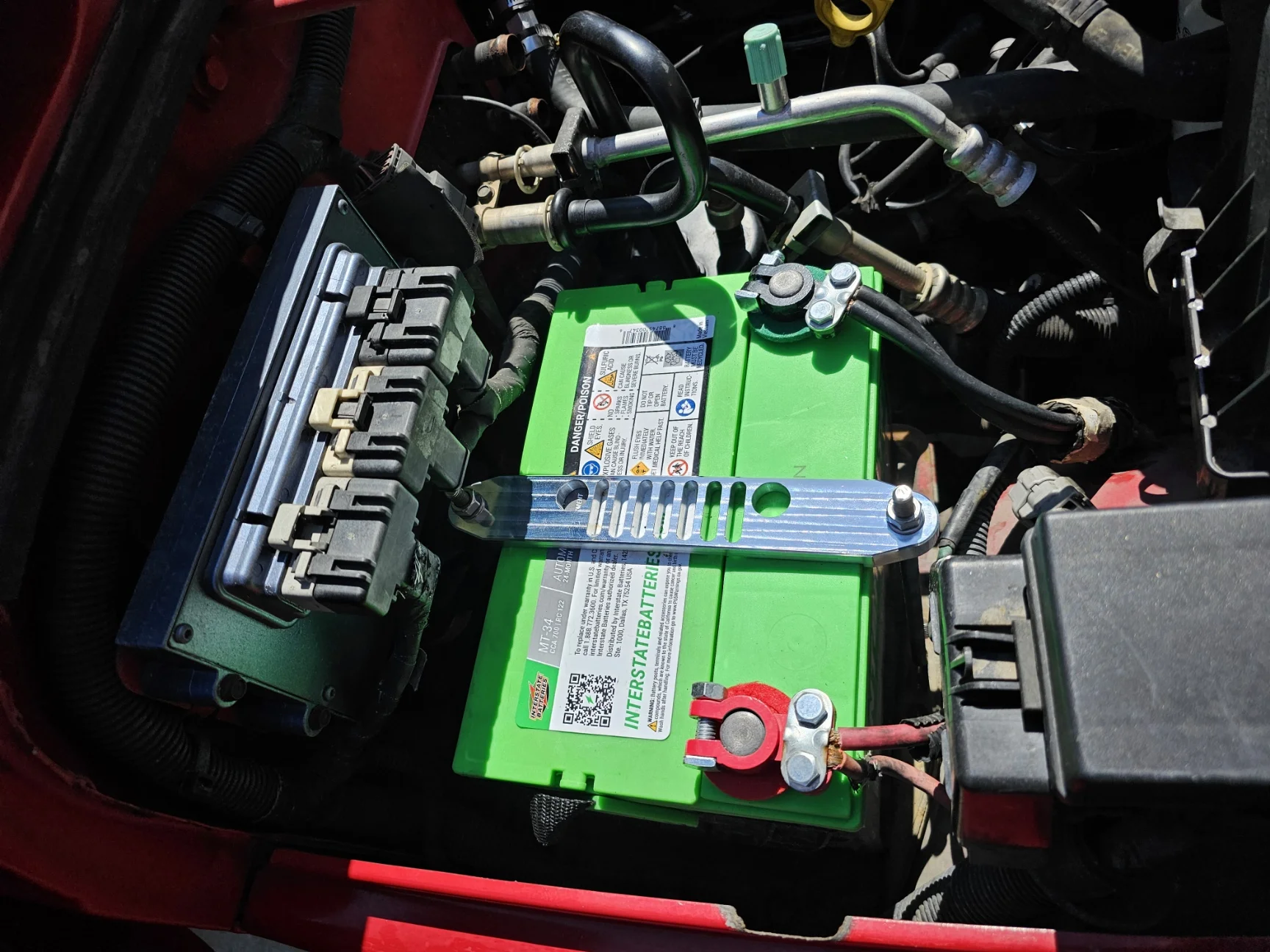

I know it's not the LJ, but I made one for that too. The TJ didn't have one so I made a Jeep one.

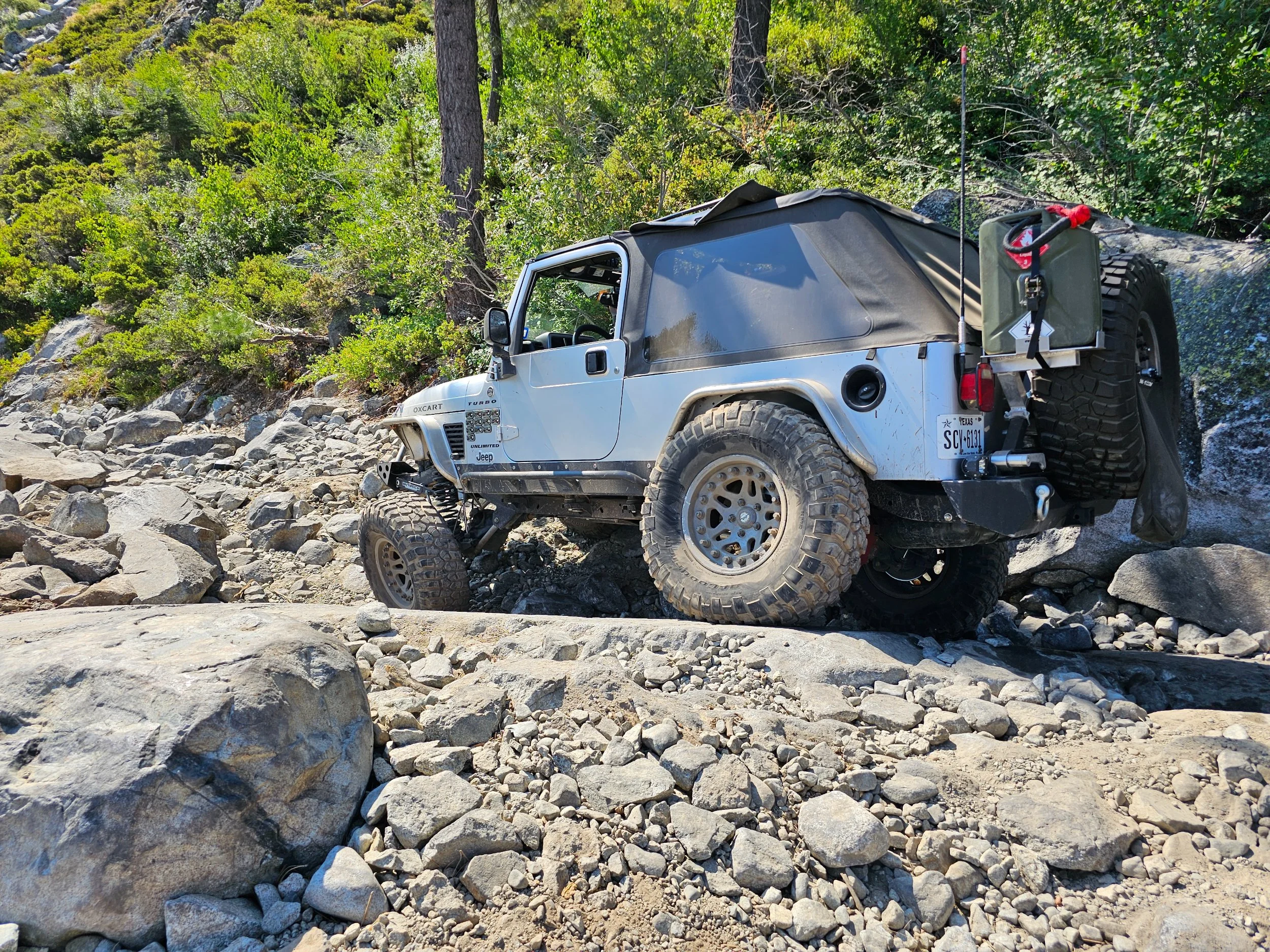

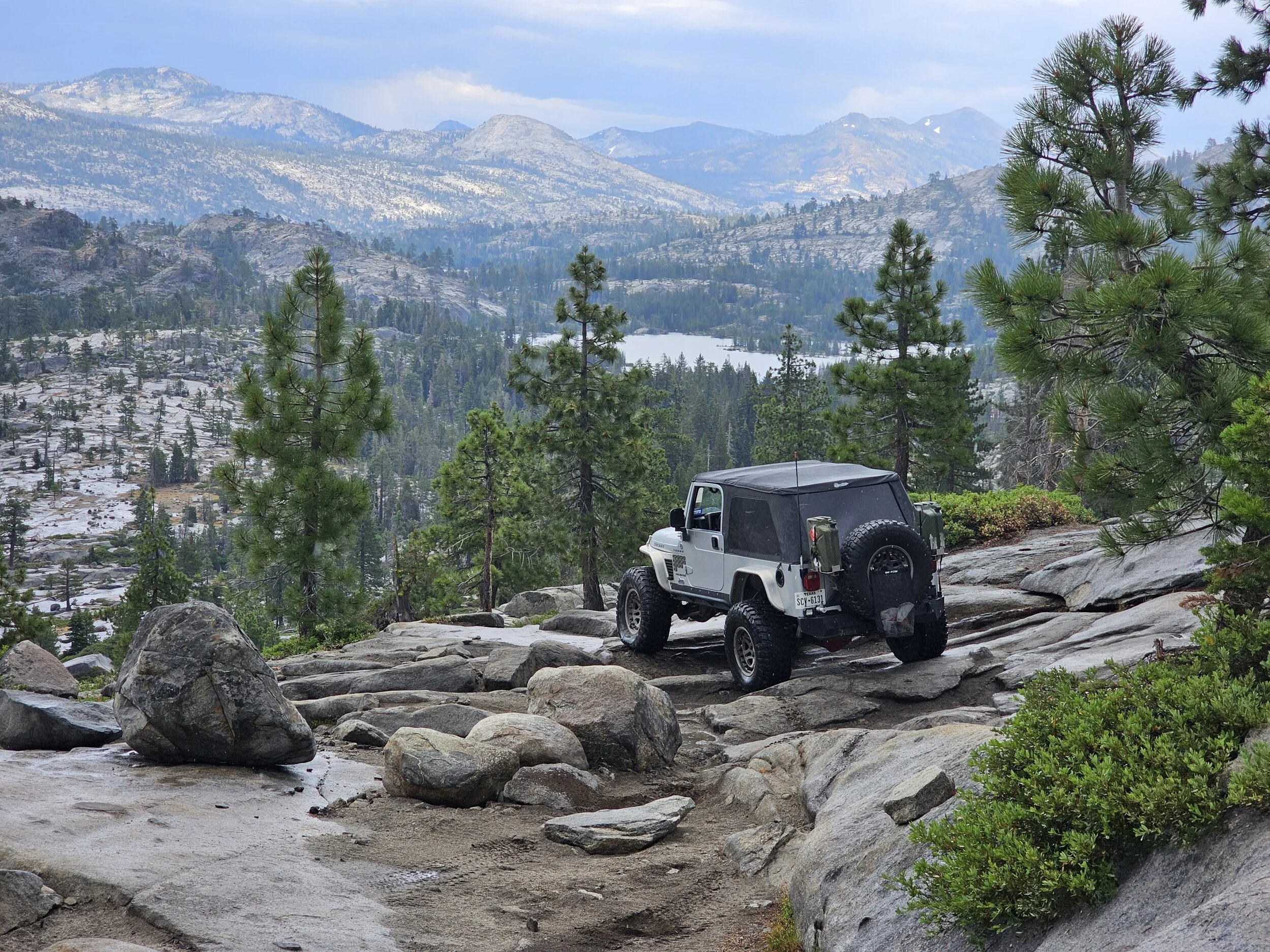

Fordyce in the books as well. Less hard than I was lead to believe. I did winch hill 1,2,4 and 5. 3 I did the middle line not the buggy line. The rest of the trail was rocky and dusty. Water was flowing at 300 and didn't go above the bottom of my sliders.

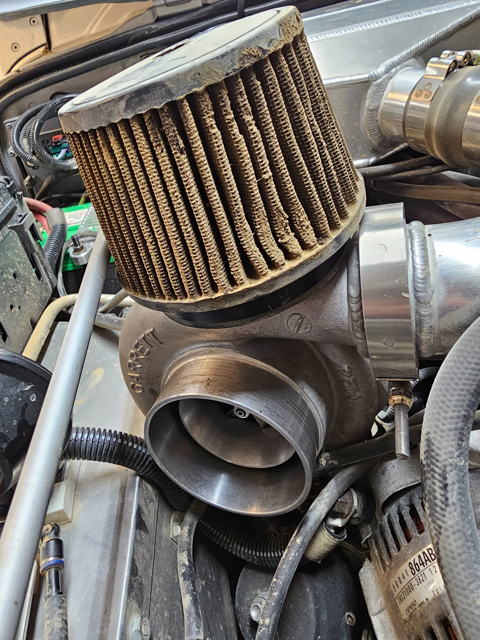

I cleaned my K&N air filter tonight after running it for over a year. It had some trips on it. Windrock, Rubicon Trail, Fordyce, Sand Hollow, Hole in the Rock Trail and a couple of local wheeling runs. It was getting pretty caked up. I pulled it off and the turbo was clean and the engine was not ruined. A touch of oil residue near the back of the impeller but no sand or grit. I guess I got the only good one. 🤣

Don't let the cat out of the bag , but I've never experienced the K&N legends on anything . Including racing a 1/2 1600 in unbelievable dust conditions.... :LOL:

I know you run a pre-filter sometimes, why not for the recent run?
And here I thought it was time to clean my filter when mine was 95% less dirty lol

I had a pre-filter on the old setup with the GT30. When I upgraded to the GT35 I had to change to a shorter filter. I might see if I can get one for this filter size too. This one was pretty filthy.
As more dirt is caked on it, less dust gets through. You might want to check after the first dusty ride post-cleaning.
