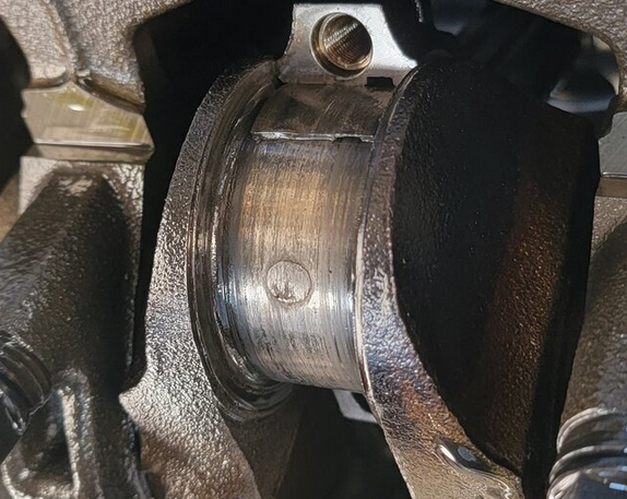

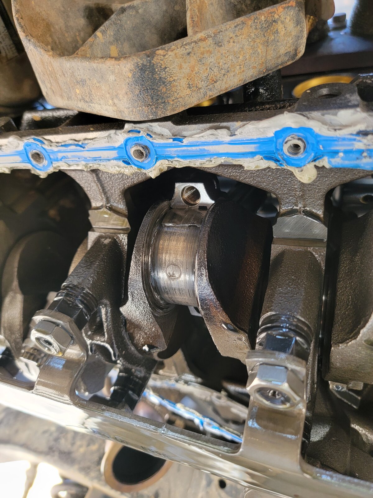

I'm thinking rod bearing or wrist pin. The loud squeaking it was doing was confusing. I have heard a lot of rod knocks, but never with a squeak.
Your thinking is mine as well. I don't think I've ever heard a main knock like that - but every rod bearing I've ever smoked has sounded exactly like that.
So sorry, Dude...
Well, this is undesirable. It appears that something was incorrect on #3. Back out it comes and off to the machine shop for the second time.

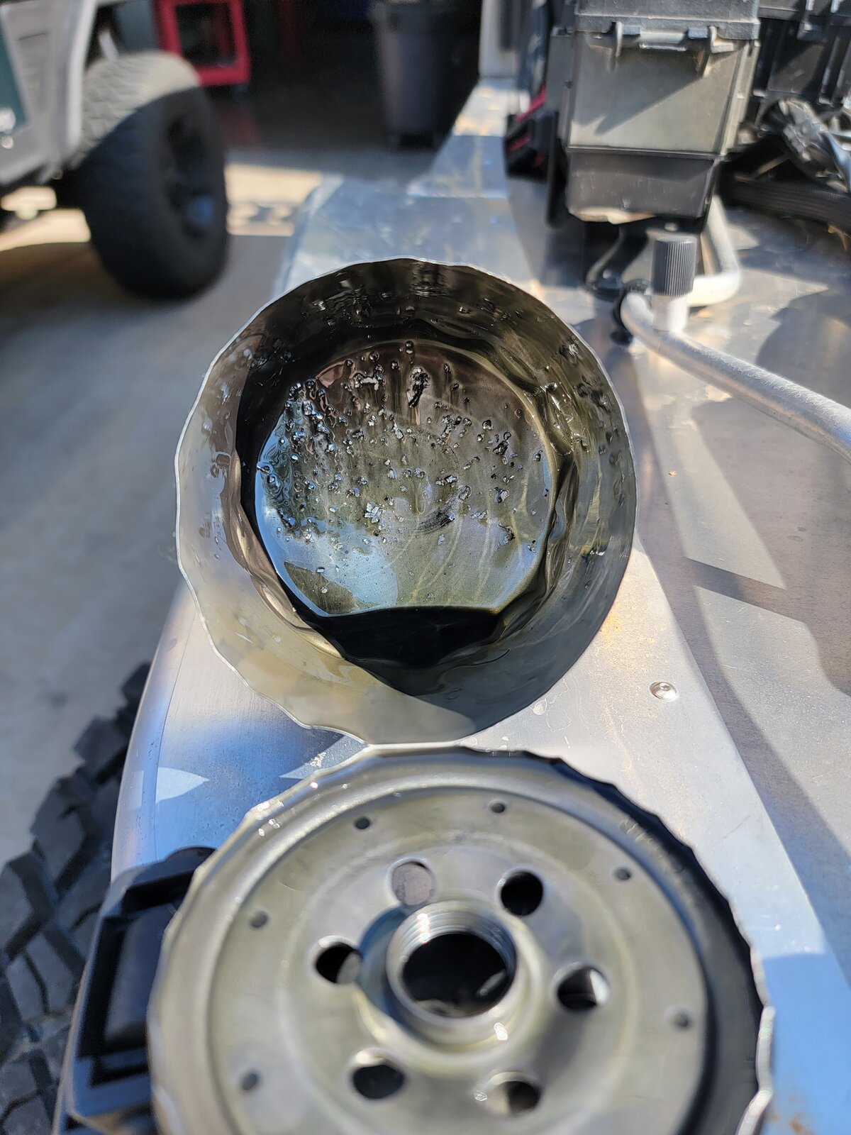

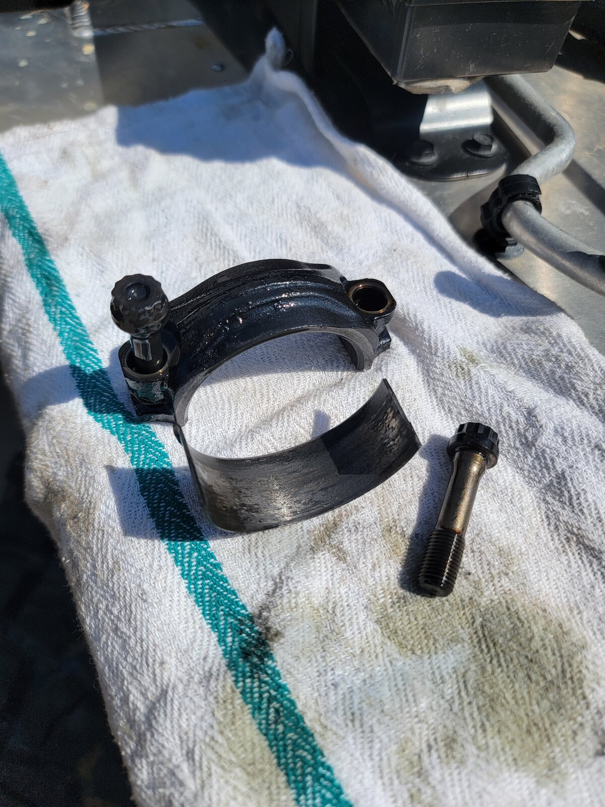

Just making sure I know what I’m looking at…(I’ve never built a bottom end)… So you have a spun connecting rod bearing and those are pieces of it in the cut open oil filter? Bummer. How do you think that happened?
Correct and I'm guessing somebody didn't check clearances properly during assembly.

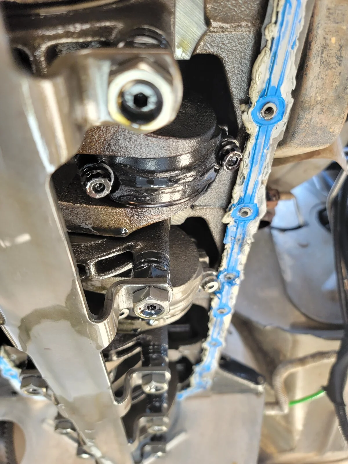

Jezza, you think the crank is savable? That's crazy how the cap is all discolored. I wonder what the clearances are on the other bearings. Might offer some insight.
I think one of the rod cap bolts was loose. I had to put my weight into the passenger's side bolt where as the driver's side spun out with no resistance. I should have double checked the machine shop. I don't think it is worth fixing. The crank is around $500 new and the labor to fix it would probably be more. I already called Russ and he has them in stock. Plus the discoloration from the heat has me concerned as well. As long as the cam and head are okay I will be happy.
