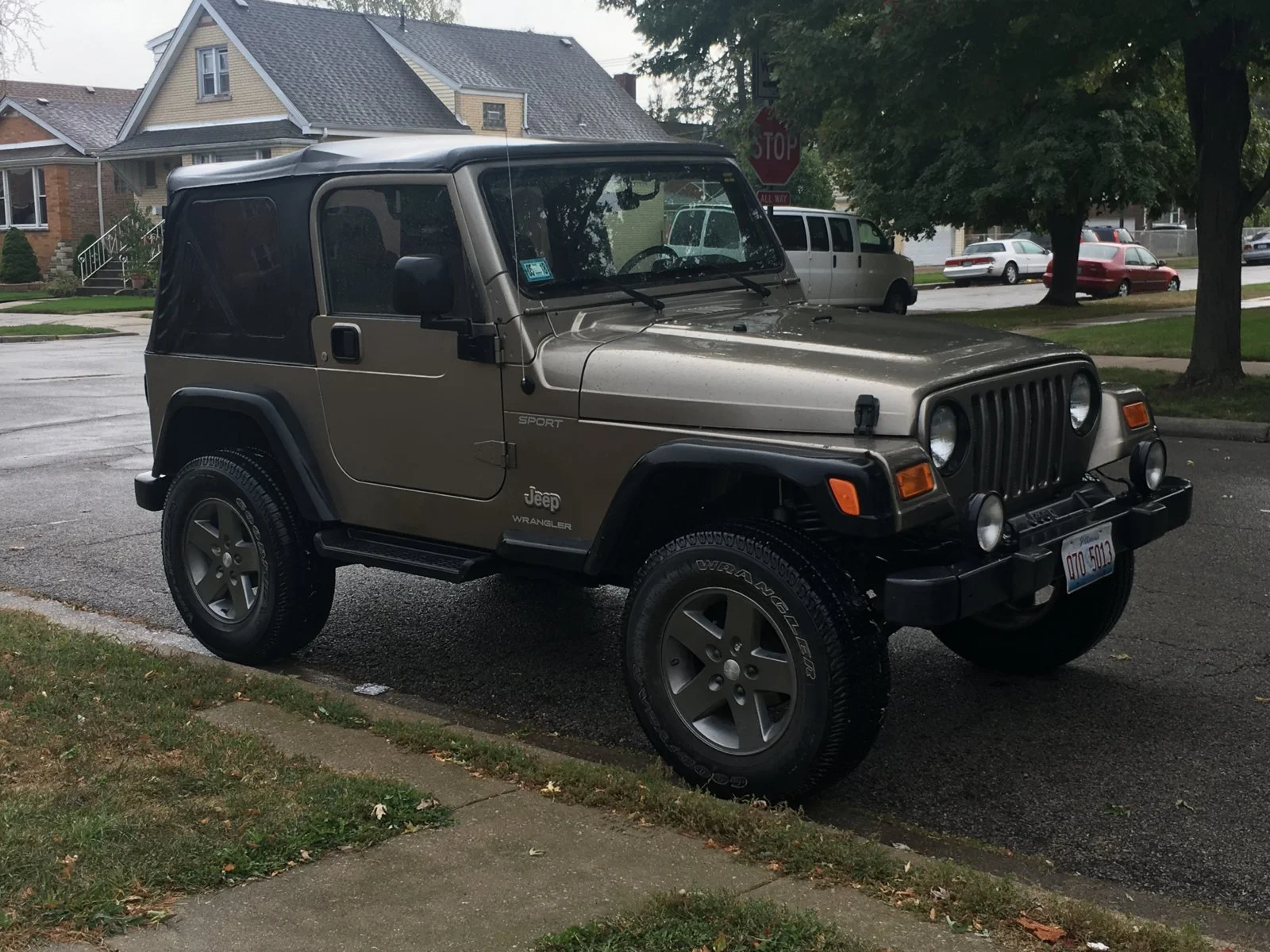

Yeah, Height wise they are a bit bigger, the offset is much more negative, and the bolt pattern is different. All that being said, it can be done...
I'm running a 3/4" spacer lift for now, and 1.25" thick wheel adapters. I don't have enough room for offroad articulation, but Driving on the street isn't a problem. This winter, I'll be adding 1" lift springs and a 1.25" body lift to get some room for the tires to move.
oPUIxv4L6Mk-B23vN_ML_Ozl_jw7shGKV28EufXEWt4IgTVbsMHA2DN_oNwc1Gw7ADcJDNPBMzrXiIpzUI=w1634-h919-no.jpg
After bolt pattern the big difference is wheel offset. A lot more backspace on a JK wheel.... which means the spacer mostly returns the rim to the stock TJ position. I kinda like the RangerBob look with a more modern, flatter wheel.

Thanks...I didn't want to just do the black wheel thing, but I don't like the wheels polished or silver. The gray turned out well...better than I thought, in fact.
