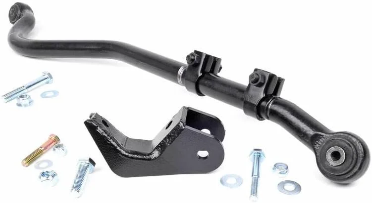

This is the trackbar kit I ordered with, seemed like a reasonable choice for my price range.
Forged | FR | 0-3.5 Inch Lift | Jeep Wrangler TJ (97-06)/Wrangler Unlimited (04-06)
