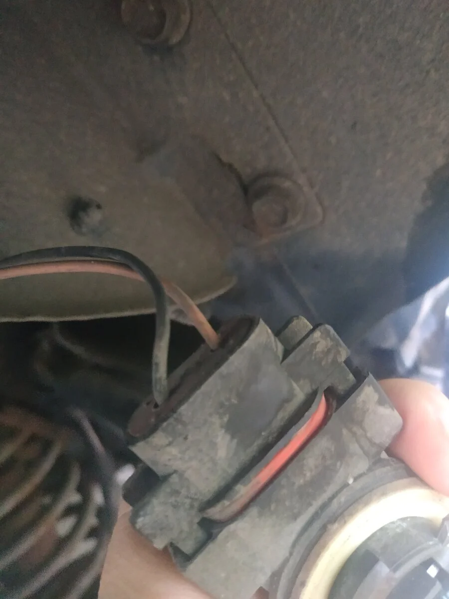

Parking lights not working on my jeep. The back parking lights work no problem. The fronts work only as turn blinkers and emergency blinkers. I cleaned the connectors, still not working. I noted some jeeps have 3 wires while mine is only 2, could this be the reason of absent parking lights? IMG_20200704_150501.webp

Are those the front turn signals or the sidemarkers? Sometimes the sockets go bad. I've had to replace a couple.
Are you using LEDs anywhere in the system?
Yes its front blinkers, not sidemarkers. The headlights are cheap led lamps from china. I installed it as i had plan to install 90ies japanese yellow fog lights, it pretty rainy and foggy here, i dont need headlights.
I'm not familiar with how the international models are wired, but with the domestic US models, the sidemarkers have to be converted to a 3-wire setup in order to put LEDs in the front.
Try flipping the LED bulbs 180 degrees in the sockets and see if that makes a difference. Many cheaper LEDs do not have a rectifier, and will only light up in one orientation. If the socket is designed to flow both ways, that could cause a polarity issue, preventing one function from working properly.

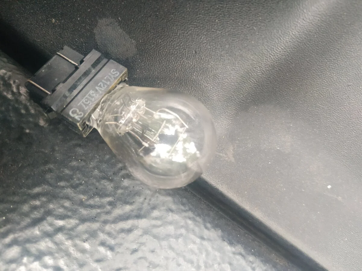

Here is the lamp itself, its not led inside blinkers, only headlights are led. Parking lights didnt work even with halogen hella headlights. There are 2 core springs insideIMG_20200704_150520.webp
Also i guess my problem is with wiring it has only 2 wires, all the threads with same problems had 3 wires. I will try to connect parking lights with headlights on relay
Here is the lamp itself, its not led inside blinkers, only headlights are led. Parking lights didnt work even with halogen hella headlights. There are 2 core springs insideView attachment 174448
Interesting. The headlights shouldn't affect the circuits, at least with what I'm used to seeing.
The best recommendation I have is to look at the wiring diagrams in the FSM, particularly for the international models, to figure out how it is wired.
