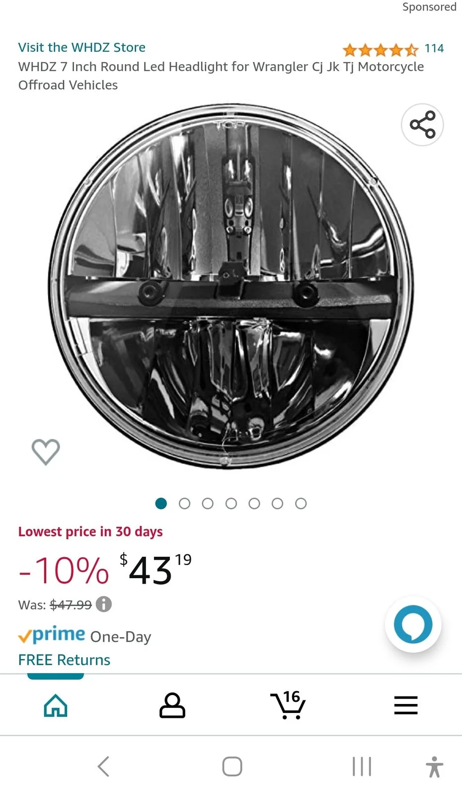

You didn't answer my question about which headlights you have, but I think I have a hunch why your Chinese copy TruckLites freeze over where my real ones don't.
Actually, I did. In post #24 above. Perhaps you are right, but I don’t think we have enough information to tell. Quite possible your climate is cold enough in Colorado that your snow is much “drier” than what I experienced last Sunday night. Colorado IS known for its dry snow, after all. I have driven with these lights in heavy snowfall several times in the last few years, but the snow in SoCal San Bernardino mountains, in the White Mountains around Owens Valley, and the Bradshaw’s here in Arizona, has always been dry enough that it never stuck or built up like this did.
Colorado has all kinds of snow in all kinds of weather. I have never heard that it is known for one type or another. And I have been running my headlights in all kinds of snow for many years.
One thing I know about LEDs is that they produce a lot of heat, which is why we often see large heat sink fins on them. We also know that Chinese copies of things are often less than honest about what they actually do. And we know that Chinese headlights often don't put out as much light as they might claim, which means your WXYZ lights aren't putting out as much heat as the real thing does. That is the real problem that you are trying to solve with a bunch of nickel and dime fixes.
