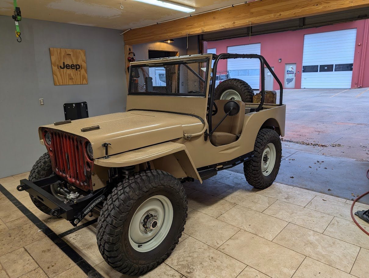

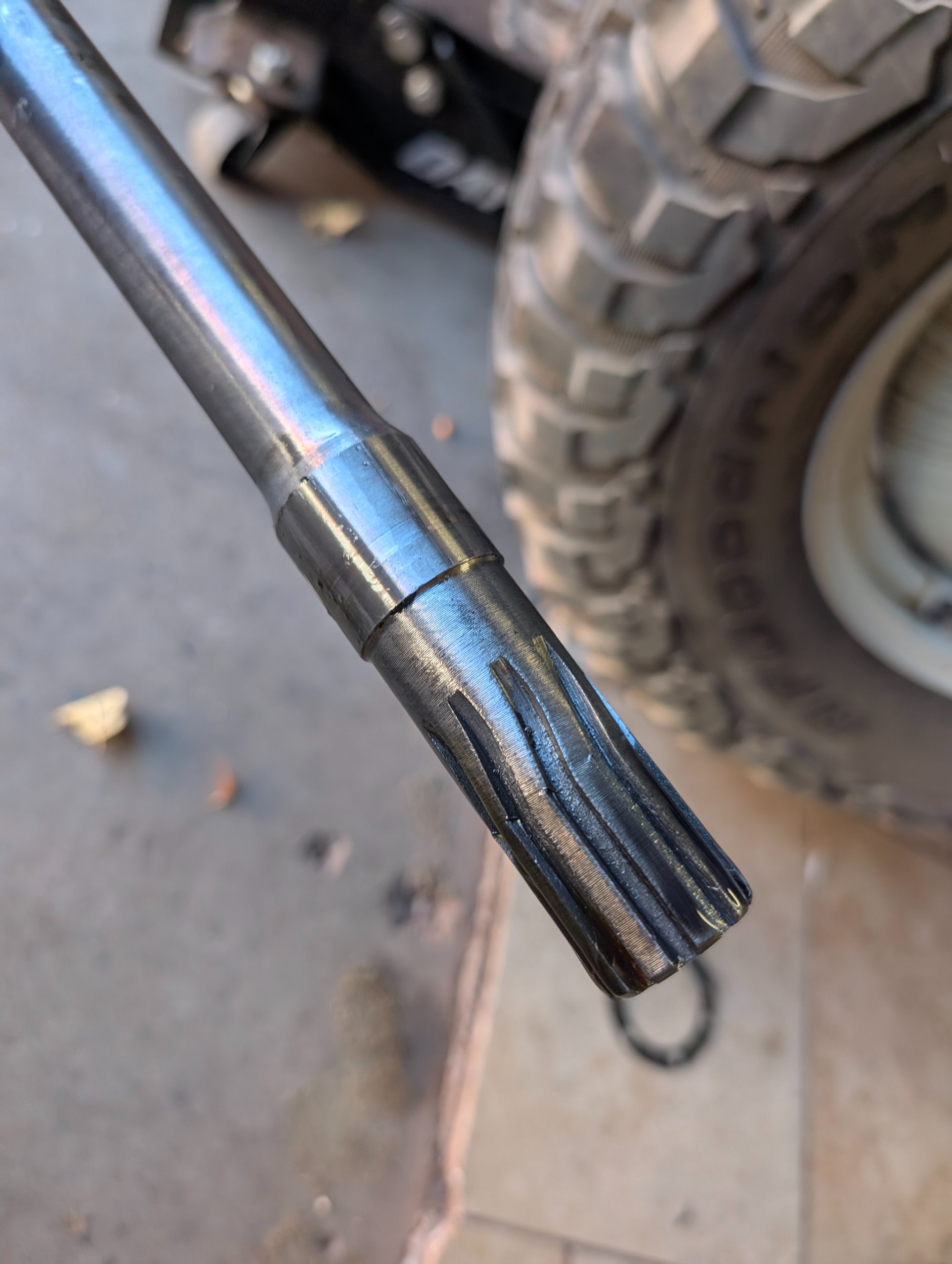

I have a little old flat fender... a 1942 Ford GPW. one of the weird Ford ones. and in the rear of that little jeep is a dana 27. That axle was fine for NDT tires, no lockers and stiff suspension, but that's not how I build mine. Mine has a 7.5R16 BFG mud terrains that get fantastic traction, and LockRight locker and a very very flexy 4 link/cantilever/trailing arm rear suspension. The result... I've broken two axle shafts in less than 500 miles of moderate off road.

But your problem hasn’t been differential strength which brings up the question: can you get upgraded D27 shafts?
I cannot find anyone that's sells chromolly shafts for my axle. It's got a 7 1/8 " ring gear and 10 spline shafts.
