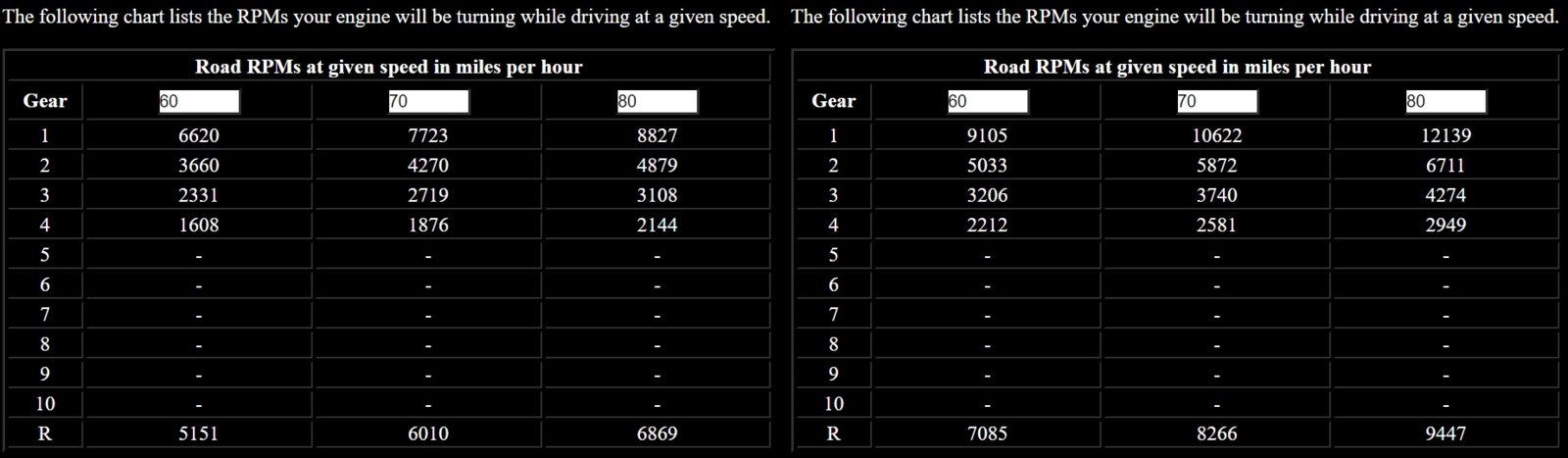

Yes thanks, I did know I had to change both front and rear. 5.13's put me in a higher RPM on freeways how much more anyone know? I am afraid to get to high of a gear also, no?
(assuming automatic trans) 3.73 on the left and 5.13 on the right courtesy of http://www.grimmjeeper.com/gears.html. overdrive at 80 mph with 5.13s puts you at ~2949 rpms. I've driven at 3000-3500 rpms on the freeway for hours at a time for the last ten years without any mechanical concerns.
