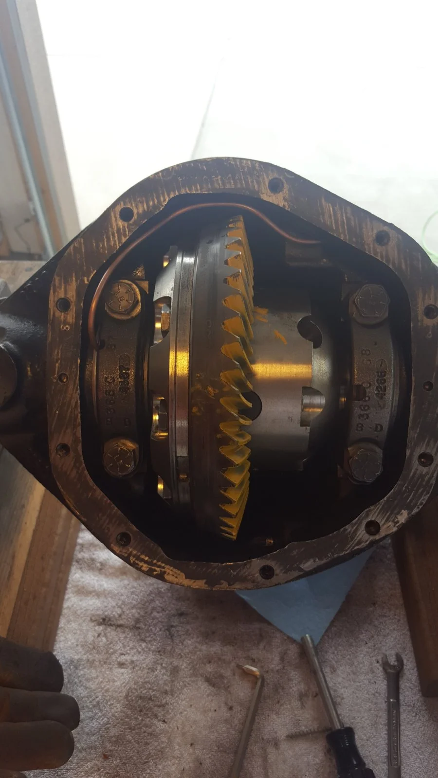

So if a shop put in my dana 44 as a used rear end would I have a 30 spline or a 35 spline or would it be unknown with out taking it apart?
Probably a 30 spline. It’s easy to remove a shaft. Takes about 15 minutes for mine with disc brakes.
Reactions: jjvw
If you had 33/35 spline axles you'd have a locker already. There are no 33/35 spline open carrriers/spiders.
Interesting. I dont know if it dont have an auto locker or not or some traction device. I could jack up rear and spin a tire to see if other side spins same direction or not. Sometimes driving it seems like there might be something there. Jeep is only three weeks new to me. I put lift, bumpers etc on or had it done. But interesting to know

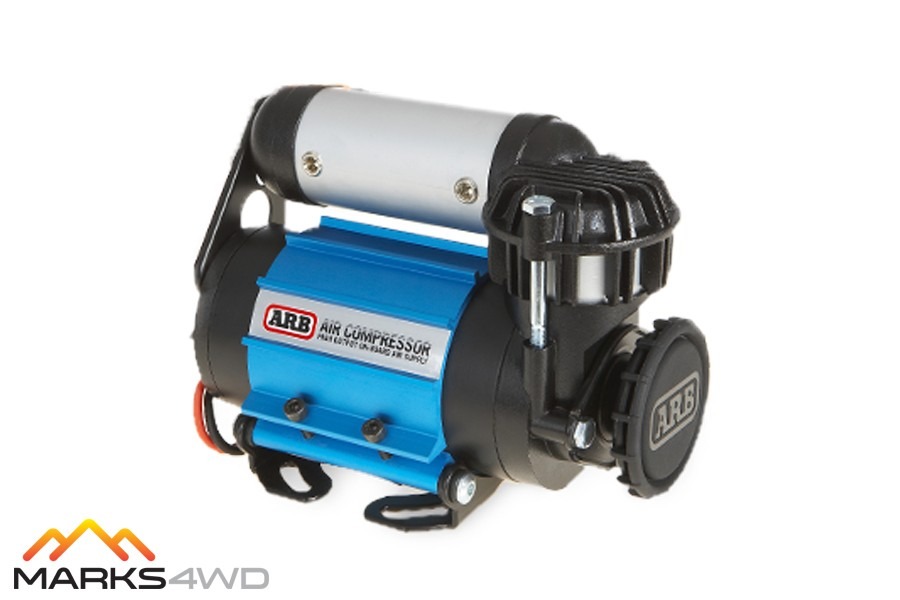

...if you want that same reliability in an air compressor? Get the single standard ARB High Output Compressor

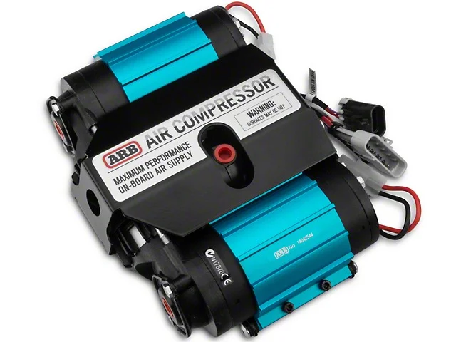

Don't bother with this duel setup pictured below, it might be quicker but half as reliable when compared to the standard model above, it stands to reason that two compressores are twice as likely to fail.
Most air compressors I've used are not very reliable, particularly in hot dusty environments like the land down under, I've killed a few compressors - yes even an early model ARB - and suffered the long slow trip to the gas station once too often, heat & dust kill compressors, the new ARB High Output Compressor has been designed with this in mind and why it's known down here as the bees knees.
It's compacted, fast enough to inflate a set of 33"s and easy to service.
HOT TIP: On a hot day dribble a little water over it when blowing up tires to help keep it from overheating, as especially if it's mounted under the hood and don't try touching it, they get hot, really friggin hot!
