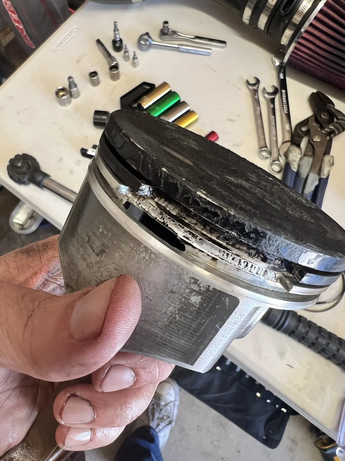

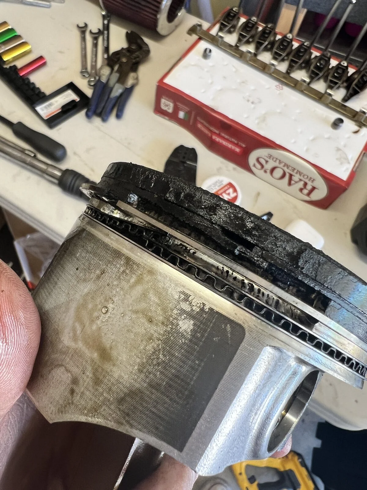

  • Check the gap on your piston rings thoroughly...if you don't, you might just lose a cylinder or more!

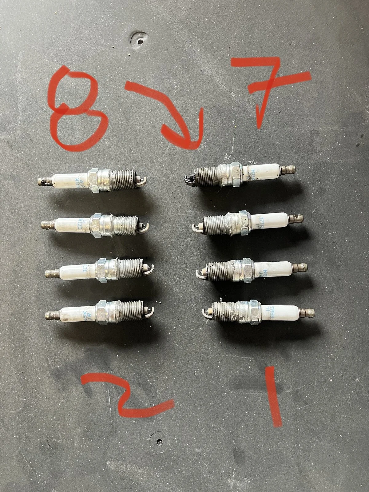

    • This happened recently. I had replaced the pistons/rings and all bearings some time back, and I started noticing that the Jeep was consuming oil at an alarming rate (and wasn't leaking it out). Pulled the spark plugs one day just to see if something was amiss...and cylinder #7 (driver side closest to firewall) was the winner! (pic below)
    • Ended up doing a compression test on all cylinders and all were good except that one...I think I maybe registered 10psi at one point. Pulled the head and literally popped the cylinder out (had no tension against the cylinder wall - pic below). Luckily, there was no damage the cylinder wall, so I bought some new rings and a piston...and popped it back in. The difference was staggering. That thing must have been jacked up for a while and I just didn't notice it or thought it was because of the tune. Whatev...it's fixed now.
    • Moral of the story...always check ALL the rings. I'm pretty sure I checked like 4-5 of them when I did all the pistons, and they were exactly the same, so I was like "must be all good"...yeah no.
