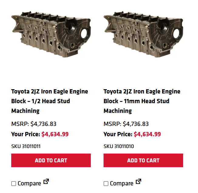

Can't wait for someone with a 5 axis mill to make billet 4.0 blocks with sleeved pistons.

Most people would not spend that kinda money on a 4.x so producing it likely wouldn't make sense. That being said, if you make one for $1500, I'll buy it tomorrow.
