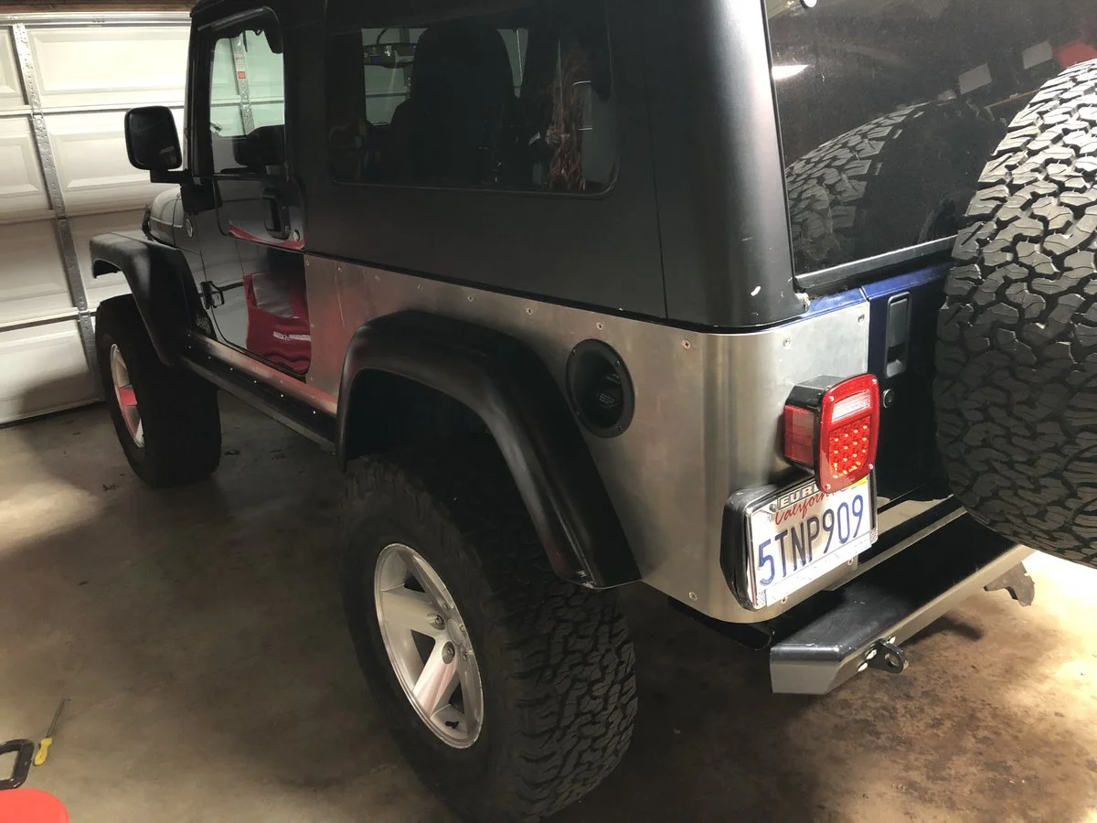

One side down today, one side to go.
Was quite time consuming having to locate and drill all the OEM flare holes. But we got through it. Ended up making them all quite a bit oversized to give us room to adjust.
It’s a shame to cover up that pretty midnight blue color !
Agreed! Don’t worry this is just the test fit to get all the holes drilled etc. I will be pulling the slider backers and corner armor off and getting them painted Midnight Blue to match the rest of the jeep. :)

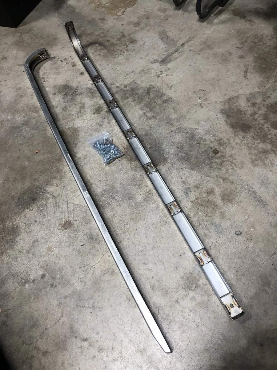

Savvy tub sliders came in.
It looks like the back corner of one of them will have to be cut off in order to make them work with the Morryde hinges.
I am still undecided if I am going to install them at this time. But it’s looking more and more like I will. The protection would be nice and holding them up to the Jeep they look very nice.
You'll never regret installing them and not using them. Can you say that the other way around?
