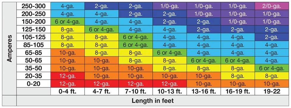

That seems overkill? I'm running 10ga to 300w amps.
Edit: Then again I am only running 1ft at most. @Midnight LJR Are you running from the battery? I'm going to leave this here: https://www.amazon.com/gp/product/B00SE6Z2WI/?tag=wranglerorg-20
I was planning to, is that wrong? The only thing I am worse at then stereos is painting.
