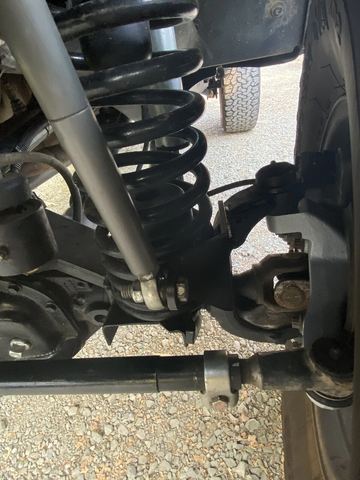

I was crawling around the vehicle taking pictures of everything and it was like an easter egg hunt. I was like “there that’s everything.” Then I spotted the flipped tie rod, and was like “oh ya” then I thought I got it all again and spotted the hidden trailer plug in and it was like a real surprise. I was all “That’s Awesome!“

Flipping the tie rod in your case is akin to "just raise the rear bumper 1.25"". Both sides were completely disassembled and the upper ball joints pulled to weld on the raised swaybar link mounts.
Funny how such a simple sentence involves so much work.

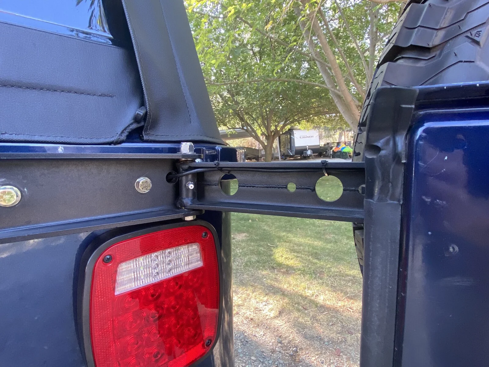

Before anyone picks on the fuse holders (and you should) we do not have a fuse holder solution we like and we've seen most of them. None of them are clean or look like they belong under the hood of a Jeep so if anyone has an example of something cool, post it up.
First off, very nice work on the jeep.
What about a 3 or 6 circuit weatherproof fuse block from Painless Performance?

Blaine’s comment reminded me. I didn’t post pictures of the new sway bar mounts.

I probably have 5-7 versions of that, plus relays plus other crap and none of it fulfills my sensibility requirements of how it should look and function. I have the cheap stuff, stuff from Blue Sea, etc..
