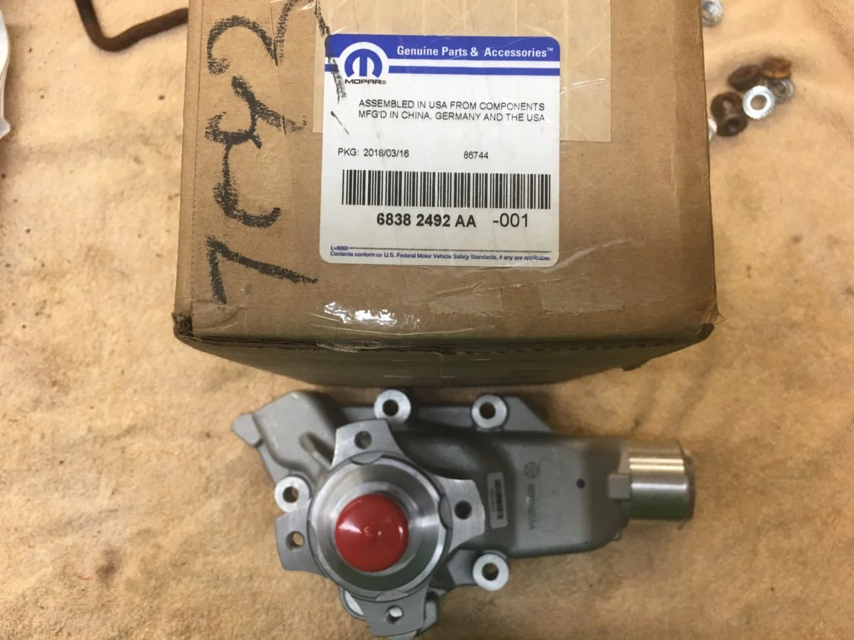

Does the MOPAR box state where that pump is made?

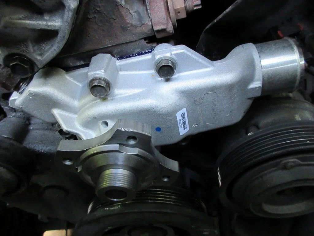

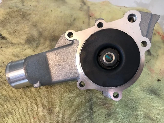

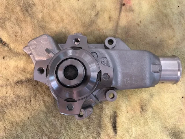

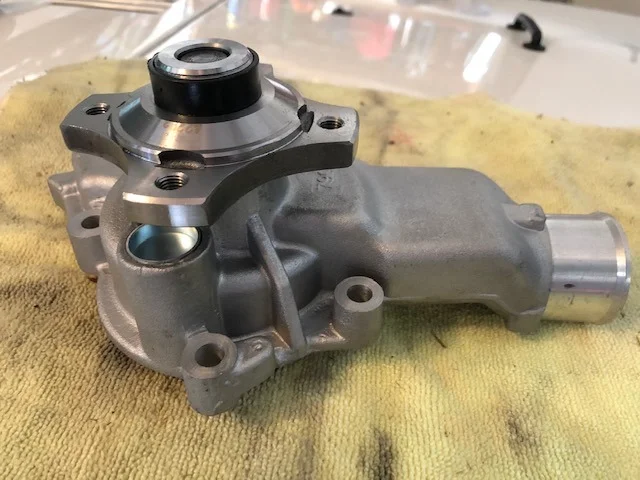

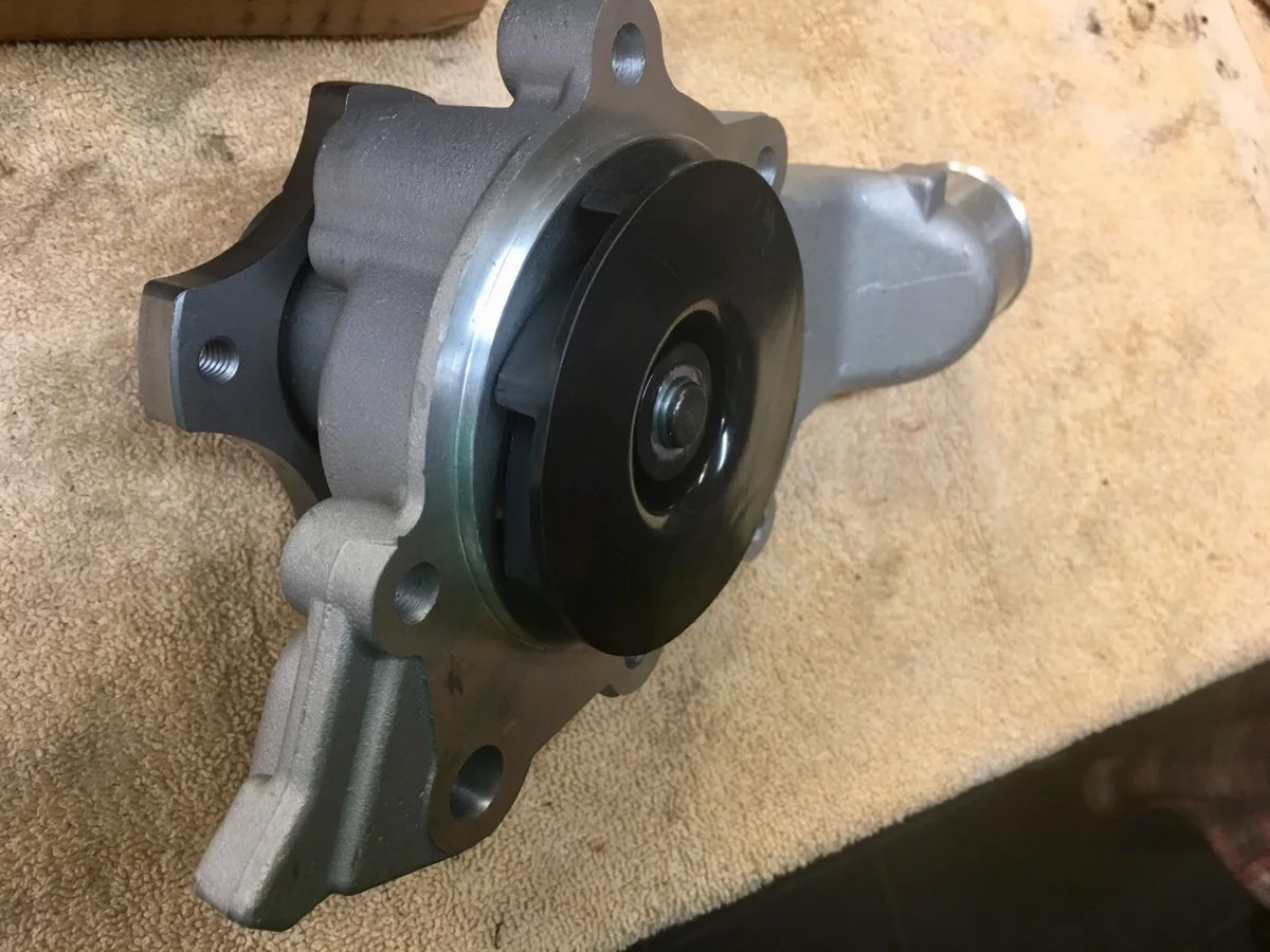

Finally got the system back together. What a mess. During the middle of the cooling system OH, I had to send the jeep to the shop to get the frame repaired. Safetcaps on both sides about 70% of frame replacement. I got the jeep back to finish the cooling system. I had a helper and we discussed the length of bolts when installing the pump. I had a leak and took the thing apart. Found the long blot (should be top) in the lowest hole. Cleaned everything, (x3) installed with Gasket, Gasket and RTV, RTV only and still leaking.
I pulled the pump bolted some plexiglass to the front to check the lower bolt hole for a crack into the water journal. All good, so it was either my my install sucked (never out of the question) or the pump was leaking. I went to the local Oreilly's and rented their radiator cap pressure tool. Pressurized the system and sure as shit it was leaking at the bolt hole.
Gates aftermarket pump had a crack internal to the hole and heater tube inlet. I went to my local MOPAR store and got a OEM water pump. I opened it and it looked exactly like the Gates. I told the parts guy what I had just gone thru and he was surprised, he said if not OEM, then he uses Gates as well. So now Jeep is running great, No leaks and cooler. It never deviates from the dot above the 210 mark.
I know there are many that will say (and do) that you should only use OEM and I don't follow that train of thought all the time. Would I use a Gates again. It depends on the application. On a Jeep (mine), yes. But only because it is so easy to replace the pump. I didn't have another Gates so I had to go to OEM. Although I have never met anyone from this forum, I could hear Mr Blain, Chris and Jerry, all sayin in unison, "We told you". All I could do was laugh and drink another beer and listen to my wife ask if I needed to take it to a shop for mechanic to look at it. GGRRRR. I am a fricken Mech Women!
