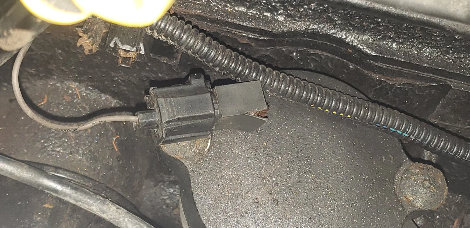

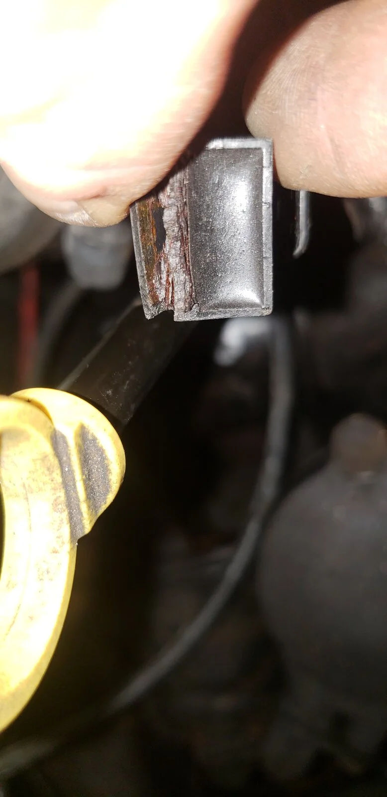

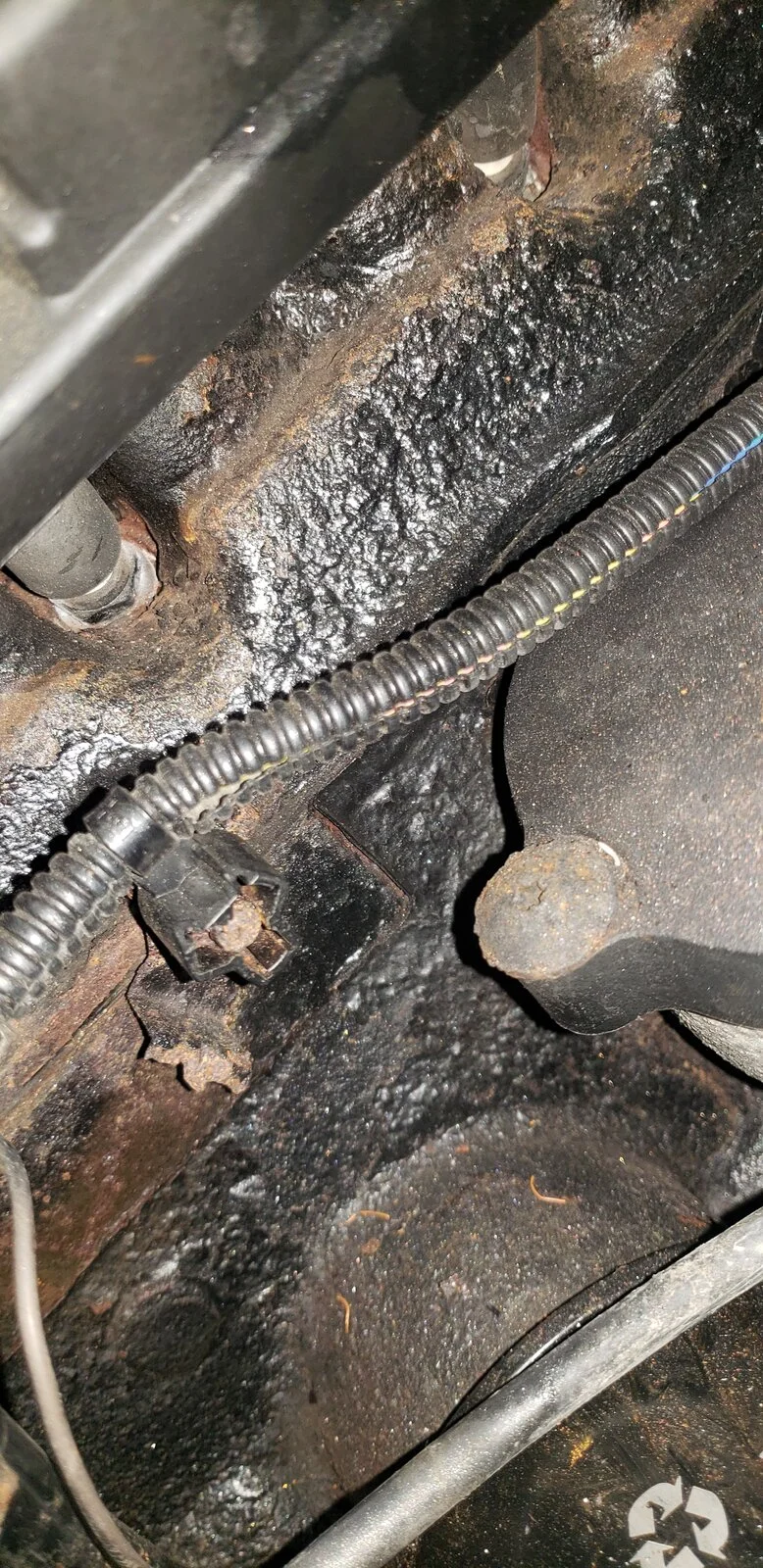

Could someone explain to me what could be causing my ASD relay to click open/close a bunch of times for about 5 seconds and then go off? I also hear a buzzing noise as well whenever I put the key into the on position. Also I looked on my old Wrangler and notice that this part has broken off of my engine on my current one. I'm guessing this is some sort of a ground but to what I have no idea could someone please elaborate? I'm including a couple pictures of the piece that I found dangling and where it came detached from the engine

Could someone explain to me what could be causing my ASD relay to click open/close a bunch of times for about 5 seconds and then go off? I also hear a buzzing noise as well whenever I put the key into the on position. Also I looked on my old Wrangler and notice that this part has broken off of my engine on my current one. I'm guessing this is some sort of a ground but to what I have no idea could someone please elaborate? I'm including a couple pictures of the piece that I found dangling and where it came detached from the engineView attachment 219371
That's your ignition coil capacitor. I don't think it has anything to do with your current issue, but you can replace it for about 10 bucks.
