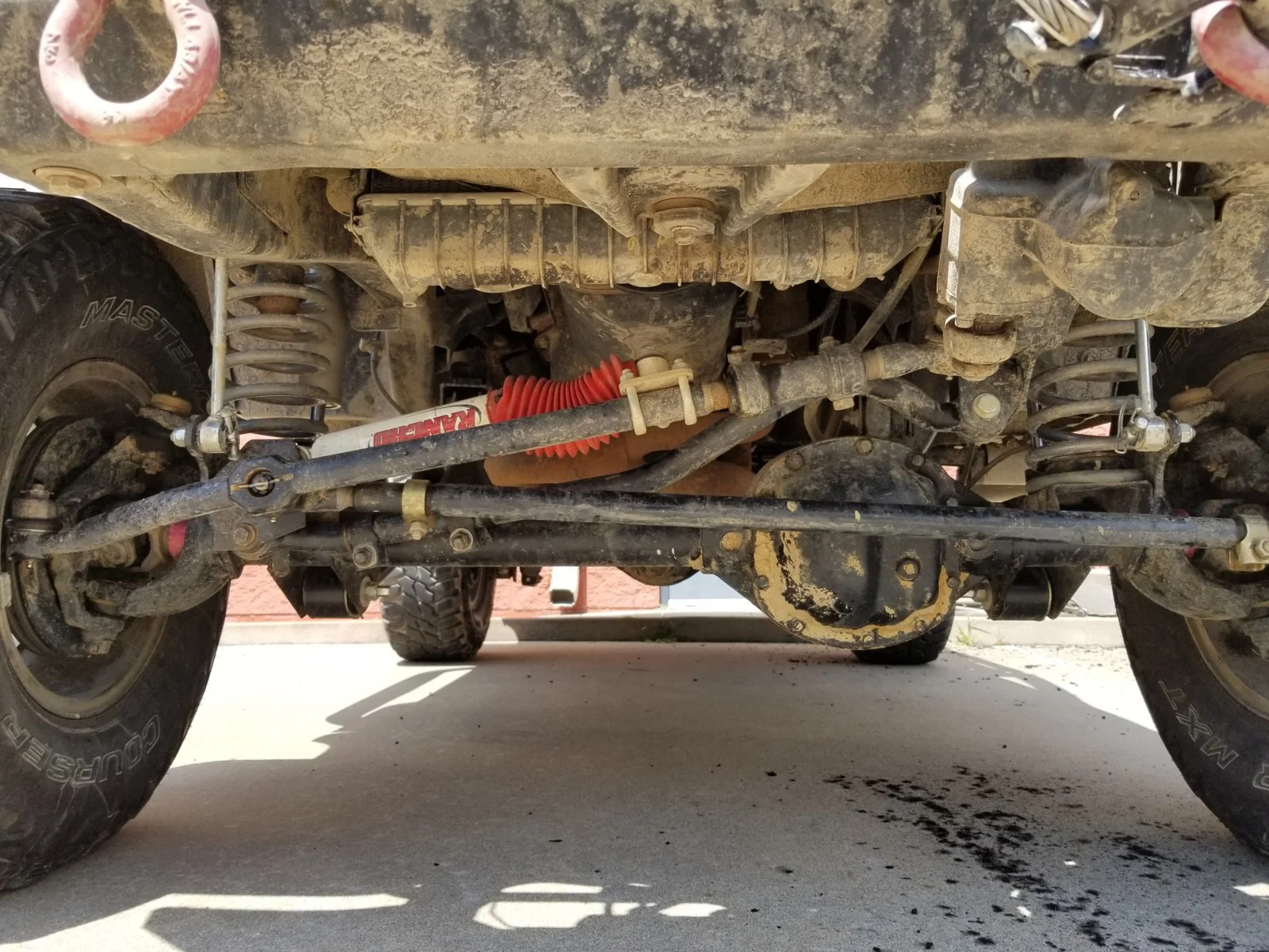

Hello. I am new to forum. Fairly novice to working on my vehicle. This is my 6th jeep now and it is not a daily driver. Not driven in winter only spring thru fall. Anyway, I’ve looked thru forums and other advice and I think one of the first things I would like to add is better steering components. Currie, ZJ tie rod seems good. I like Currie And was wondering how the install is. I think I can do it. I have replaced the oil pan, trans lines, and this weekend pulled the left rear axle shaft and had a shop press in the seals and bearings and then I re installed it. So, is doing the steering myself doable? And what is a good kit and are there any other things to improve there while I’m saving up for the parts? Already installed a rubicon express stabilizer. Thanks much

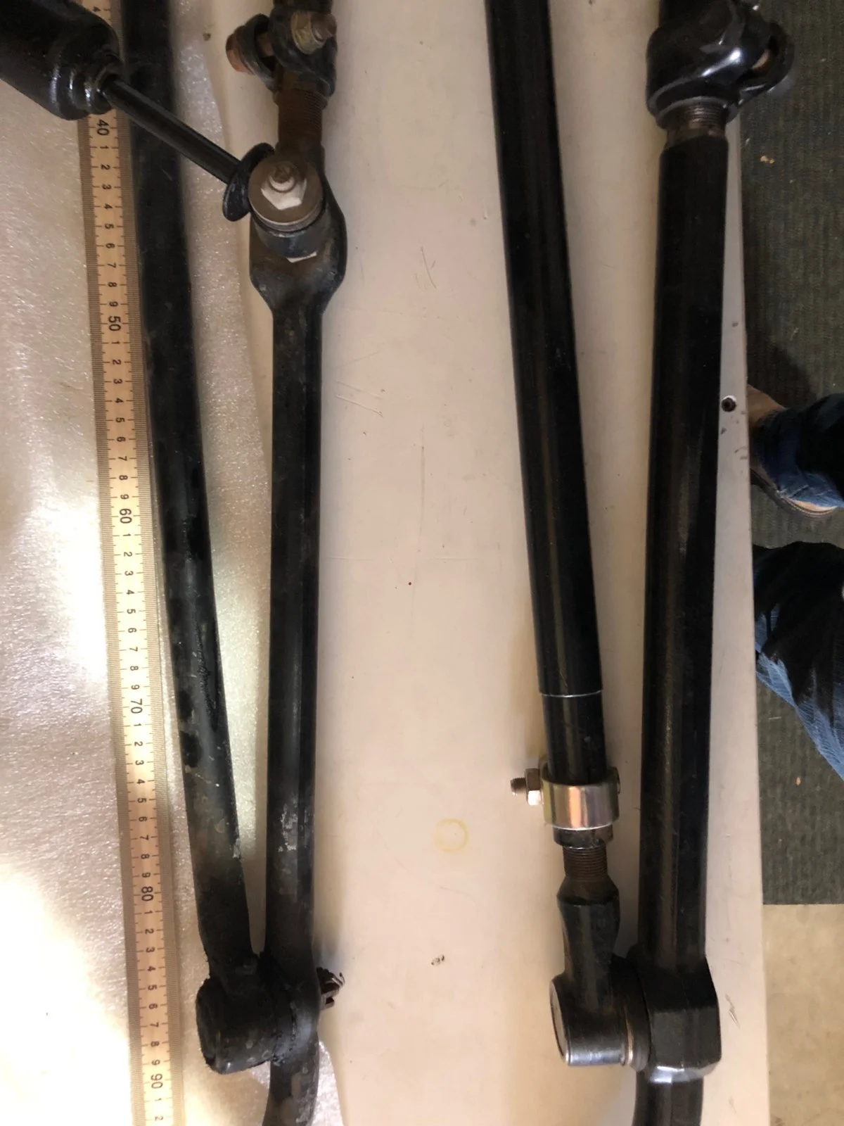

The ZJ steering is a solid upgrade--I wheeled and DD'd mine on 33s for 3 years with no issue until I found a deal on the currie steering.
Heres the difference between the zj and the currie steering though. Its a monster.
for the pic. I may save up for the Currie depending on other things I want to update. I’ll inspect the front brakes and if they need to be replaced I will put money there and get the crown kit for steering. If they are ok, I will most likely get the Currie.
