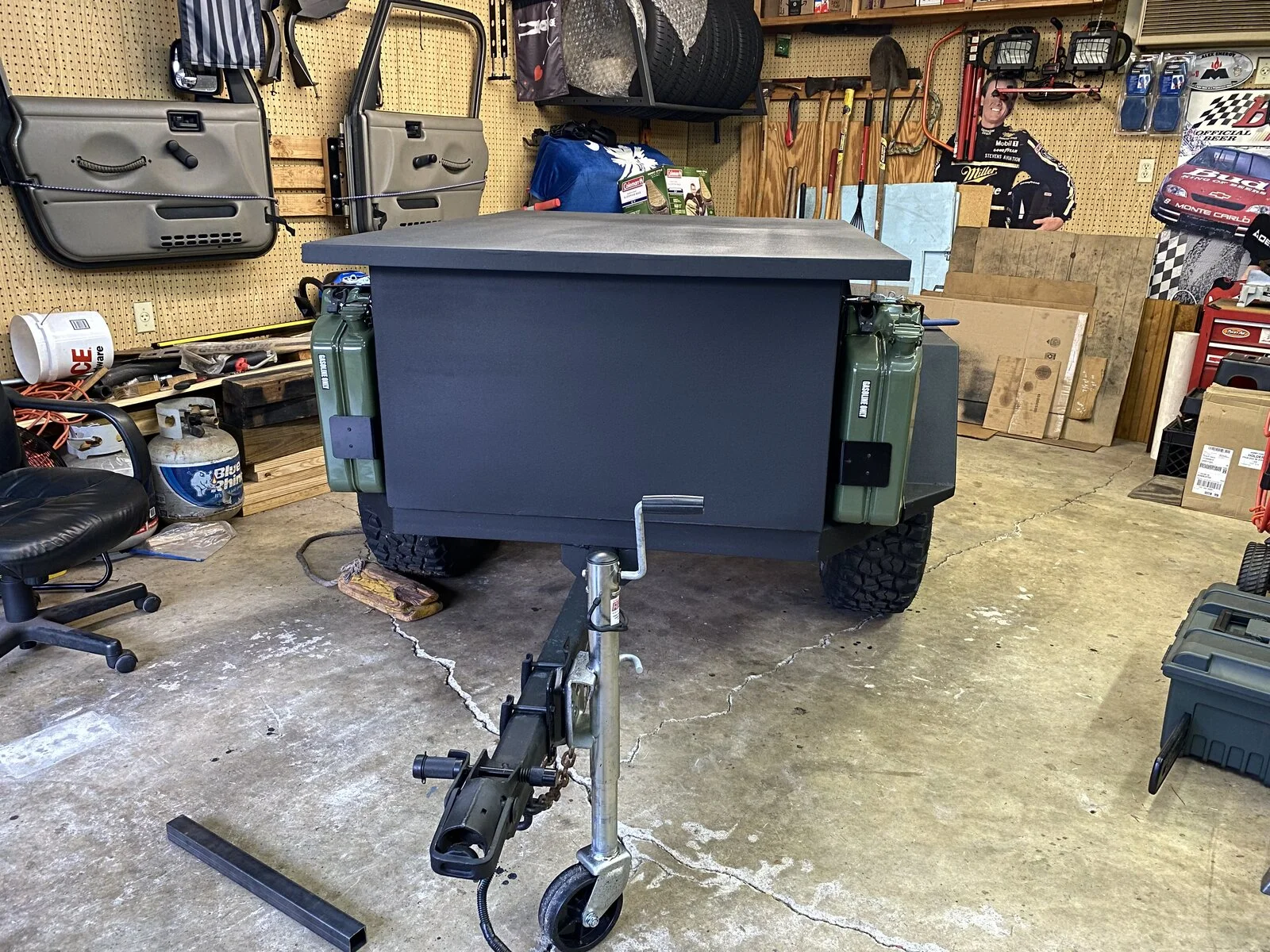

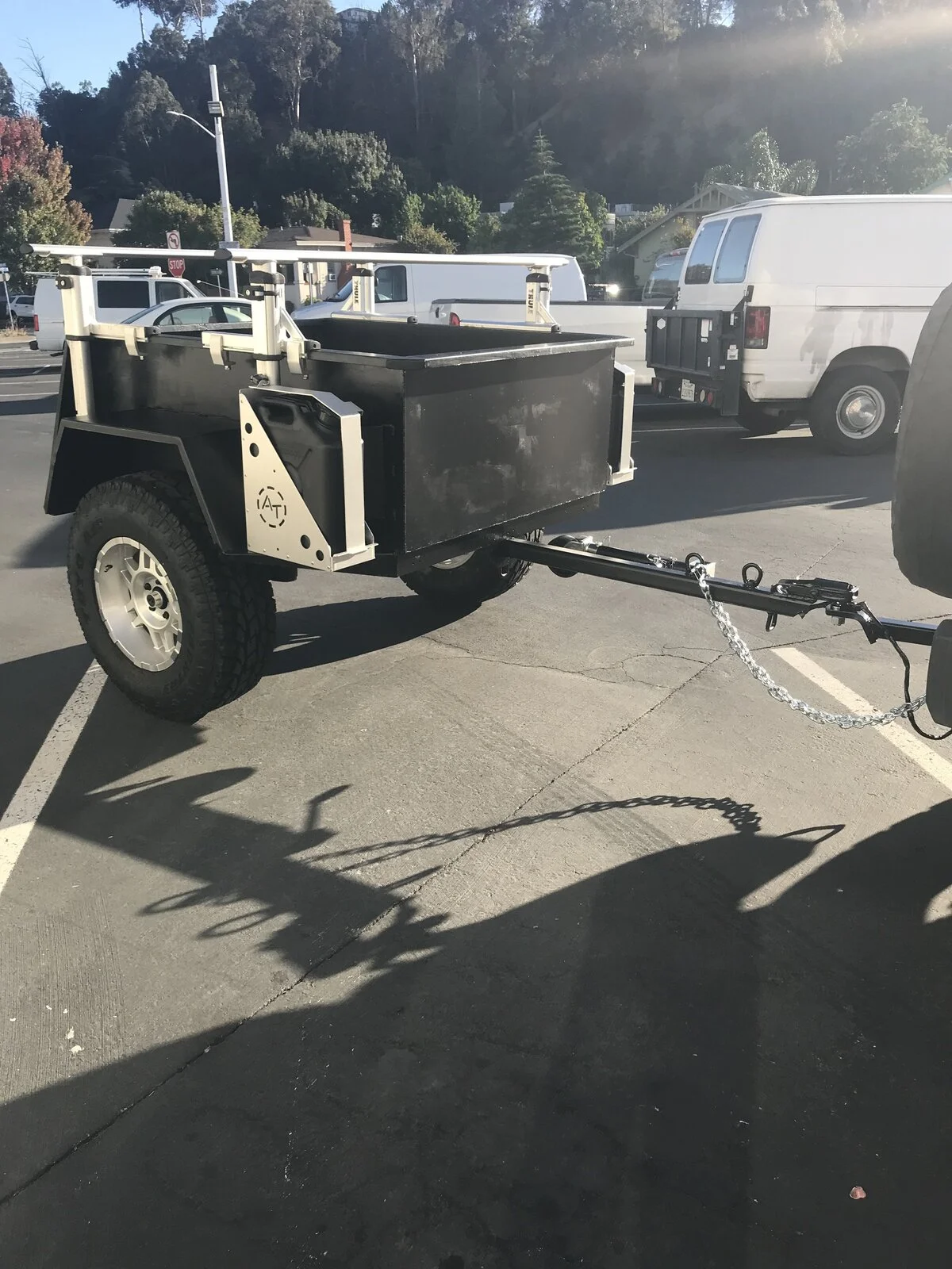

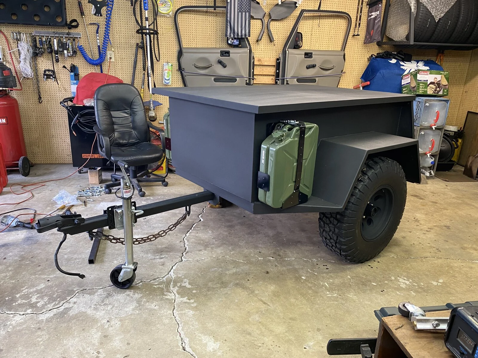

I thought you Pack Mule guys might like to see this one which was posted on the Expedition Portal forum today. Too bad it's just the one pic.
Two of my trailers are posted just above it (#655) and the build thread(sort of) for the first one is included in my signature.
https://expeditionportal.com/forum/threads/collection-of-trailer-builds.52549/page-44#post-2999742
I’ve just got random bolts and nuts holding them in right now. I ordered some stainless steel hardware. Button head cap screws to install from the inside of the bed so stuff won’t get hung up on them.

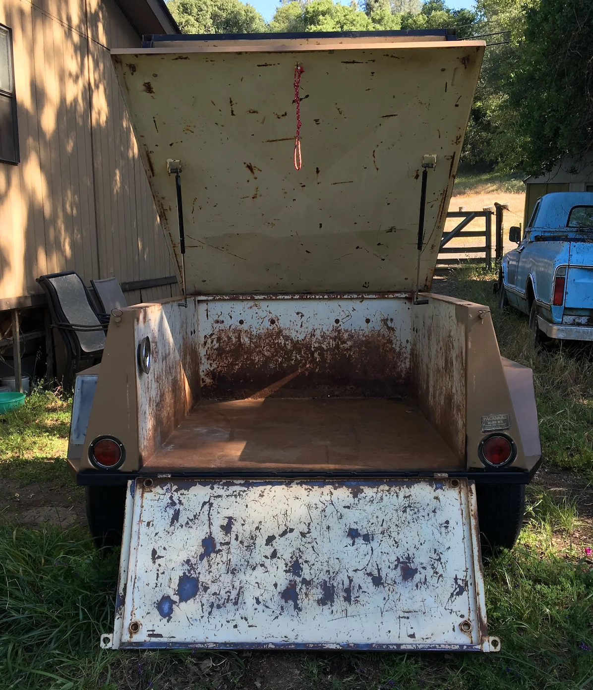

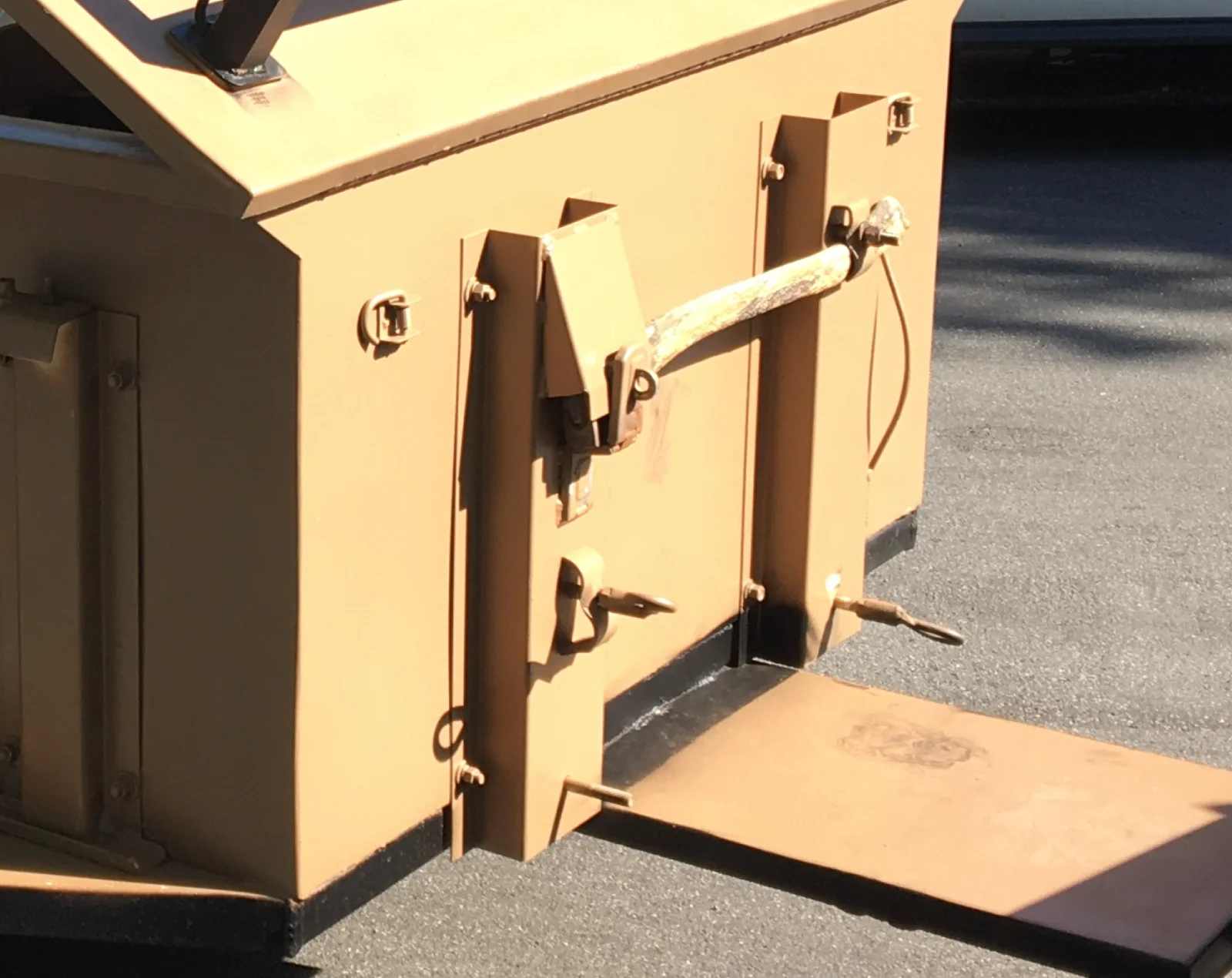

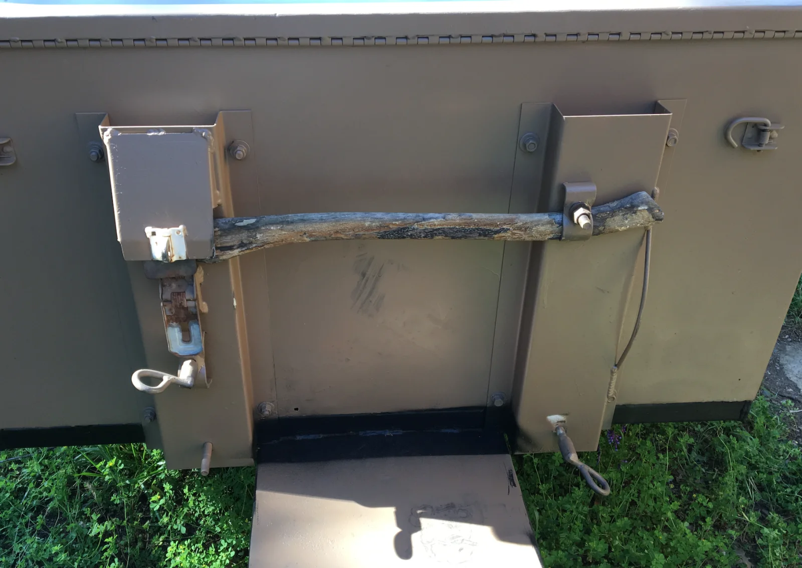

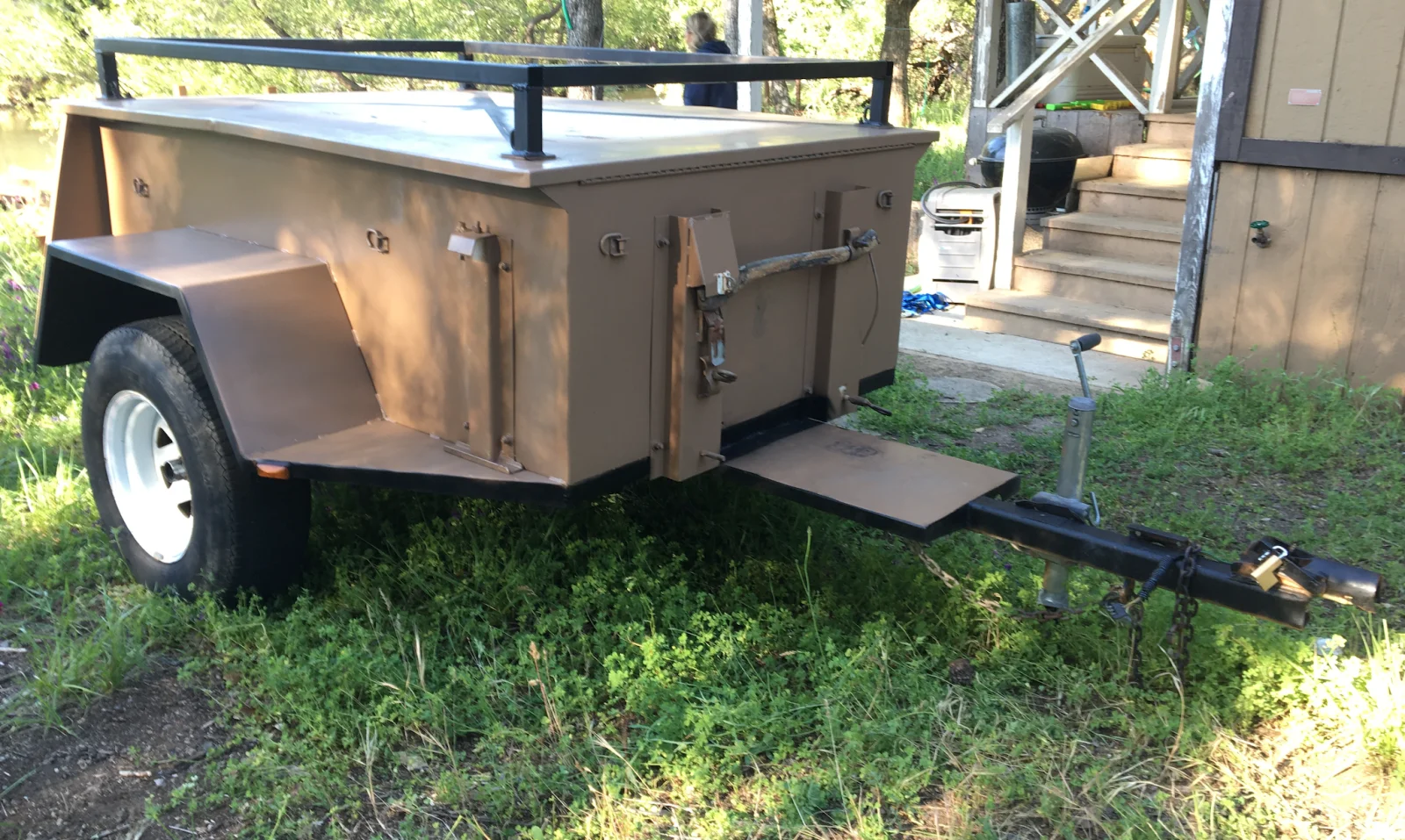

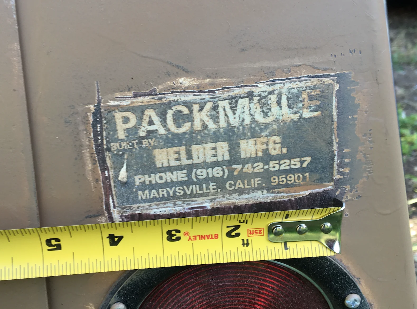

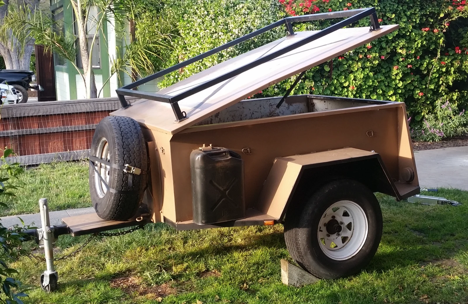

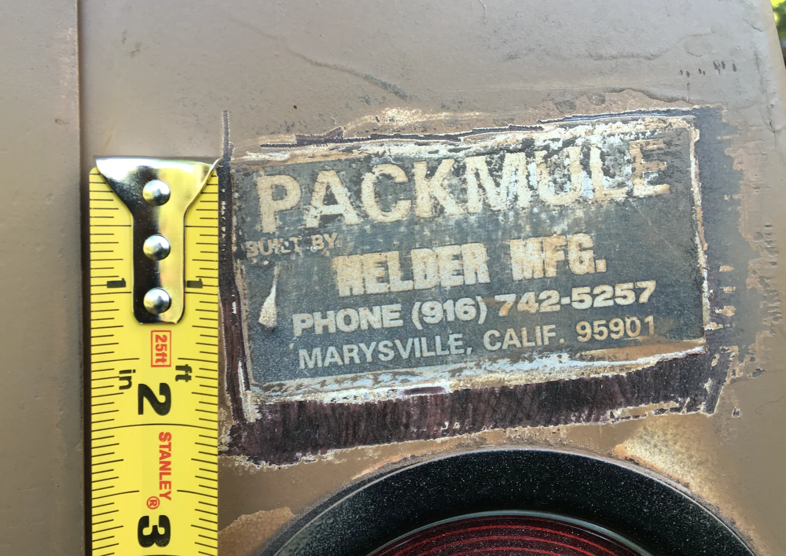

Posting my pics here, just to add to the knowledge base of the Helder... I haven't built it up the way I want to yet, but I had to jump on the opportunity to buy it a few years back... $800 is what I paid and it has a couple options not found on many Helders..
1992 Helder Pack Mule
- Bought from I believe 2nd owner in Northern California
- I feel like this is visually slightly longer/wider than some of the older models, but do not have actual measurements handy.

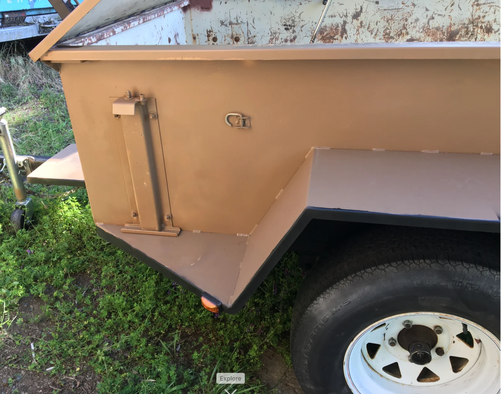

- Jerry Can holders on each side
- Locking axe, shovel and hi lift jack mounts in the front (a cable lock can be run through the tool hold downs)

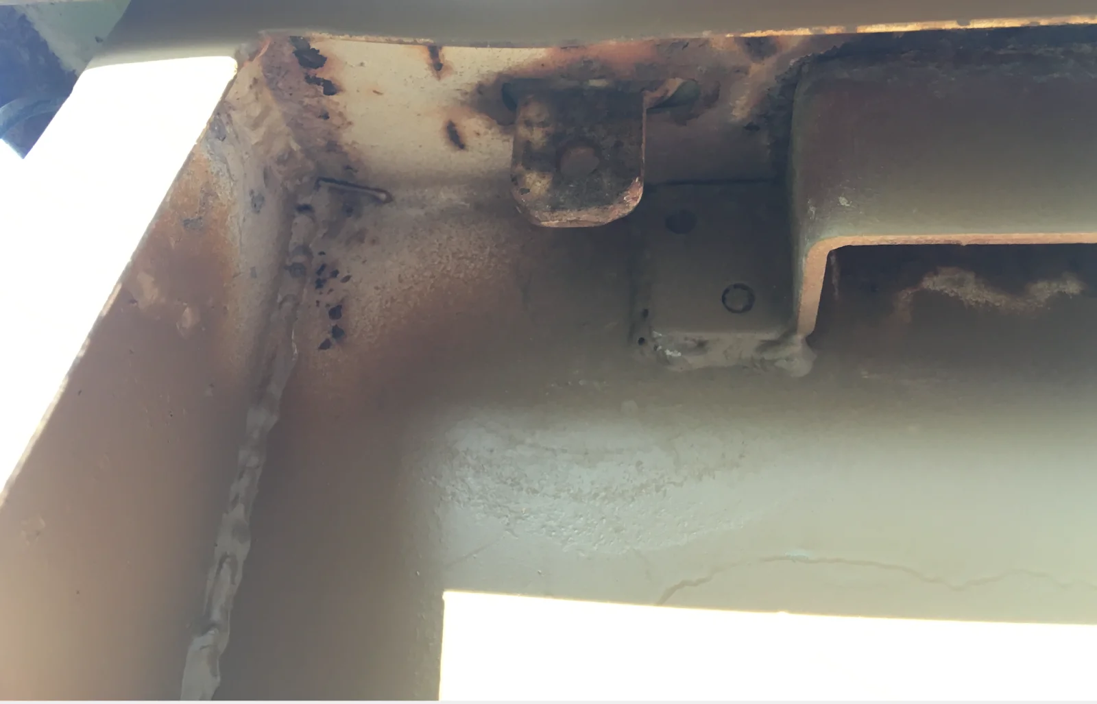

- Hinged, Locking Top
- Roof Rack (unsure if this was factory Helder)
- Leaf Spring suspension
- Tongue Platform (I do not believe this was factory)
- Does not have original jack, but does have original jack mount
- Tie Down spring/hooks on sides/front (unsure if this was factory Helder)

That is pretty cool.
