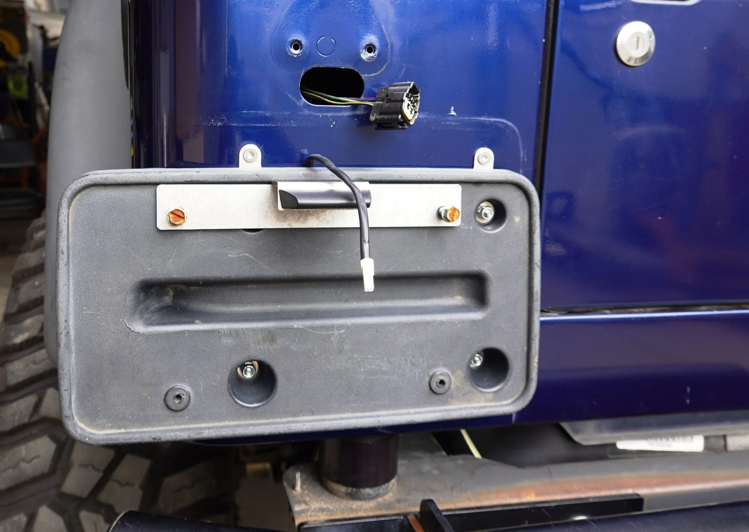

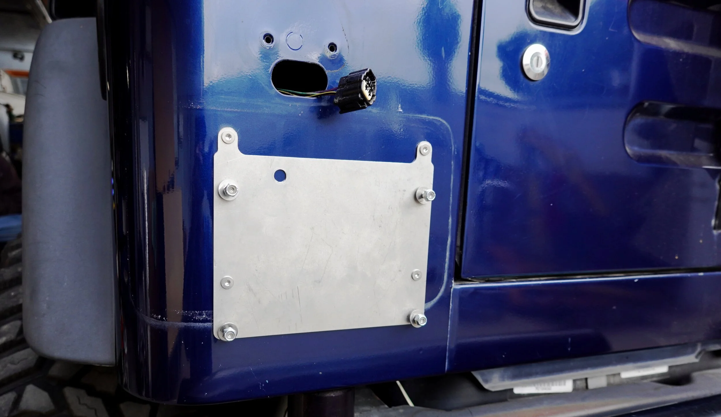

Very simple. Make a plate that has press in studs that point outward to attach the OEM plastic license plate mount to with nuts and fender washers. Offset those down from the original holes enough to clear the tail light housing. Attach with supplied ultra low profile socket cap screws in Torx with a 6mm thread that screws directly into the original holes with a matching thread.

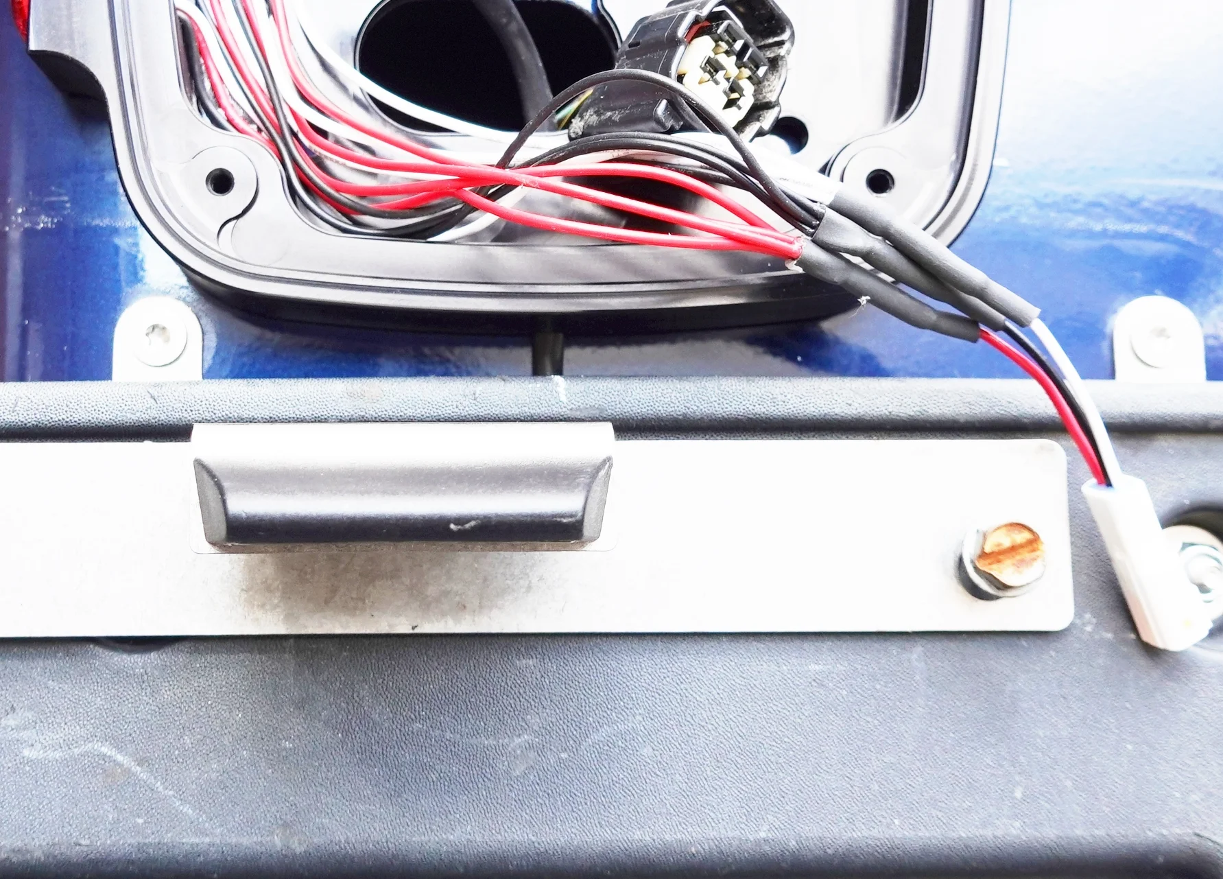

The hole is a drill guide. Some folks may not want to see the small bit of wire that goes up into the groove on the back side of the tail light housing. If that is the case, they can drill the tub, take the plate light wire in that way and then plug that into the harness connector we supply.

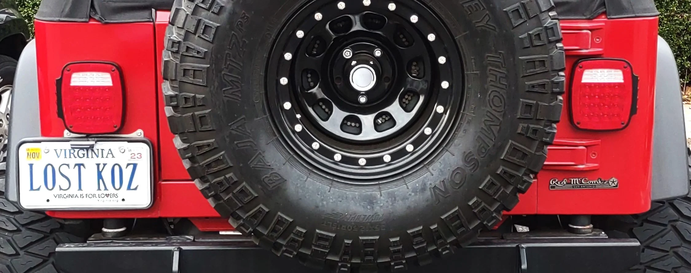

Looks like this when done.

Not going to lie - I was hoping that question would elicit exactly these pics! We'd have to know you had a solution built in but couldn't see it in the other pics.
This blue TJ in the earlier looks like sanded bondo where the OEM mount would be so these previews of the bracket are awesome! Easy bracket to paint black and it would blend or body paint and it would blend.

You can paint, it is just stainless steel so it won't rust. There is no bondo on that TJ.

Figured. That picture was at a distance it looked like bondo -> And my brain said 'Nope, Blaine isn't having you bondo your Jeep.' But I couldn't figure out what you had brewing (and you didn't give us a trailer preview ;) ).
