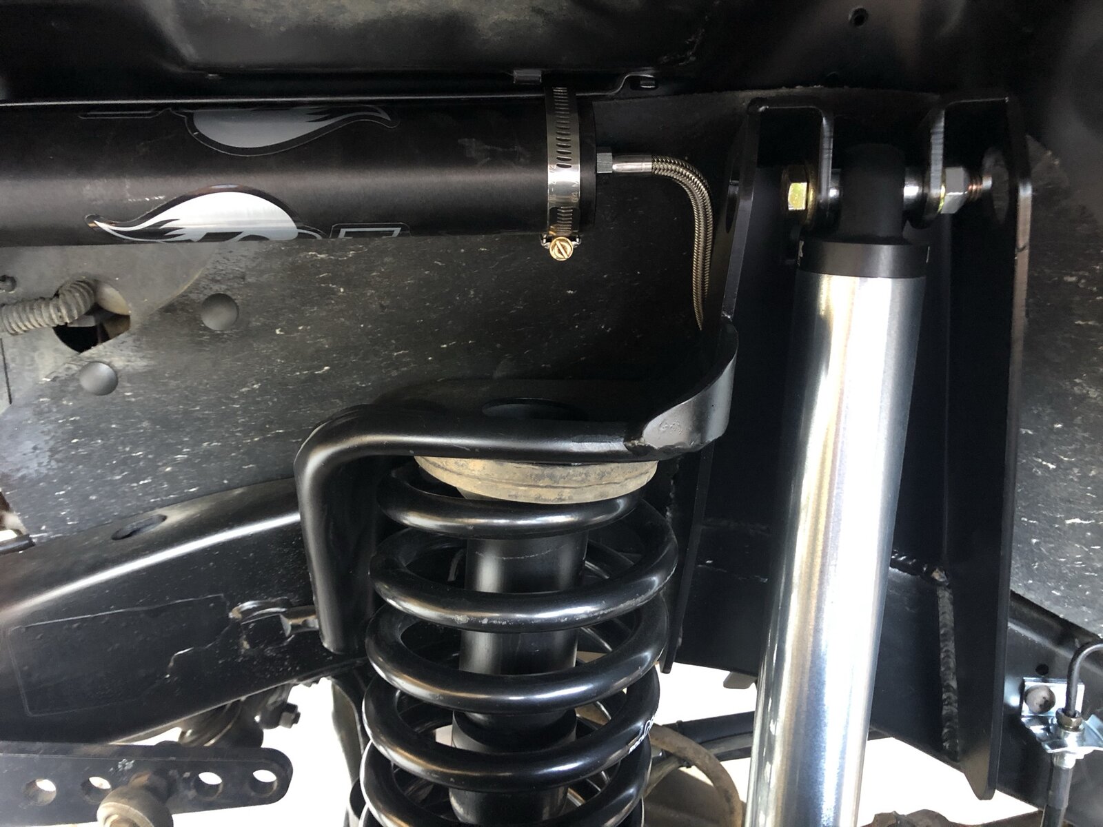

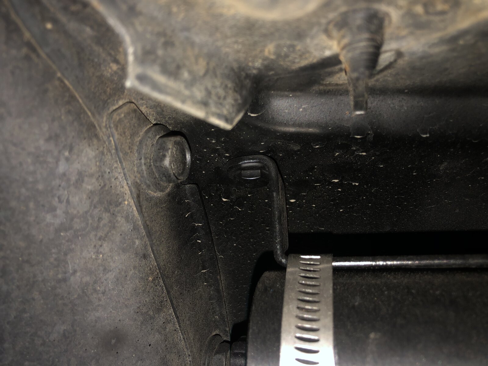

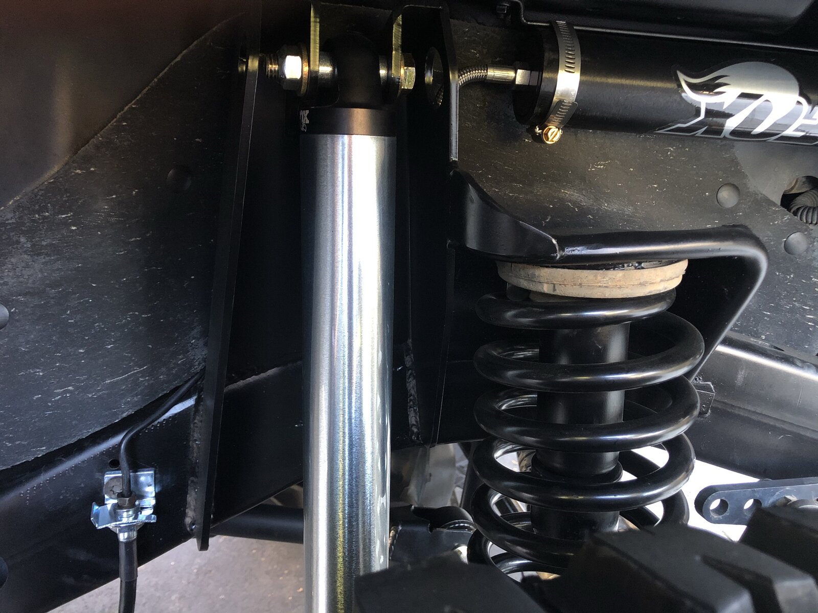

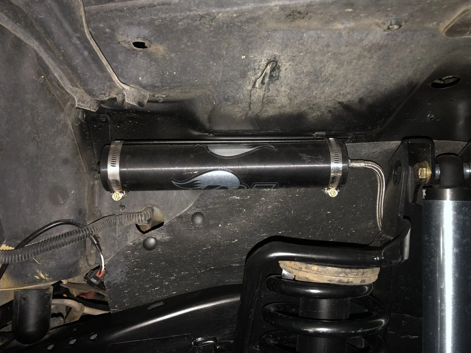

could I get a photo of the mounting locations of the reservoir mounts? I think the back is fairly easy to find but the front is a mystery...
I will get a better one for you in the morning too 👍🏼
Reactions: psrivats
The mount does not need to be that long to hold the reservoir. The length is designed around using the stock air box bolt on the other side but also extending past that weld nut just inside the back clamp so one doesn't have to pull the washer fluid reservoir to drill through the fender. The same goes for the front one. Scope out the top to make sure you don't drill the AC line on the other side and it works for both sides.

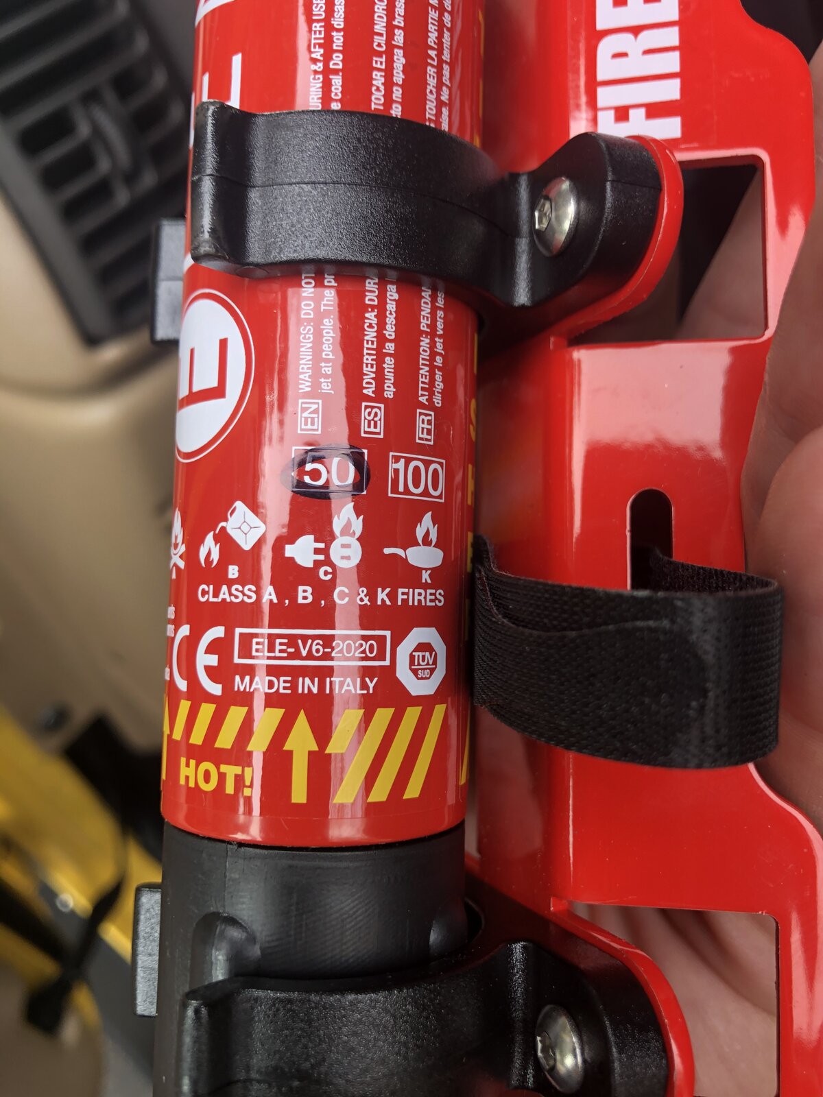

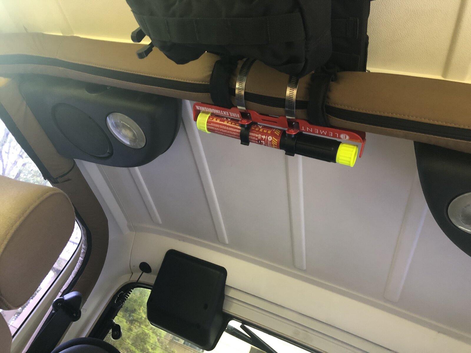

My element fire extinguisher came today after a long wait. Came all the way from the distant land of Canada. I first saw this thing on @Midnight LJR ‘s build thread and keeping with the light and efficient theme of my build I decided a swap was in order.

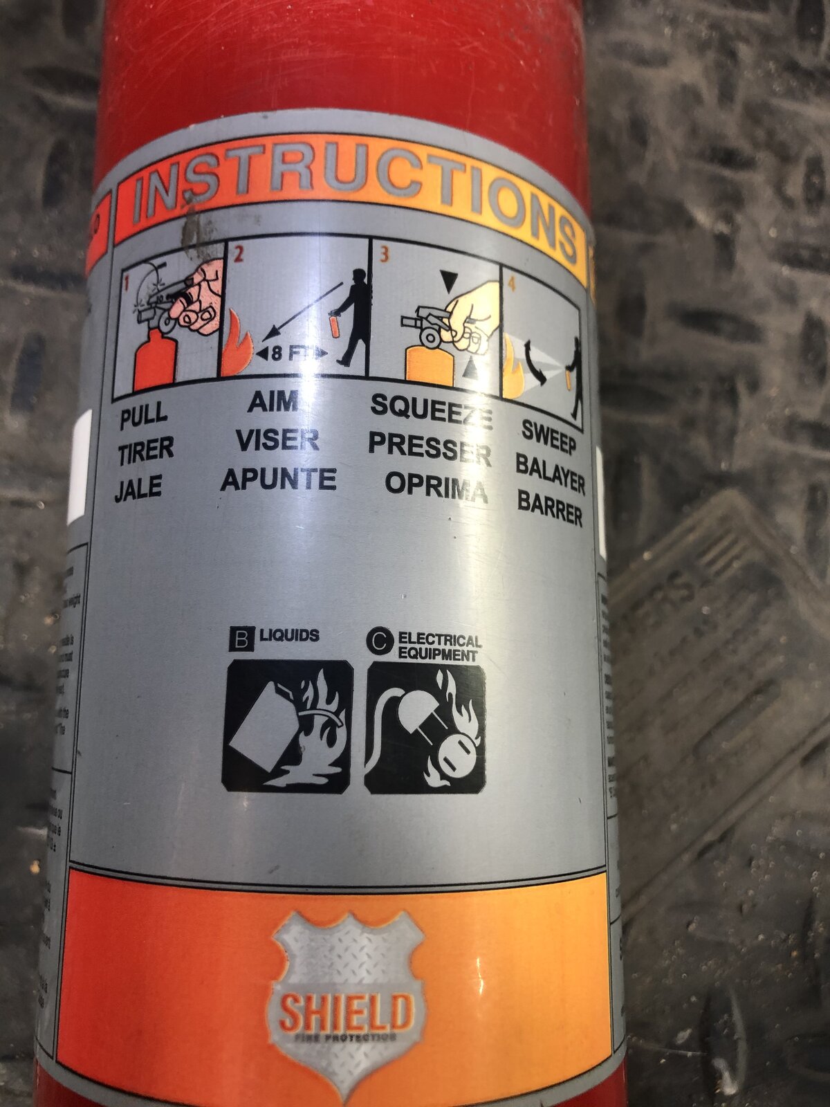

to compare the traditional serviceable 5 pounder obviously weighs in at 5 pounds and supply’s approximately 10-20 seconds of dry chemical agent intended for burning liquids or electrical fires, hence the B/C designation. The element is the size of a road flare, weighs in at a pound not including the mount and supply’s 50 seconds of a dry chemical gas agent and is designed for A/B/C and K fires. A superior product in a tighter more efficient package. Also going off of @Midnight LJR I opted to install it between the speaker pods because it can be reached by all passengers or, with a small hop by short people, from any door on the vehicle.
