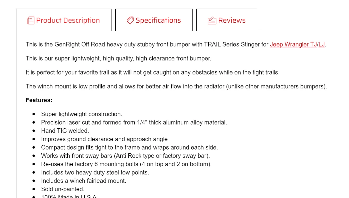

I don't see that anywhere, maybe they already updated? I see they claim it's 1/4" aluminum alloy. My Jeep is in the shop right now, so I can't go measure the thickness. Again, I'm not trying to ague, I have no stock in Genright, I was just impressed with the customer service and the parts seemed quality to me.
This is what I pulled, from the site from the bumper I bought from them. Maybe I'm looking in the wrong area? Specs is blank.

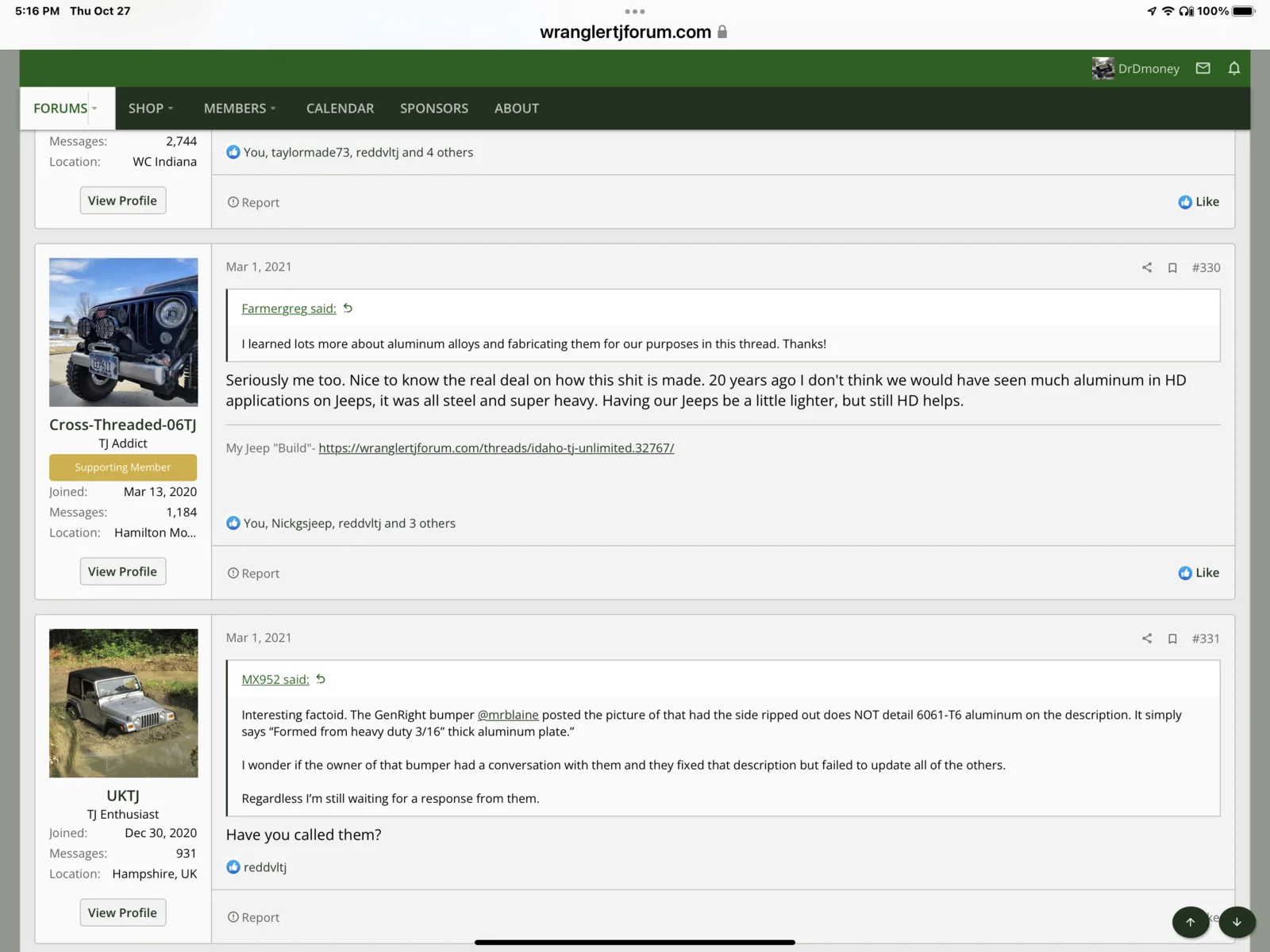

They changed that add during the last discussion about it, when was that, a year and a half ago?
I looked at it earlier this week and it still said 6061-T6, unfortunately that's not archived on the wayback machines.

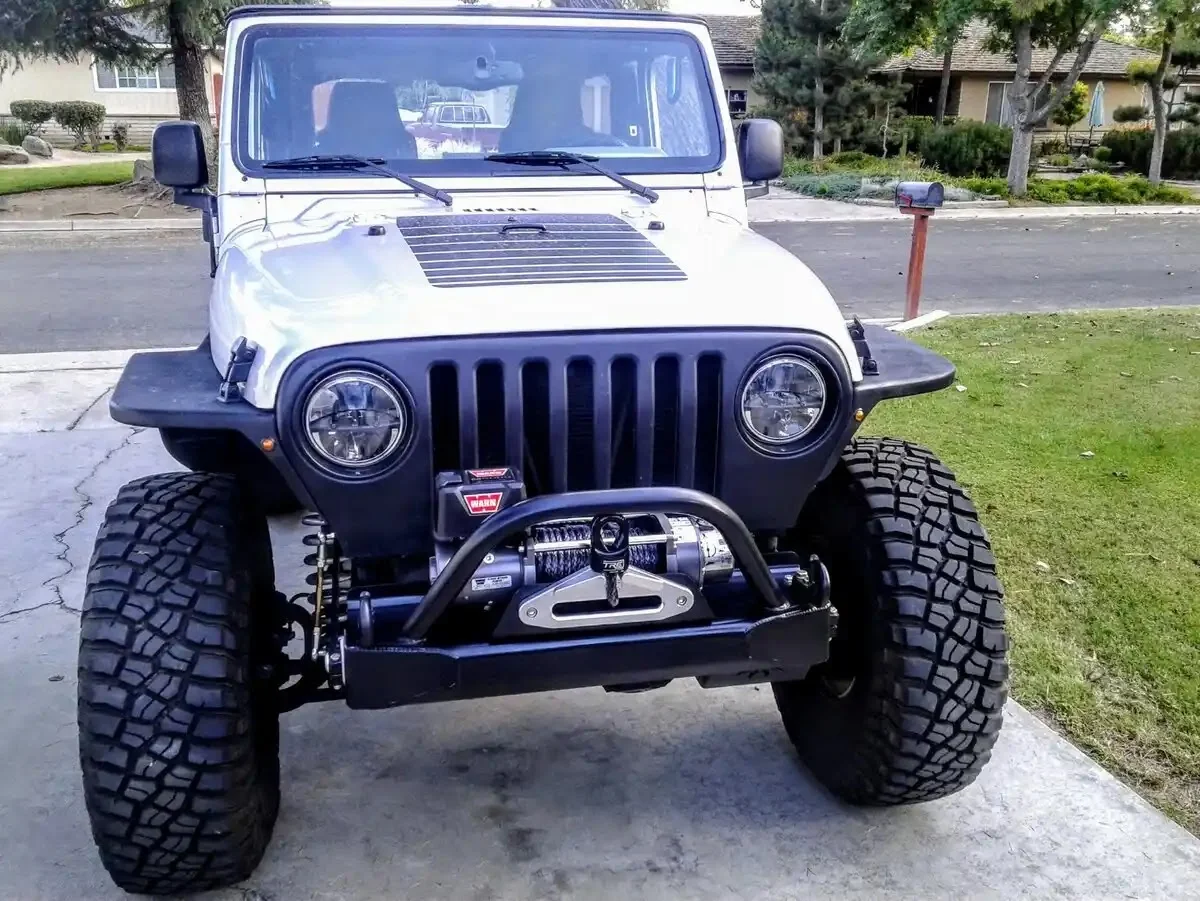

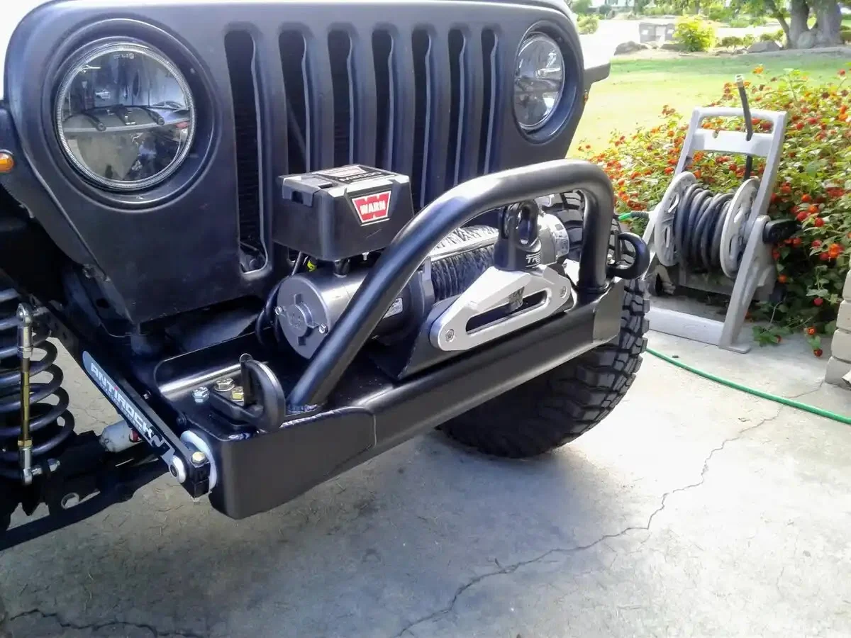

Here's what I have:
It is 6061 T6 and it has the proper bend radii. I am an aircraft structural repair inspector by occupation. I have the tools and ability to properly measure radius and test for proper hardness. The welded corners lose some strength just like other aluminum bumpers. This is a stubby bumper so there are no provisions for any kind of "Hardcore" upgrade to the welded corners. It is what it is.
The bumper itself weighs 9.4 lbs.
Add the winch fairlead, weight is an even 12 lbs.

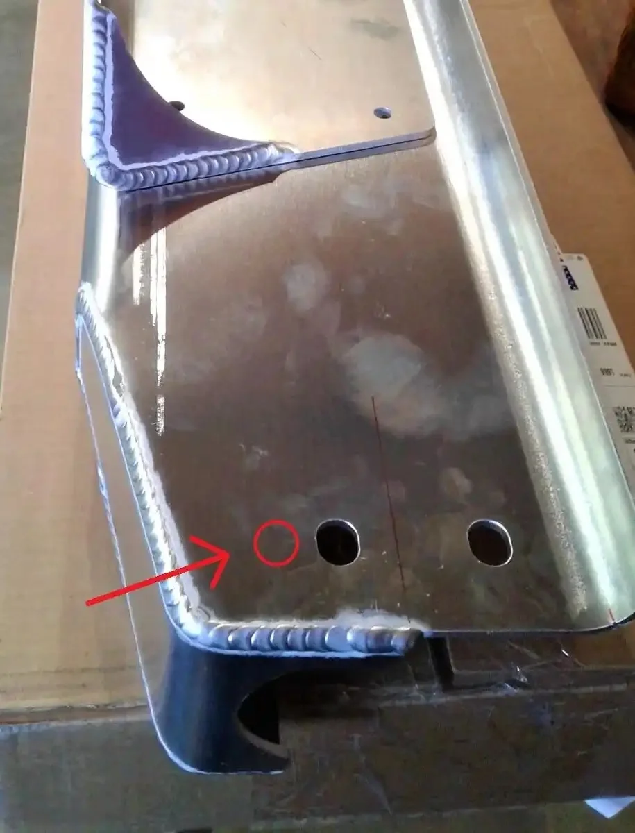

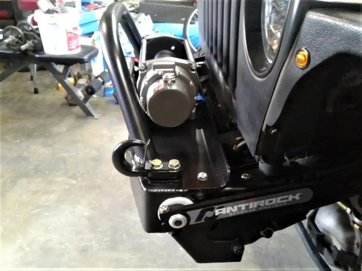

The deck of the bumper extends further back than stock. It uses the first 2 bolt holes and then uses the first bolt hole for the sway bar. My bumper only came with 2 holes on each side. I had to drill the 3rd. Not sure why that is, maybe UCF has corrected that on newer bumpers.
The bumper does not have the reinforcement bend on the bottom of the bumper below the crossmember. Apparantly Savvy is the only one doing that.
It has never been an issue for me, I have taken a few hits to the bottom of the bumper with no damage.

The UCF bumper, IMO, is a very attractive piece. It's low profile, sleek and very lightweight.
