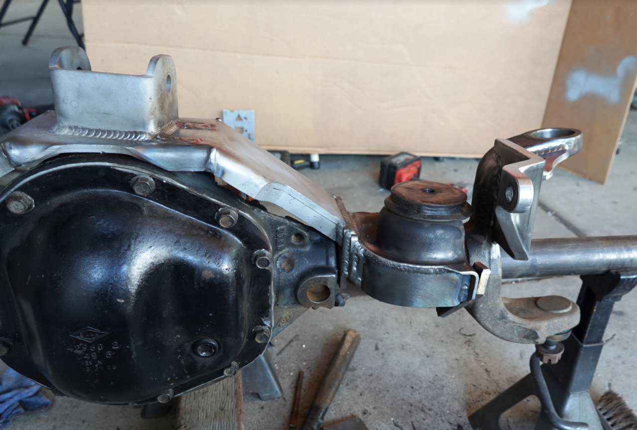

While the "truss" style upper control arm mount is reasonably well designed and fairly stout, it is still doing the job that was shared between two upper arms previous. I've seen a lot of carnage in roll overs so I wanted an extra bit of strength between the truss and the axle housing. The weld around the two cut off ears is a poor bond since it is to cast material. By filling the gaps with weld, that adds a mechanical connection that won't let it more laterally. Then, even if the welds crack all the way around like some cast welds do, they won't crack in a perfectly straight line that would let the truss lift straight up off off the ears.
Of note- the cracks or joints at each of the bends in the truss flanges should not be welded until last. Welding closes them up and pulls the two ends towards the middle and the truss won't fit.
The appearance of the pieces we weld on should also be noted. They are a uniform gray, that's because we have sandblasted each piece. I wanted a good key for the finish paint and then I wanted a good key for the weld through primer which is a high zinc content version in this case.

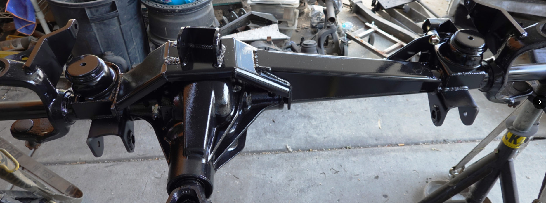

Continuing the build photos ..
After the truss/stiffener was finished, it was time to start on the swaybar links.
Here is the raised swaybar link mount getting mocked up. Blaine pulled the upper ball joints so the heat from welding won't mess up the races.
After welding them in place using the original mounts as locators (and making them look as if they came that way originally!) ...
This jeep is getting the BMB hydro assist setup. Blaine built the inner brace for the hydro-assist mount since the bolt on mount won’t work with the Savvy stiffener welded on. He also trimmed the corner off of the left side spring perch and made a new skirt to stiffen it back up. This is done so that the corner of the spring perch will not hit the trackbar barrel at full stuff.
There is a lot of inner detail in this work for maximizing everything that is is possible that only comes from experience and refinement over years.
And after finishing both sides, Blaine prepped and painted the axle with 2 coats of the Black Top KBS satin.

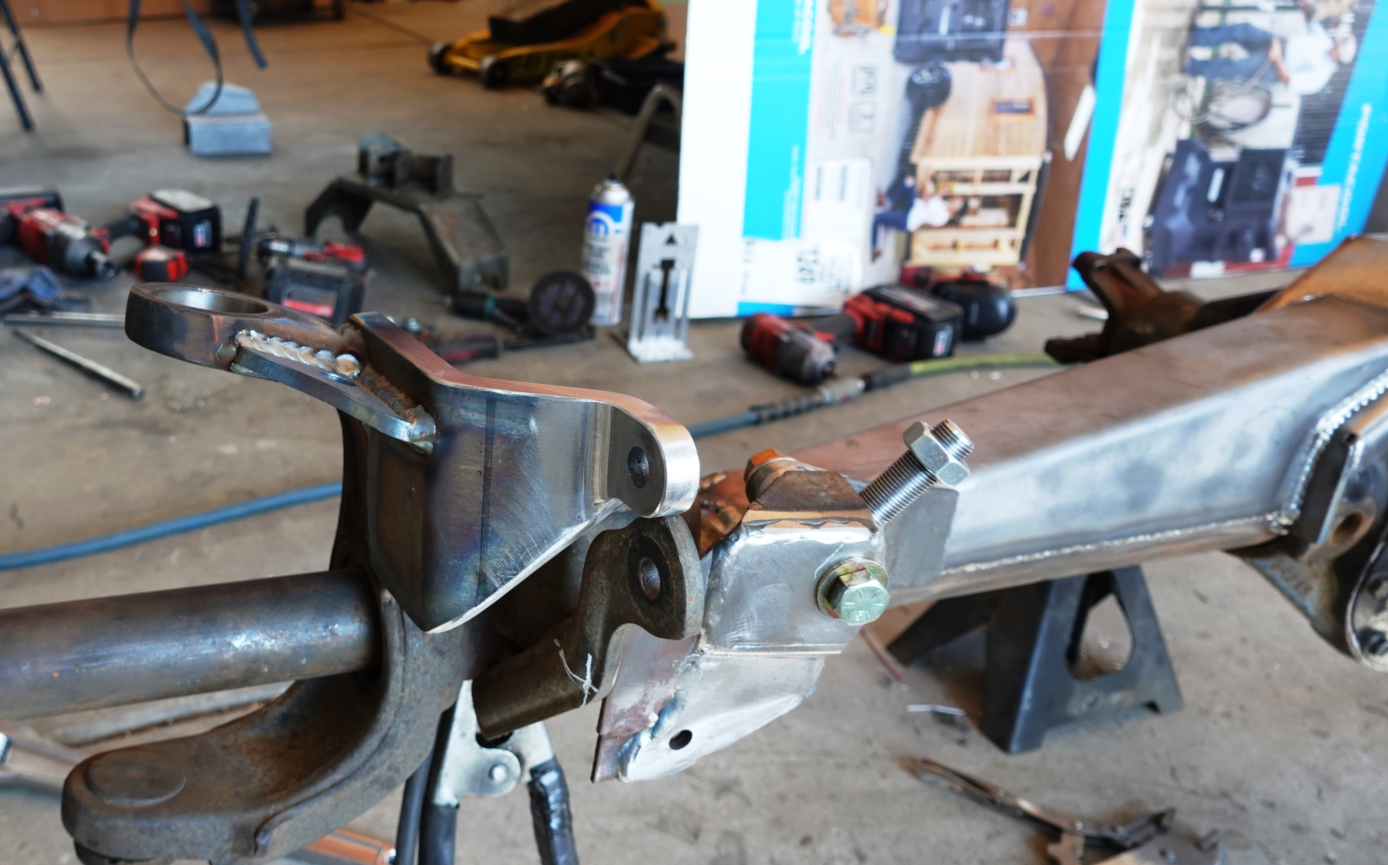

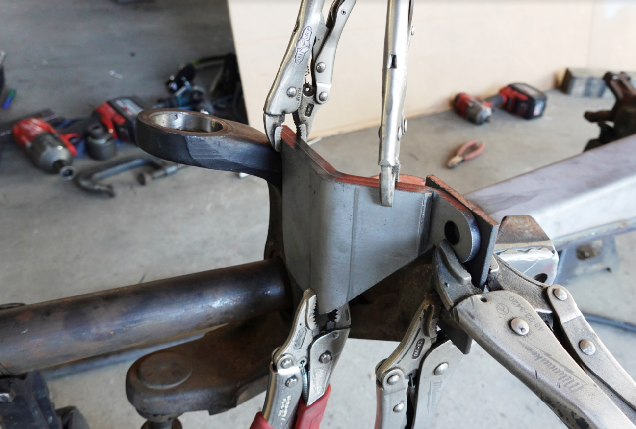

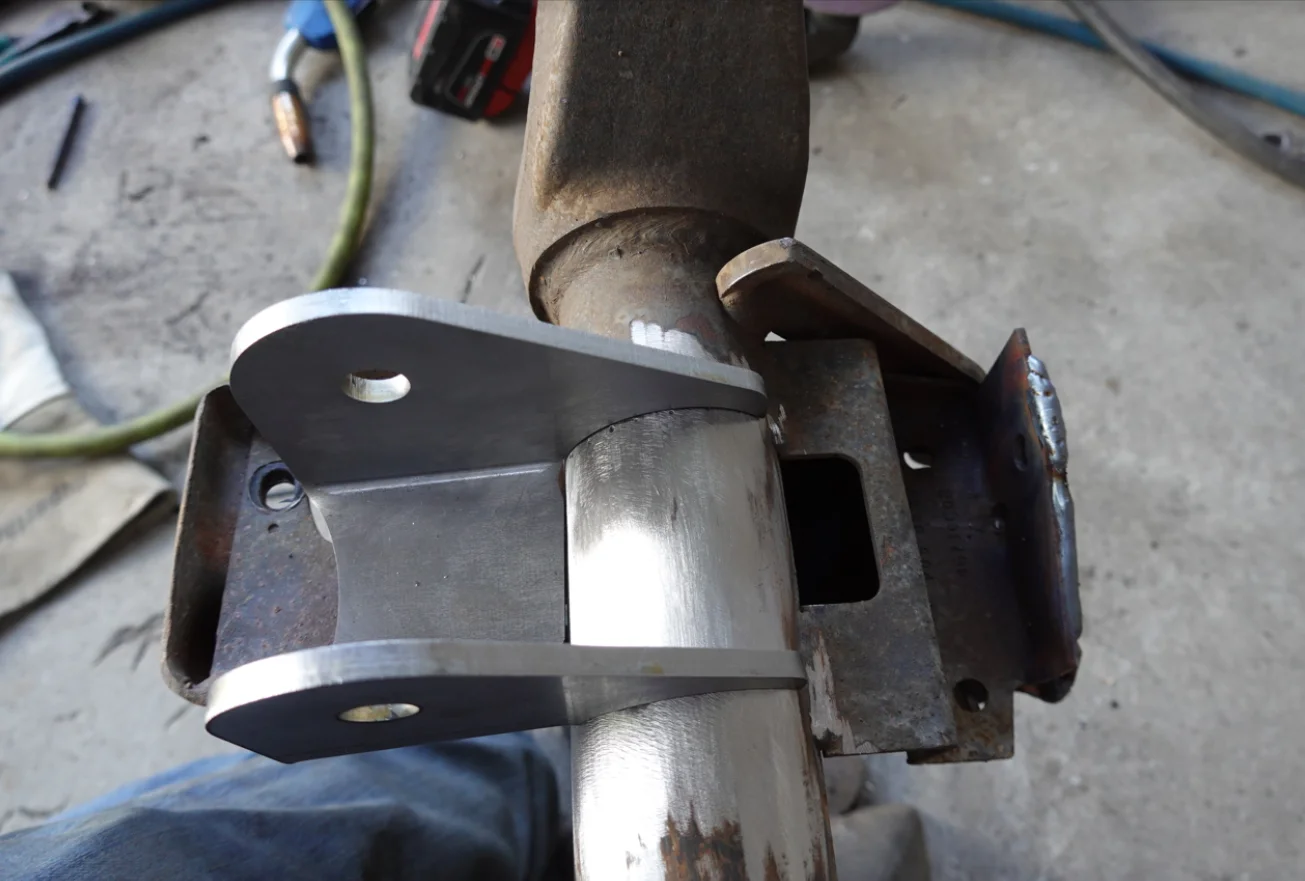

Next, it was time to work on the front axle. The axle side LCA mount was cut out, and an Iron Rock offroad mount was welded on. You can see the tiny row of punched dots that are used to mark the location of the mount. It's a small detail but something borne out of practice and experience.

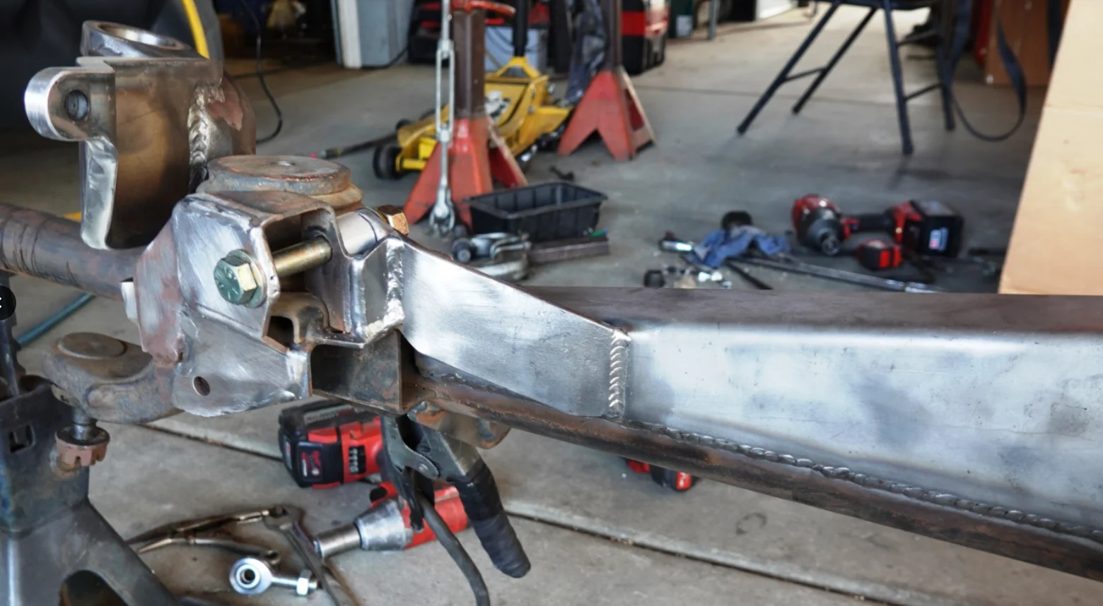

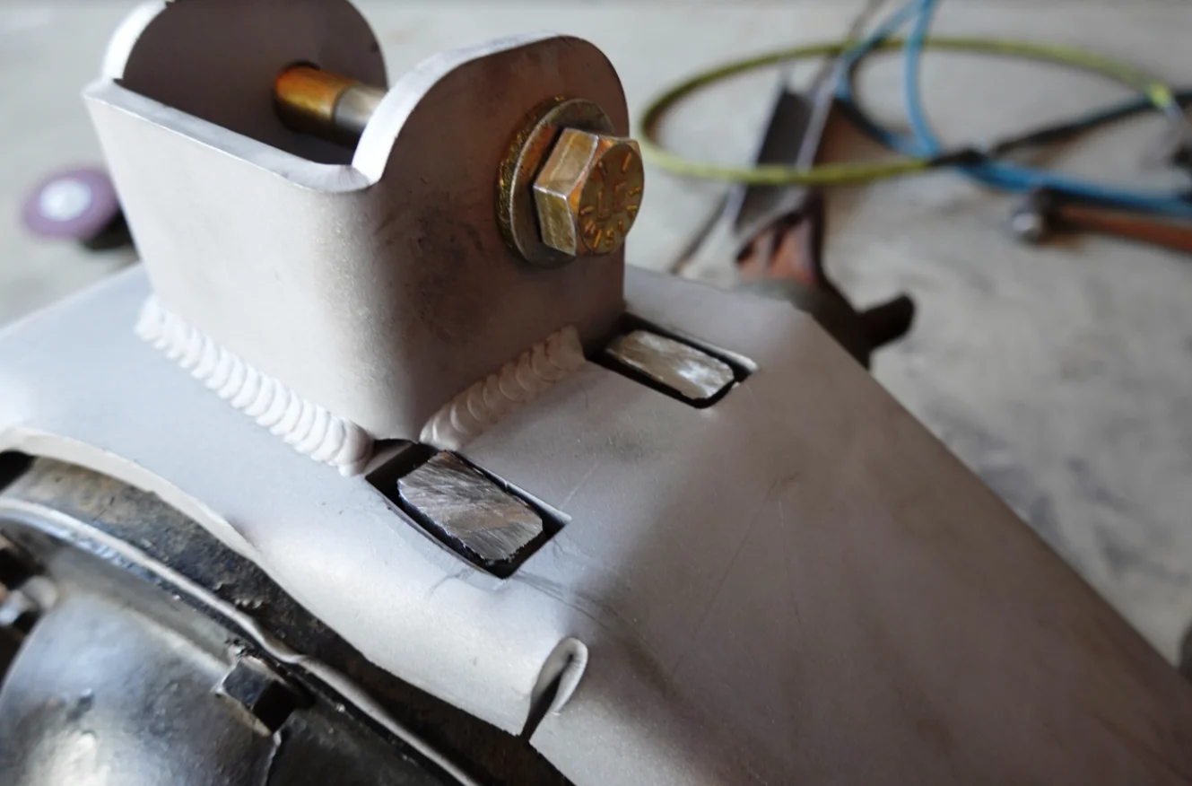

Next, the track bar bolt and stabilizer bolt reinforcement plate were added. You can see the bend in the bracket to get them exactly at the angle needed to get it to sit perfectly. Aso notice the hardware .. Blaine is a walking encyclopedia when it comes to understanding what hardware to use where and nothing is chosen without purpose.

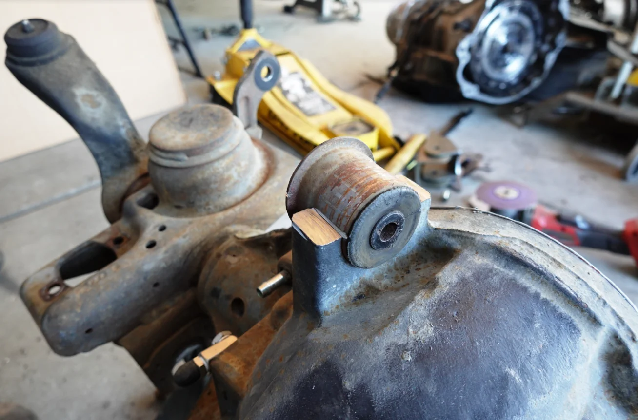

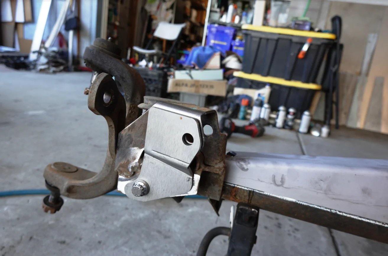

Then, the factory cast control arm mount was removed and trimmed ...
... and trimmed exactly where it needed to be when the truss goes on.
