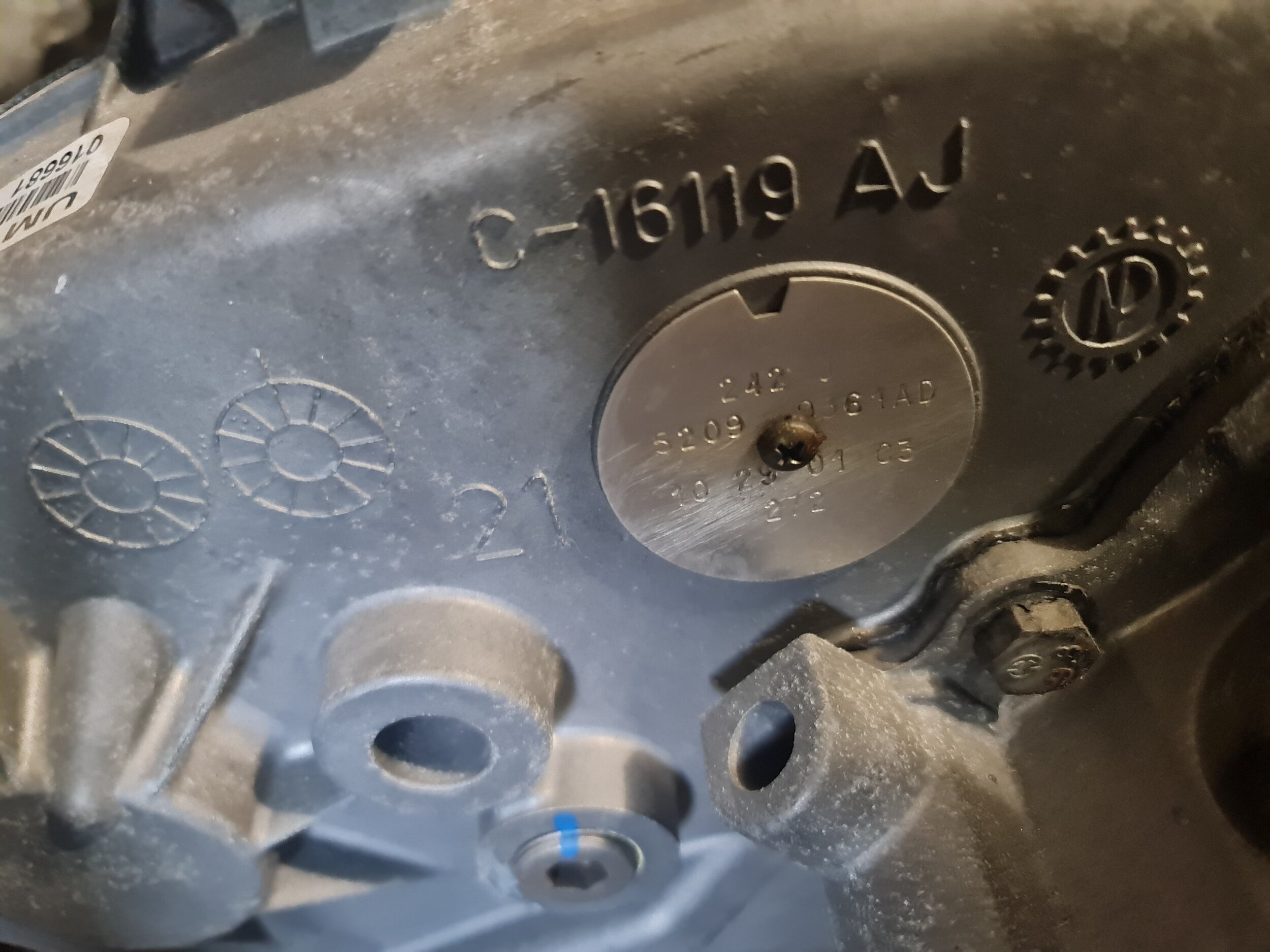

Hey yall so.....long story short,I want to do my savvy tummy tuck,a while ago I bought a T-case from the summit outlet foolishly thinking it was a Np231.....I have an SYE for a 231 from AA but that won't work on a 242🙃
What i have is an Np242 for up to an 04 Grand cherokee

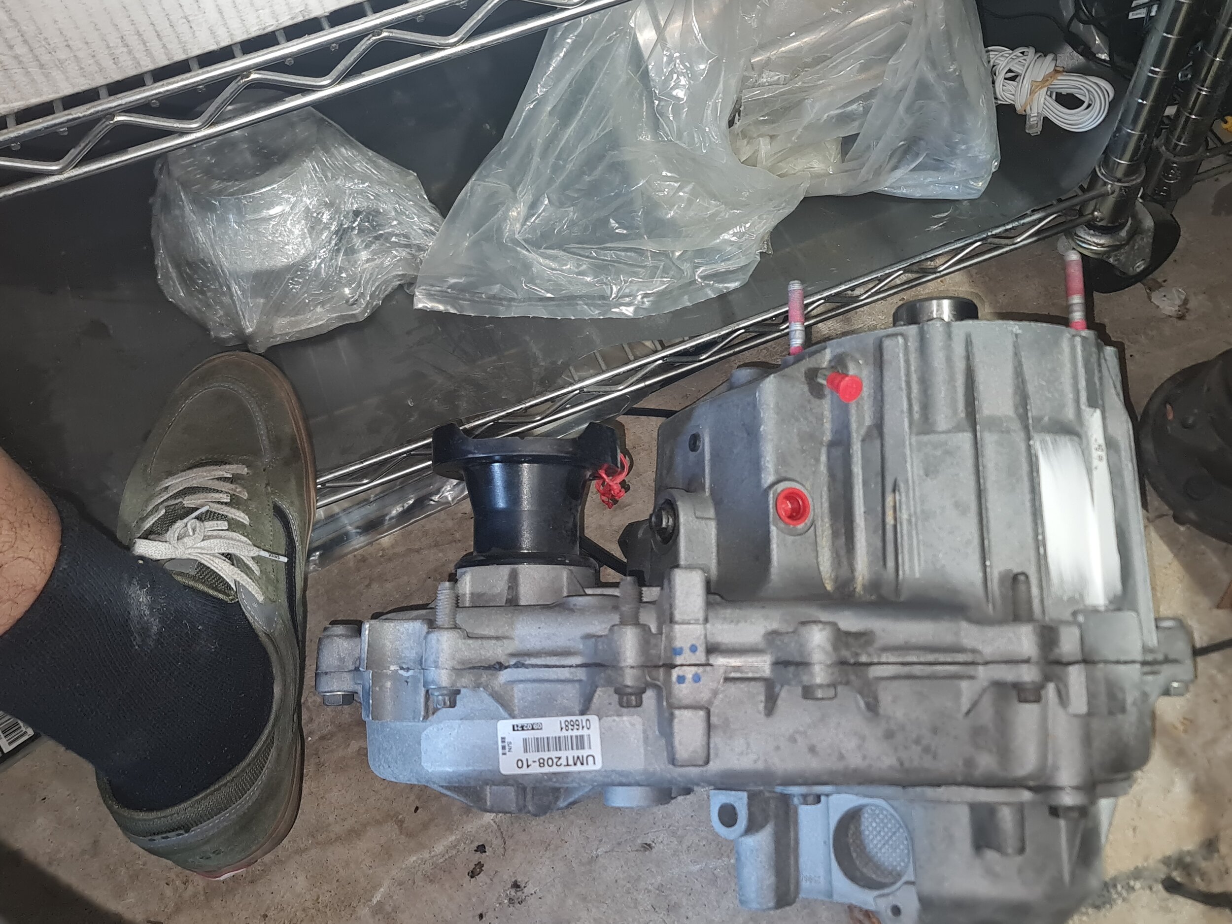

I was gonna start disassembling this Tcase but realized it was a 242...
Peep the SYE in the back.....and the Rubicrawler 😉(not gonna be using it anytime soon)

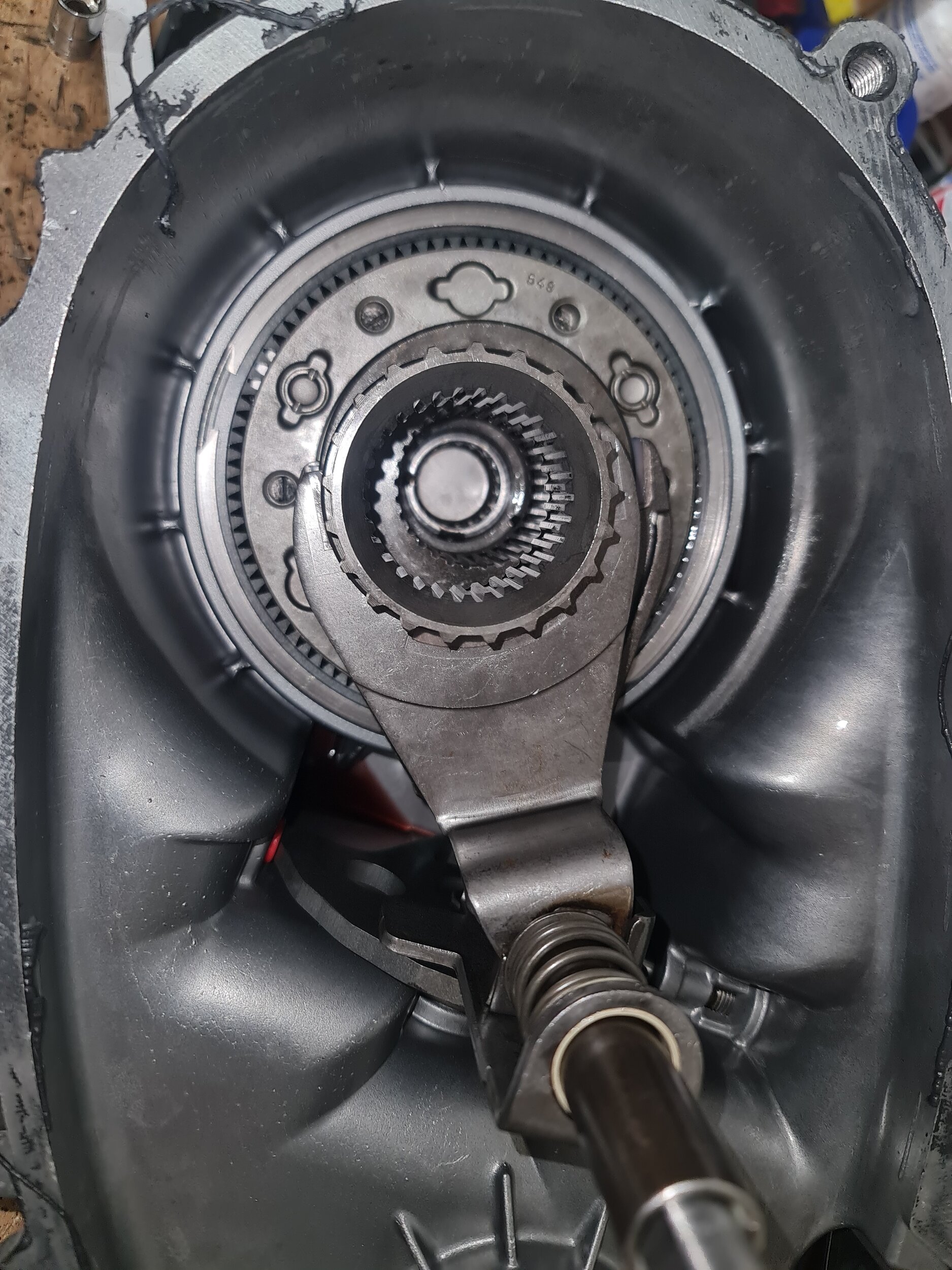

Welp I sure as heck got the 3 pinion planet.

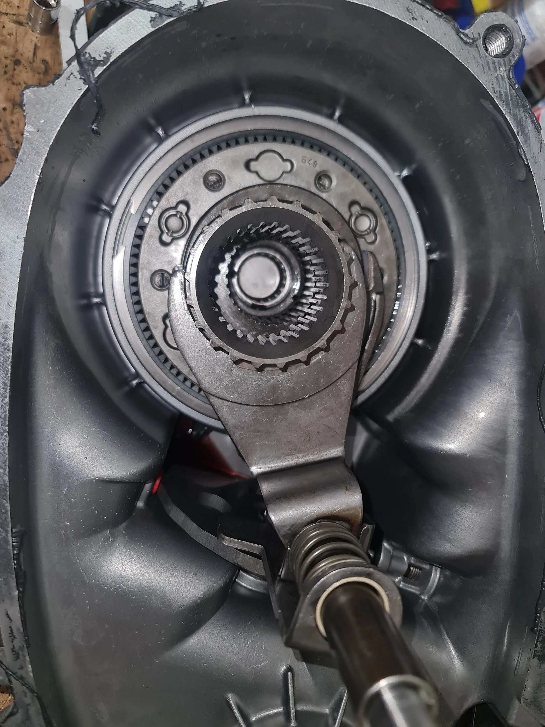

Edit,Forgot to add the pic of the input side
Looks like I have the short input right ?

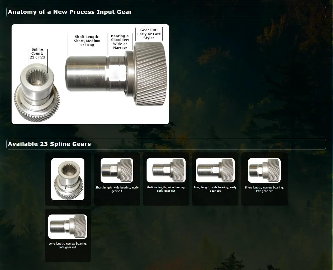

Yes that is the short...
https://www.novak-adapt.com/knowledge/transfer-cases/np-nvg-input-gears.html
Reactions: D's Jeep Wrld

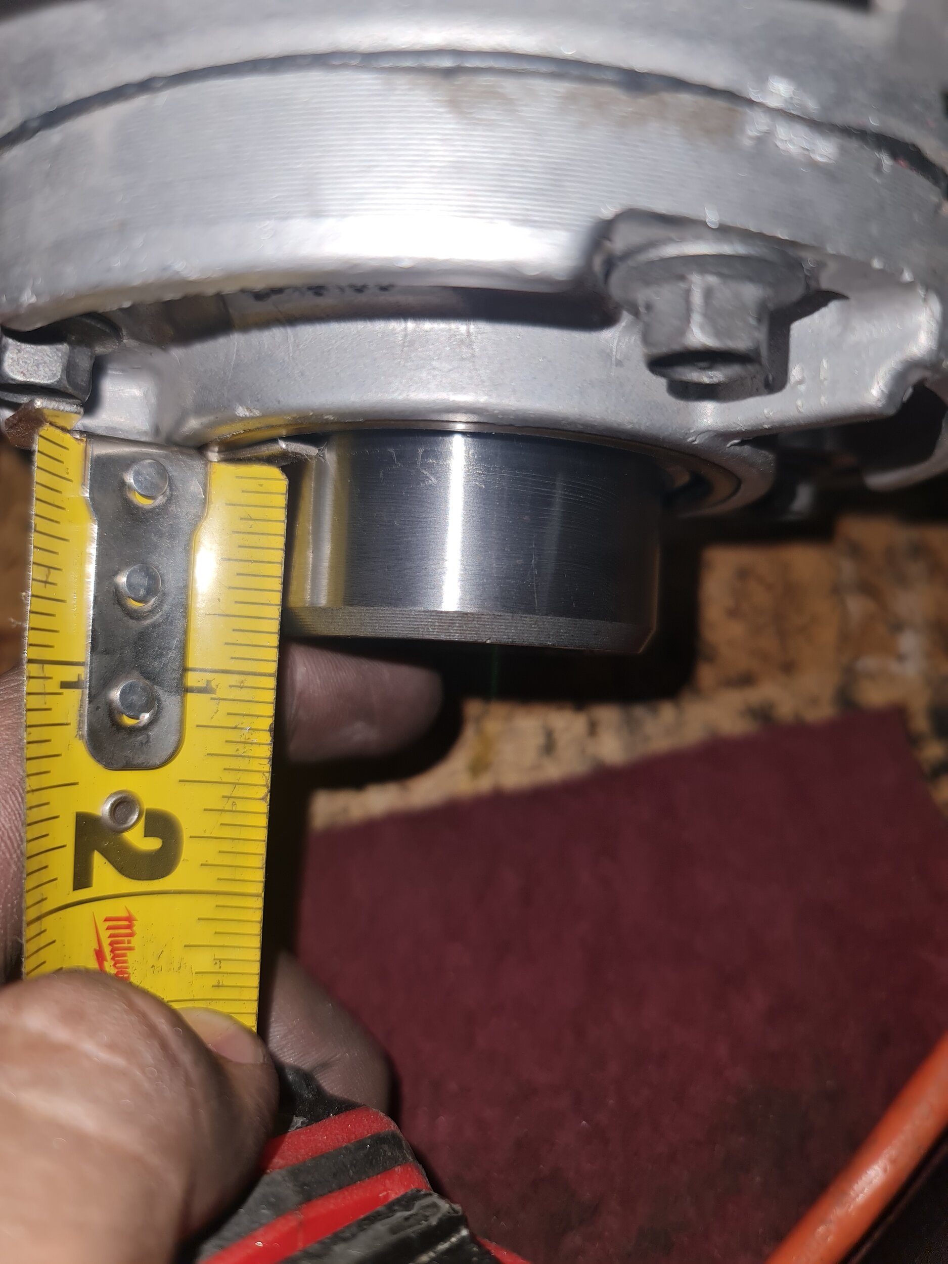

Wanting to recheck the years of the two input bearings sizes of 16mm and 24mm
UPDATE- found that... just a scan up found a more recent post.
did anything change beside the bearing size ..... in reference to the bearing...... as in ... where they bearing rides..... did that change.....
As in ..... I got fubared and my main shaft dissappeared after Dec. 2024 dissassemly and boxing it all up.... Now here in Sept. 2025 back at it..... well Eddie my buddy is back at it. Picked up another 242 to rob shaft out of.. my original rebuild started inside a 2003 Tcase,
robbed shaft got now is from a 99. Have the whole 99 TCase actually. sadly the 99 also does not have the NP231 spot in the short rear shaft case for speedo. the 99 and the 2003 short rear case is the same. that would have been a nice consolation prize
previously got proper bearings to fit the trans input I intended to use. Main reason for disassembly back in Dec. in first place was to swap input gear to match the manual trans.
is that 99 shaft going to cause issues in the 2003 stuff orr? 2003 case half had already has some of the new bearings installed and all cleaned up. Am hoping to use 99 for shaft and for a mock up to remind how the puzzle goes together.
sense asking you have learned the bearing surface on the shaft is the deciding factor. Either shaft can be used in a rebuild as long as you use input gear, main shaft all have matching bearing size.
