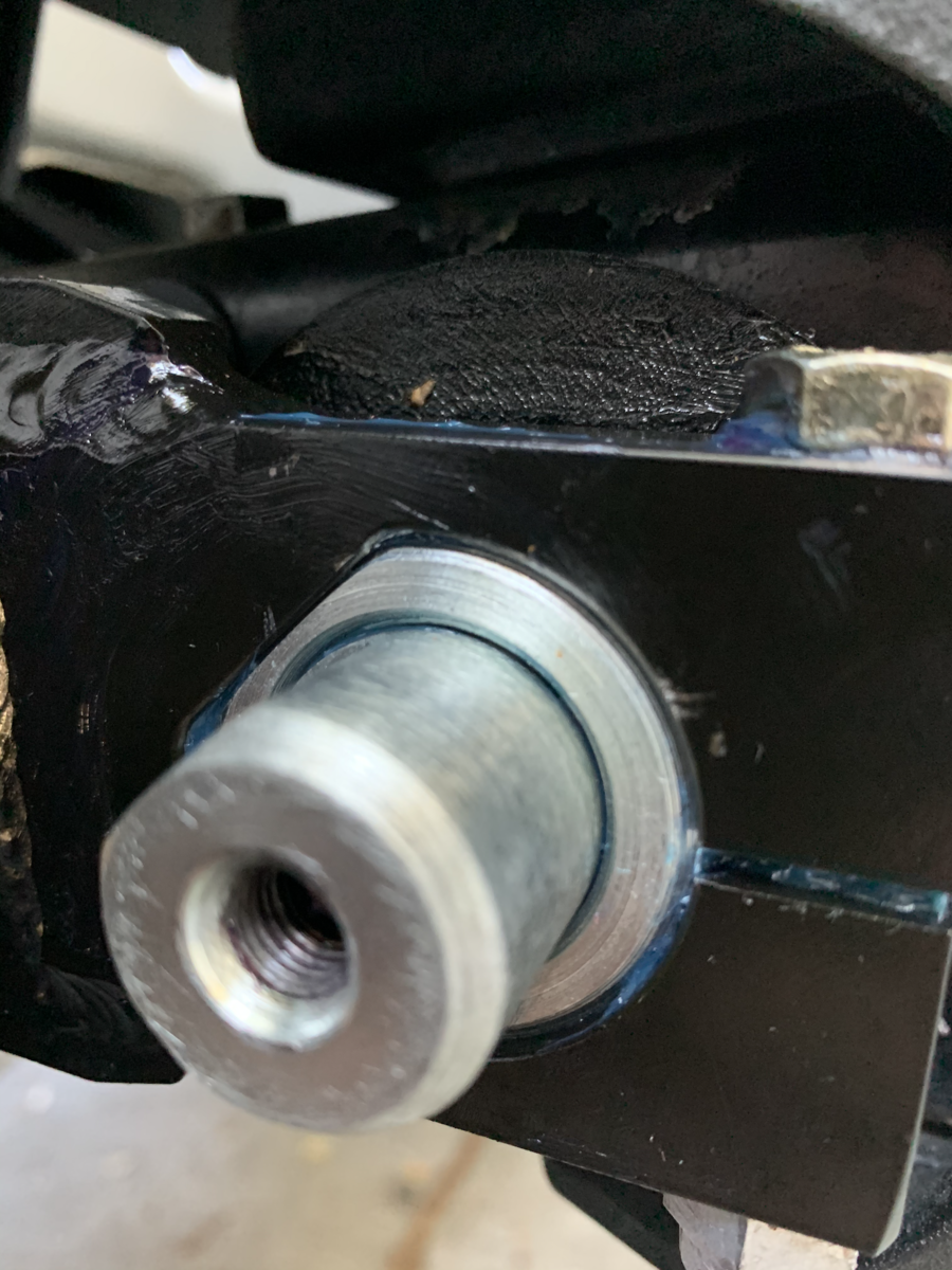

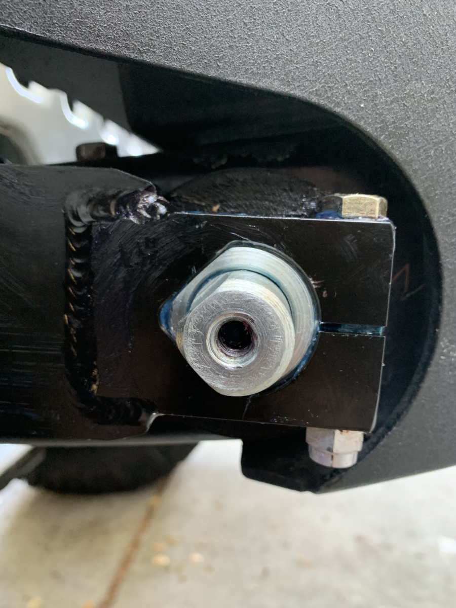

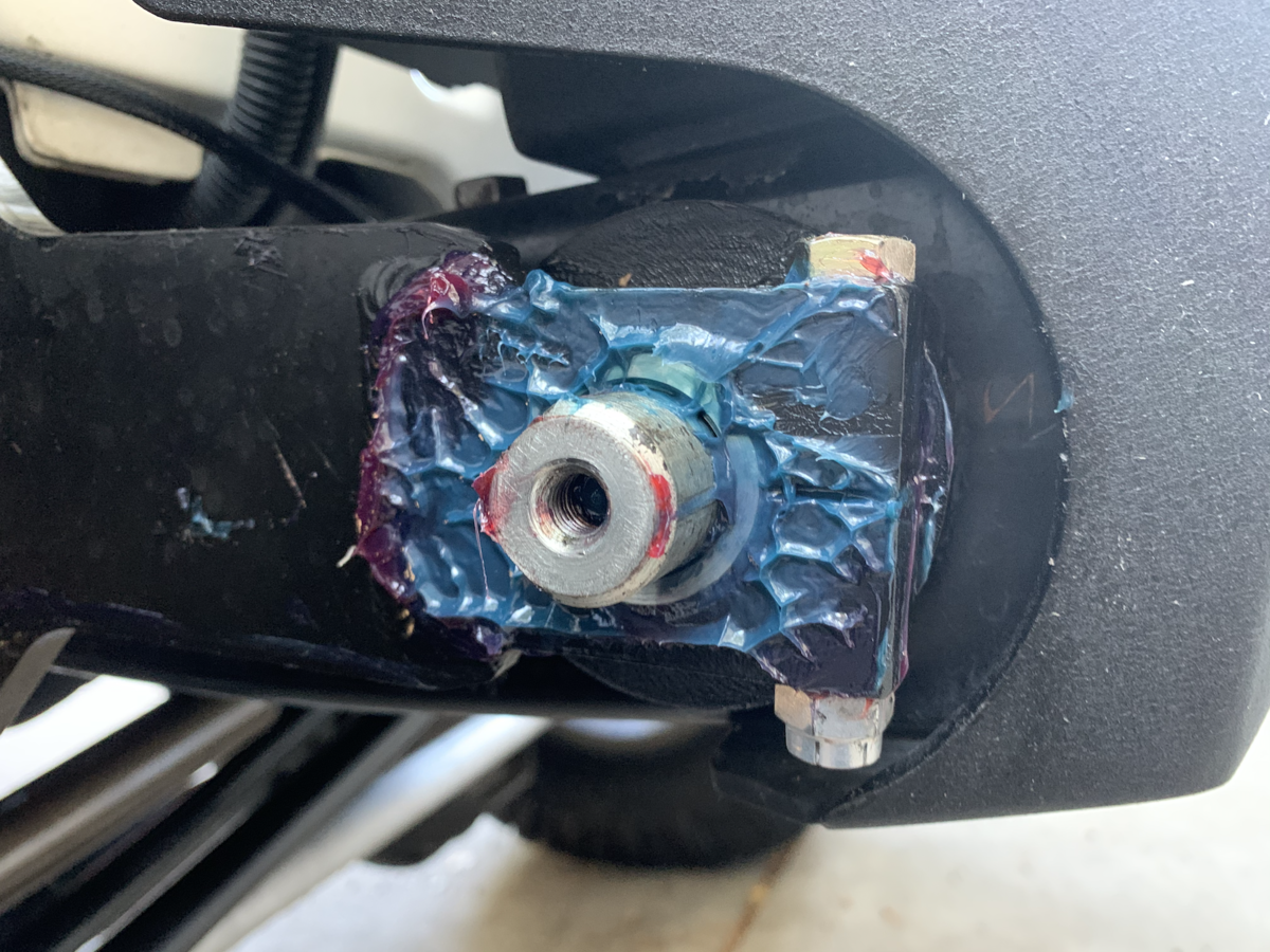

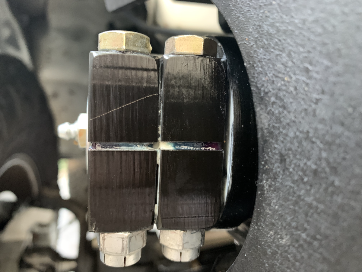

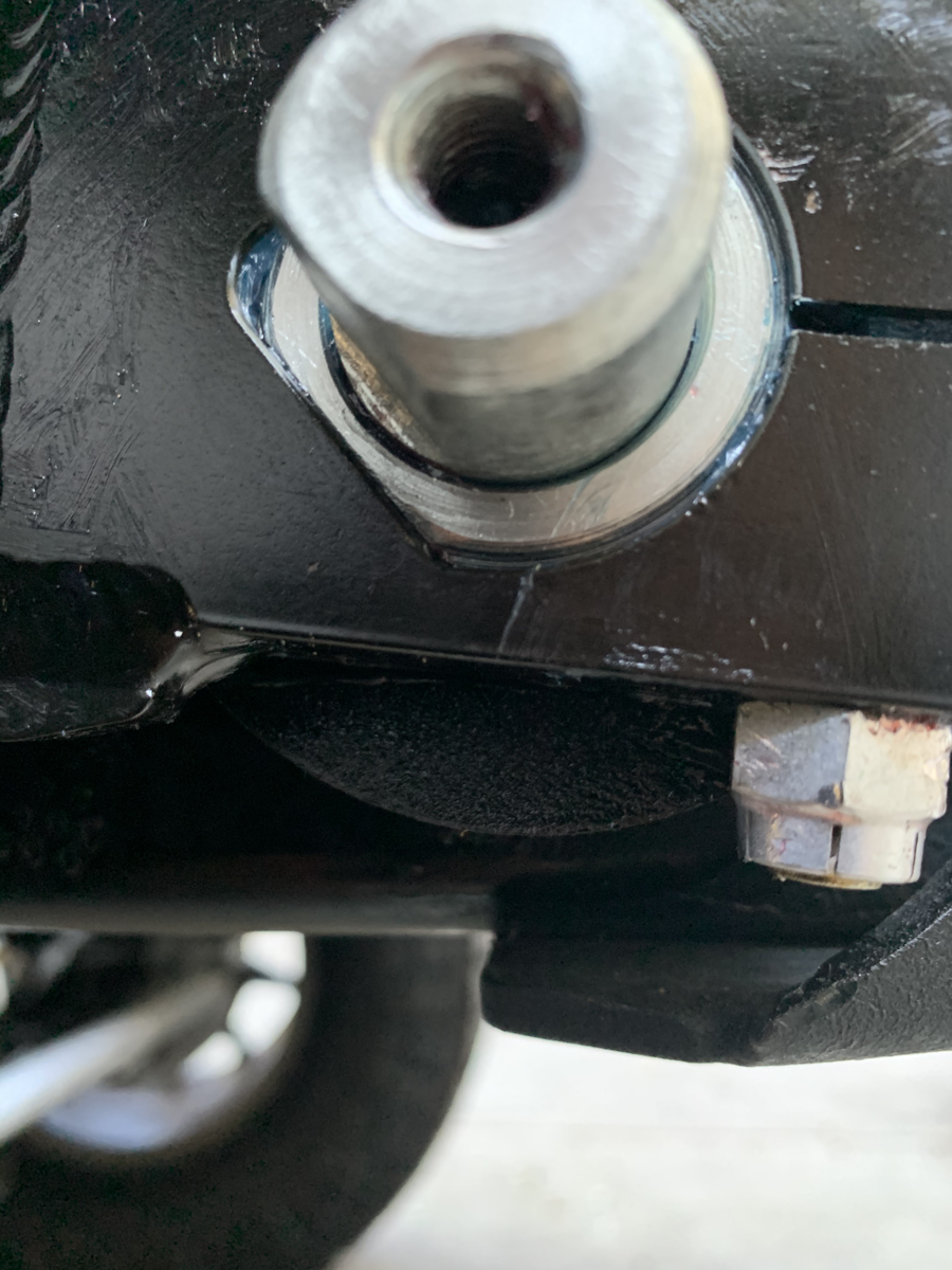

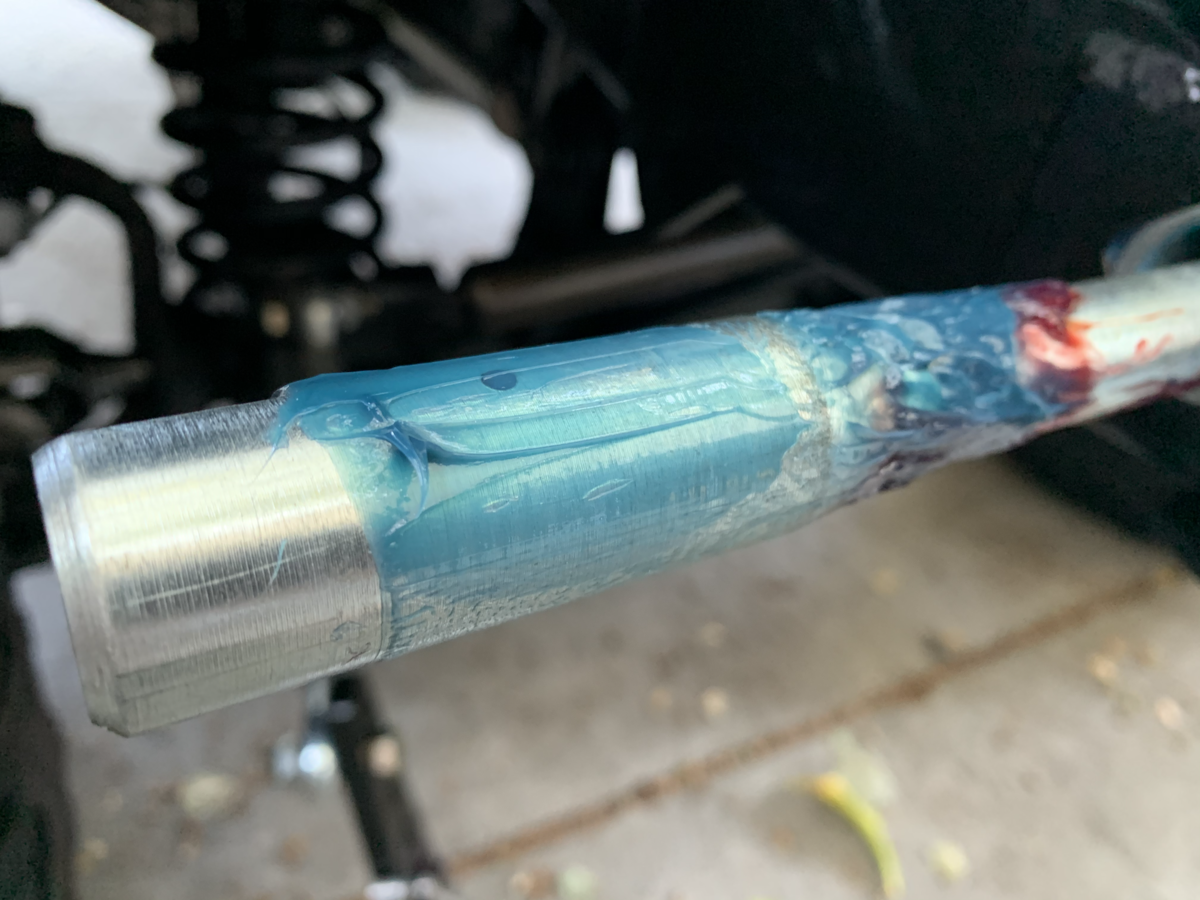

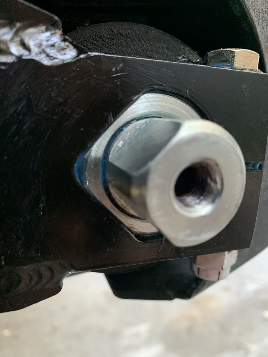

Always greased, never ran dry. Anytime it gets clunky, I regreased. I have only about 200-300 miles since installing the Swayloc. I think I found where all the grease went-- inside and out all over all the sliding components.
No visible damage or indicators that I could tell.
I paid close attention during reassembly to make sure all arms were seated properly. It's hard to tell, but it looks like I was able to close the gap a little between the greased arms. Not much (sub millimeter range), but hopefully it will make a difference. I cleaned all the parts the best I could and regreased with a good silicon tacky grease (similar to what came with the SwayLOC). Followed that with a quarter-pump of marine grease to fill in any gaps. I guess we will see in a couple days.

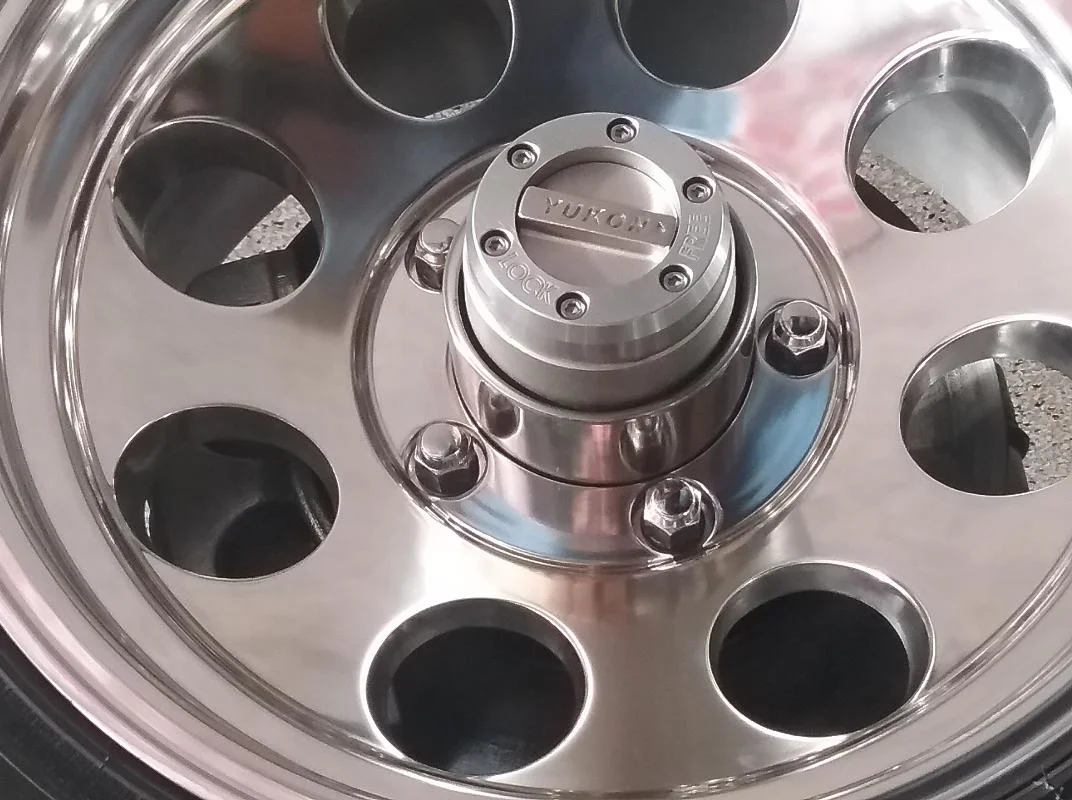

Just for fun, here's a side-by-side visual of the Yukon 5x4.5 hub kit and Yukon 5x5.5 hub kit,.
The 5x4.5 kit has certain advantages that had I considered more carefully back then would have heavily influenced my particular choice, such as a much better selection of wheels with the appropriate backspacing than wheels with the 5x5.5 lug pattern. (Actually, I would not have needed to purchase wheels at all with the smaller hub kit. I think that my background as a CJ guy and the nostalgic side of my brain conspired to make me rationalize that any hub with a "real Jeep" lug pattern must be better. Its definitely "better" in the sense that now the lug patterns on my jeep and '46 Bantam trailer match.)

To OP, I agree with everyone else about contacting ORO by phone. A new SwayLoc should not have that much clearance between the sway bar and bushings. I would venture to guess something is not machined to the correct dimensions.
