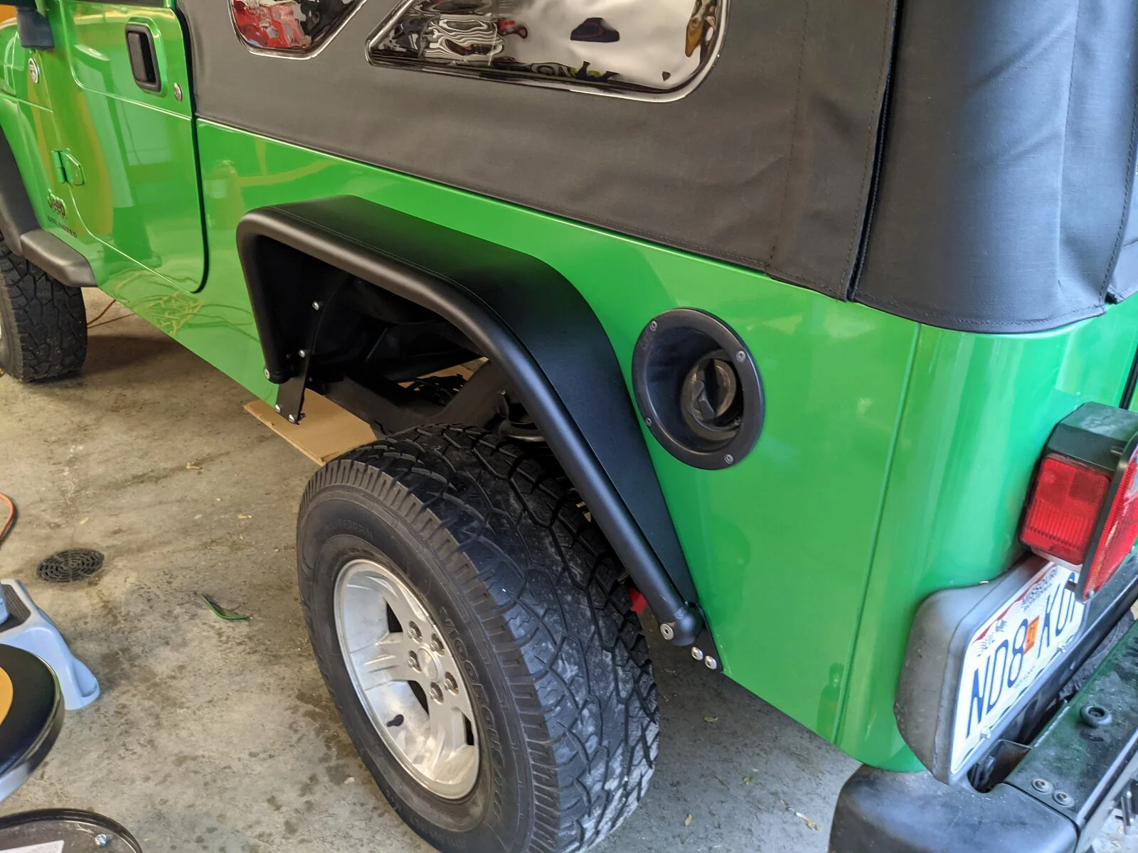

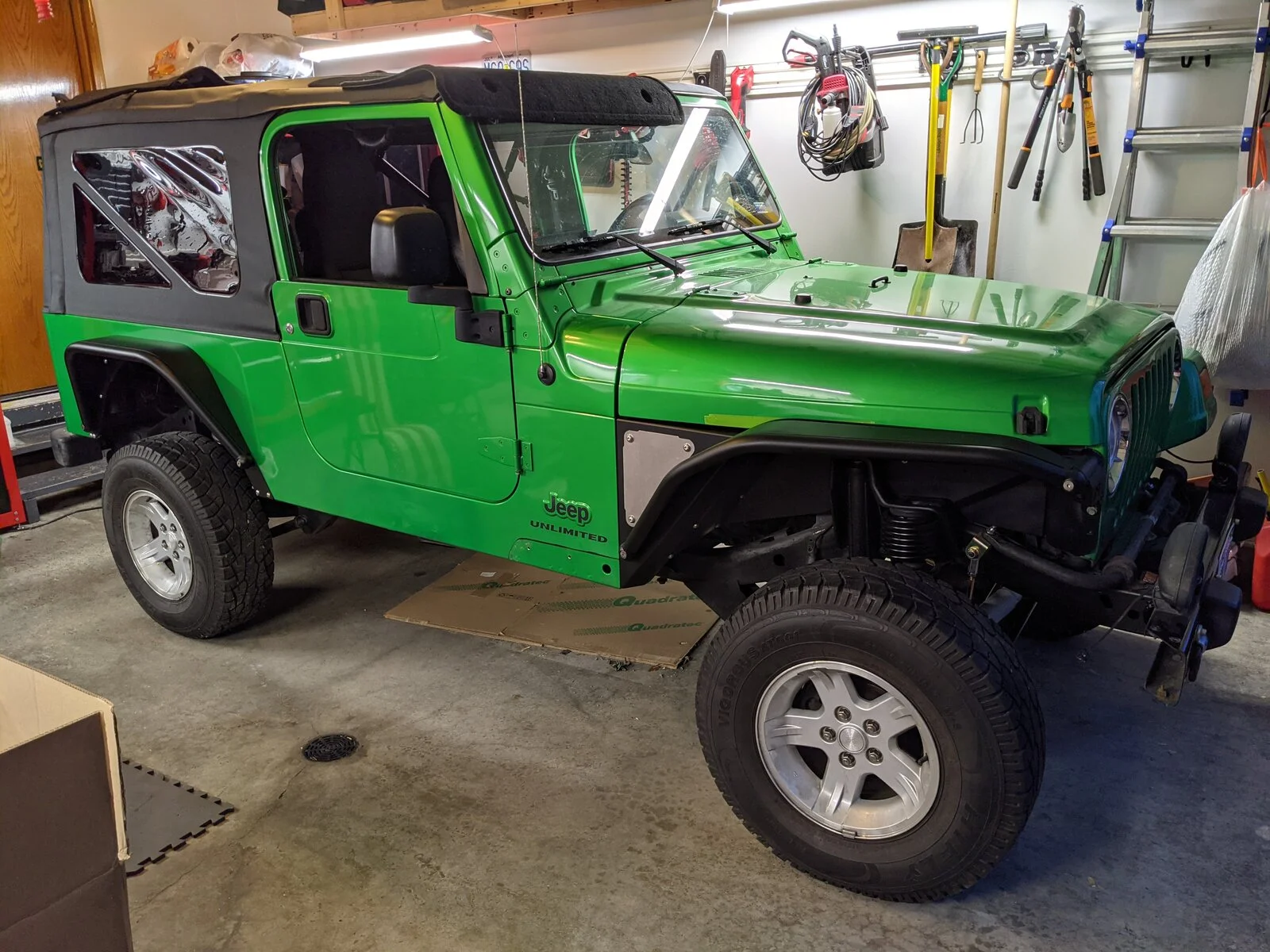

I've started back in on this LJ. I installed the rear fenders and have started on the fronts. Should get them and the rock sliders all finished this weekend. I need to do oil changes on all three vehicles and my JKU is getting new brake pads this weekend. Weather looks to finally be good enough to get some real work done in the driveway.

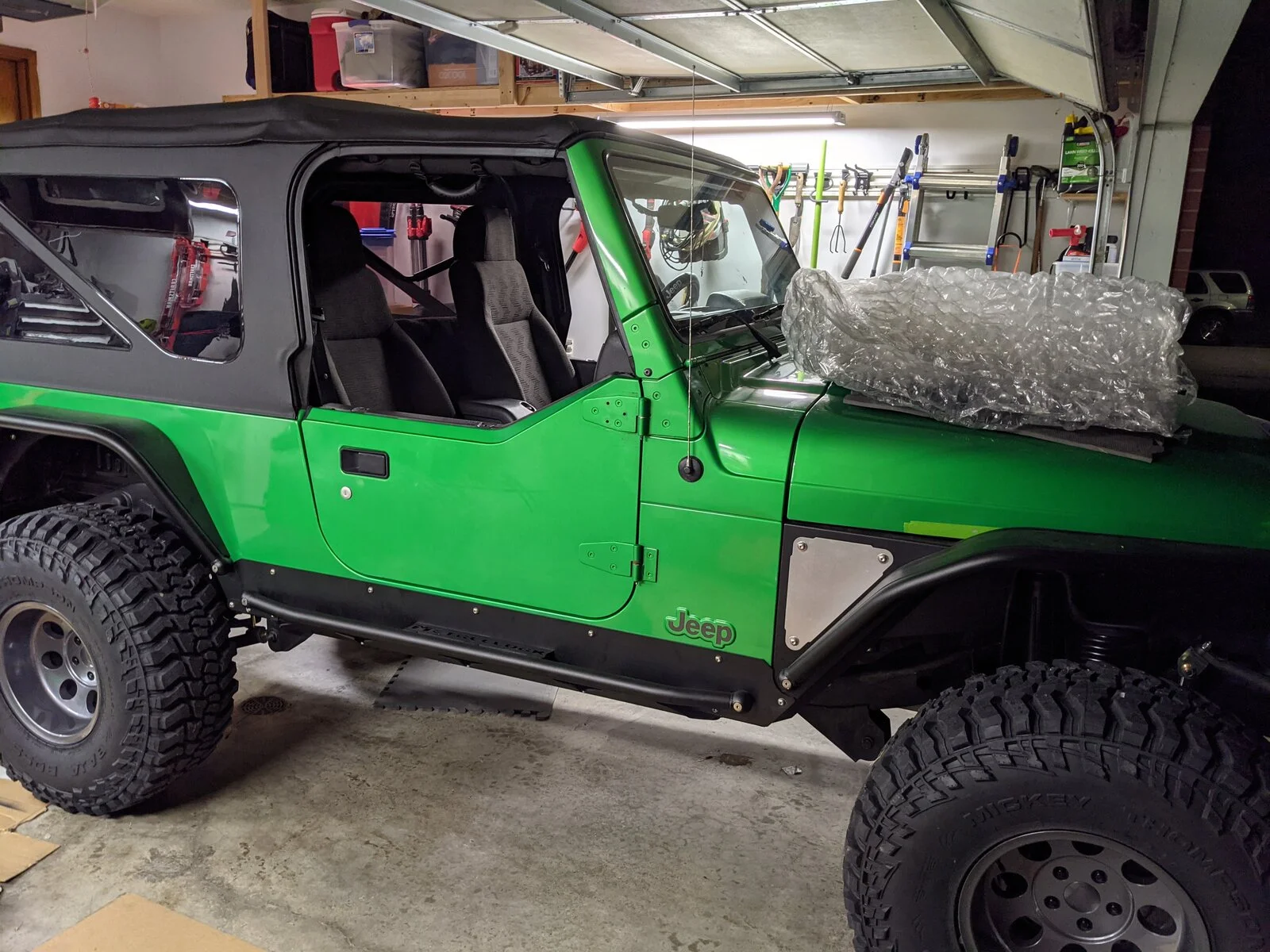

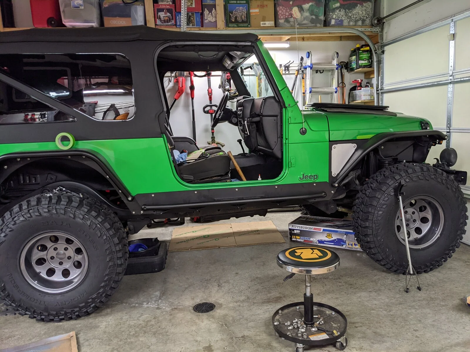

I got the fenders put on. I don't have great shot of them yet. They really make my 31" tires looks SUPER small. Should be putting the rockers on this week. I'm not in love with the silver access panel on the side. Thinking of either getting the vented ones or maybe just painting these black. Any thoughts on those?

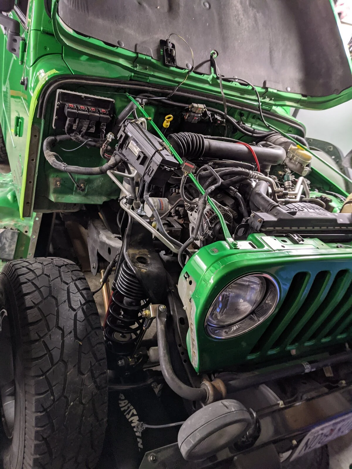

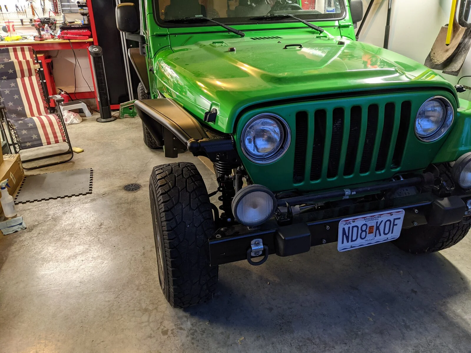

While I had the drivers side fender off I went ahead and swapped in the MORE steering shaft riser. Seemed like it would be far more difficult once I got the fender back one. I probably should have done my MML at that same time. I just wasn't ready to tackle both the body and motor mount lifts yet.

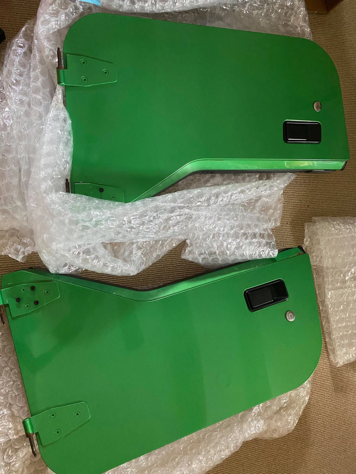

Wife and I made an impromptu road trip to Texas to pick these factory color matched half doors. Probably paid too much but to me they were worth the trip. Plus the lady selling them was super nice and a Jeep collector. Can't wait to get these put on.
Finally installed the rock rails. I'm going to swap out that silver plate on the fenders. Just not a fan of that look. Seems incomplete to me. Unfortunately, it's all getting placed in storage for a bit. It's going on the back burner for about a month or so. I have a bunch of things to do on my JK that needs to be done before the 23rd. So I am making space in the garage to be able to get around and work on the JK easier.

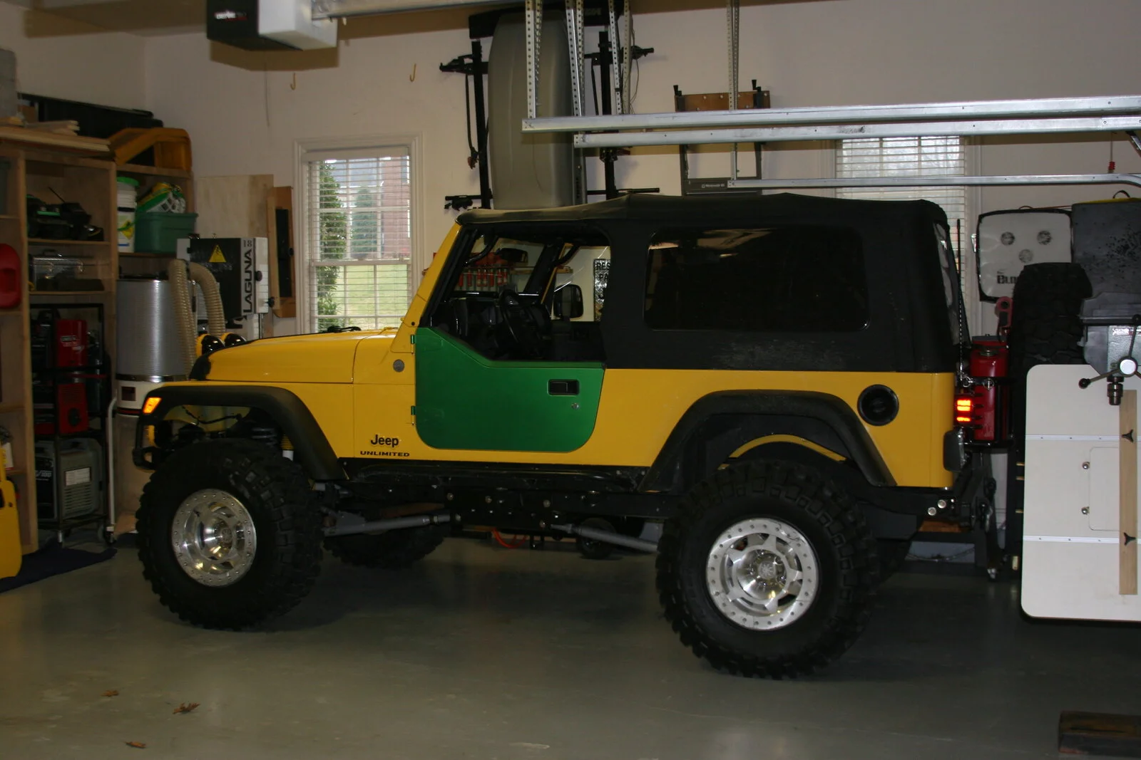

I'm guessing they are now yellow? Your Jeep looks great even with green doors. :)
Thanks. Yep, yellow now. That's a pretty old picture - the rig looks quite a bit different these days.

We installed some TMR hinge bushings and the half doors. The drivers side stock bushings were a pita to get out. They were so rusted. Oddly enough the passengers side wasn't an issue at all.

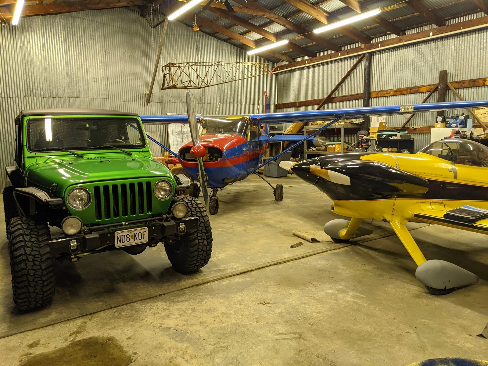

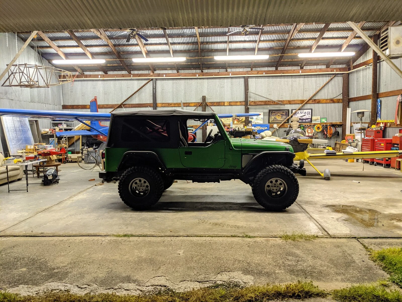

Then we took it out to the airport where it will stay for a week or so.
It's with good company. The blue Cessna is my dad's and the yellow RV-3 was my brothers. Quite the collection of toys out there at the moment.

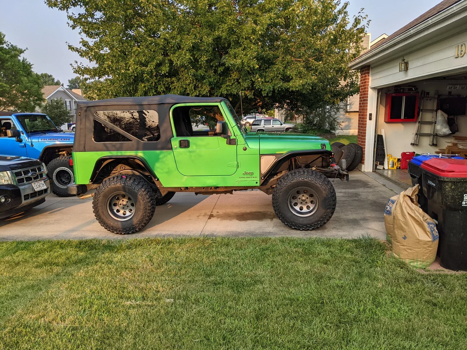

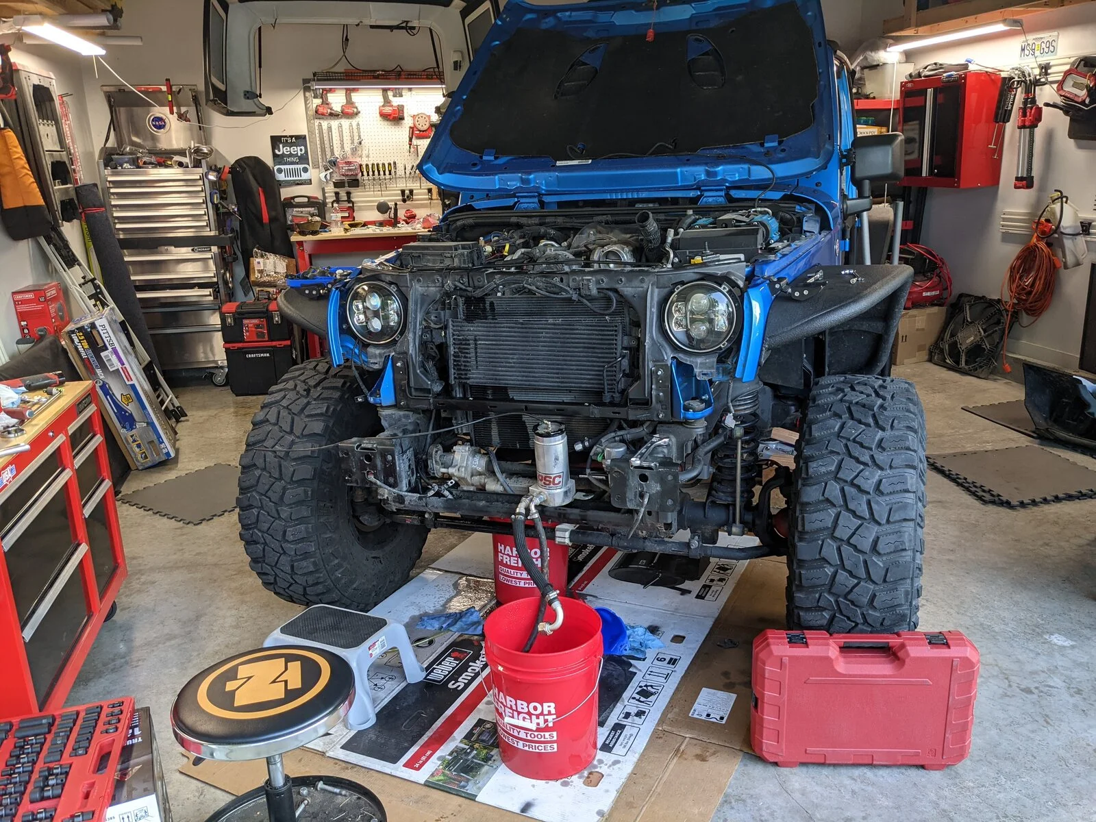

Not really TJ/LJ related but this is the reason it's spending some time out at the airport. We are doing a lot of maintenance on the JKU. Replacing the radiator, resealing some problem areas on the power steering, and then doing some changes to the steering setup. Going from a draglink flip back to under knuckle setup. Swapping front springs. Adding an ARB power line for a fridge and a few other odds and ends.
