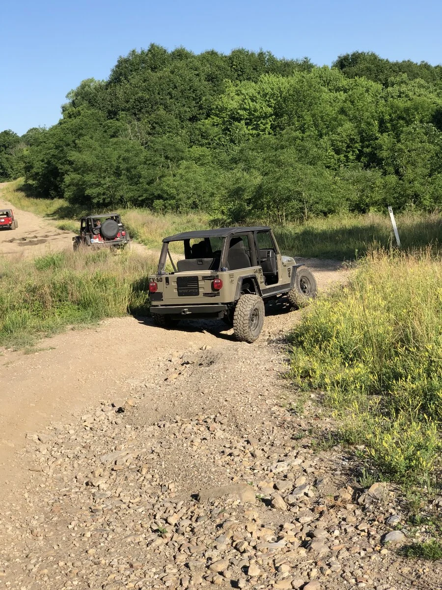

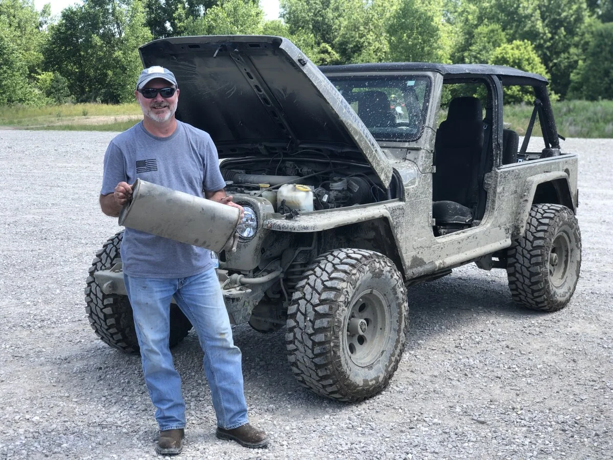

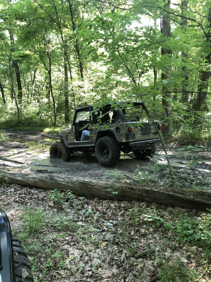

Some good times on the shakedown test today. Had Veteran John behind the wheel. He even got to keep a souvenir. 🤣 The LJ didn’t disappoint! Busted a shock bushing and broke off the muffler but no winches were used! I count it as a great success! Another reminder to always test out your rig as you go so you don’t spend crazy money when you don’t have to!

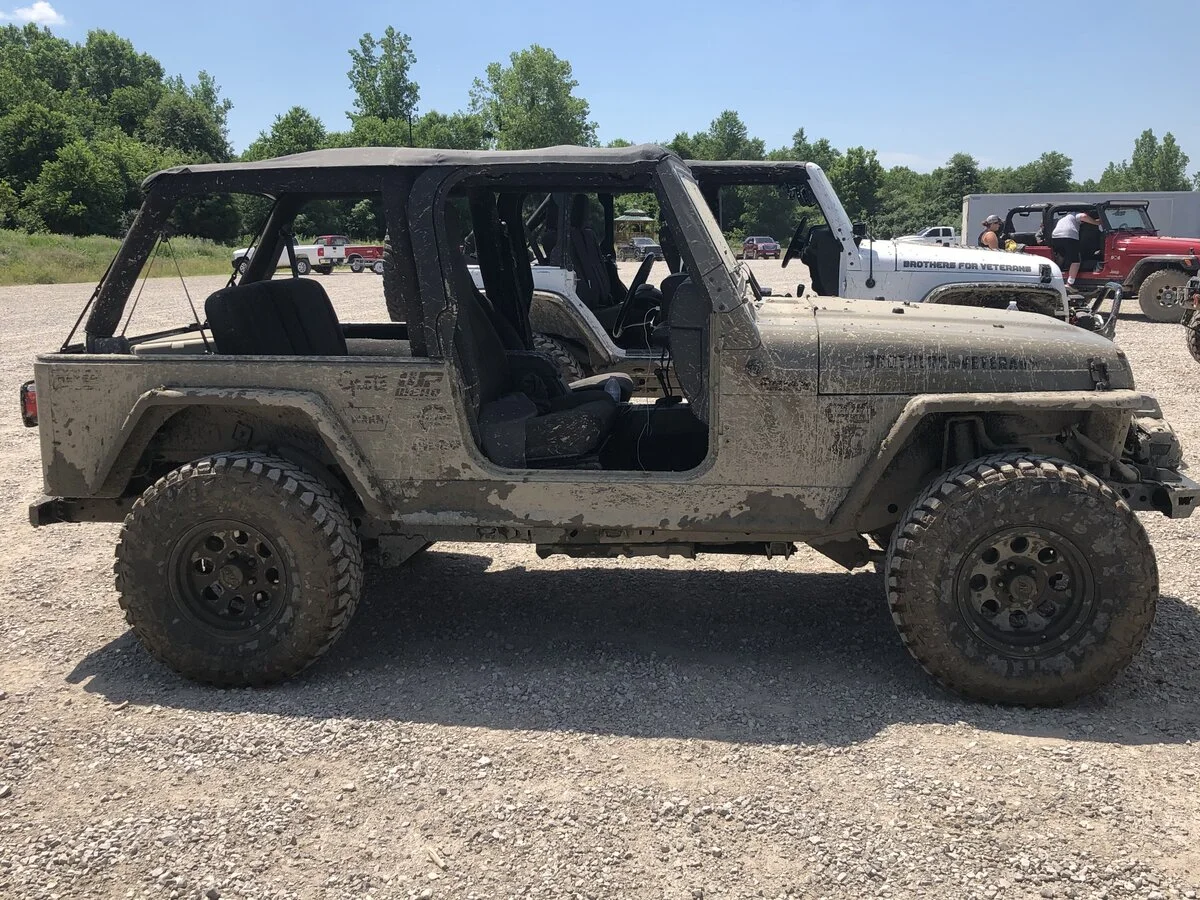

Here is a picture of both the rigs we use. My 2015 JKUR and the 2004 LJ. Our Veteran was behind the wheel for the entire trip in the LJ and did an awesome job!!

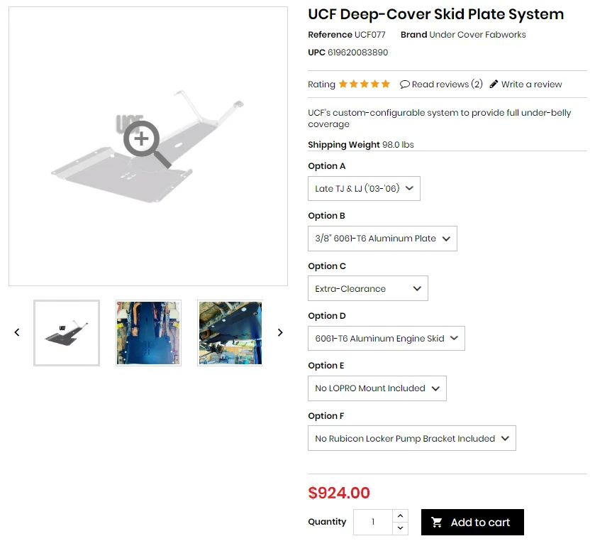

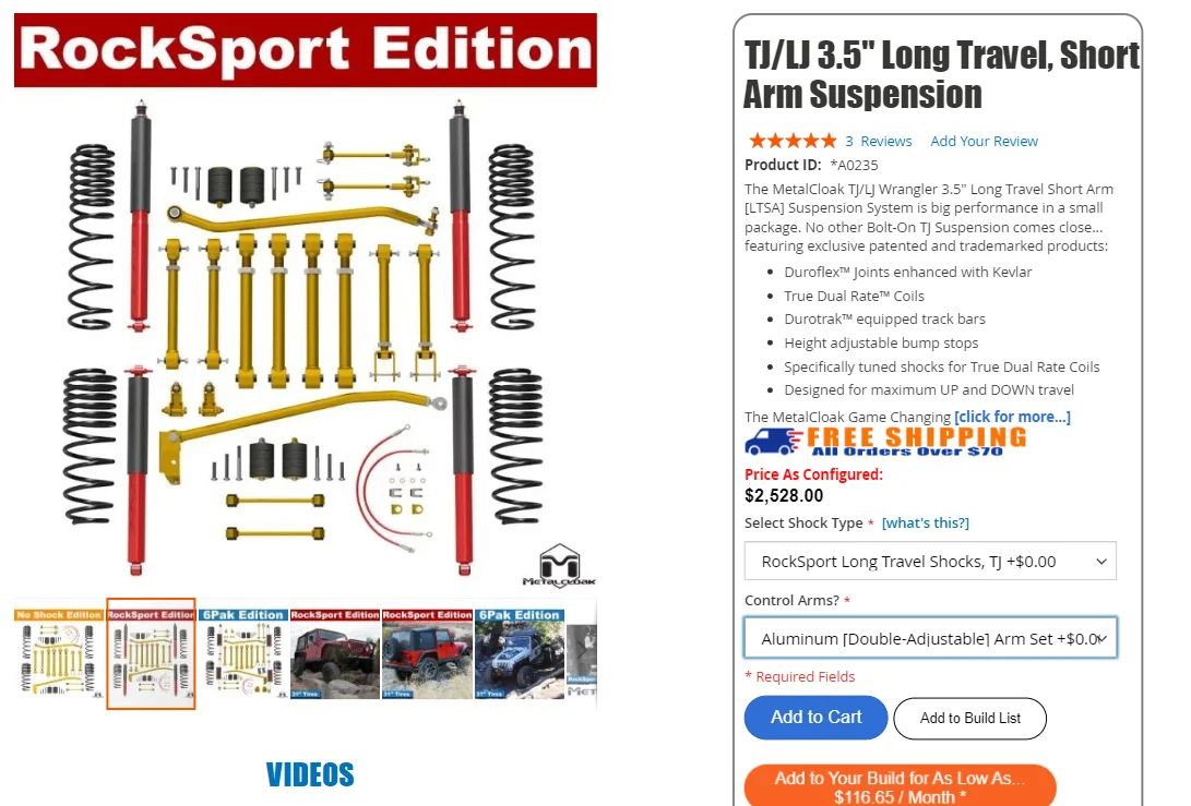

Looking to go with the Metalcloak 3.5 short arm kit and also add UCF full skids underneath. I'm running the 3.5 gamechanger kit on my JK and love it. Would like some feedback from you all on the skids and lift. Thanks!
View attachment 170185View attachment 170184
Metal Cloak is not real popular on here, most say due to their marketing..... Savvy is big here andthey are top of the line stuff..... I too have been looking at the MC stuff, I like the bushing idea over the JJ, some on here will flame on that statement, but........ there is zero maintenance for bushing...... just my 2 cents
The only thing I can tell you is to talk with those who have had Metal Cloak bushings and the longevity of them. Yes bushings might not need any maintenance but if you have to replace them every 10K miles are you really getting zero maintenance? I'm not saying they wear out that fast just throwing a number out there.

I have 40K on my Duroflex bushings. No wear. I checked them at 30K. Super easy to take apart and check too. No special tool, other than snap ring pliers and a hammer.
The springs, however, I have reservations. No personal experience with them, but the dual rate thing may look good on paper, but having half your spring collapsed at ride height doesn't make a lot of sense if you have your shocks set up proper.
