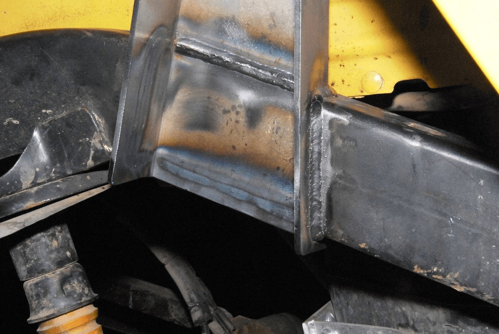

Is there a reason why the rear mounts are not flush with the bottom of the frame, @jjvw and @TJDaveX?
For me, I measured and measured, cycled and cycled the suspension. I wanted close to equal up and down travel with the lengths of shocks that were available. This is what I ended up with. What I didn't account for was spring settling and off road gear loaded in the Jeep. There was a ton of stuff being done to the Jeep all at the same time, including brand new springs. There is definitely more down travel than up travel now. If I could do it all over again, I would of mounted them slightly higher.
They are kind of stuck where they are now!
Had the built Dana 44 axle I bought not have had the Poly Performance lower boxed shock mounts already on it, I'm not sure if I would of done it. But, the previous owner of the axle ( very wise and well respected in the Jeep community ) explained the benefits, and showed me how he mounted his upper mounts on his then yellow LJ. That sold me on going through with it. I am still very happy with how the Jeep performs and rides after all these years.

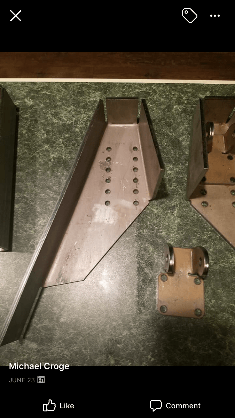

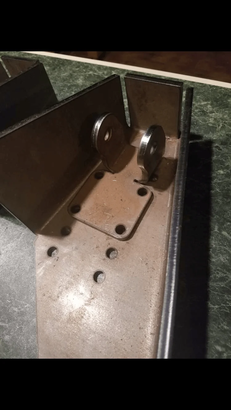

Would an adjustable upper rear mount (I think Dave from Jeep West fabricates them?) make the job easier? As I was thinking about the process and how many measurements are required prior to burning them in, I came to the conclusion that you pretty much get one shot. Is there any downside to having an adjustable mount?
Don't have a pic of the lower mount but it sounds like you have the other end of this one I did?

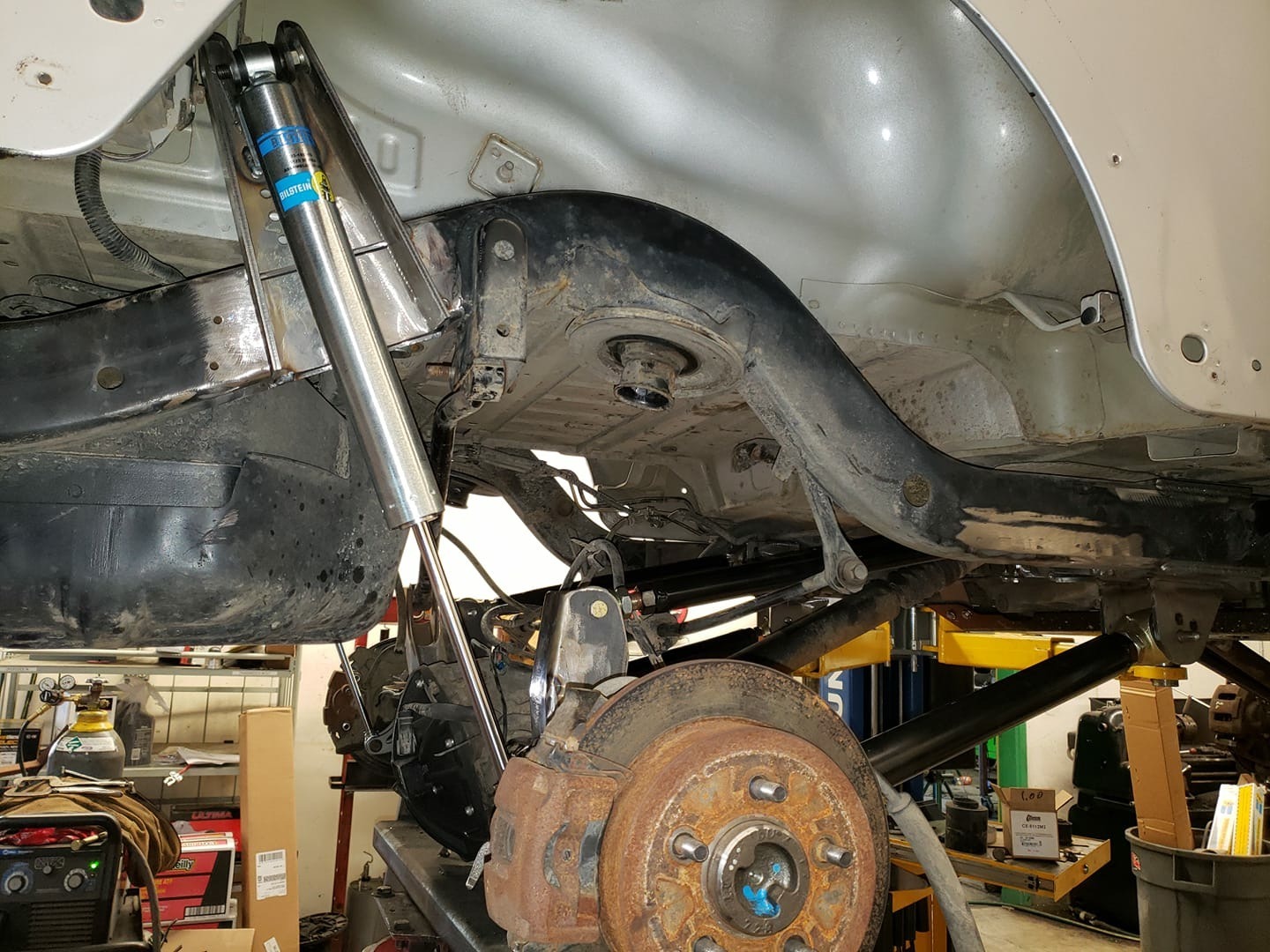

Is a caliper relocation kit needed for a Dana 44 when outboarding the rear shocks, or can it be done with the calipers in the stock location?
Needed? No, you can generally spend enough time cycling it and get the mounts positioned so the caliper doesn't hit the shock body under full articulation, but it takes a lot longer. It also limits how much real estate you can use to get the shock where it needs to be rather than where the caliper forces it to be.
OK, sounds like your kit is the way to go then. Thanks for the response! :)
It's a pretty clever kit. I can see where it made the job much easier. Plus the parking brake works a bit better than before.
