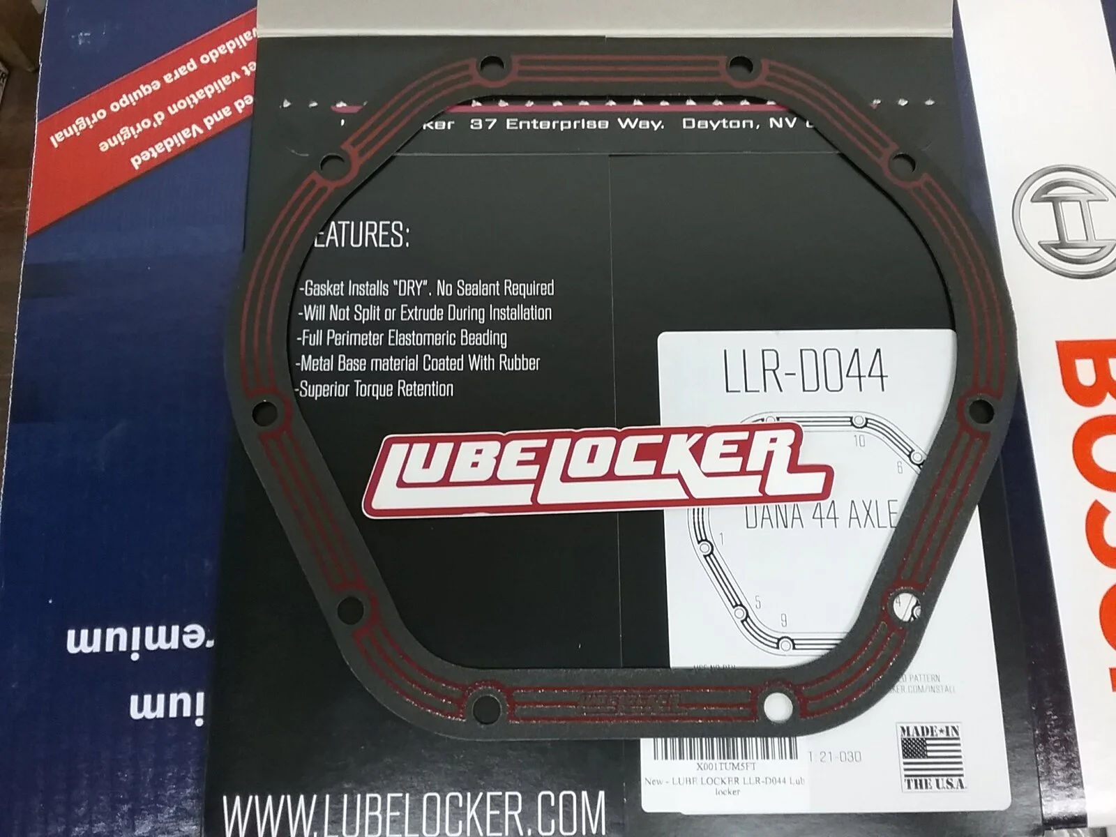

Preparations for diff diagnosis. I need to be able to drive it home after inspection, so gonna give this a try.
You'll question why you ever used RTV in the past. The Lube Locker is so nice.
Just think this will be the last time you clean RTV off the mating surfaces. (on that axle)
Those are nice. I have them front and rear on my TJ. I also have one on the Rubi, but for some reason it drips, and everything is torqued down right, so I don't know what the deal is with that LubeLocker. ☹️
Warped cover maybe?
Reactions: Indy
Warped cover maybe?
I know the LubeLocker itself is warped, but it dripped on another Dana 44 I once had it on too, so something wrong with that particular gasket. A bit annoying. I'm either going to have to buy another one or go to RTV. I am selling this Rubi, but a friend is buying it, so maybe I should just do another LL and call it a day.

I've installed LL's on other peoples rigs but hadn't gotten them for mine until now. Crap I even have one for my transmission. So it'll be interesting to see how they do.
Reactions: DrDmoney
