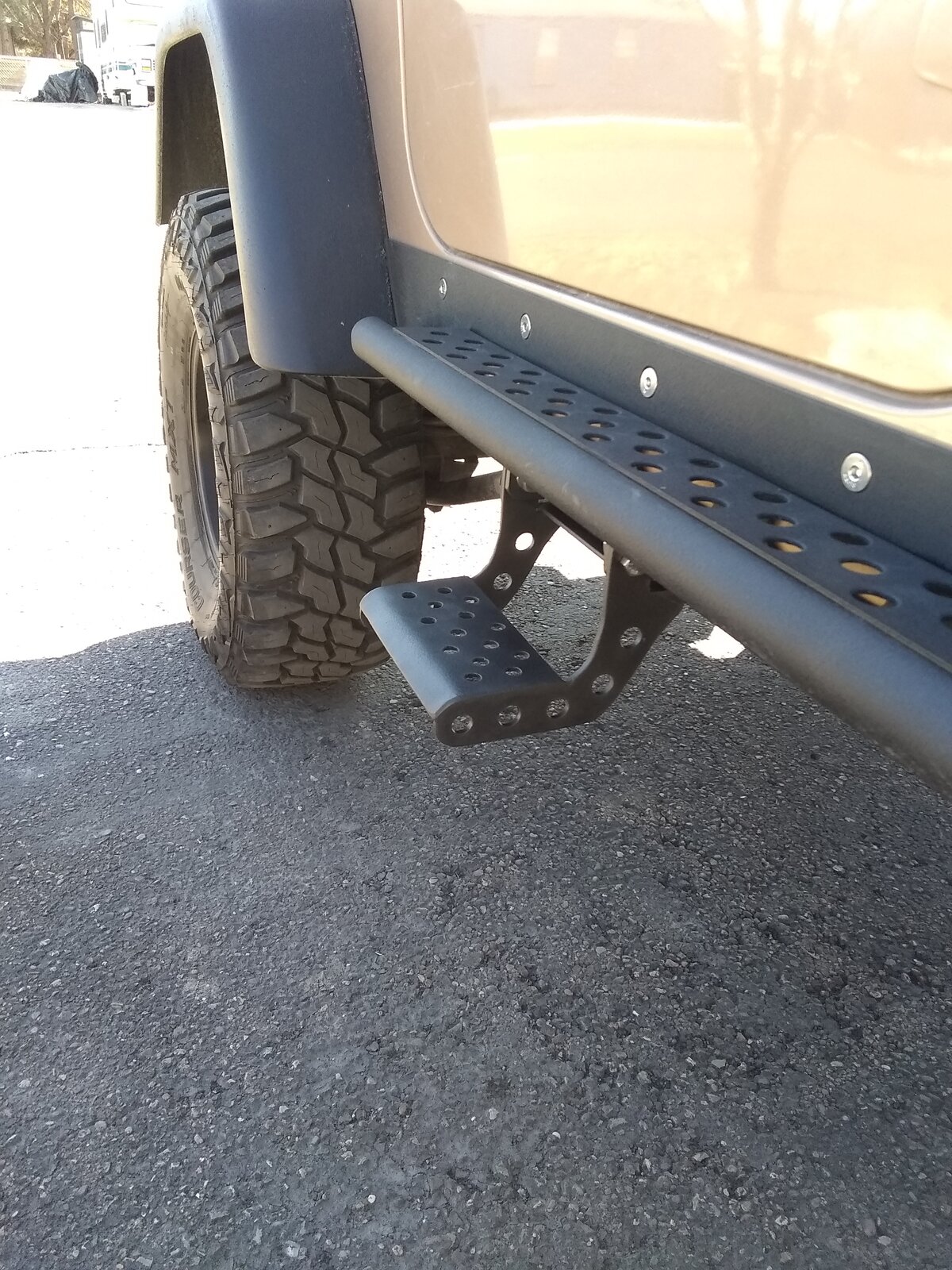

My wife is vertically challenged, so you'll also spy some Warrior rocker steps in this pic.
My wife too ! So I built some detachable steps for my rockers. Happy wife/Happy Jeep life
