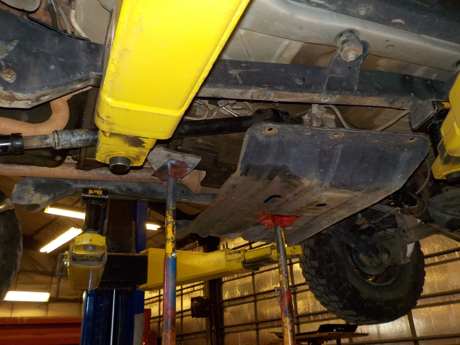

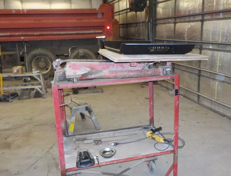

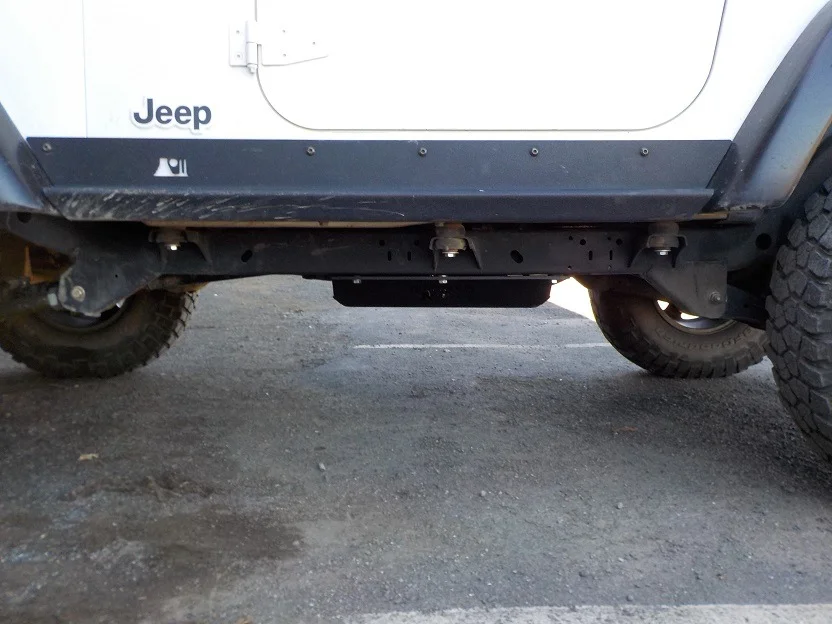

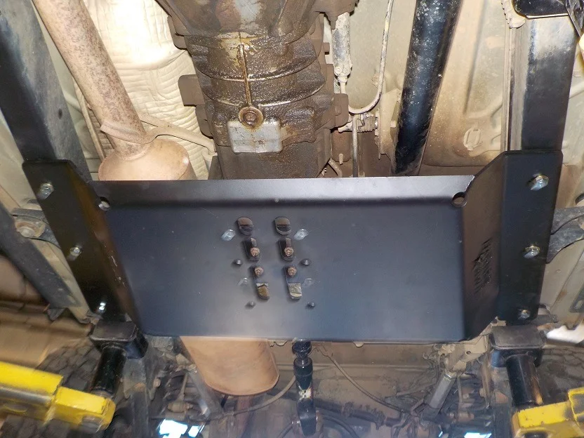

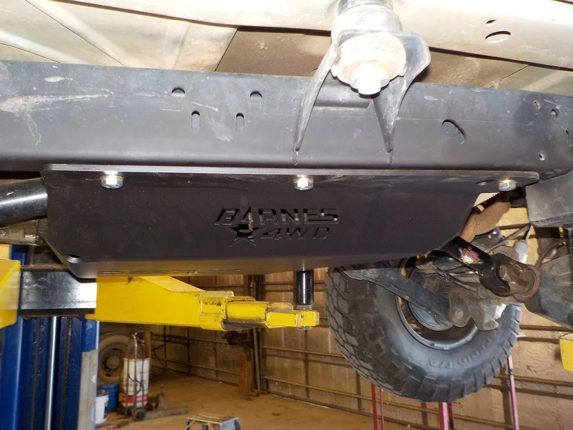

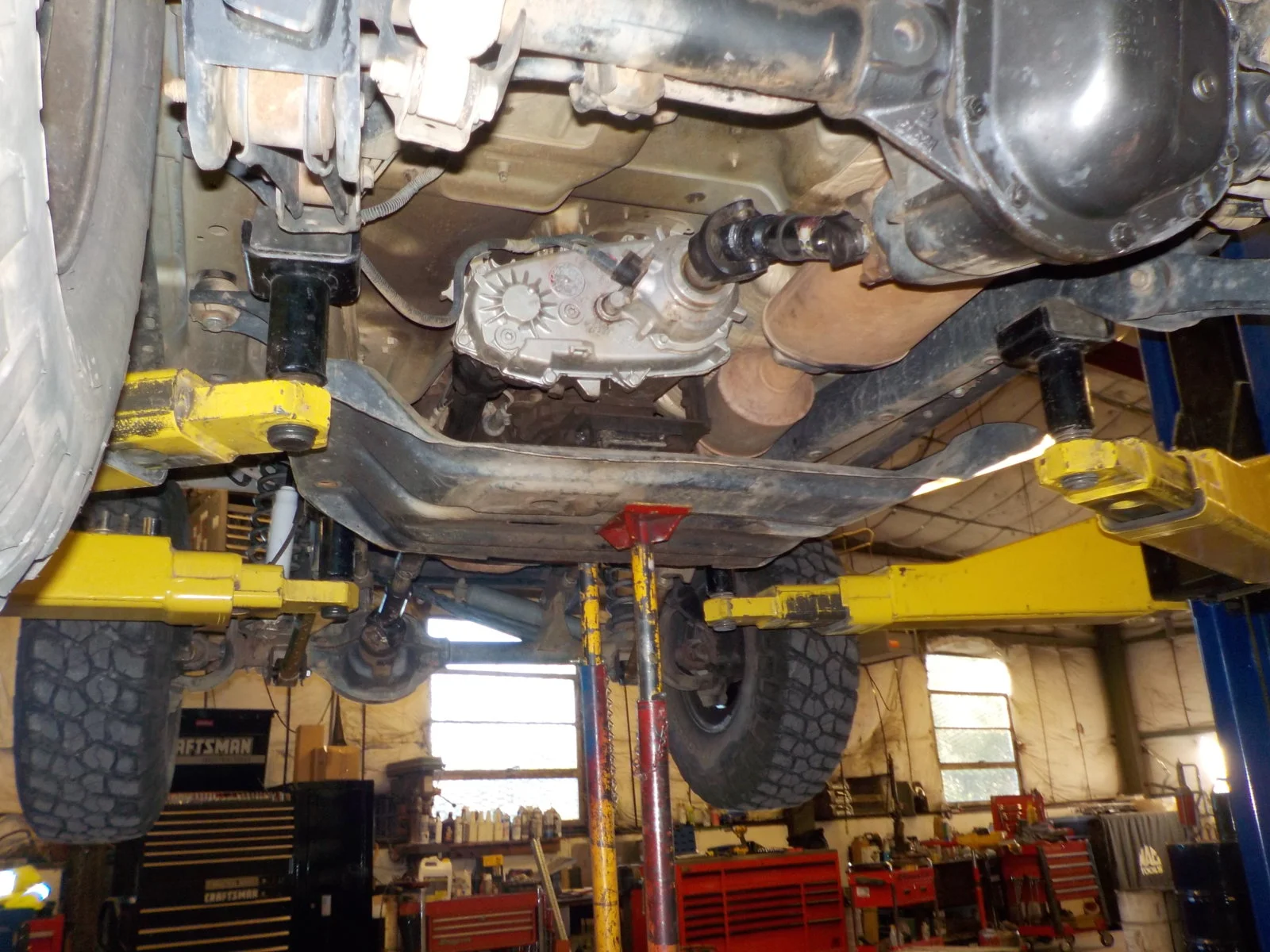

Today was baby tuck day. Got the old shovel off with little drama.

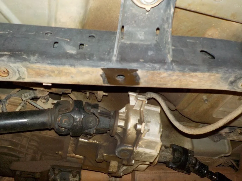

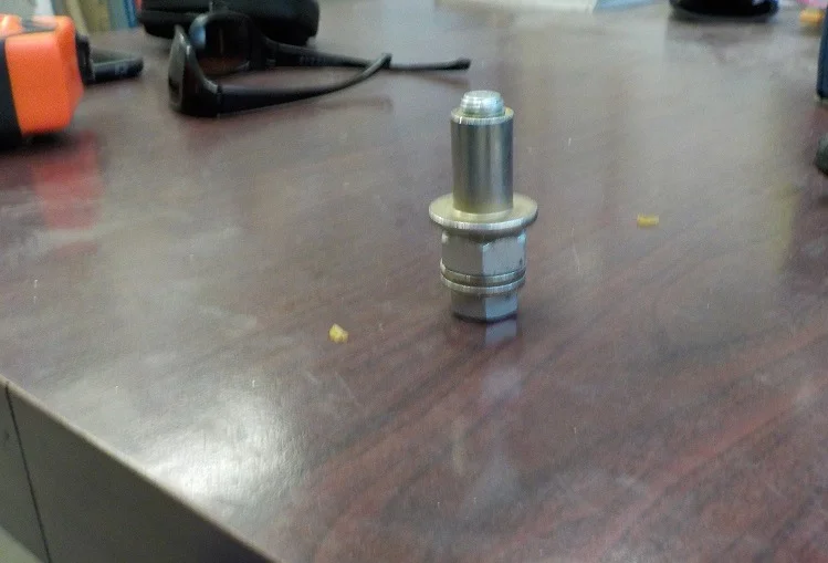

There was a little bit of surface rust on the frame at the mount location, so I cleaned that up a bit and ground the bad nutzert out to install a new one.
Blaine's nutzert install instructions went without a hitch.
New nutzert installed.

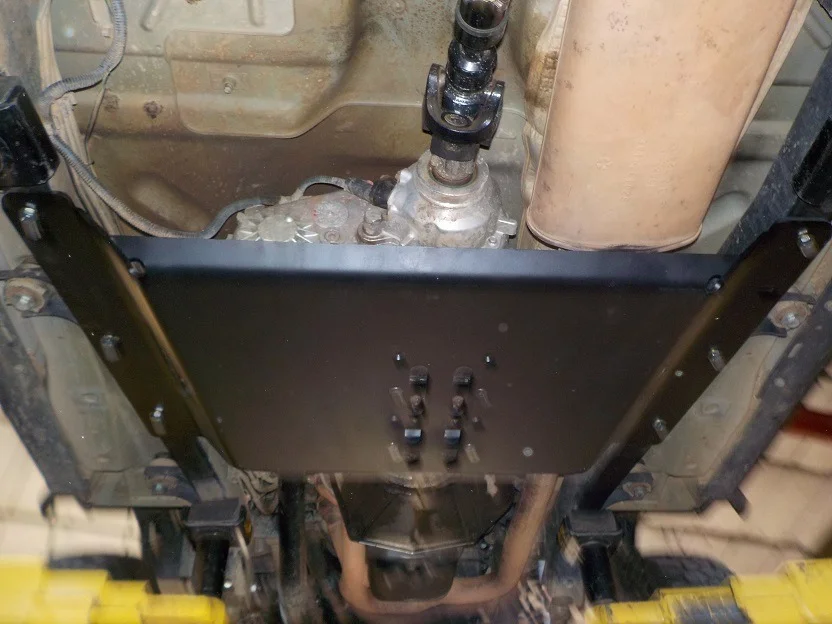

Ready for baby tuck.
The trany jack made it easy.

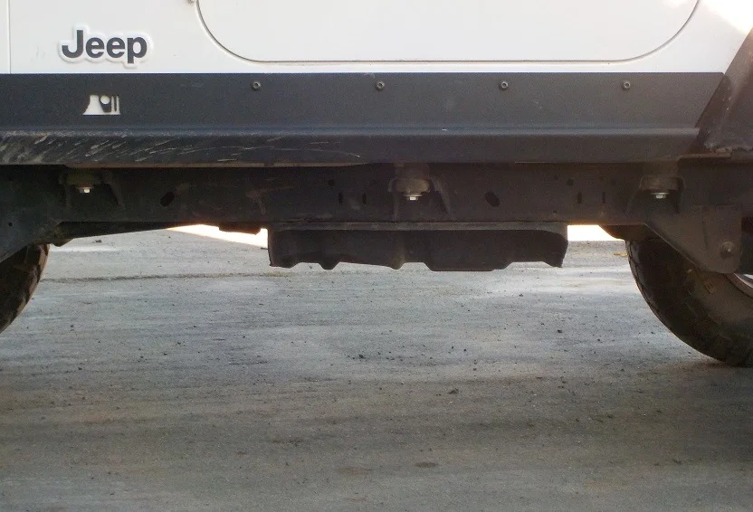

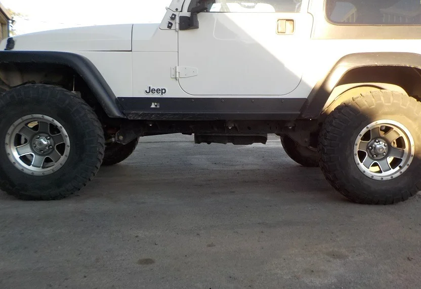

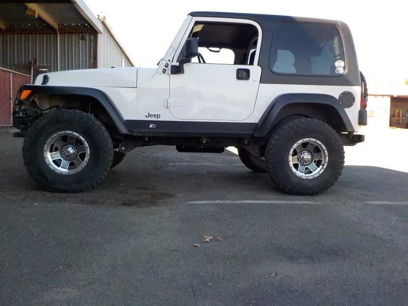

Everything bolted up as advertised. Here's a few before/after shots.
LeShovel.
Baby tuck!

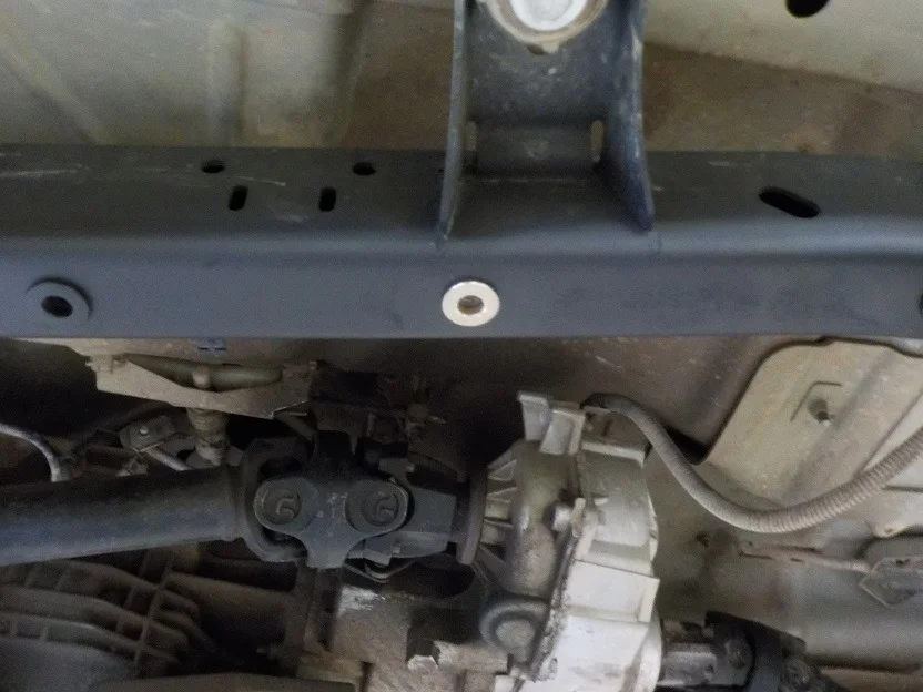

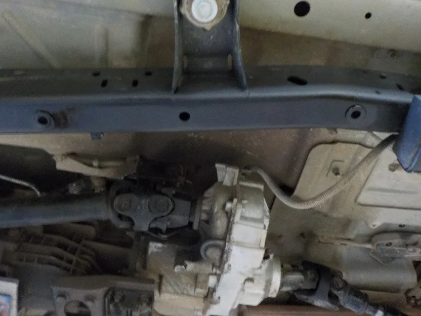

Now on to the numbers. Pinion angles before the install:
Rear DS = 14.5*
Rear pinion = 13.5*
Front DS = 6.3*
Front pinion = 7.4*
After install:
Rear DS = 13.0*
Rear pinion = 18.0*
Front DS = 7.5*
Front pinion = 7.6*
(+ -) margin for error on the pinion angles since they should not have changed. The front DS didn't change much, but the rear DS, Oh my! Took it for a test drive and it drove smooth. My annoying vibe is still there but no rear DS vibe at hard acceleration. Still 5* low is a lot, so I brought the pinion back up some and now it sits at, DS = 16.5*, pinion = 15.0*. That should be ok for now.
Over all I gained 1-1/8" more clearance. Everything shifts good, and as a matter of fact, the TC linkage is smoother than before, so bonus there!
A step in the right direction brah! Looks good.
Reactions: bobthetj03
I ain't no spring chicken brahs, so the lift helps me sleep at night, instead of popping pain pills. Still had to break out the cardboard to adjust my rear pinion angle.
Reactions: ac_
That was a nice gift to receive. I’d be bonkers about that one. That’s a big step forward.
Question: with the 1 1/8” lift and the change in driveline angle, was the change not sufficient to require a new driveshaft?
Didn't really think about it, but looks good so far.
