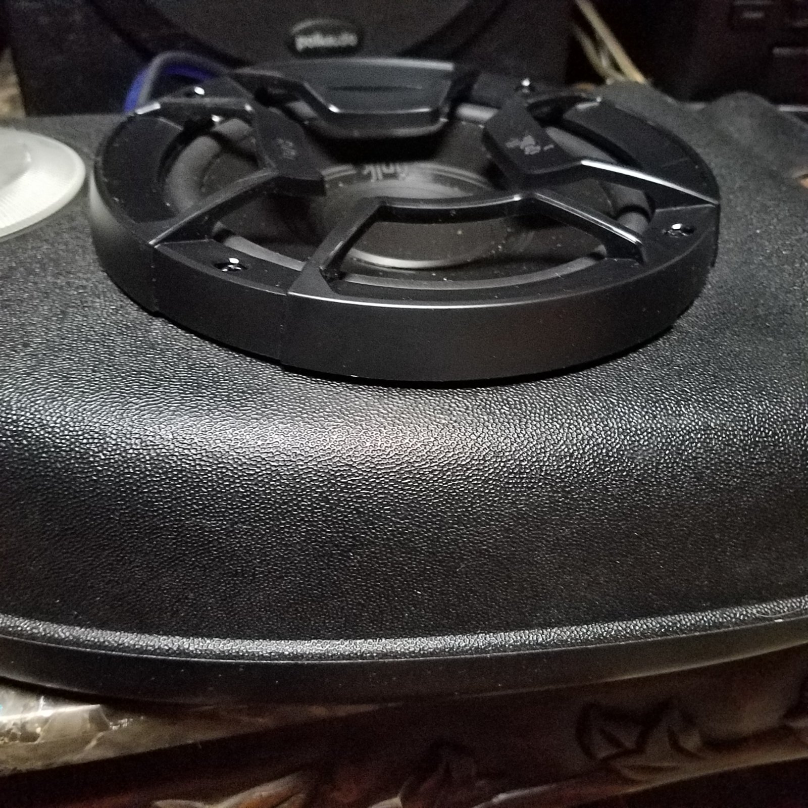

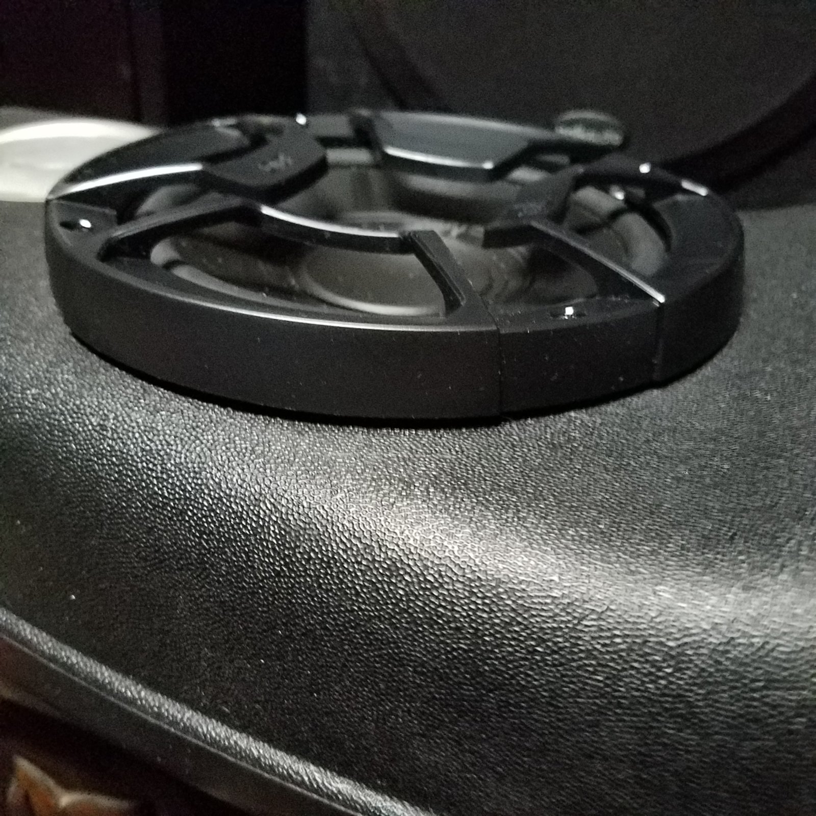

Consider the Polk 6.5" for the speaker pods, it is worth it from a sound standpoint. Pics of what it looks like. Also, stuff the pods with polyfill regardless of speaker size. 20180425_072931.webp20180425_072908.webp

Crutchfield says 6.5" doesn't fit. What harness do I need to make them work?
6.5" fits in the soundbar used in 2002 and older TJs without modification. I'm not sure about the sound pods introduced in in 2003.

Don't waste your time on 6.5's in the sound pods. They are so close to your ears you need to tone them down to get a proper sound stage.

03+ doesn't fit without modification. Not worth it IMO.
In this case, I'll stick to the smaller ones. I don't want to spend too much time on this, just enough to get a solid improvement without spending a week on it.
