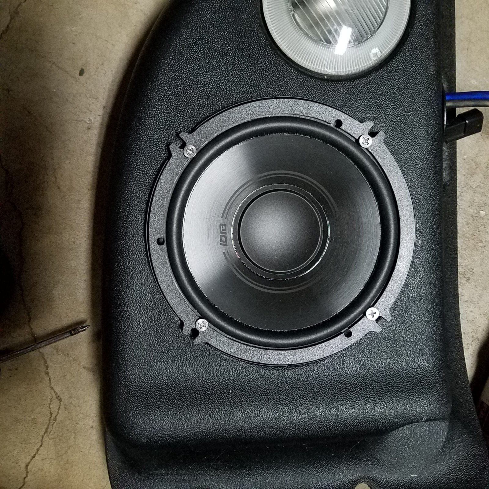

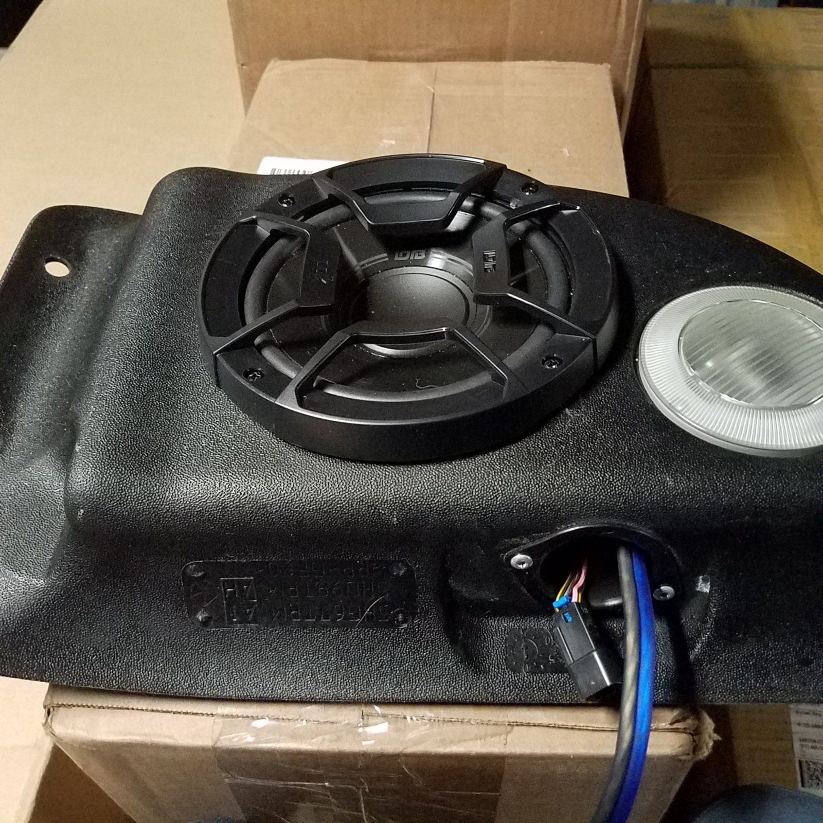

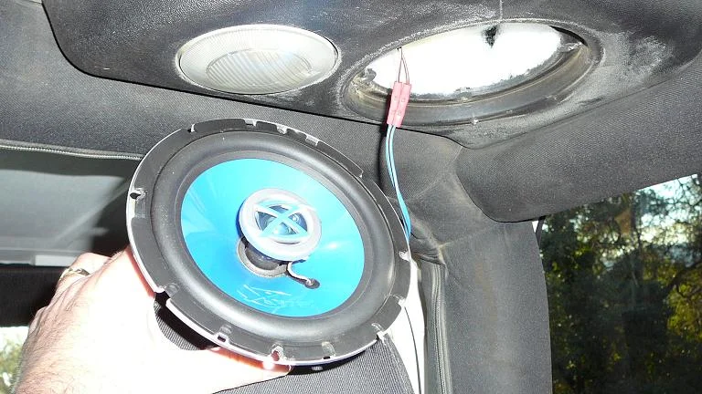

6.5" fits in the soundbar used in 2002 and older TJs without modification. I'm not sure about the sound pods introduced in in 2003.
03+ doesn't fit without modification. Not worth it IMO.

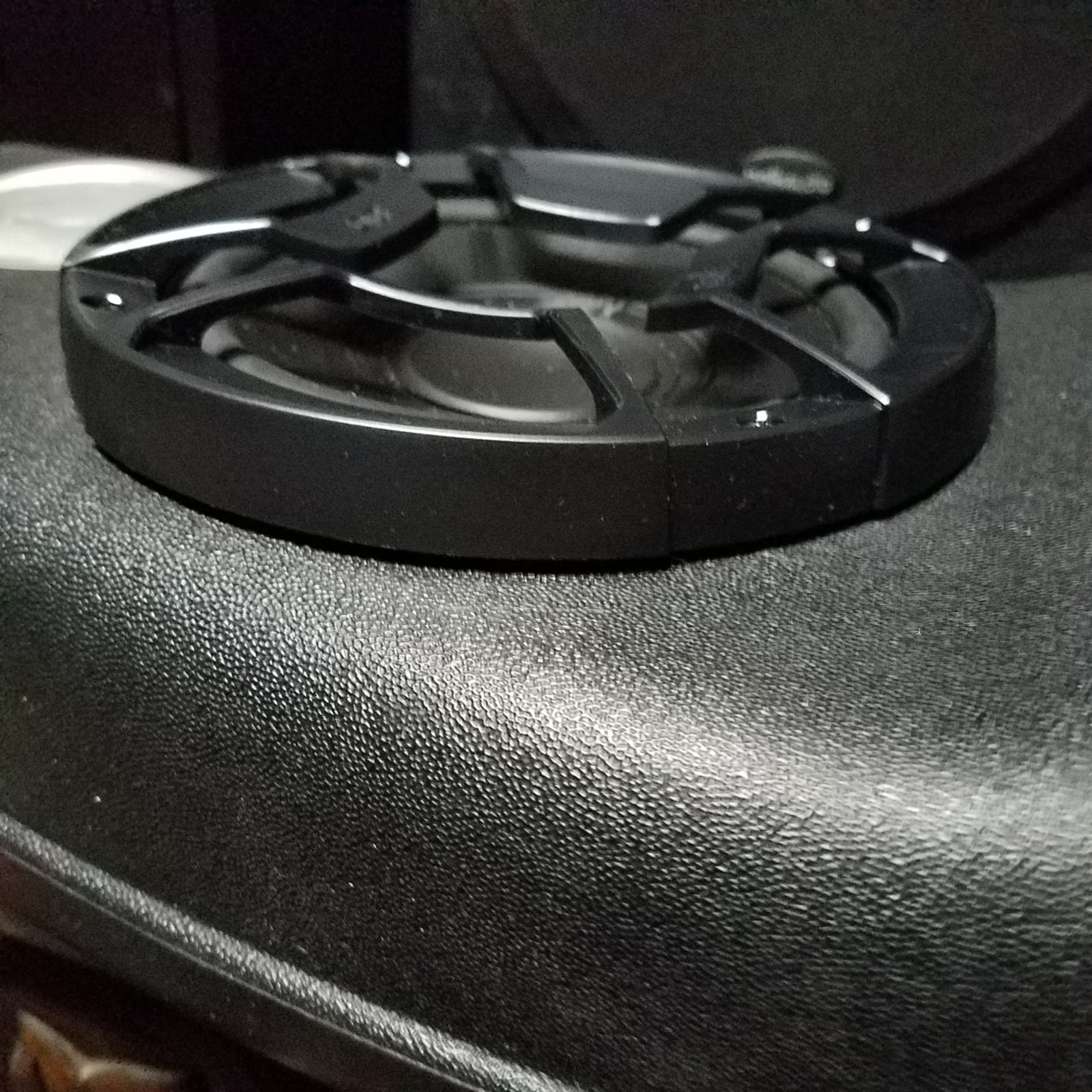

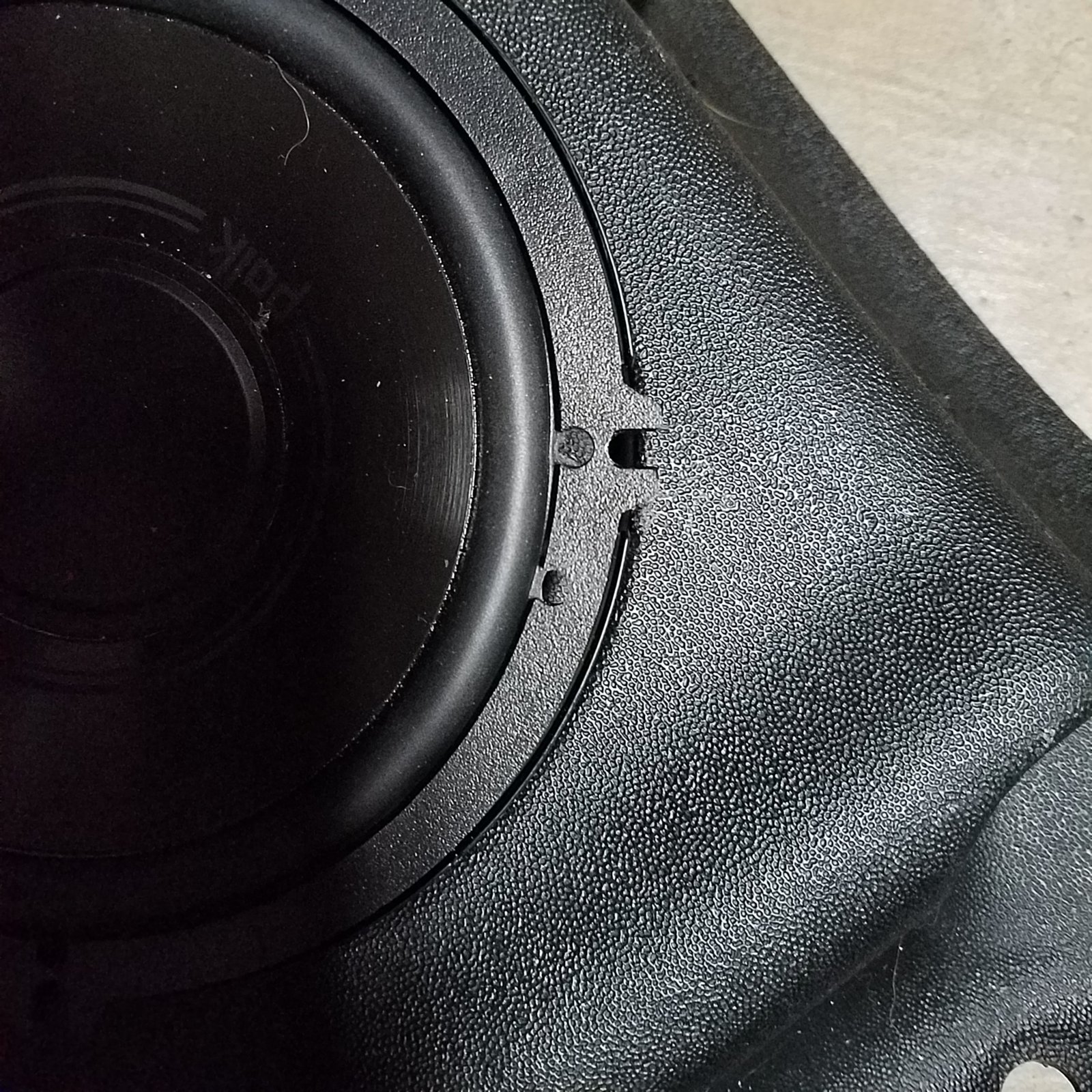

I posted pics of the 6.5" prior to your posts. Here they are...very easy to do, less than 45 mins. I also used some pieces of weatherstrip to keep the rings light covers from rattling.
@bobthetj03 - the 6.5"s fit nicely with just relocating screw holes. By relocating screw holes it is literally screwing a screw into plastic. The sound is fantastic, and I relocated my 5.25" Helix speakers to the front to drop in the 6.5" Polks.
View attachment 71767View attachment 71768View attachment 71769View attachment 71770
Yes, a 6.5" will fit with modification. I had them previously in my pods. I switched back to 5.25's when I bought the Polks and literally can hear no difference or improvement, but like I said earlier, I have them toned down to improve the overall sound stage.
