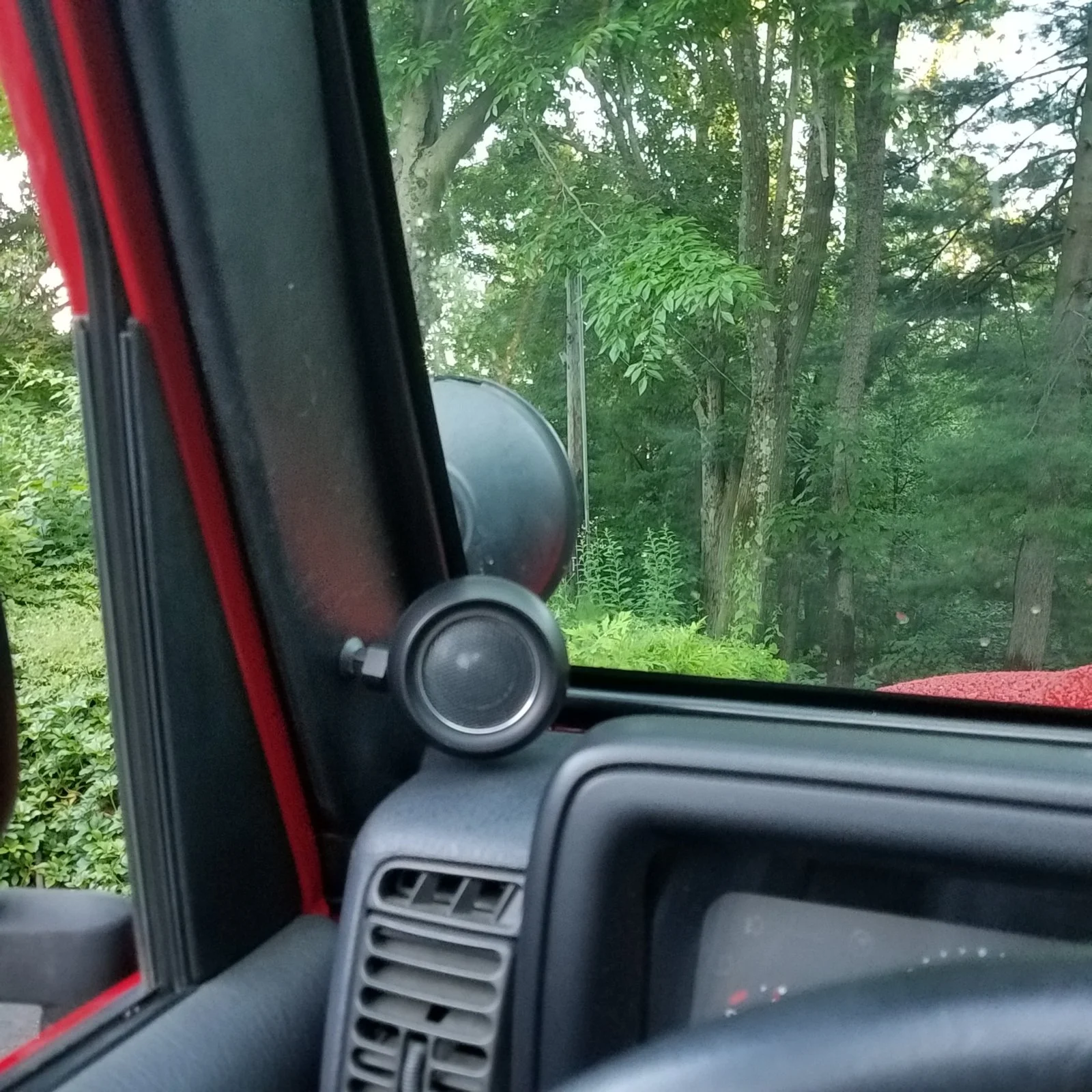

the polks work great, but I think I am going to run a 1" tweeter on the dash to move the sound a little forward.

I think it might complete the system, already did the HU both polks, and upgraded sub speaker (stock location) with an amp just for the sub. Even with the dash speakers in a pod they still are in such a bad location that you can hardly hear them.

Indeed it may complete the system for you. As you said, the dash speakers are just in a bad spot, facing down at your knees, so that is the weak point. By moving the tweeters up high you will get so much more sound on axis hitting you perfectly.
