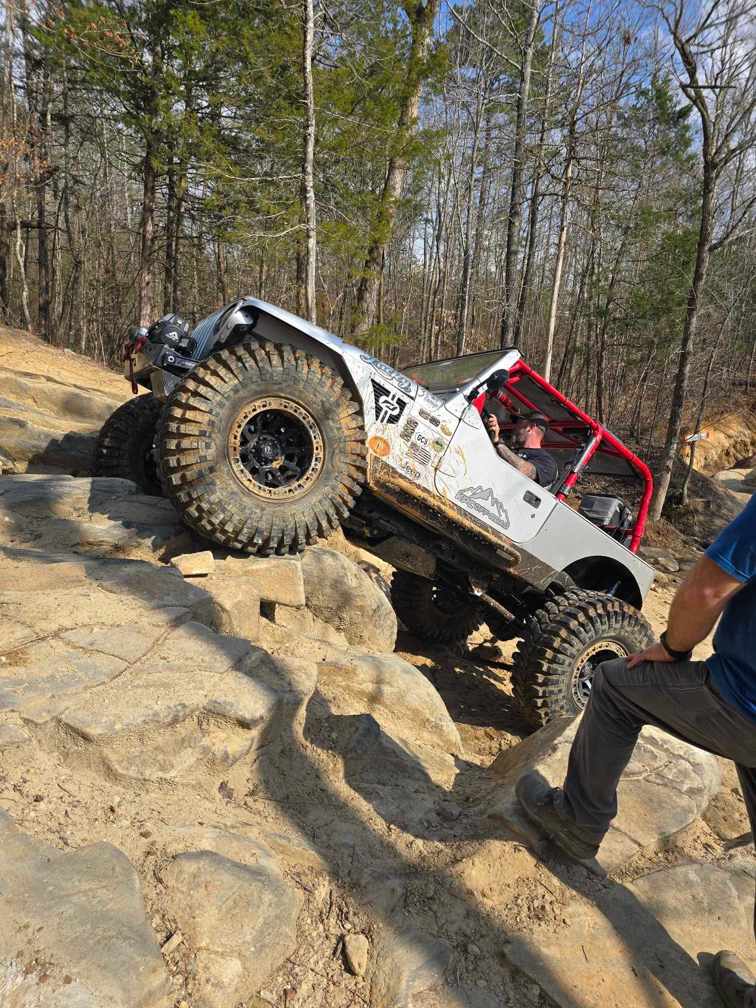

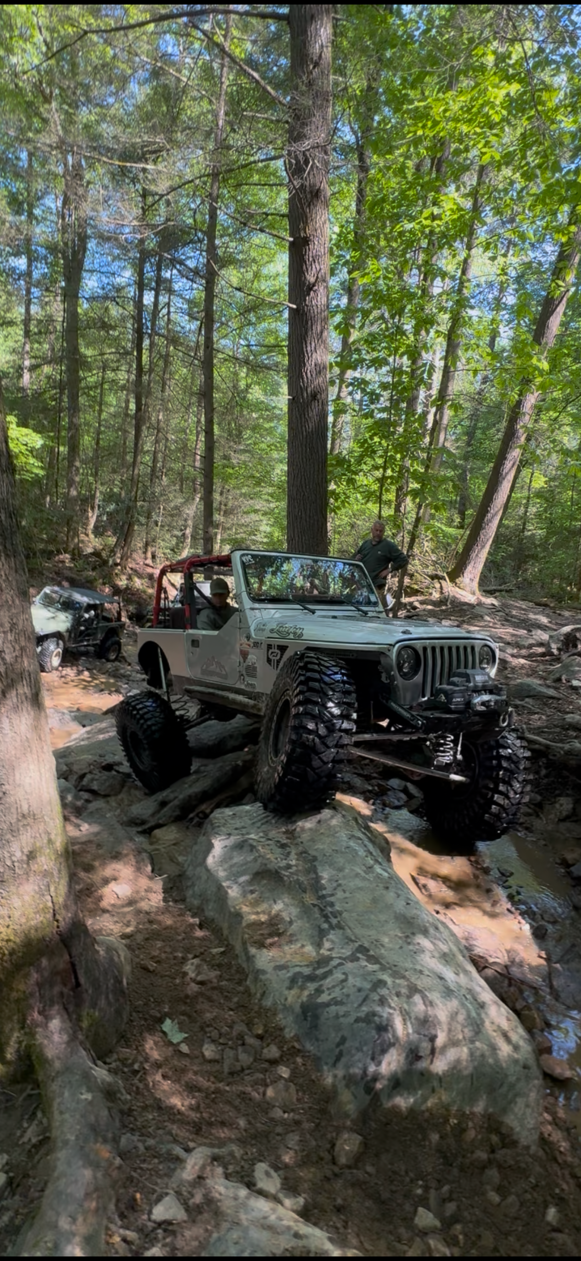

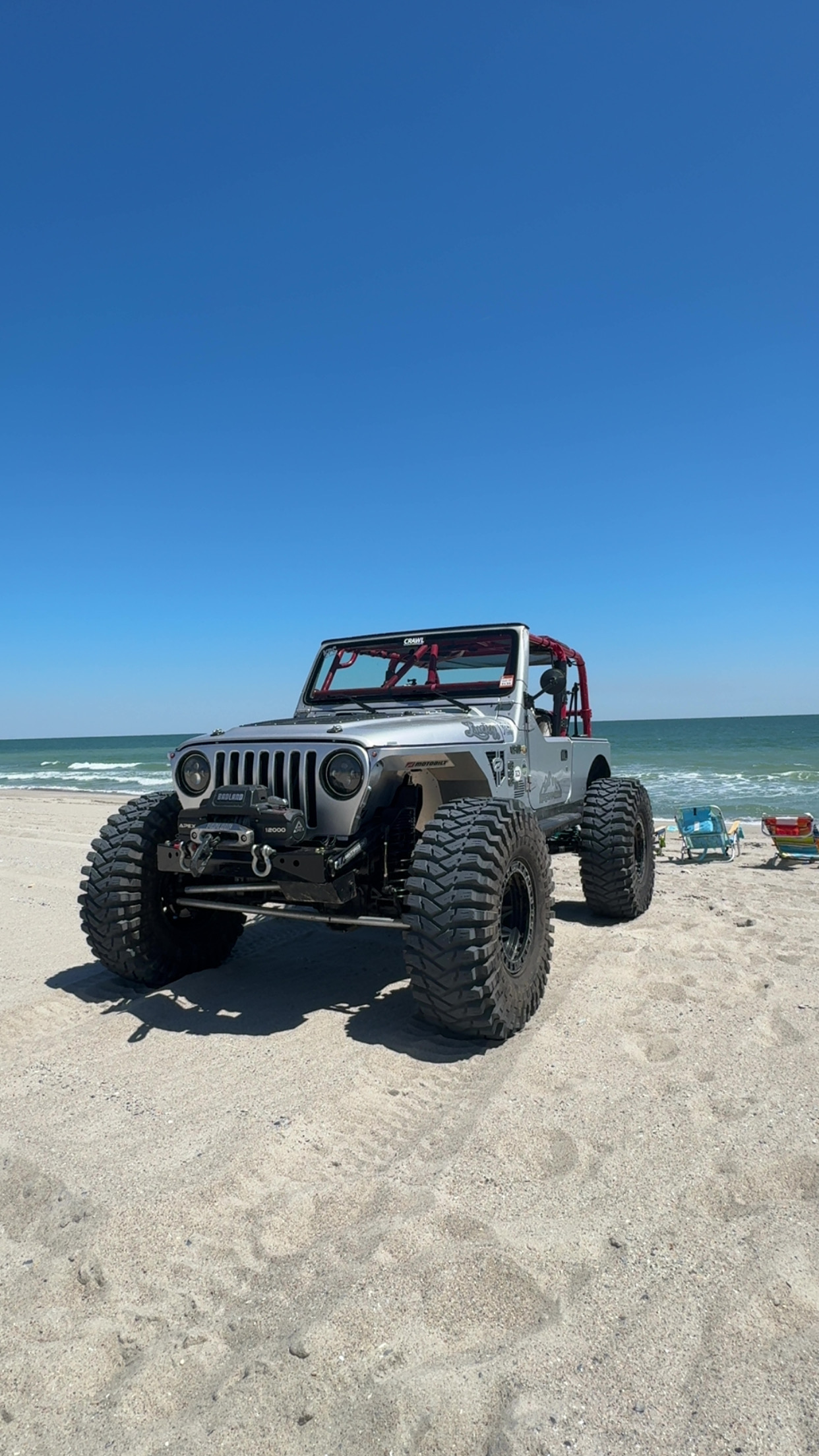

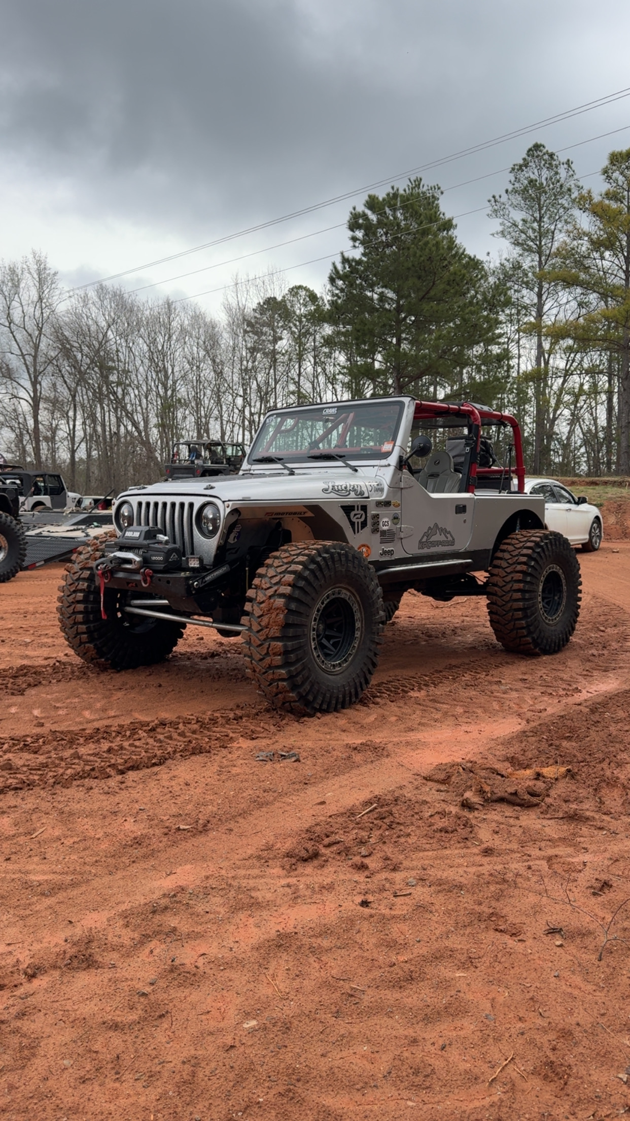

My rig has made some big changes since I originally joined this group. Recently swapped JKR axles into my 03.
Front:
5:13
E locker
Chromoly shafts
Barnes JK2TJ swap truss
OTA track bar mount
Rusty’s off-road long arms
2.5” skyjacker springs
Rear:
5:13 (obviously)
E locker
Chromoly shafts
TMR truss
Rusty’s off-road long arms used for 4 link
Crown performance brake lines
Factory TJ rear springs
40” DOT treps on 17” fuel beadlocks
Motobilt rear armor custom cut
Motobilt high line front fenders
Motobilt front bumper

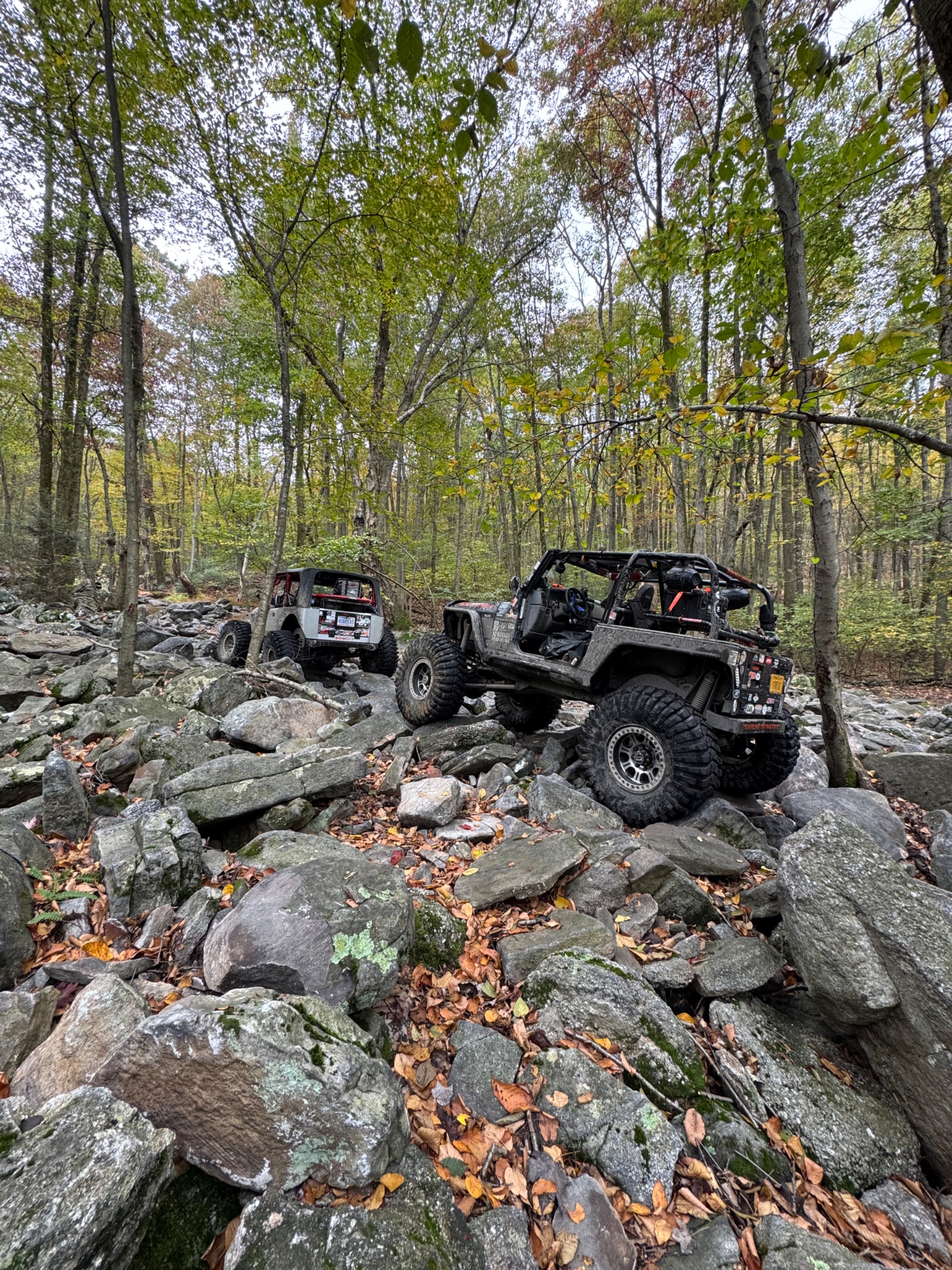

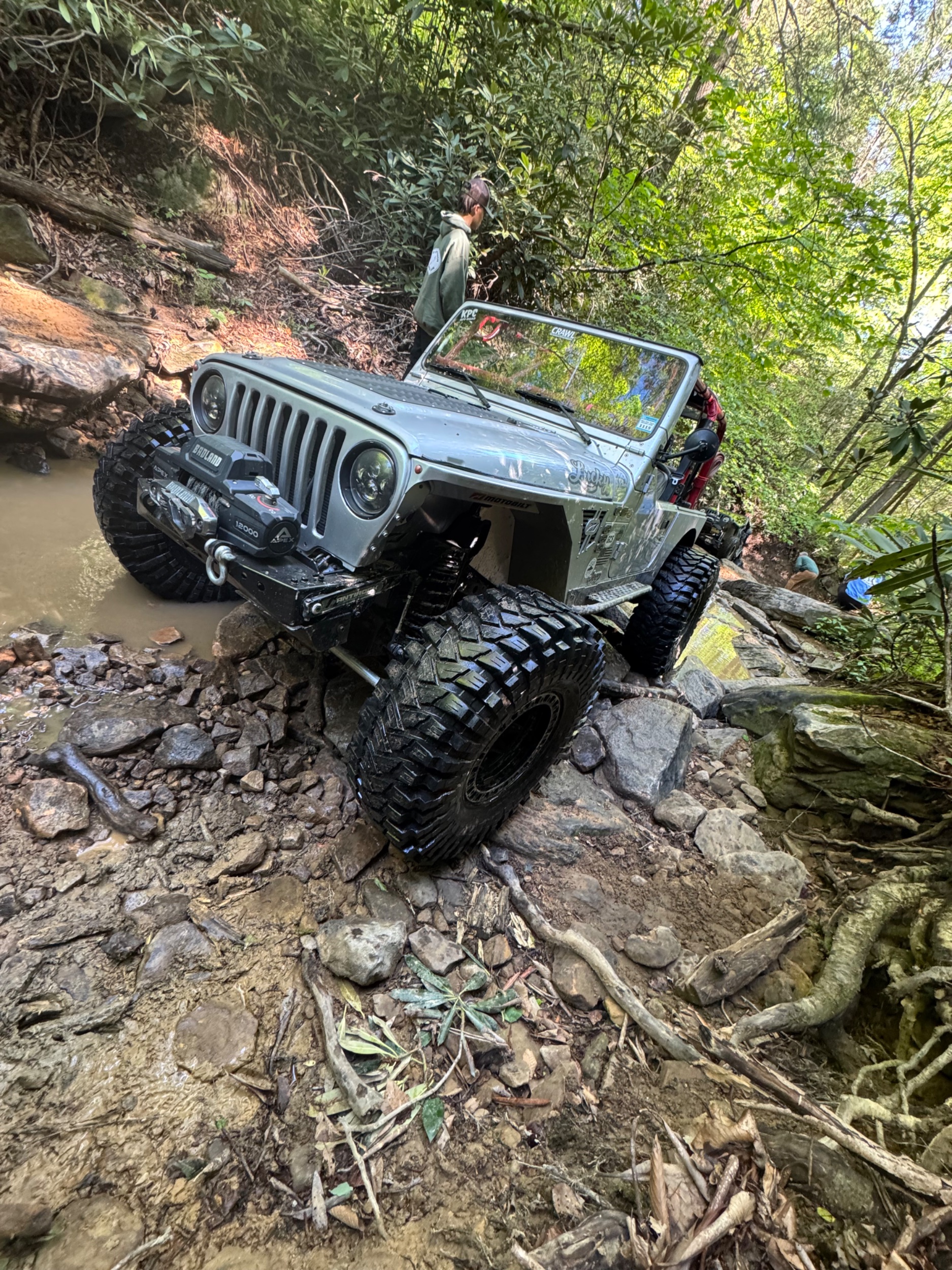

Update on the build. It’s held up great on some tough trails. We’ve hit GER, AOAA, Rausch and Uwharrie. We hit the reds and double blacks at AOAA and rausch with no issues.
Those Treps really set it off! The whole rigg is bad-ass! Nice build!
... Also like the play on "TJK". I have Gladiator control arms in my TJ so I put "TJT" on the side lol... Good lookin' out!

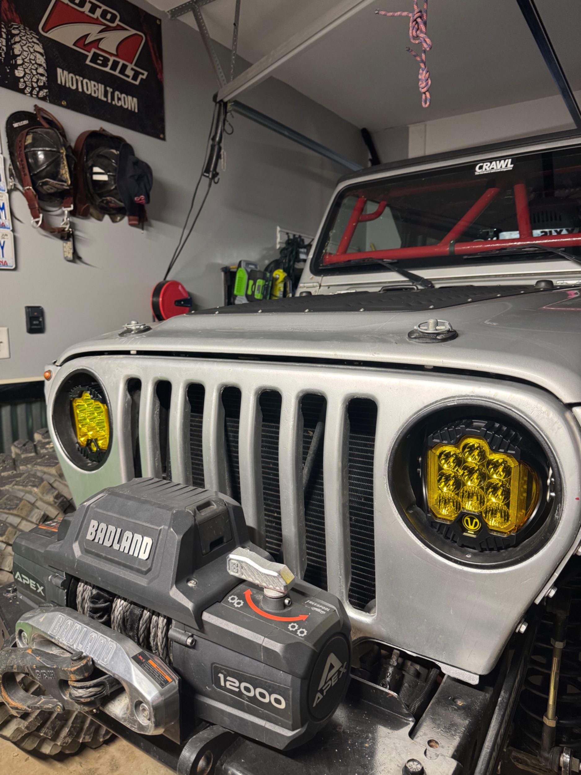

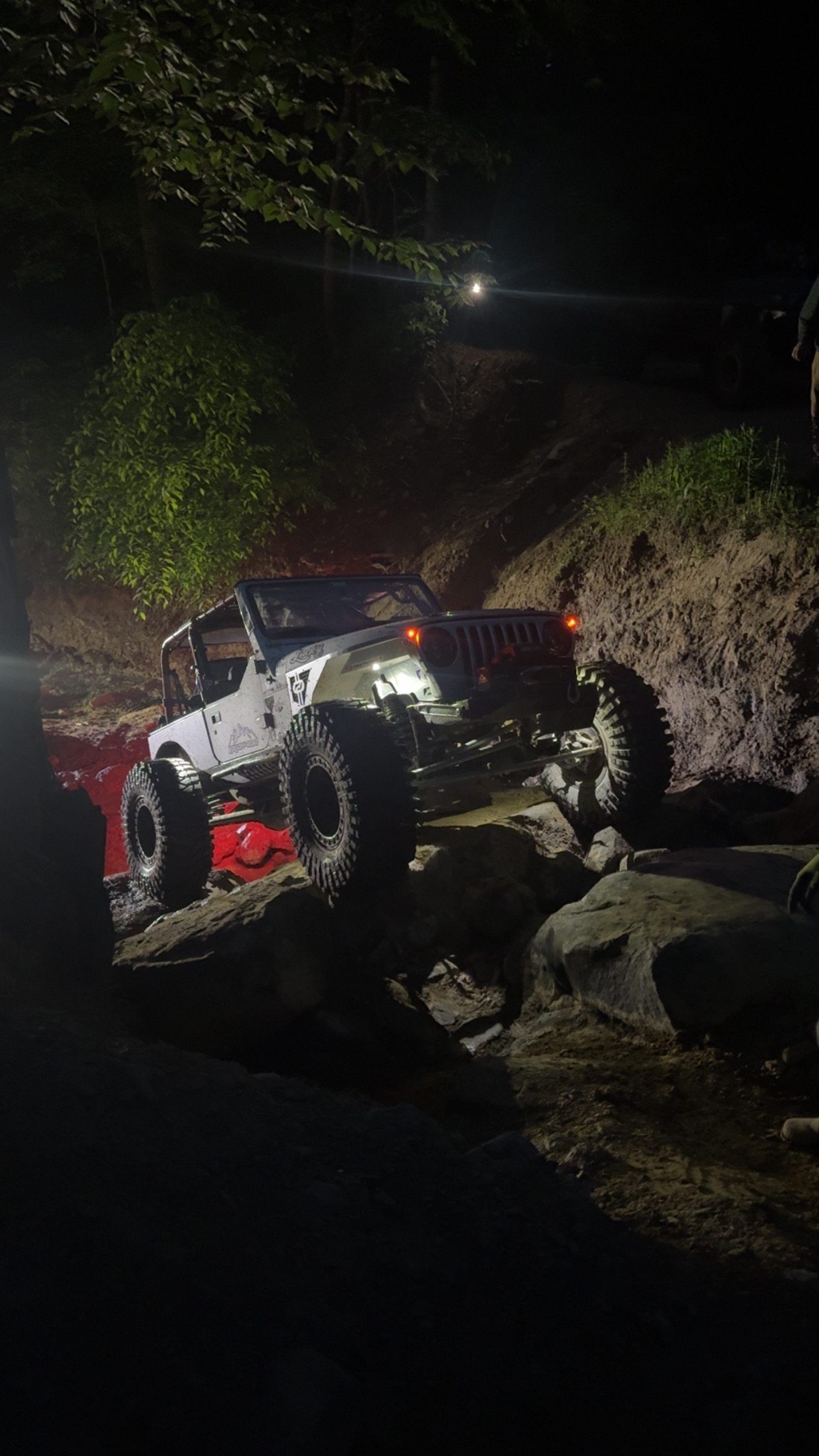

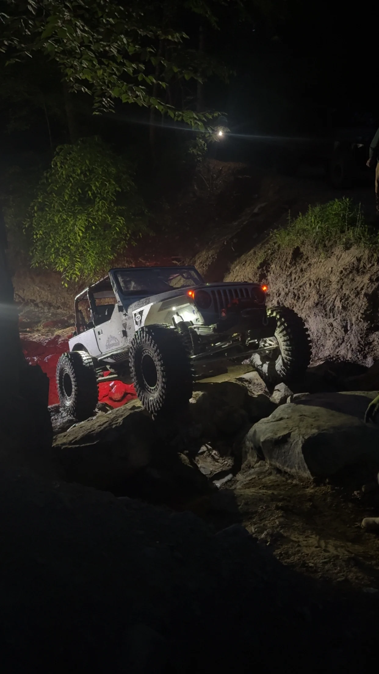

Been wanting to add these style lights for some time. Finally got around to doing them. Happy with the outcome

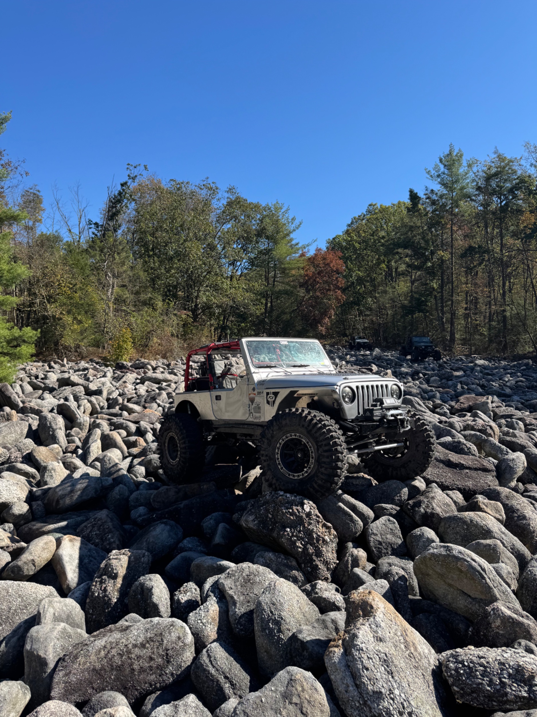

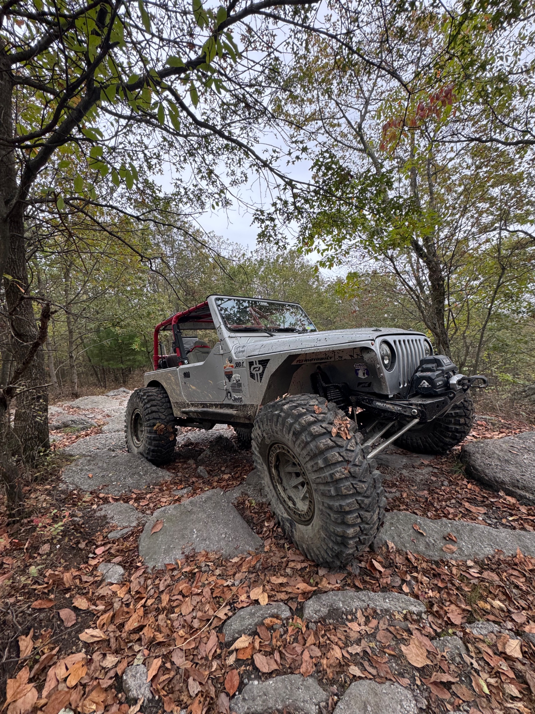

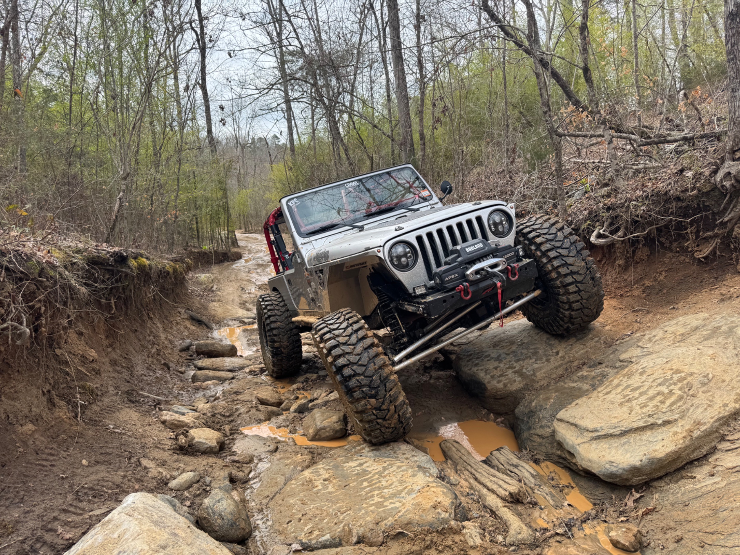

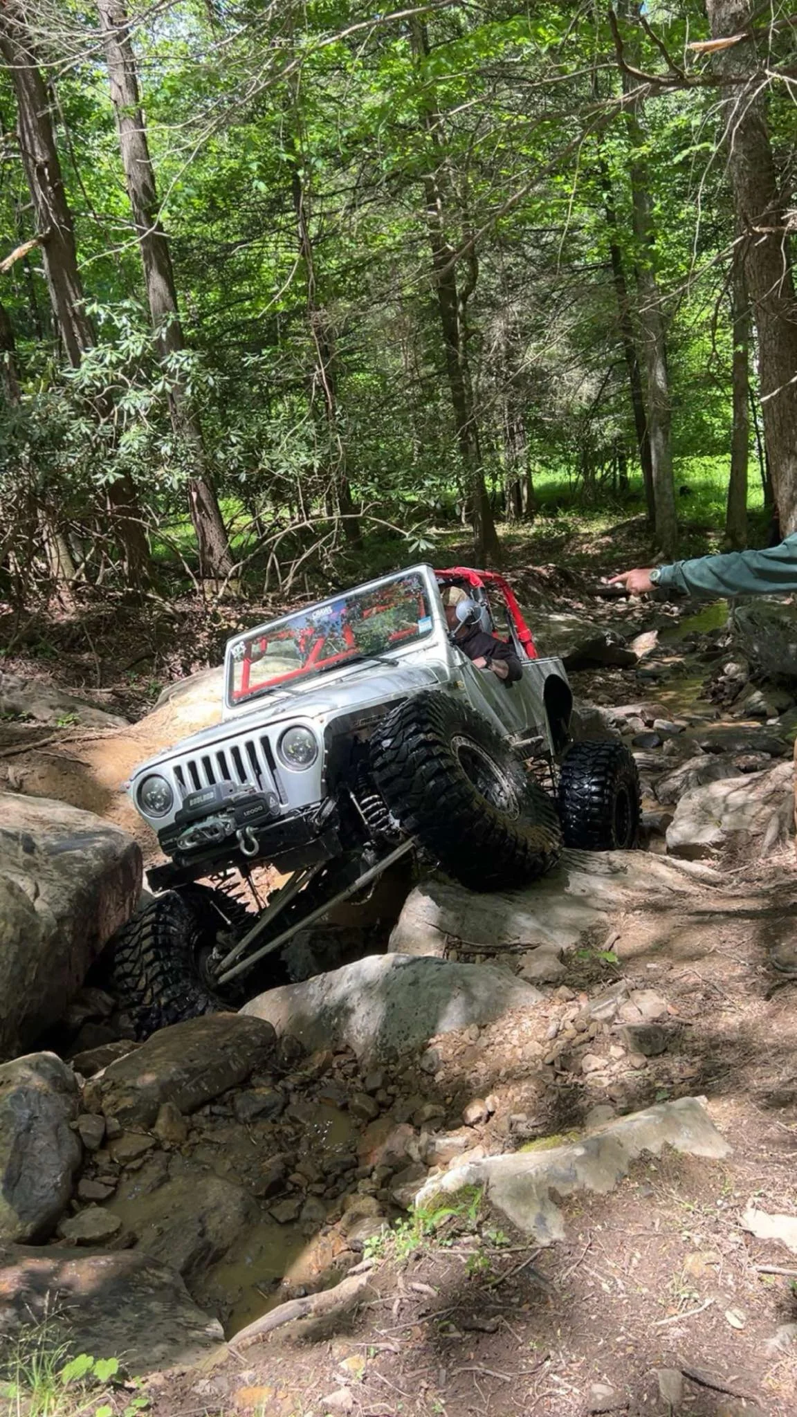

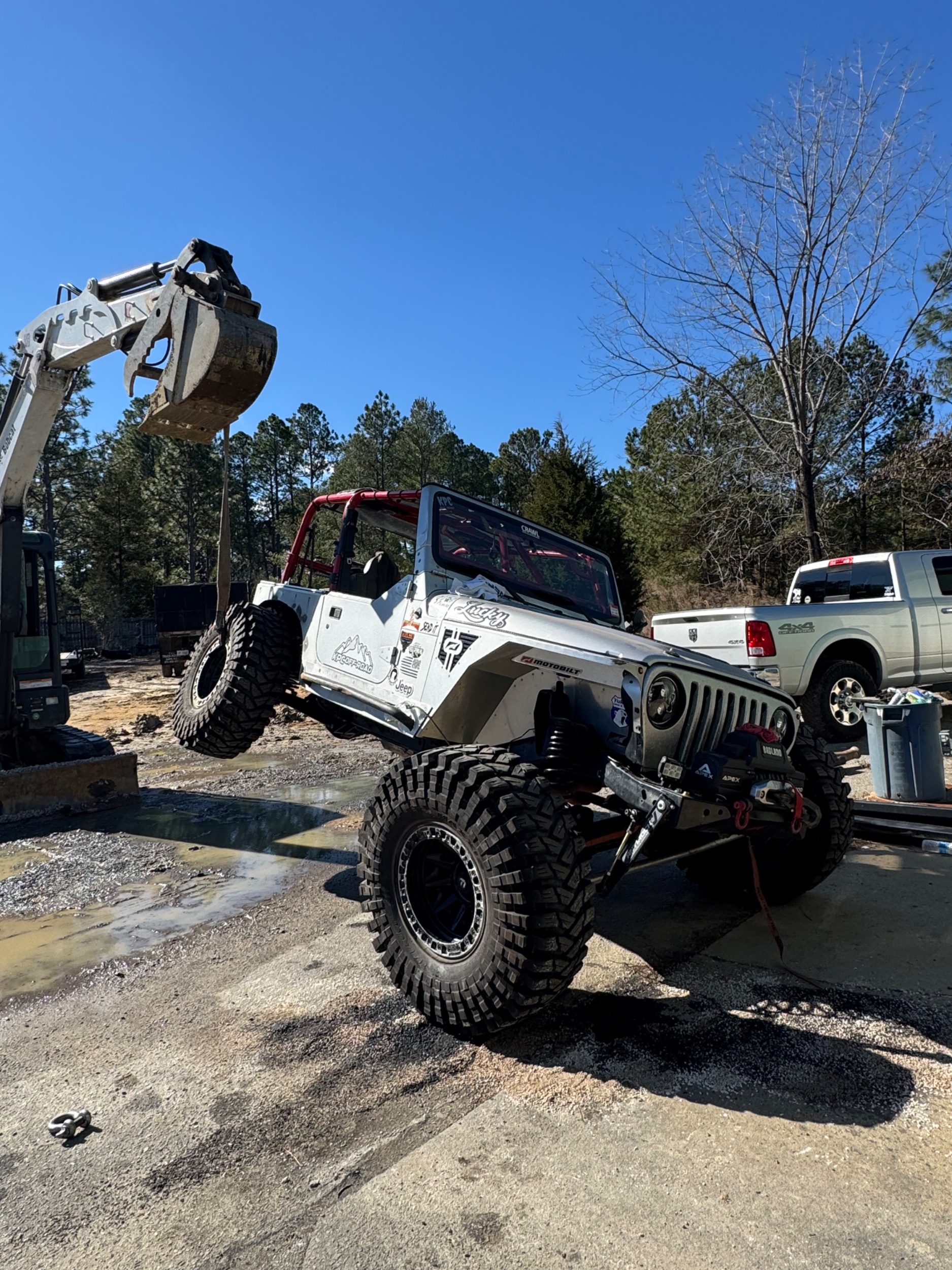

This picture really helps me understand how different components affect peoples builds. As you know, I have JK axles, 37's, & Metalcloak arched fenders. The use of a flat pitman & high steer knuckles severely limited articulated up-travel, especially when right front (passenger) tire was stuffed and wheels turned "Passenger". The drag link would hit the frame rail. It's clearly evident that your jeep does not have this problem.
Yeah it’s those small things. I do not have have that issue. In the front the only clearance issue I had was my passenger side sway bar mount. I had to cut it off and weld up straight to clear for the drag link
