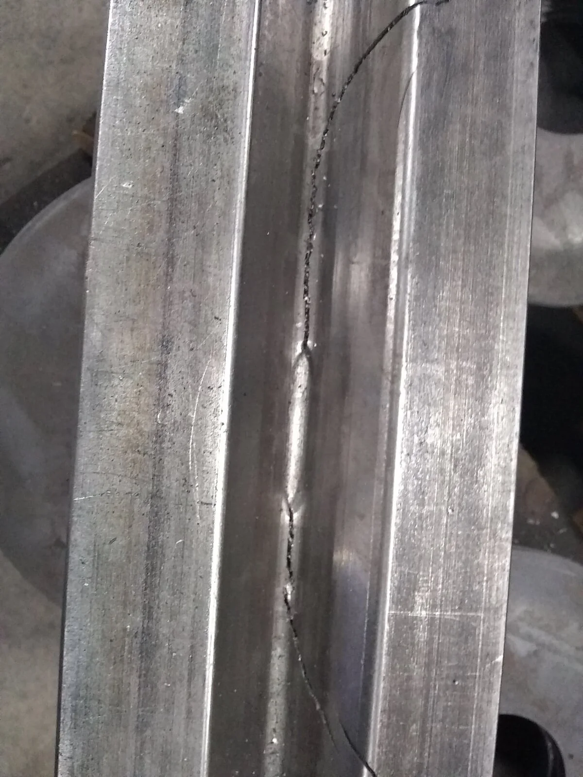

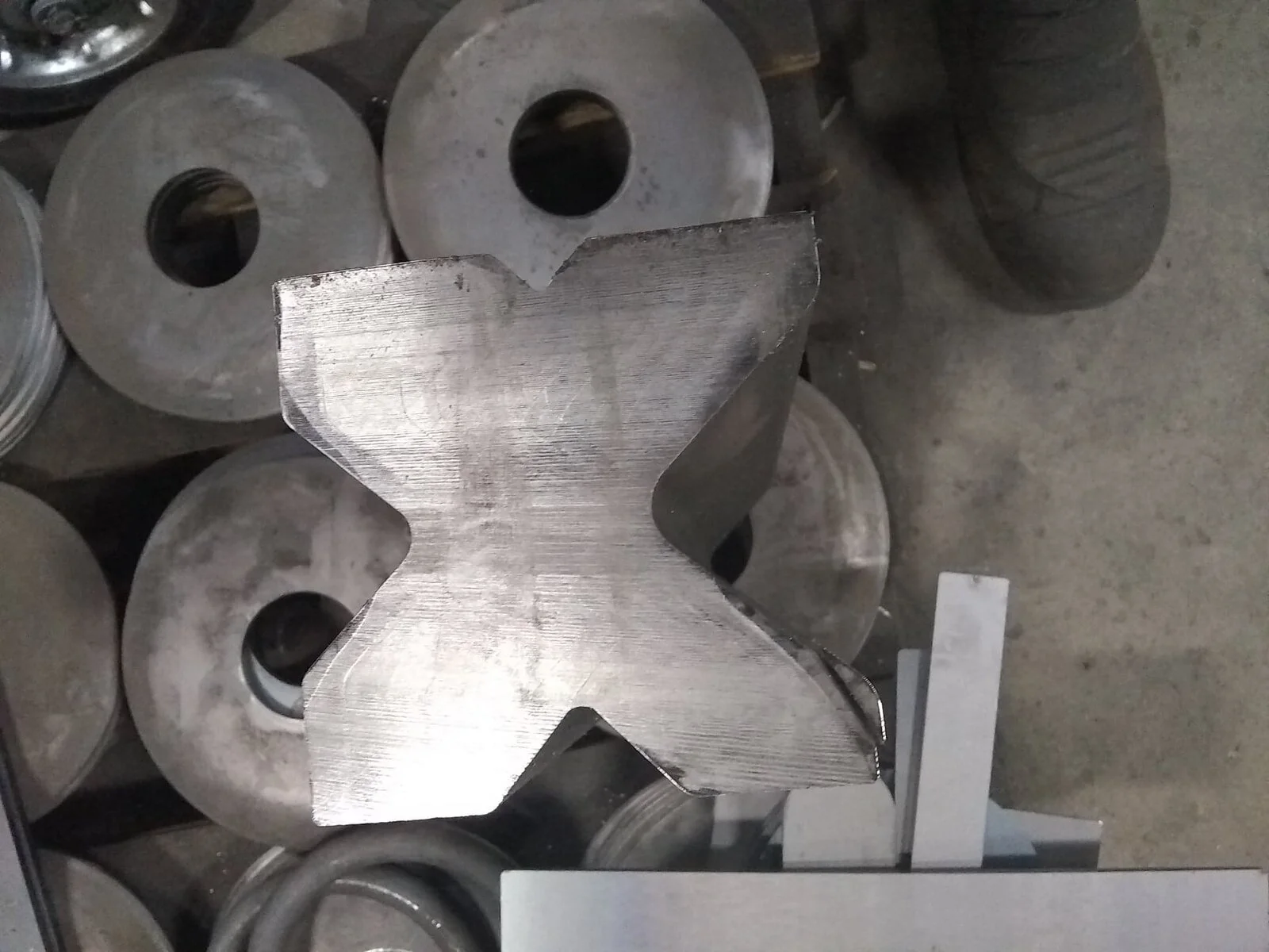

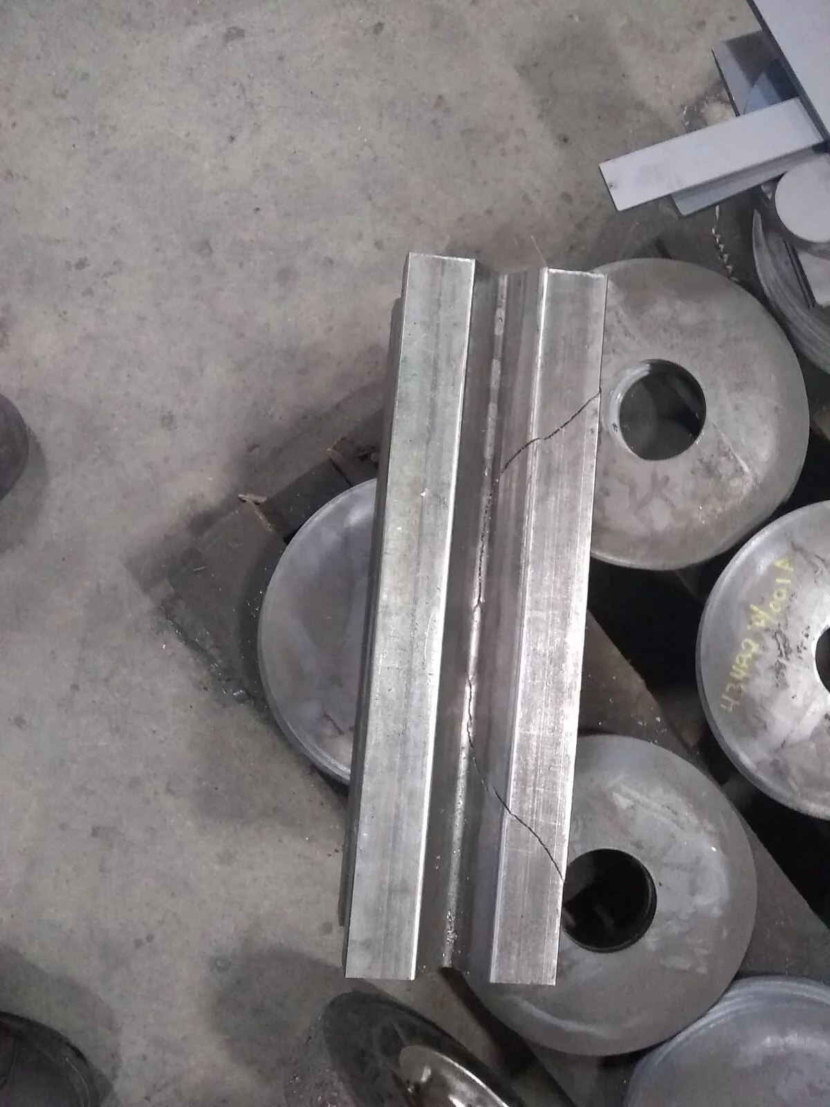

here's a stress crack for y'all..........this sounded like a lightning bolt hit the building.
this is about a 14" x 4.25" x 4.25"chunk of the bending bed that used to be 12ft long an sat under a monster press brake. look what this fool went and did to it. 12K mistake......BOOOOOM. he's lucky it didn't come loose and tag him.
anyways this piece is mine now and i'ma clean it up and weld it up and use it on my hydraulic press at home.
There is a reason they warn against coining stuff.
