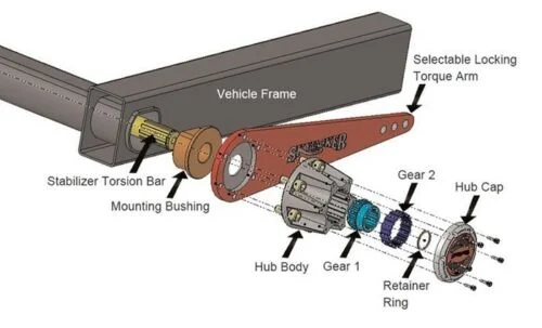

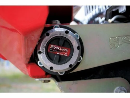

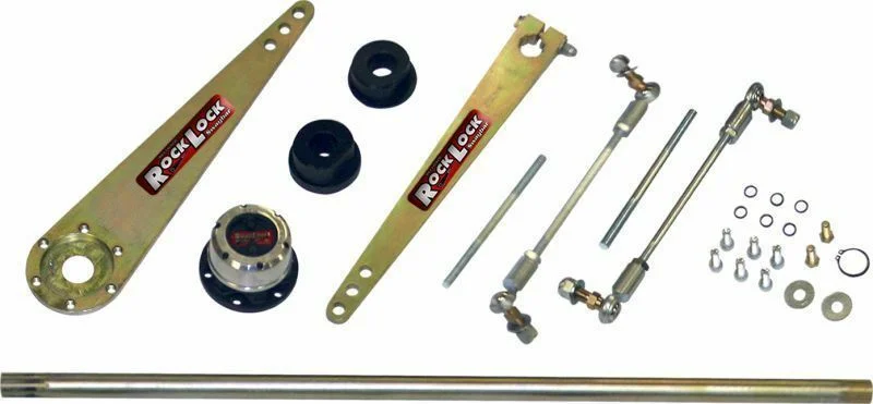

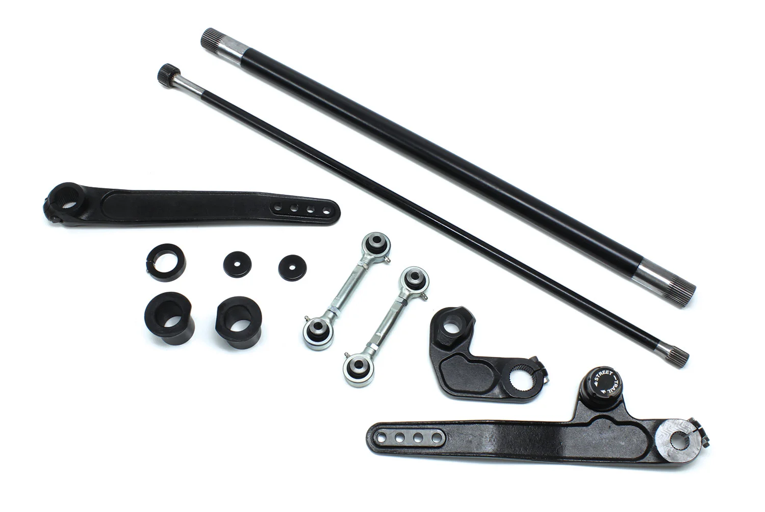

The Skyjacker RockLock is a torsen bar like the Anti-Rock with a hub on one end that you turn and disconnects the swaybar. So it's like having disconnect links.
Skyjacker® RockLock Sway Bar Disconnect System 97-06 Jeep Wrangler TJ LJ JFSBA10 | eBay

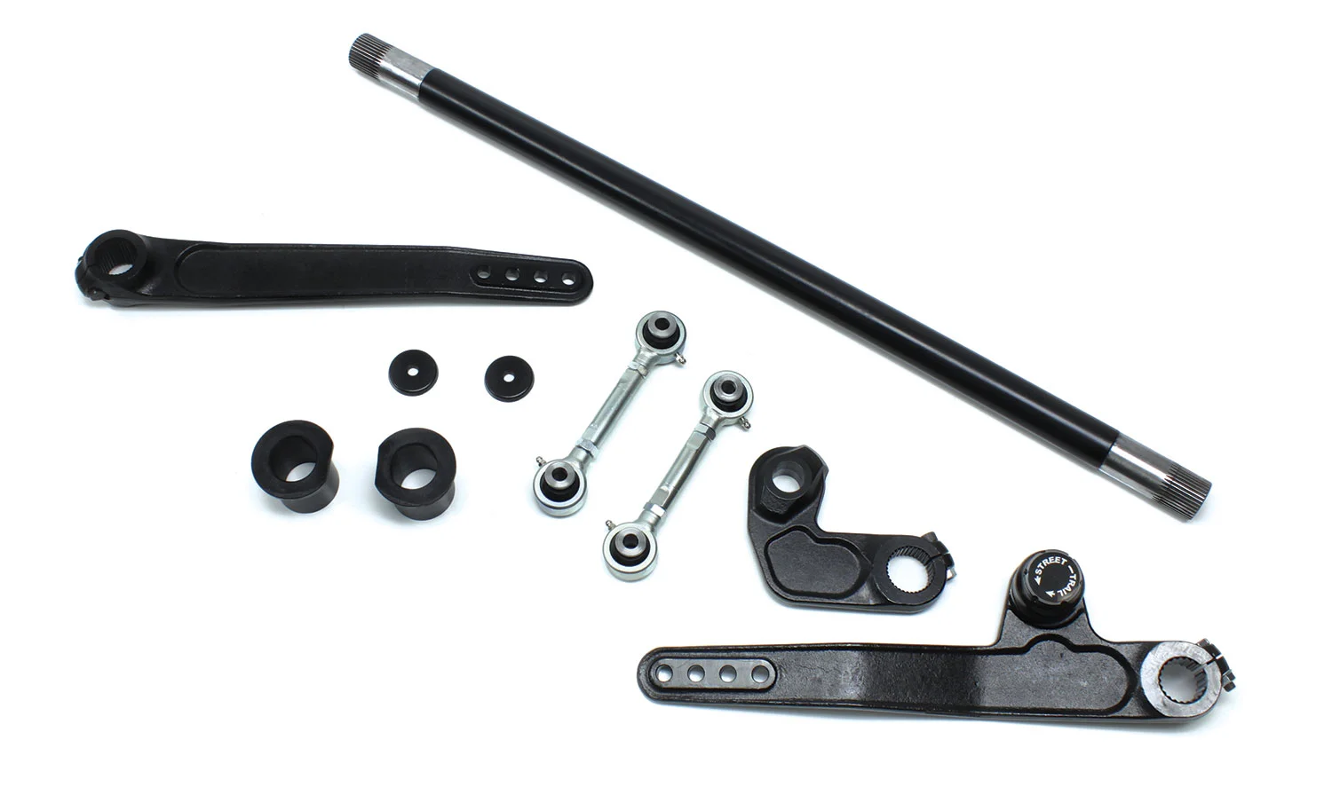

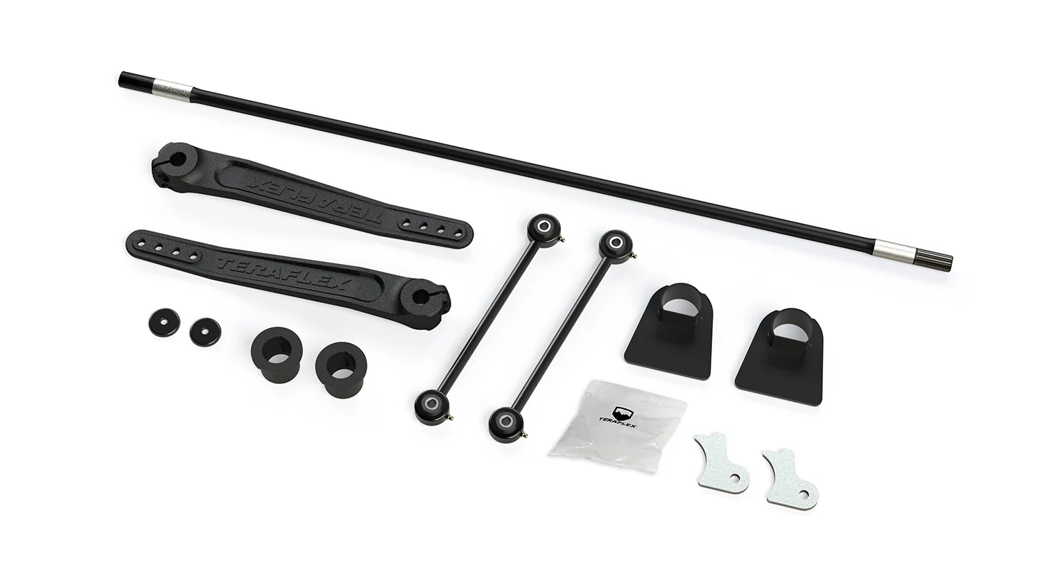

The TeraFlex kit id more like the SwayLoc but the disconnect is a LOT different.
TJ: Dual-Rate ST Front Sway Bar System (0-3” Lift) - TeraFlex
And then as was already mentioned TeraFlex makes a single rate kit also with just their Street Bar.
TJ: Single-Rate ST Front Sway Bar System (0-3” Lift) - TeraFlex
And TeraFlex also makes a rear bar similar to a rear Anti-Rock.
TJ: Trail-Rate ST Rear Sway Bar Kit (4-6” Lift) - TeraFlex

You are not really switching between two different swaybars, just two different rates. When it is disconnected for trail use, it is reacting against an AR size offroad swaybar. When you connect it for on road use, it combines the inner and outer swaybars for a higher rate than either bar alone. Someone needs to design a triple rate disconnect so we can really confuse folks.
