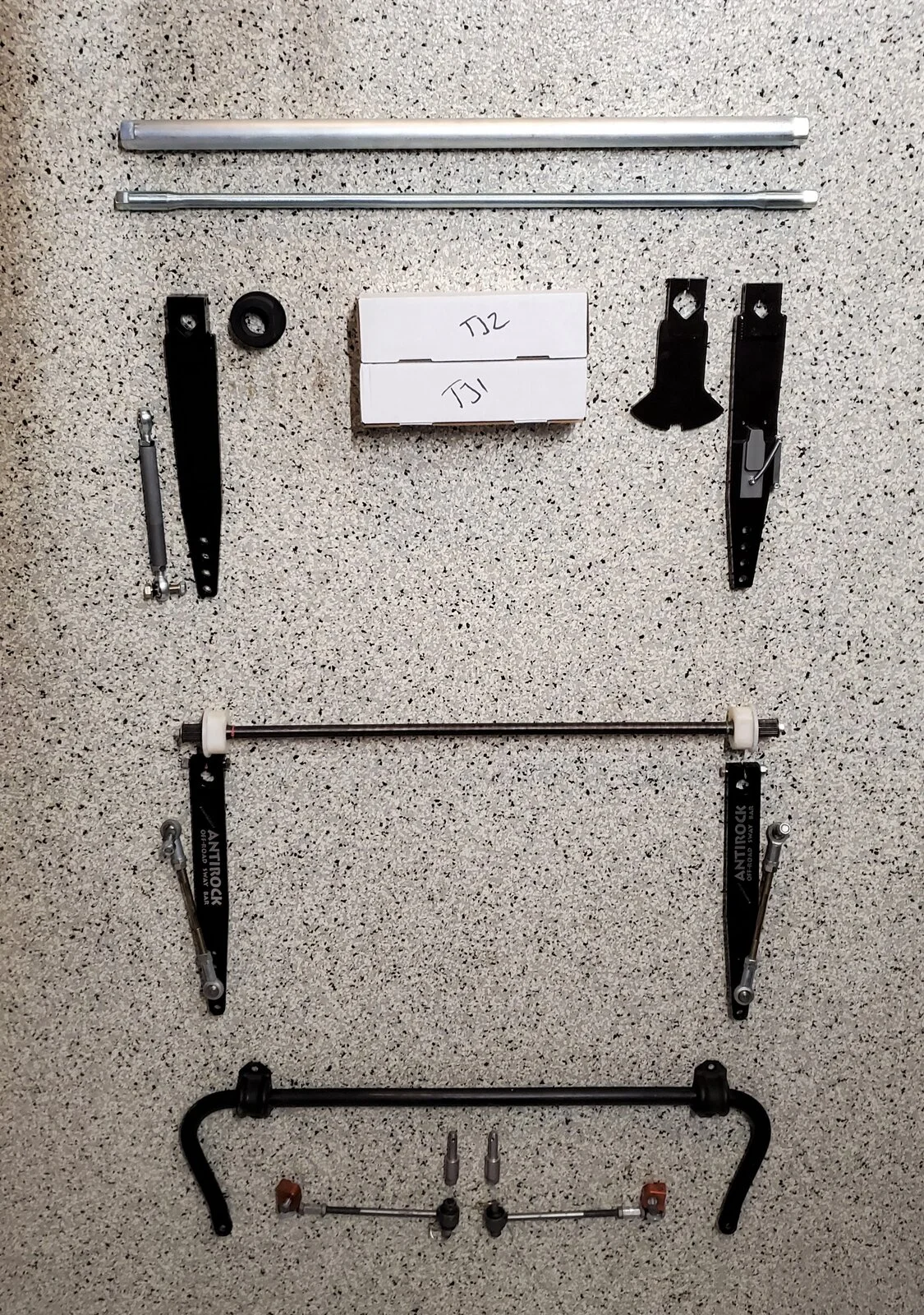

The first photo in Post #1 allows a comparison of the Antirock torsion bar and the SwayLOC torsion bar. Both neck down to 0.75" in diameter, they are nearly the same length, and it is my understanding that they are made from the same chromoly steel.

* The first generation SwayLOC employed a splined torsion bar with a single diameter rather than necked down as the torsion bar is now. In combination with the threaded hole for the retaining bolt this created a stress point that resulted in breakage. The second generation resolved this problem, but not without some well deserved ill feelings held by previous generation customers who could not obtain replacement parts, now "NLA" due to the design change, who were required to pay for an "upgrade kit."
That is an excellent photo. And yes, in my research, what I found is that after the early hiccups (and some customer service issues), the design was updated and it became a very good product after that.

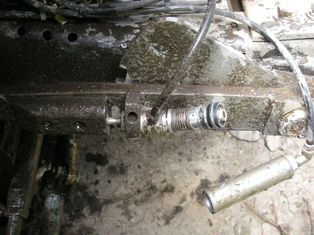

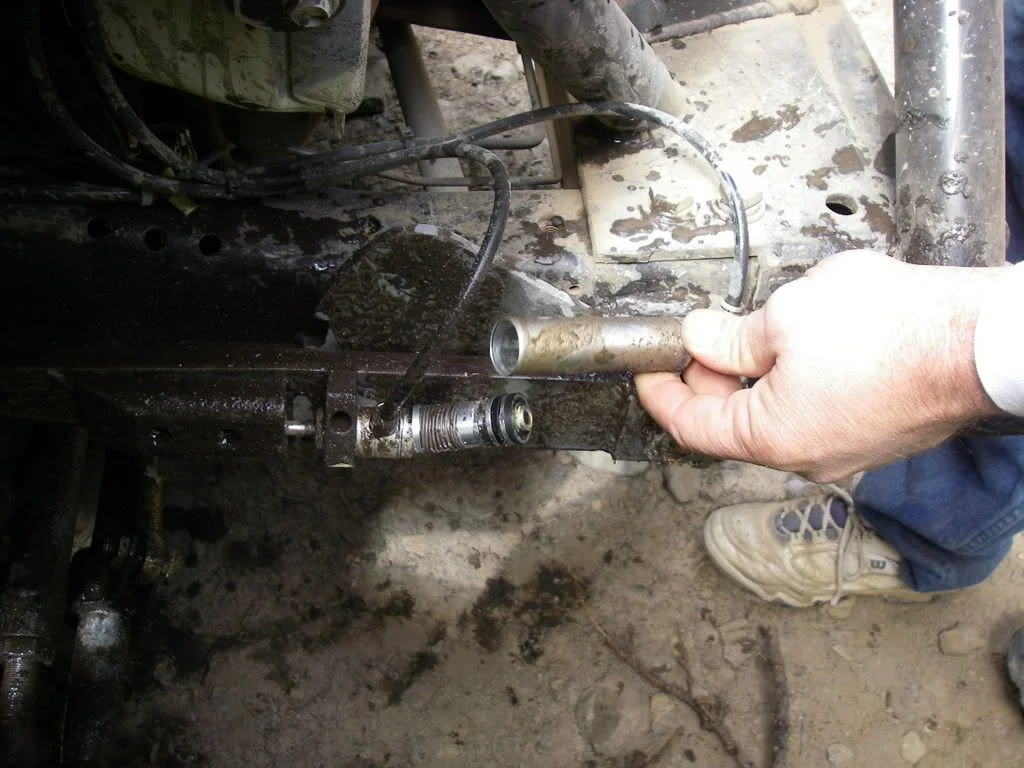

Now I did manage to break the air cylinder once and neither Steve from ORO or myself could figure out how I managed to break it. But this was the only time I have had any issues with it. And I've had mud caked on the arms before and never had any locking or unlocking issues.

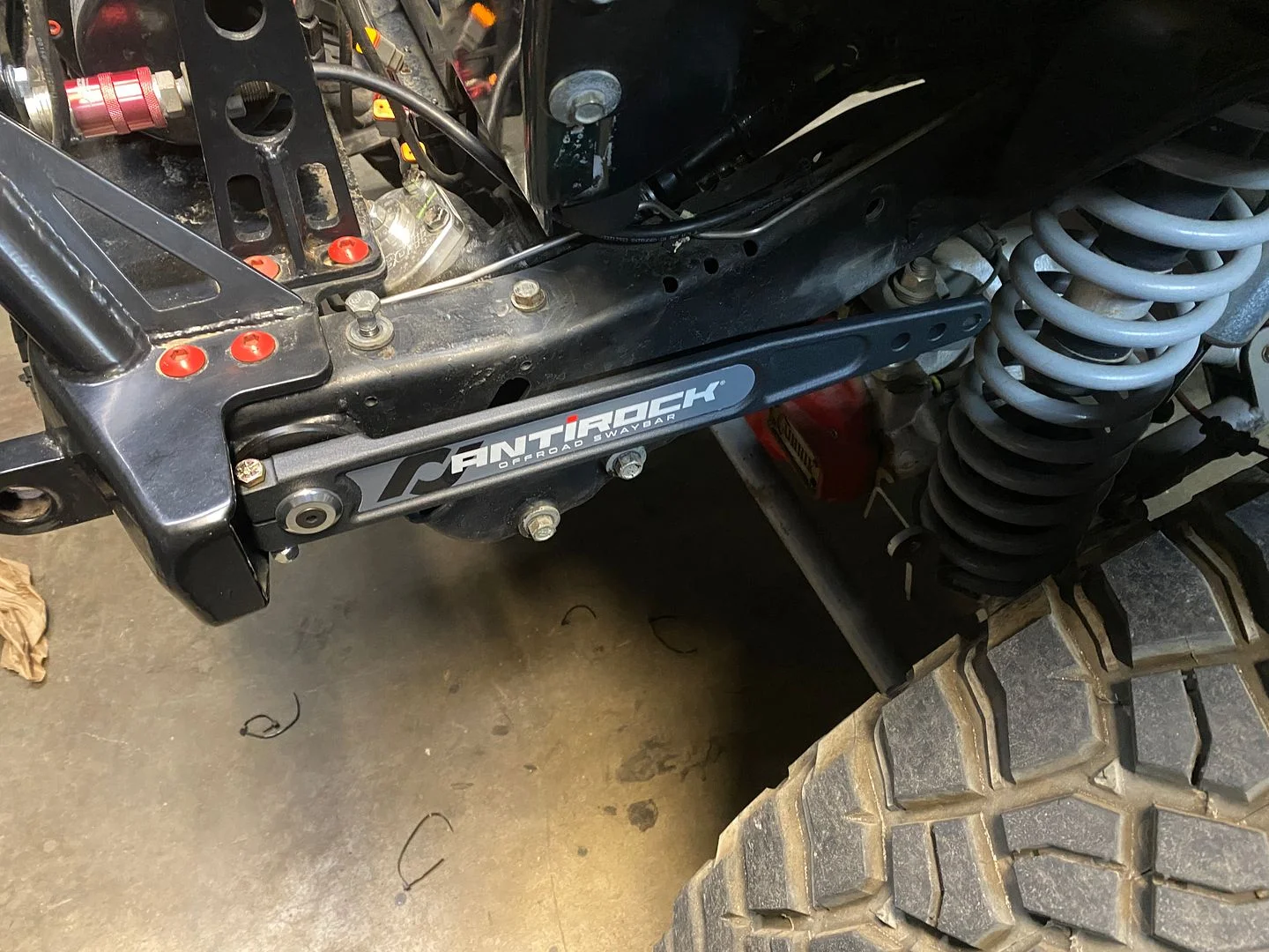

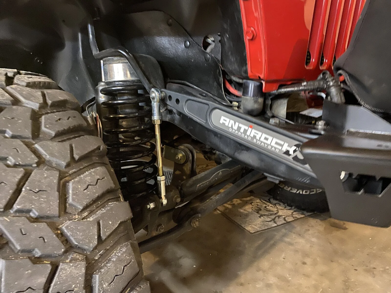

I spent about an hour removing the old swaybar and disco hardware. I managed to get the bushings in and the torsion bar installed and the arms "leveled". Looks like a winner.

The AR should be angled up around 10-14*, not level.
