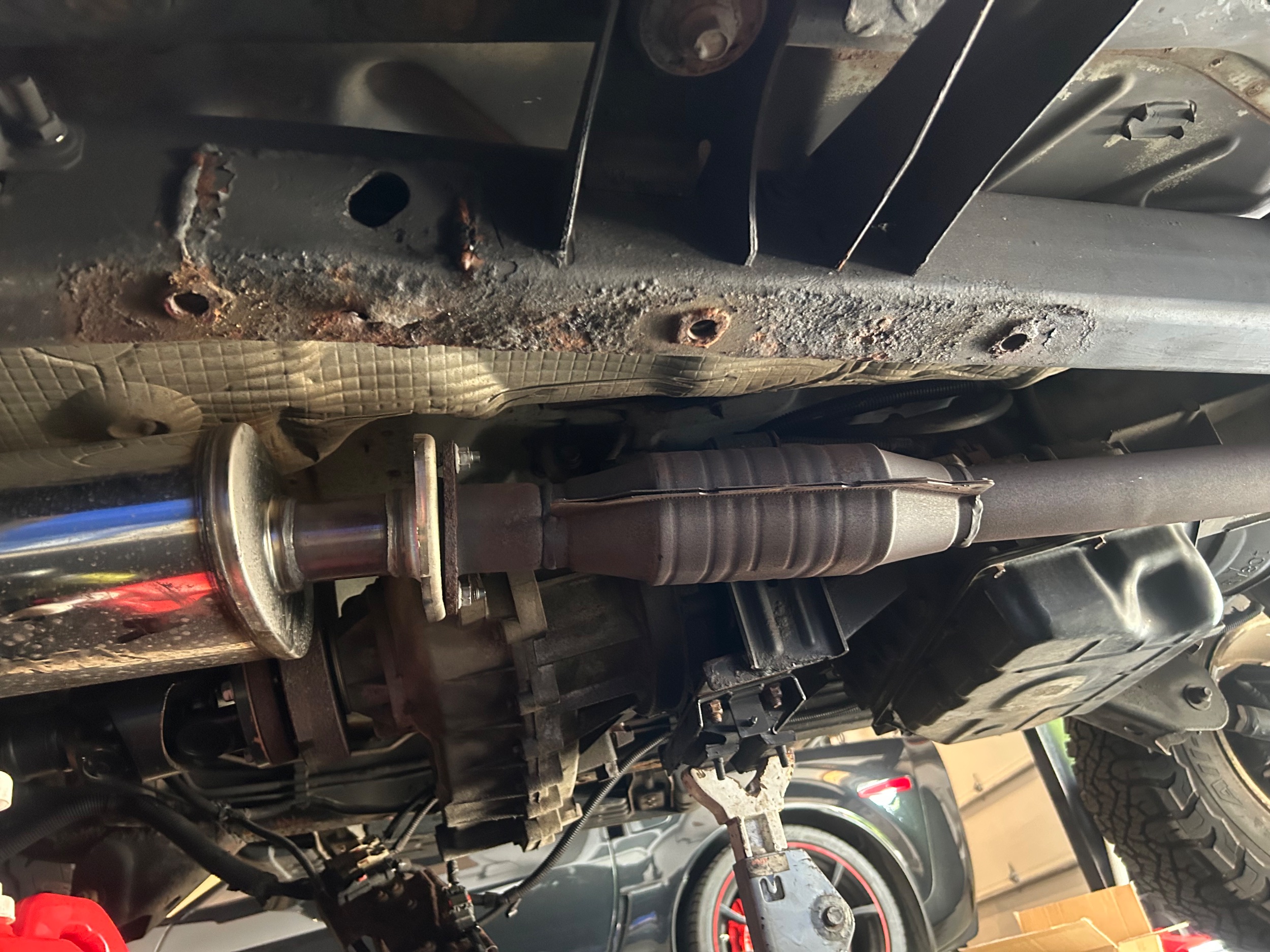

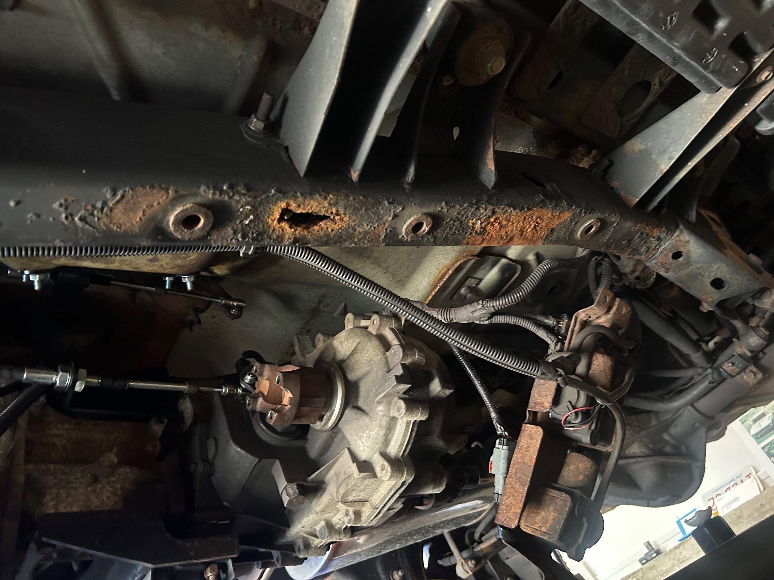

That’s nothing. Mine looked way worse when I pulled the skid plate off last summer to replace my transmission mount, install savvy shift linkage and front driveshaft removal. If I was you I’d spray some wool wax or apply grease prior to reinstalling the skid plate
That frame doesn't have long to live.

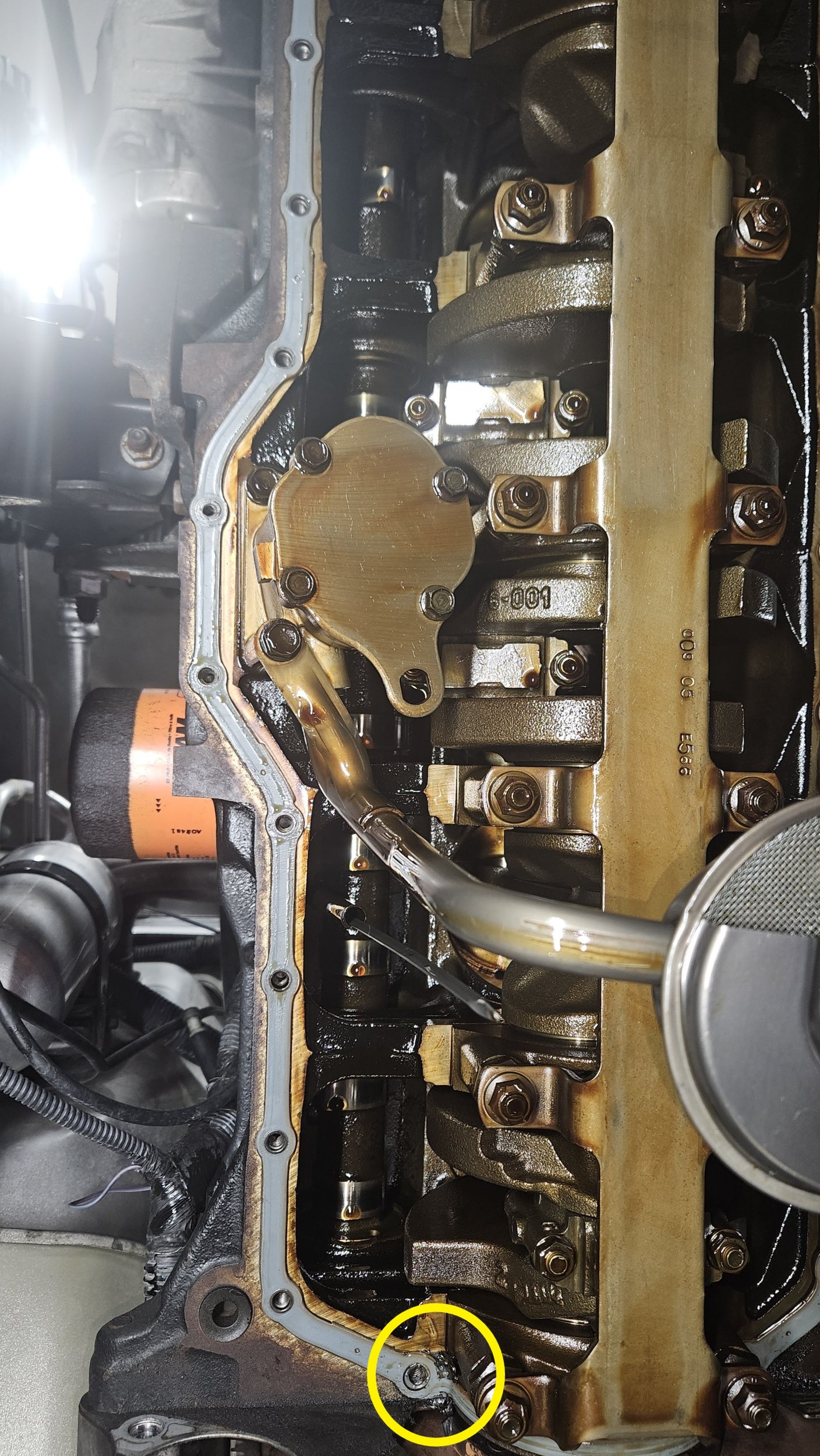

Looking at photos to refresh my recollection.
When I took off the old gasket, there was RTV in the back between the flat surface and crankshaft hump. I used some here on both sides as well.
